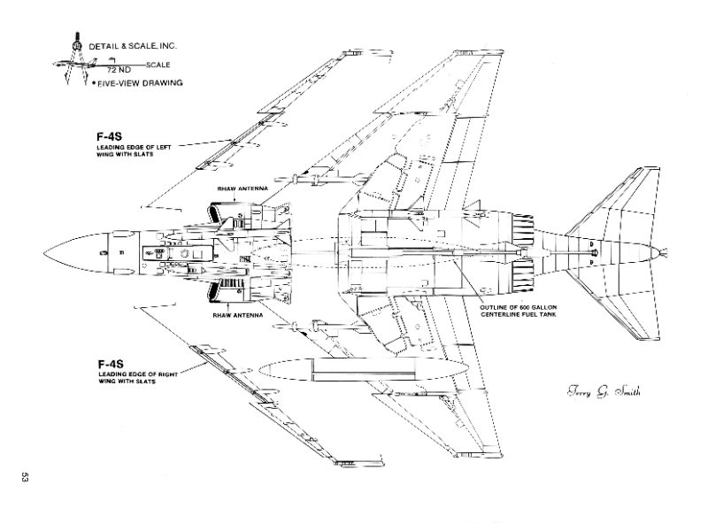

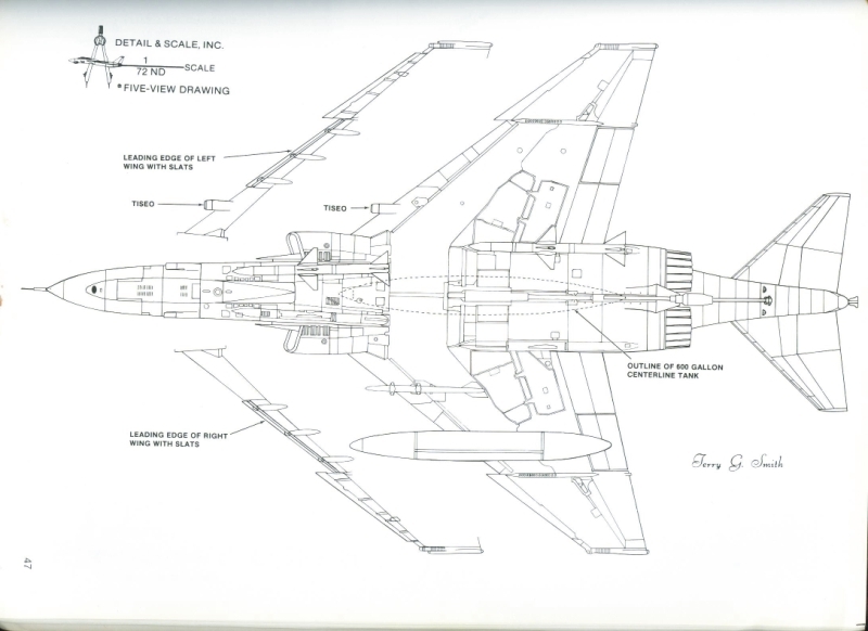

Hello:
I put two drawings of the F-4E and another two of the S versions with the same leading edge slat.
Carlos.

Cool! That F-4S scheme is RC model worthy. Folding outer wings would be a unique touch for a detail to add to yours.
