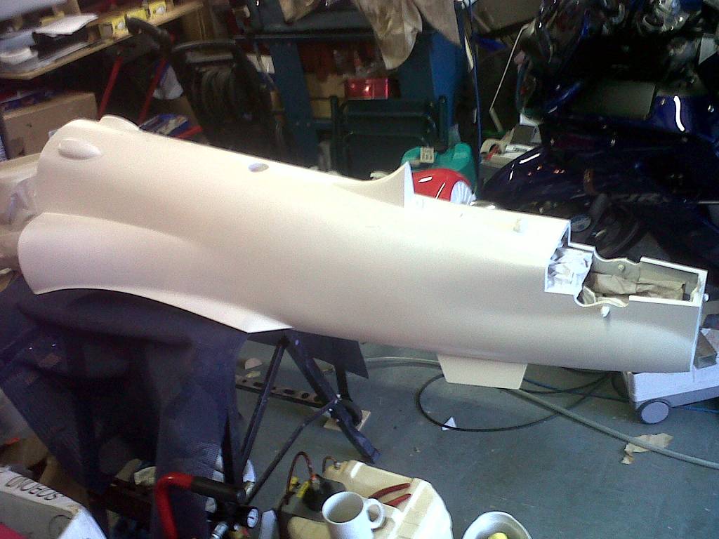

Finally managed to get the red paint matched on the Hawk
Two reasons I am repainting, one the carf stuff is not fuel proof you only have to buff with dry cloth and red comes off and secondly the main reason the paint scheme not been done right in the first place! plus I get rid of the mold line... ok 3 reasons.
The red has prooved to be not easy as anyone who paints will tell you. The CARF Display is a VERY bright red and typically bright reds are very translucent which means the base coat does matter. Well I usually use a Ti Green 2k primer which is very good but even in the pic this was tinted by 10% white 2k! you can tell the difference especially when you take it out of the sunlight. The right hand side has white primer which makes a huge difference. The guys at paints4u.com have spent some time on this finally having to manually mix taking out lots of orange and using a lot of very bright red tint! The small peice on the right is original red (cut out when fitting air scoops)
Second pic is top of nose which has just been redone, but it had light green Ti primer and you can tell the difference so this bit being rubbed down and done with white 2k primer before the red, then it will be exact match!
Also first time I have had 2k through my SATA mini jet 4 that I recently brought ... well impressed how it lays the paint on, pleased I brought it!
Alan

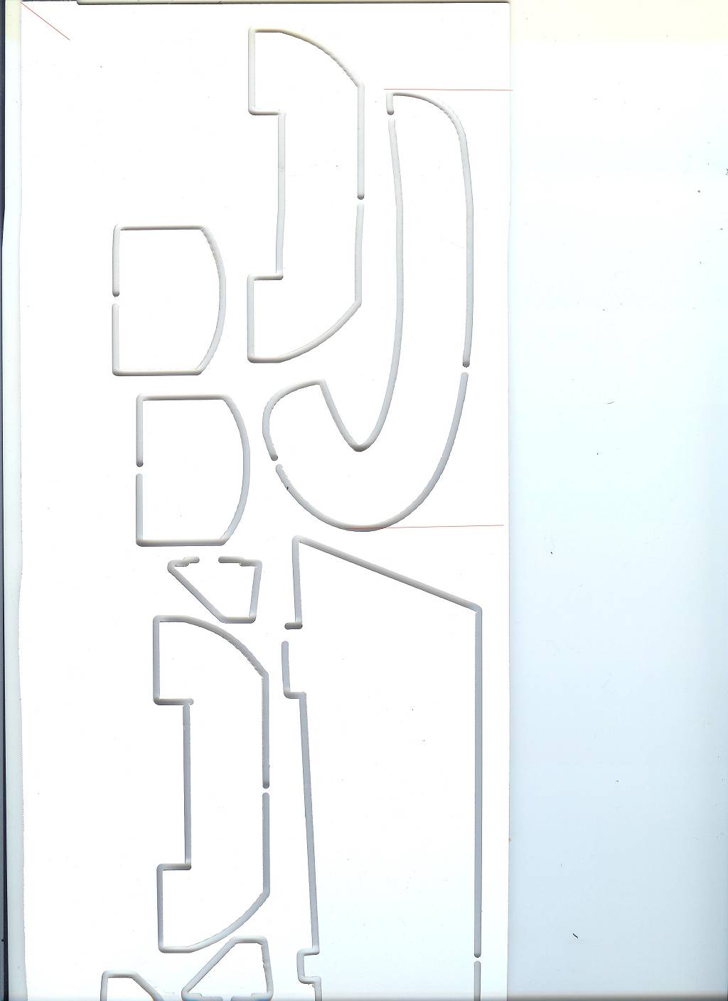

Can anyone trace an out line of the wing fence and post it so I can make a set for mine
Old 09-09-2012 | 10:05 AM
  #805
Joined: Jun 2002
Posts: 13,266
Received 793 Likes on 576 Posts
From: Watford, UNITED KINGDOM
Default RE: Comp ARF BAE Hawk build thread
If you get no takers I can draw around one and fax it? Don't have a scanner!
Dave

Hey Rich,
I tried scanning it and then printing it. It printed a tad smaller. I will email you the file anyway as it gives you the correct shape and you can enlarge it or let me know a better way.
Marty

Maybe you can provide the length measurement as marked on the photo that you sent to me?

Thanks Dave, I think Marty's file may work...

If you draw two vertical lines at each end of the fence, the OAL is 127mm or 5". Hope this helps.
Marty

Thanks Marty, that what I did in the photo that I posted, the lines came out very light, but they are there
Thanks for the info!

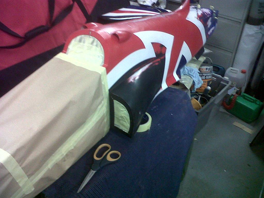

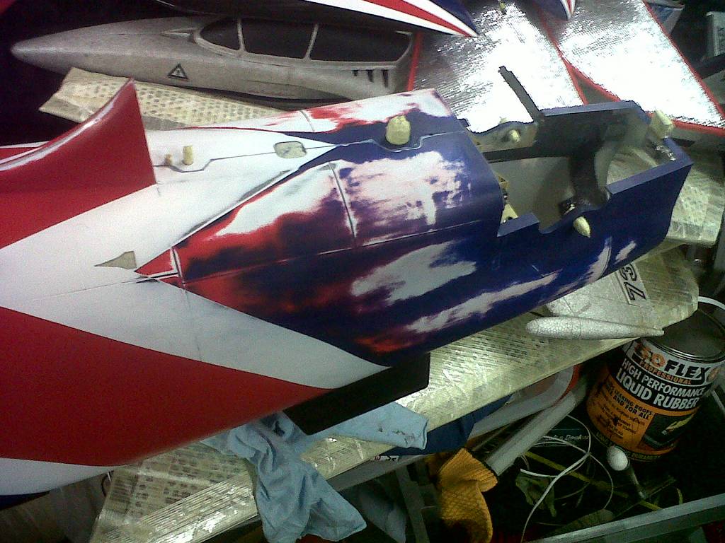

Have been busy getting the rest of the fuz ready for painting, the front half is done now, so starting the back. Got rid of most of the blue and even though you can still see the design I have removed quite a lot of paint before I give it a light coat of 2K white primer.
Hopefully the back comes out as good as the front. One thing I did when building the CARF Hawk was to bolt on both jet intakes as I knew at some point I would repaint it, this makes it very easy to spray the intakes.

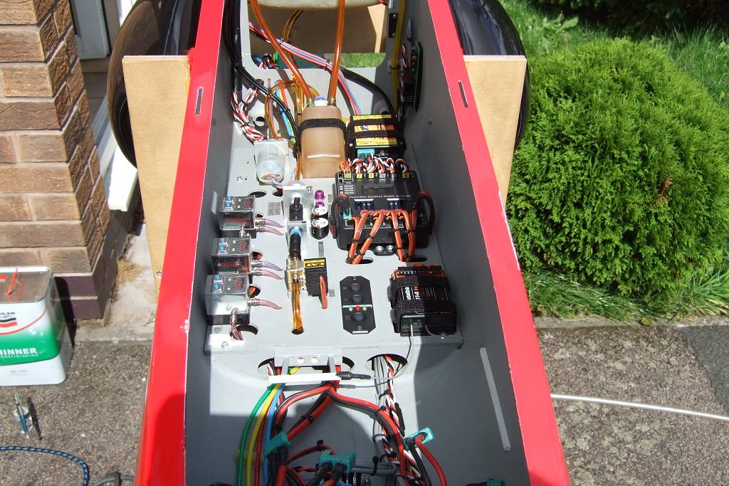

Couple of pics from my install
Alan

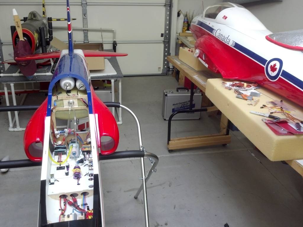

After some medical problems I am finally on the road to finishing up my hawk.
All that is left is to Set up the controls, Balance and put the finishing decals on.
I was going to put smoke in but did not think ahead and brought the wing cable out the top of the wing instead of through the front. Has anyone put their smoke tank in another area other then on top of the wing where the wires come out?
I really do not want to move the wires if I do not have to.
Here are some pictures of my install.
Stan
