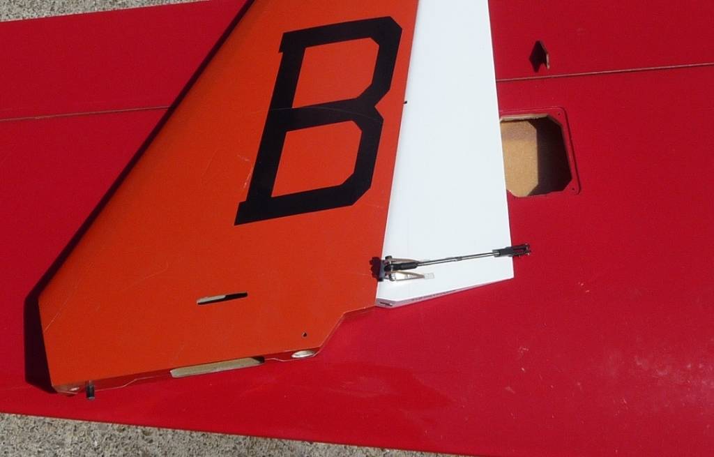

I know it sounds extreme, but the "cracking" the horn and re gluing is the best solution. It takes seconds and the lines are then good. I'd stick with a clevis at the servo arm end to keep the action inline, you could trim the cover moulding and fit a ball link inside the horn but you will not get a totally solid flap as easily. (I sleeve my 3mm rod with carbon tube also). I built a Hawk for a friend begining of this year and it was fine, I'll talk with CARF about this as I thought it was sorted. Actually a guy picked up a Hawk kit from me yesterday that has just been ordered, I'll get him to check the alignment

Alan And Dave,
Thanks for your input.
I like the idea of bolted ball joints to help correct the angle. It is not a perfect fix but if it works leave it alone.
A friend here in Tucson Has not started his yet. He says he is going to mount his servo on the inside of the top skin between the gear mount and original servo mount. He says that it is then in line with the horn and he can still get his gear in and out. I will look into that also.

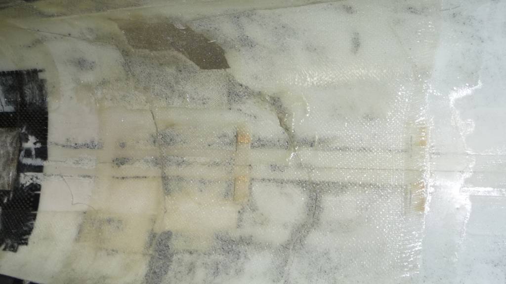

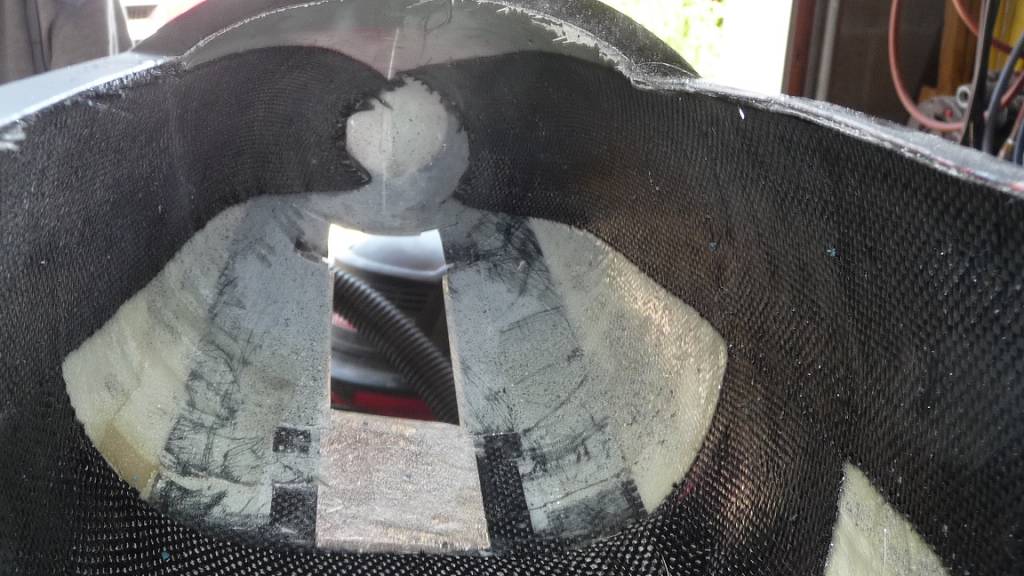

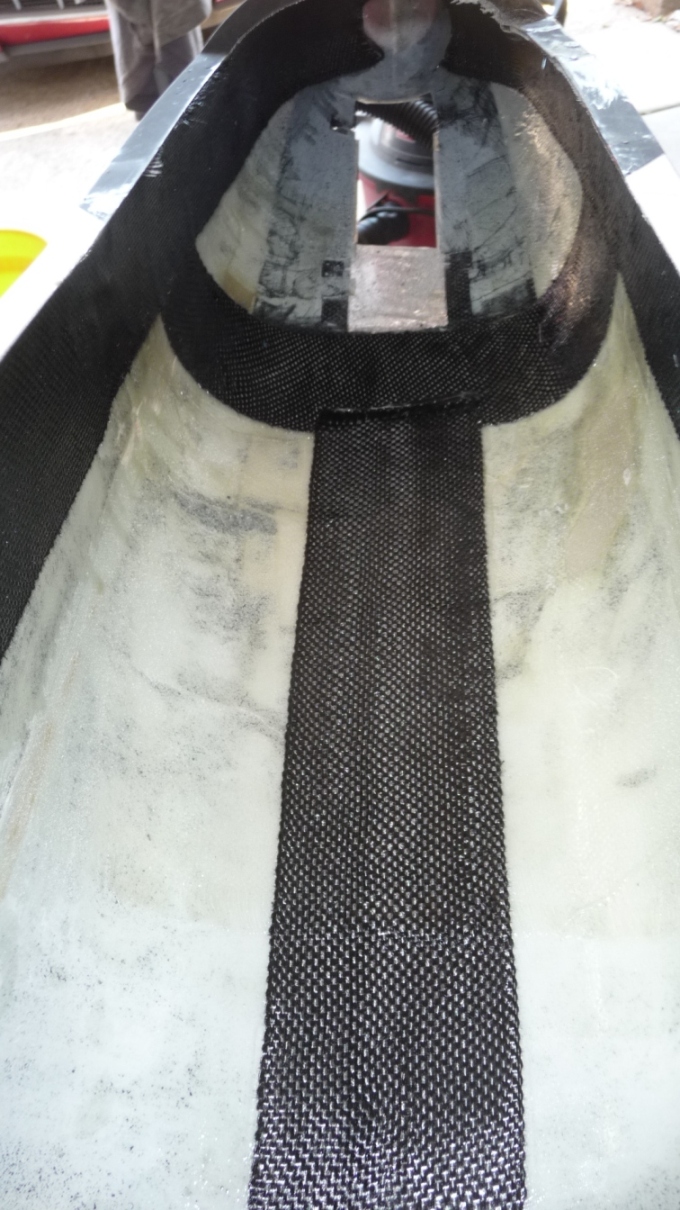

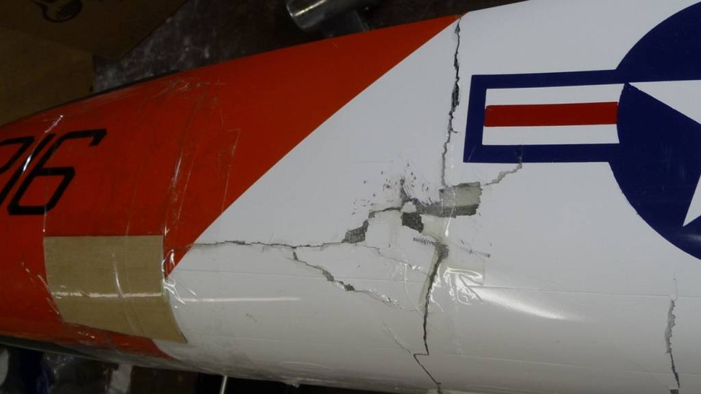

I have made a little progress on my rebuild project, I have the broken section of the fuselage glassed internally, I used 6 oz cloth and then I will lay in a strip of CF down each side of the fuselage.
I will use 2 oz cloth for the exterior repair, the reason for the 6 oz cloth is I wanted to create a buffer zone for when I sand the v groves in the exterior skin where the cracks were so I don't break into the CF layer that will be applied.

I made carbon fiber rods to stiffen the original rods provided in the kit.
I used a ball joint on the servo arm side to correct the angle. I used the connector provided in the kit on the flap horn.
I have to say it works fine that way. Very acceptable.

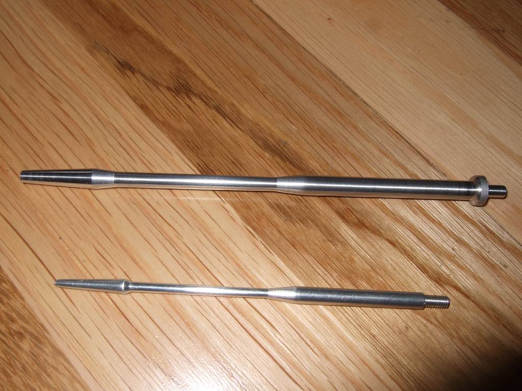

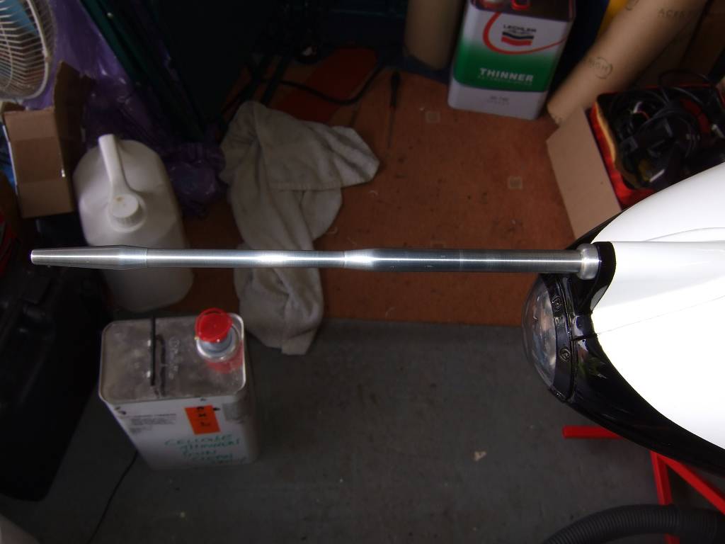

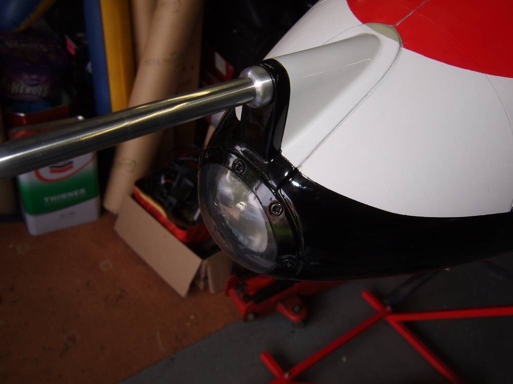

Finally got round to fixing on the pitot tube assembly (as spraying rest of plane anyway). Turned up a pitot tube same as I made for my 1/7th scale hawk. Stuck a M4 thread on the fixing end of the pitot tube and turned a tube with a internal M4 thread which will be glued with hysol in to the end of the carbon tube that's already inside the molding.
Just got the red to spray, at least this will get rid of the mold line..
Alan

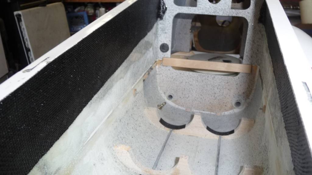

Here goes with the pics any more dimensions just ask, the plywood spacer I used was 1/8" and I did turn a plug up to get the correct centre with the carbon bell mouth entry etc...
I noticed you state you don't want to use packing but I found on mine if I used the 1/8" everything inline plus the Hawk flies spot on with no pitch change whatsoever with any throttle settings. The way I did it was the ony way with the carbon shield that gave me what I was looking for.
The tube exits the fus by 5-6mm.
If you set up the engine to the settings then using a plug say plywood for diameter of the bell mouth and balsa (both centred and glued together) to fit exhaust of turbine that will allow the centre height of the thrust tube.
Just noticed for a second time the JetCat rubber disc that holds the JC fod guard in place the rubber has perished/rotted again.... won't be buying a third will get some decent rubber sheet and make my own [
Alan
