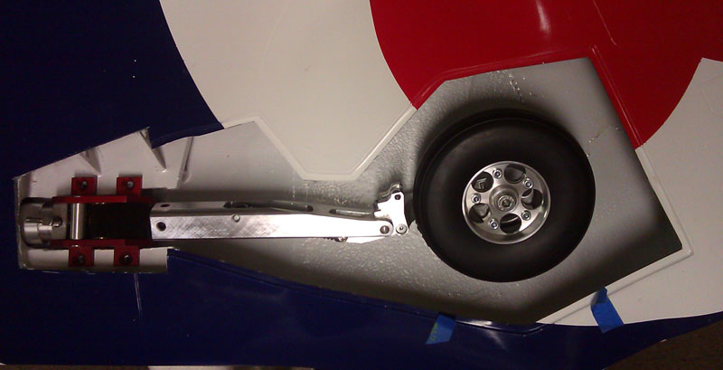

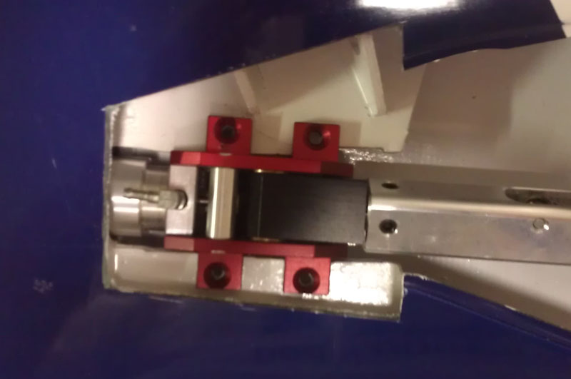

Anyone else not able to mount the leading edge rails of the main gear even after grinding away the flange? I mean it isn't even close to possible?!?!
Actually, it wasn't possible on ours either - the mount was way up under the wing skin. We cut the area around the mount away as a hatch so we could easily get to the mounts. After we get the gear finally mounted, we'll put them back in with 1/8" ply mounts on the corners and small screws...
Bob

I initially mounted the gear in the wings as it fell into place. I was barely able to secure it on the rails by having cutouts for the bolts that went right to the edge of the door depression, by cutting the bolts short, by using a ball driver at an angle, by grinding away supporting plywood, and by trimming away a portion of the mounting flange from the blind nuts. Then after adjusting the toe in of my gear I found the tires were clearing the back edge of the wing surface by a millimeter with all the gear door depression ground away. I flew in like that for awhile but was never really comfortable. After a bad landing I lost my millimeter of clearance on one side so I decided to relocate the gear. After plugging the bolt holes and relocating the gear to put the wheels more centered in the well and giving me 5/16" clearance behind the tire when it passes the wing skin I found the bolts much easier to access and the peace of mind priceless. So it appears the plywood mounting is not being placed properly in the molded wing.
The first step should be to place the gear where it needs to be in the wing cutting away ply as necessary to accommodate the gear and cylinder. You will still have to grind away the ply support below the ply mounting rails (I used a dremel tool with a Permagrit cutting wheel) in some spots if you want to use trimmed blind nuts but that is pretty easy and fast to do just a bit of a pain to get at. I believe some have just tapped the ply for the 4mm bolts which would be easier but I used the blind nuts. Looking at my Ultra Flash the ply gear rails in it are approx. 10mm thick, that would be fine for simple tapping into the ply. But the gear on the Hawk is much bigger and the ply only approx. 6mm. Anyway if I were to simply tap the holes on a Hawk I would Hysol another layer of ply below the rails to add some material.

Yea, its probably possible to do it without making a hatch, but its so tight and was going to be such a royal PITA, that I said "screw it" and made the hatch. Now we have all kinds of room and the blind nuts were relatively easy to get in there. We have the wheel centered in the well with the proper toe-in and we have somewhere around 1/2" or more clearance around the wheel on all sides...
Overall, I think cutting the hatches is going to be the easier way to go. Its going to make getting the gear in and out and routing air lines, etc., much easier. We're thinking of hinging the lower gear doors like the full scale, but if you wanted to go the route of just notching them for the gear leg to extend like the instructions show, you could simply glue the lower gear doors (with the notch cut into it) to the hatch you cut out and just make the thing one piece. Four pieces of ply (or polyply) on the corners and 4 screws, and you're all done...
Oh, and we did have to grind away some of the gear mount and also put two washers under the outer gear mounting bolts to get the gear properly positioned in the center of the well and to have it go far enough into the wing (with the required toe-out) to keep from interfering with the gear doors.

i must admit that I too had same difficulty as Husafreak , but I added 0.8mm ply on one side and the wheel now have enough clearance

Here's some pictures of our gear mounting with the hatch...
ID:	1948129   Click image for larger version

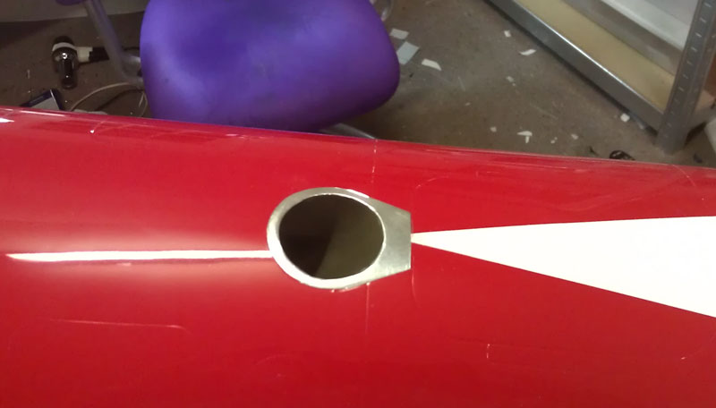

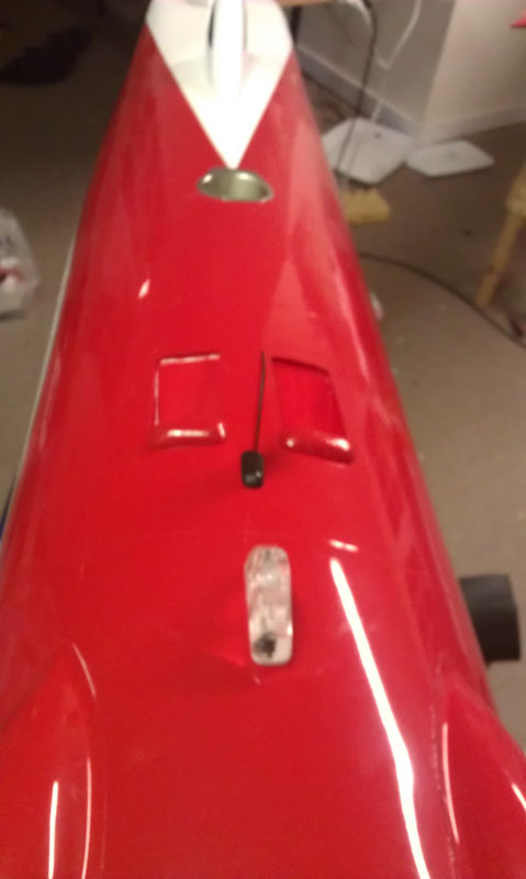

Here's some pictures of the details on the top of the fuse - including the APU exhaust...
ID:	1948140   Click image for larger version
ID:	1948141   Click image for larger version

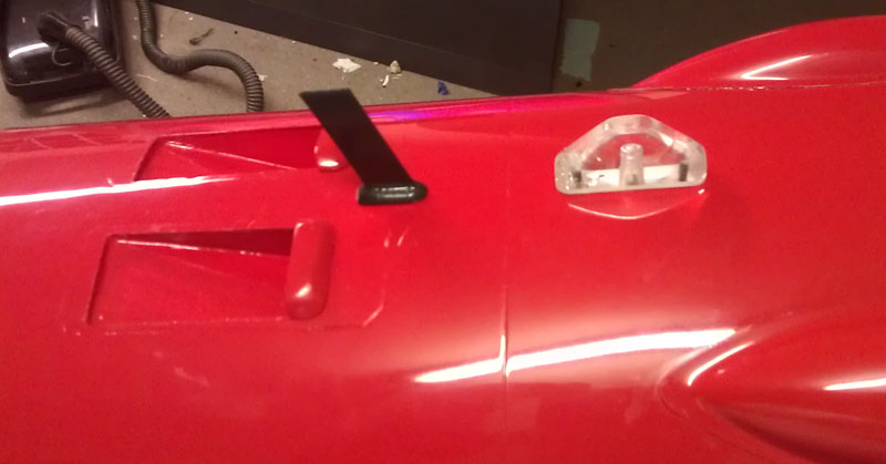

Does anybody know what these parts are for????

The two like parts are the stabulator slot covers ie. they attach to the stab to cover the "hole" in the fuselage. They don't fit very well and I don't use them for fear that they will jam the stab by catching the edge of the elevator servo hatch. I'd rather live with the gap there, which is not that noticeable to me.
The other piece, I'm guessing is CARF's attempt to replicate an antenna blade.
MIke
OK, thanks. I did wake up this morning with the realization that those are the stab slot covers - my brain must have been working on it over night, but I was lost on the other piece. I can't find an antenna on the Hawk that is shaped like that. I did find ones that are shaped like the other antenna pieces on the "parts tree" and they did not supply one for the "blade" antennas on the fuselage...
Bob
can you describe hwo you did the APU exhaust and also intakes ?
thx izzy

FWIW those stab slot covers are not very scale like. Which is fine for this sport scale kit. But if you are going for scale accuracy you won't want them.
