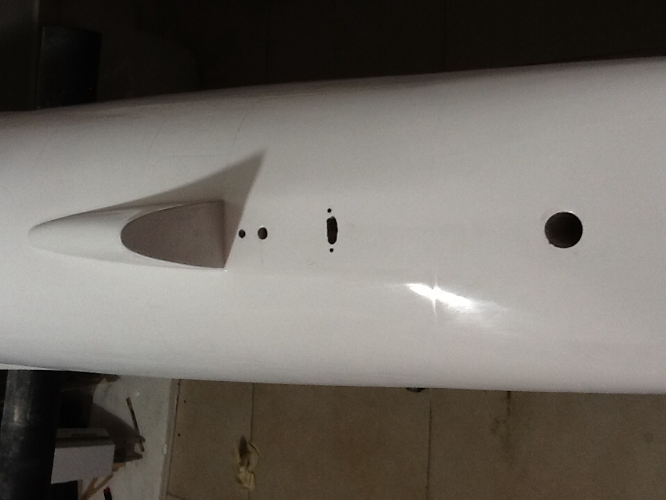

Maybe I mis-explained
i made a small hole for the extension lead of the rudder servo (which is in the fin) to enter the fuse.
There was no hole for the servo lead to enter the fuse ( the fuse came with 3 holes -1 tube for fin,1for bolt,1 for locating front pin)
the hole I made is located between the pin and tube for the servo extension. However there was a strip of wood under the fuse skin between the 4mm nut and tube
am I making any sense ?

Fine. The ply is just to support the T nut for fin fixing. I normally mount behind, but what you have done is OK, nothing to worry about
Dave

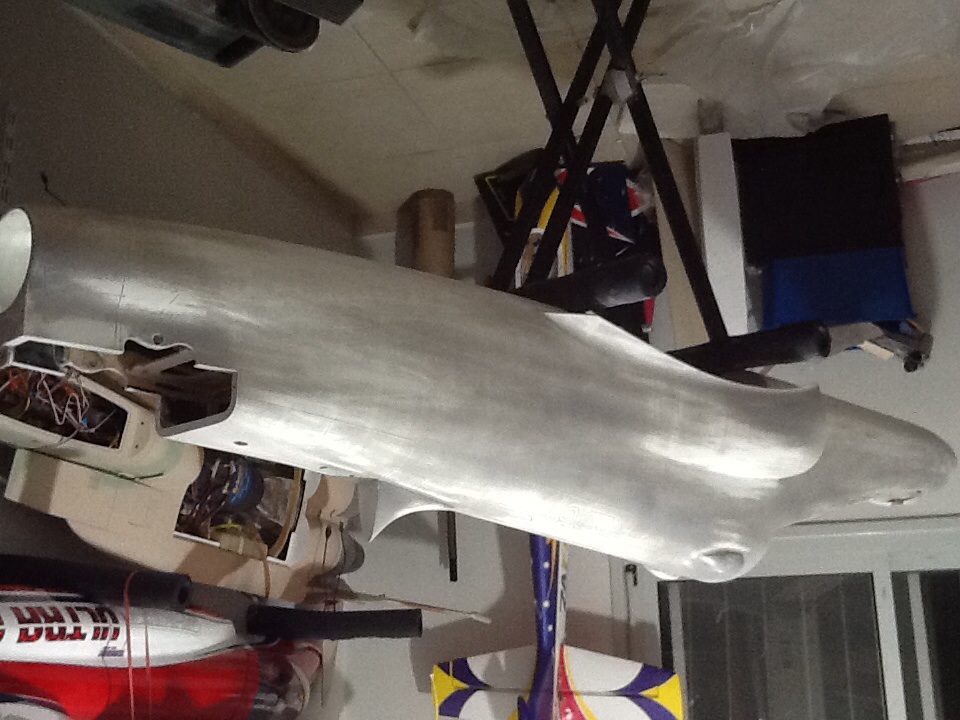

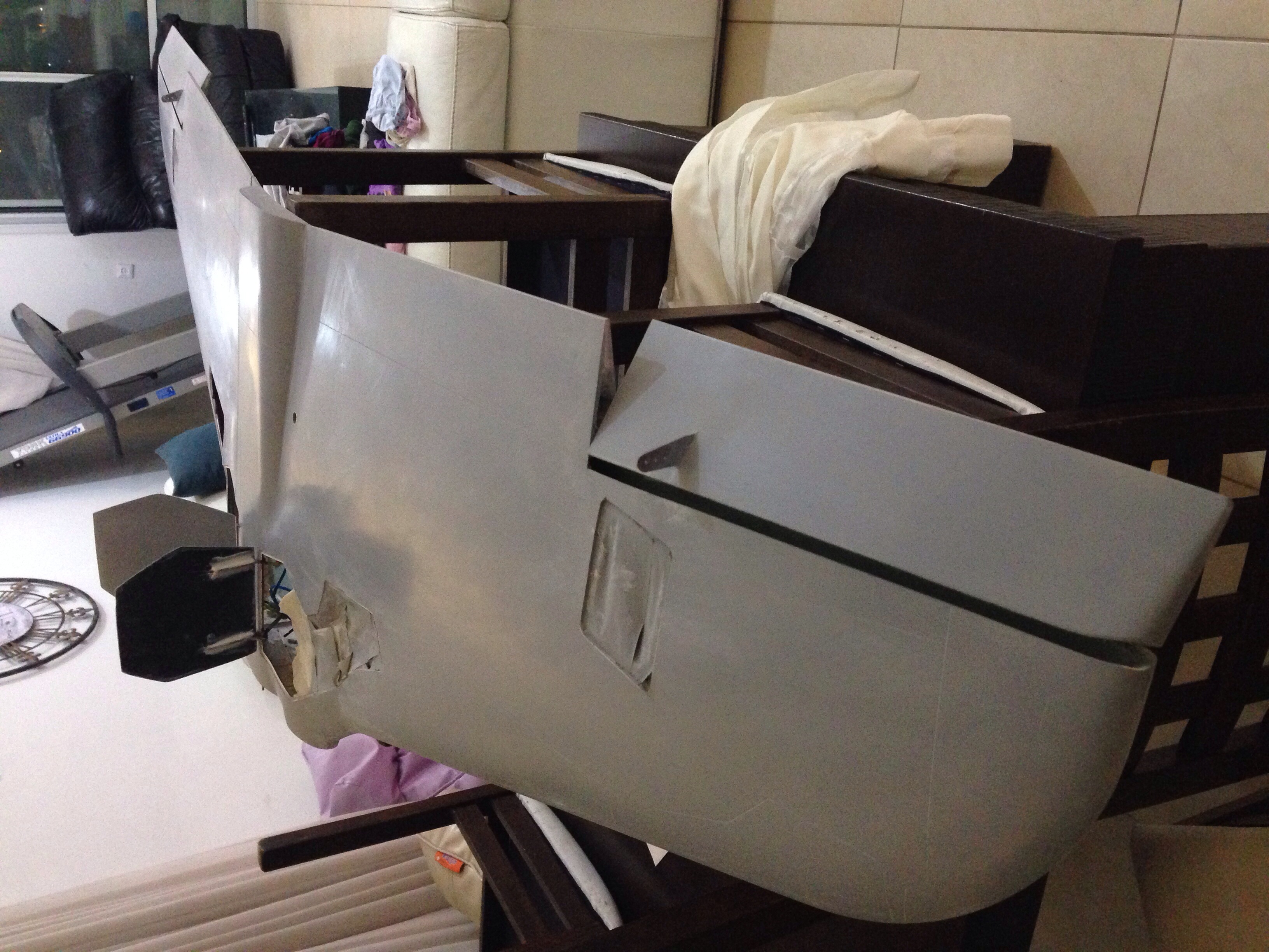

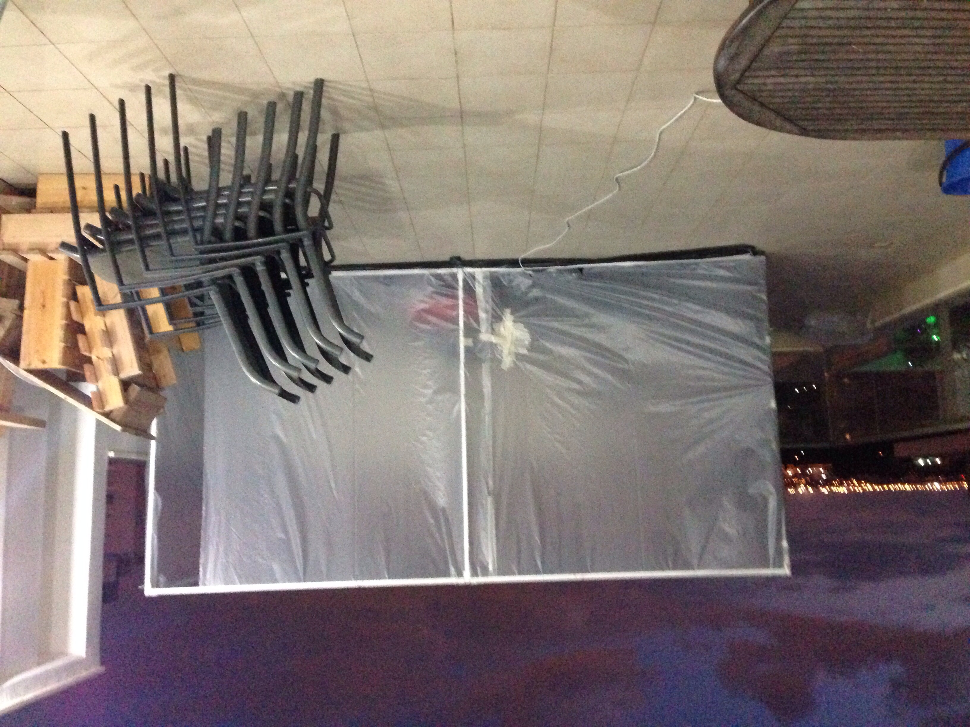

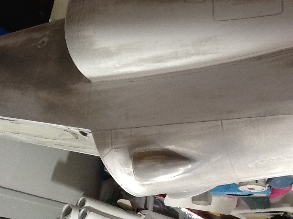

Started painting. Made a temp
painting room in the terrace. Wife was supportive
on went the primer.
Can anyone advise if I need to
rib down the primer with 400 or 800 wet
ID:	1943401   Click image for larger version

800 wet before paint should work out great. I used 600 and 1500 wet but in different areas and couldn't really tell the difference. That with CARF paint which flows and covers very well in one application.

Do I need to rub down the grey primer completely back to the white gelcoat before painting to save weight.?
if i do so would some parts of primer left be visible under the paint?
I will be using 1k paint( paint with hardner)
Old 11-29-2013 | 05:22 PM
  #1661
fireblade5437's Avatar
Joined: Dec 2005
Posts: 974
From: Leicester, UNITED KINGDOM
As Husafreak has said 800 will be fine with water, I only use 2k primer, which had to be mixed especially as I needed to use white to achieve the correct brightness of red on the 2010 Display.
Also if paint has hardner then it is 2k as it is 2 component, 1k is just one component i.e. the paint.
You don't want to 'plaster' the primer on, with the 2k primer I shoot one light coat followed by one wet and leave to dry. When sanding yes I take off as much as possible but you have to judge when to stop as you don't want to go through. If you look at some of the pics of the tail plane you can just see some of the original below the surface but I did not go through etc
When rubbing down the gelcoat I would have used around 600 grit to get a good key onto the fibreglass, there are special fibreglass primers that are flexible and provide a key for following primers, this type of primer is a very thin clear coat and I have used in the past when using 1k primer on glass etc but I have found the 2k primer which I use 700Ti if keyed it sticks like glue, its awesome and you have seen the finish with 2k over the top, preparation is EVERYTHING!
Also if you are using 2k or 1K for that matter use a air fed mask! I have heard of people waking up in hospital after using 2k with no mask!!! Not good for lungs!
Alan

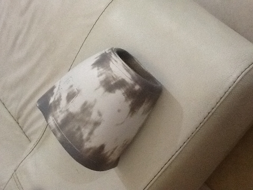

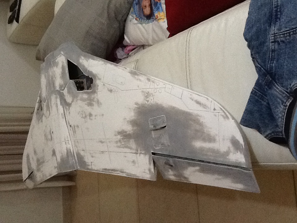

Alan hi
thanks for clarifying
i am then using only 1k primer and then 2k paints
I did put too much primer I think as some of the nice detailing panels has primer in them now and will make them disappear so I rubbed down quite a bit with 800 paper wet
pics attached
I ended up trying to fix that by sitting a few hours wig a small fine needle scraping away the primer in those panel lines
I have note done the fuse yet so how do I get a light enough coat to cover yet not fill those panel lines ???
What red color are you using as you mention needed a special primer mixed to have the red brightness come out correctly. I am using bs381c 538( cherry red) which is the color code for the red on the 2012 display. Last thing I want is for the color not to be correct after this first project
thx
izzy

Would this be ok for base or would I need to go one more round. The body is smooth.

May i ask how did you make those chairs and other stuff stick to the ceiling of the room?

Not so much a special primer just that the paint guys I use had to mix this up white as usually light green or grey. With any bright red, yellow or fluorescent white primer is way to go. Bright reds like the one I am using are very translucent hence why you need white undercoat.
I would recommend that you use a white primer and your red will turn out fine as the 2012 is a bright red as well.
With regards to your question re the primer, 1st is to mix it to correct ratio with thinner if not in spray can, I prefer the 2k with a little more than 10% thinner typically around 13%, spray light coat, don't try and cover everything straight away you will put it on heavy and have possible runs. After the light coat I allow a few min to flash off then do one good wet final coat, don't be tempted to keep going over same bit! If a bit needs redoing wait until dry wet/dry then spray over area again just enough to cover then wet/dry when dry... You will get use to it and it will feel right once you get the practise in..
Alan
