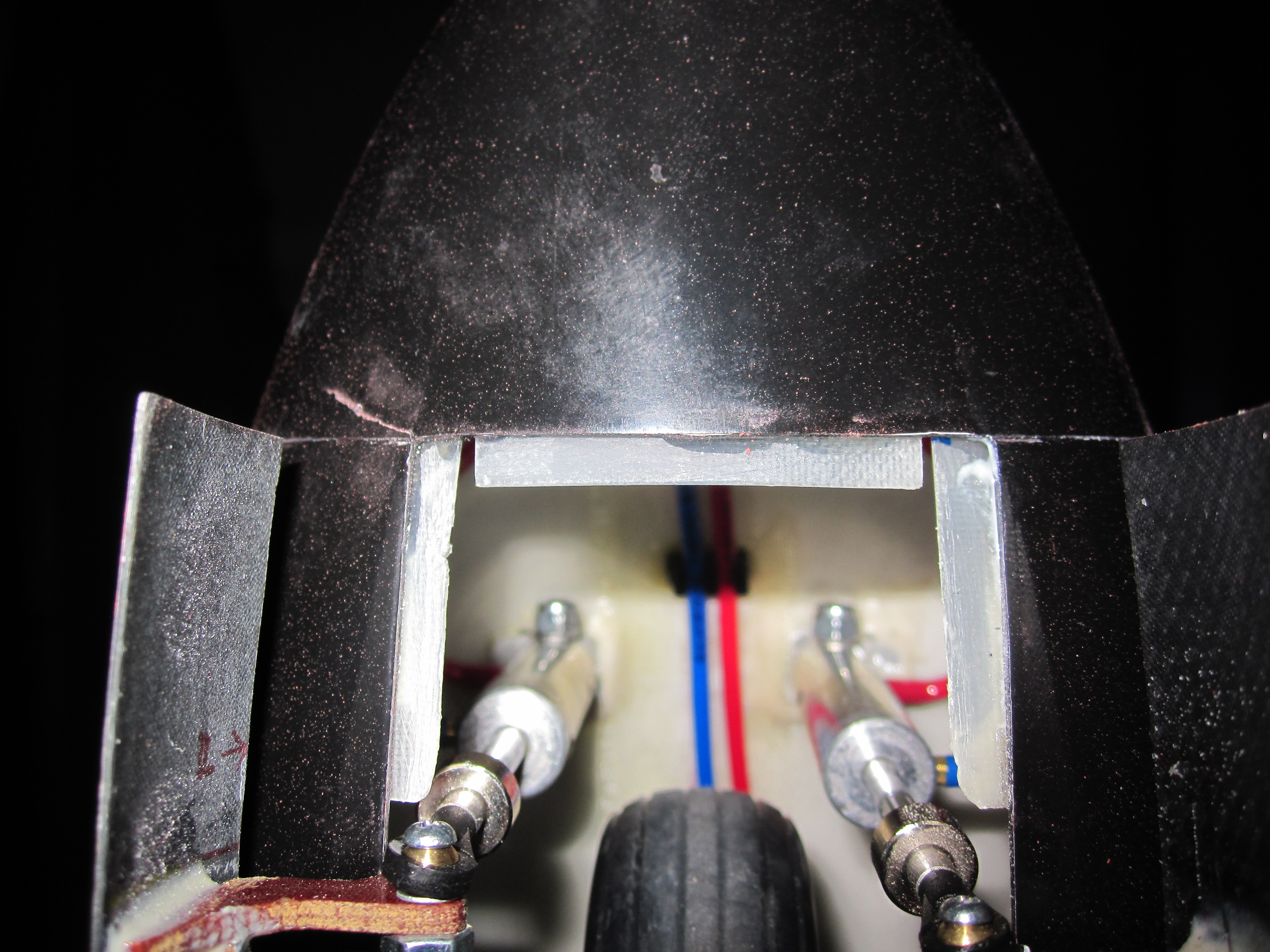

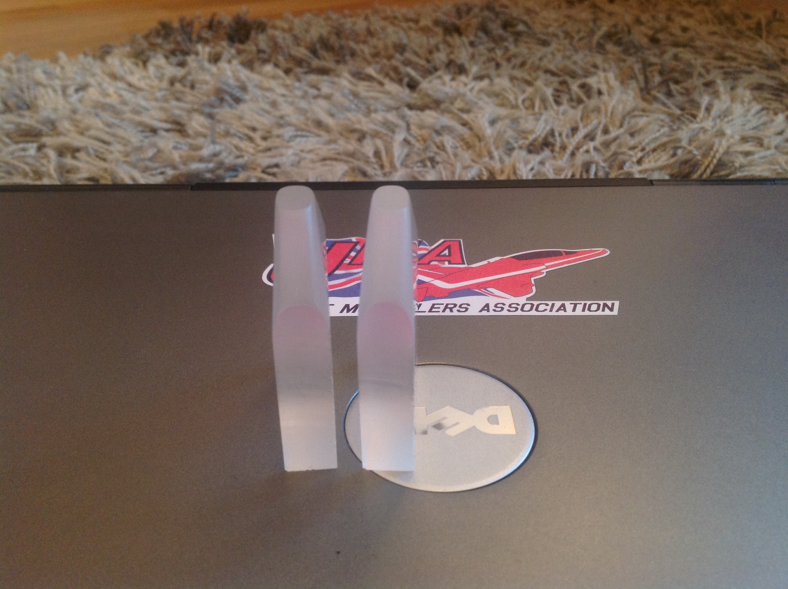

Can anyone show me how they mounted the air rams for the front gear so that they are removable I case needed
i have chosen the 2 door option
thanks

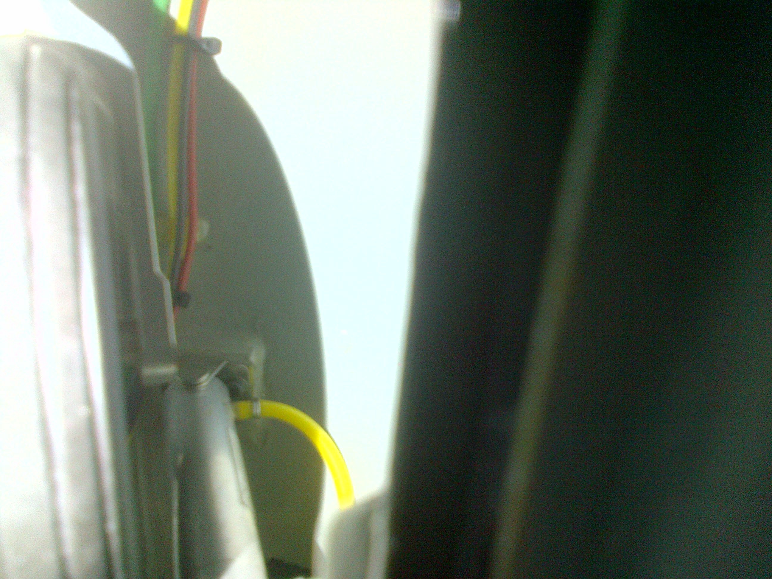

I know pic bad but all I can do at moment, I used 2 or 3mm fibreglass board (cannot remember thickness) but I used Hysol glue to glue two nuts on back on board then bolted ram bracket to the fibreglass board then using Hysol glued the whole assembly into position. Once dry I just use a Allen key to remove the bolts leaving plate and nuts in place, this makes it easy to fit the bolts back in when re-fitting ram assembly. You can only see one cap head in picture but you get the idea!
2nd pic shows the door assembly which is ran with small Hitec MG thin wing servo, there is a pic of this way back in thread that shows it clearer.
Most of work probably about 99% of what I have done is on the thread and of course all the other guys have posted pics of what they have done as well. Might be a good idea to spend a evening going through the pics
Alan

Errr...You pop the C clip off, the pin comes out and the rams follow? ;-)
A large flat screwdriver is all that is required-though my 4 year old Hawk has never had the need. Robart rams spec'd are just about the best available...
Dave

As Dave said cylinders are very good, yes you can take C clips off but a damm sight easier to just remove two small cap head instead of C clip I guess depends if you have small hands
Alan

Yeah, I replaced the C clips and pins with screws and nylock nuts. No biggie either way just looked like it would be hard to get at the c clips with my big meaty paws. My cylinders just sit on a blob of Hysol.

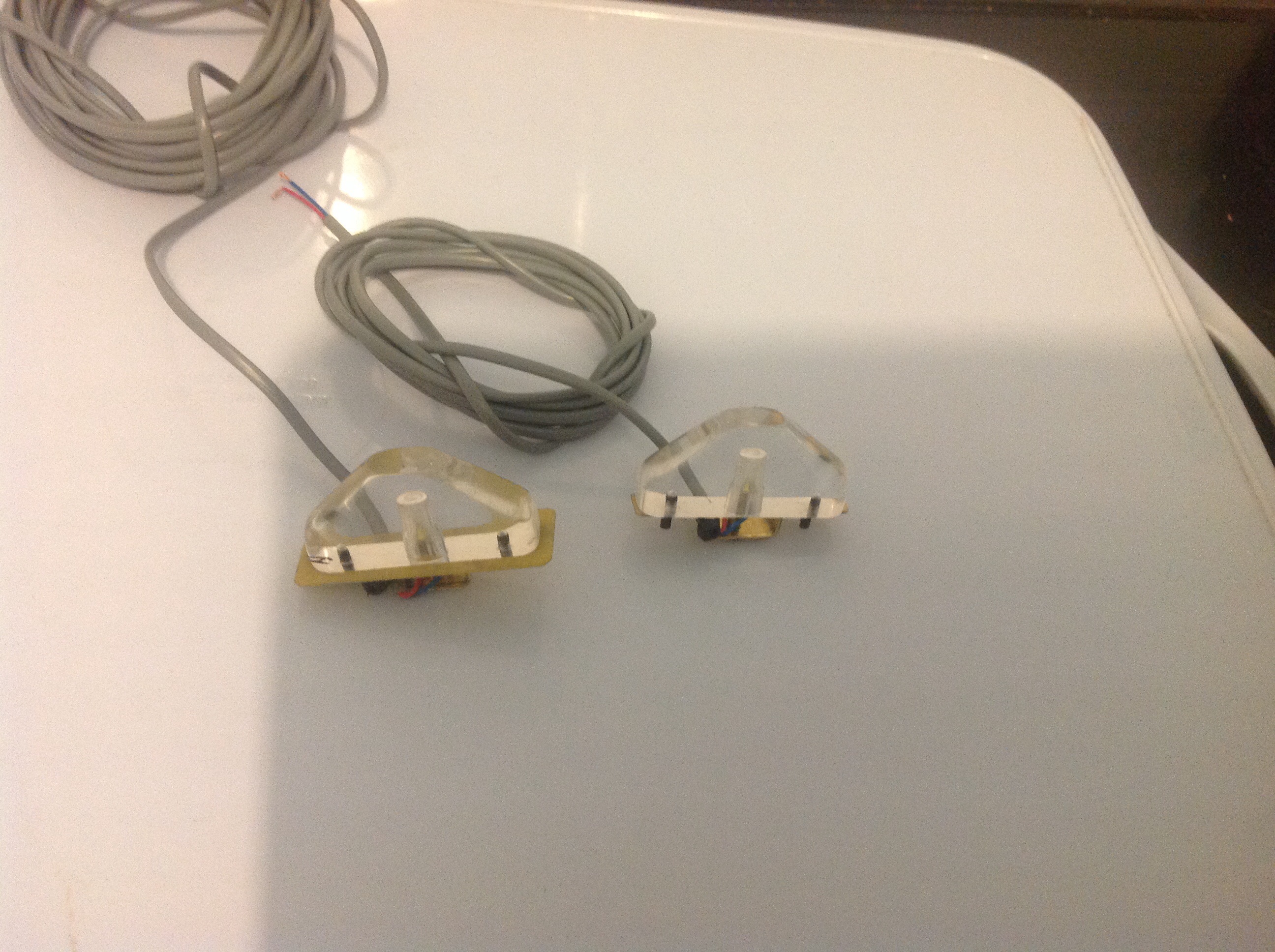

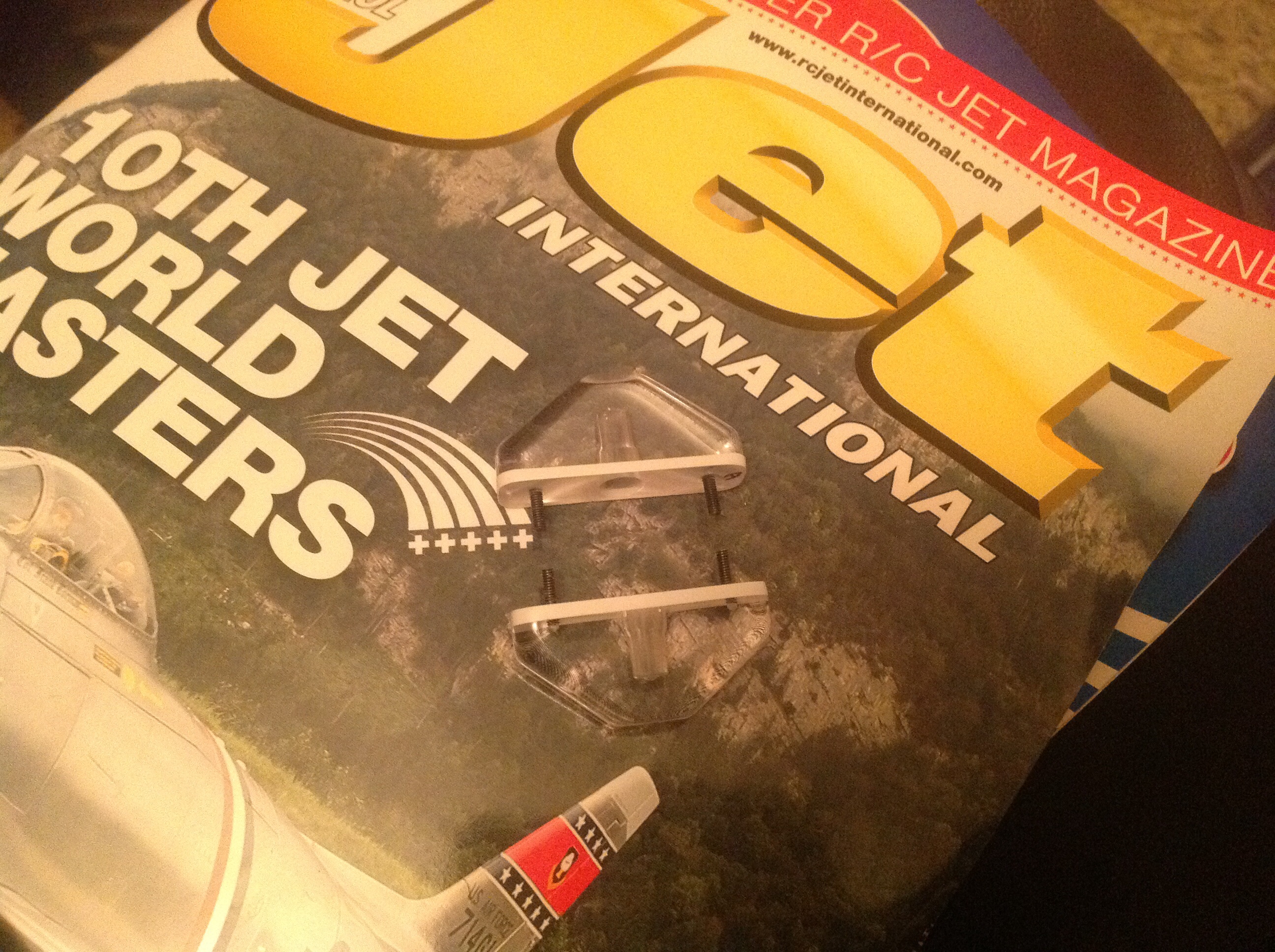

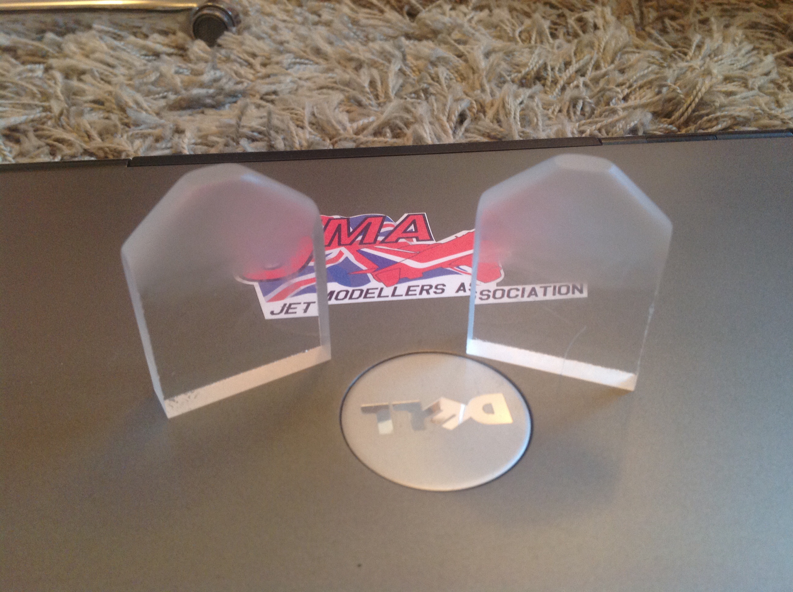

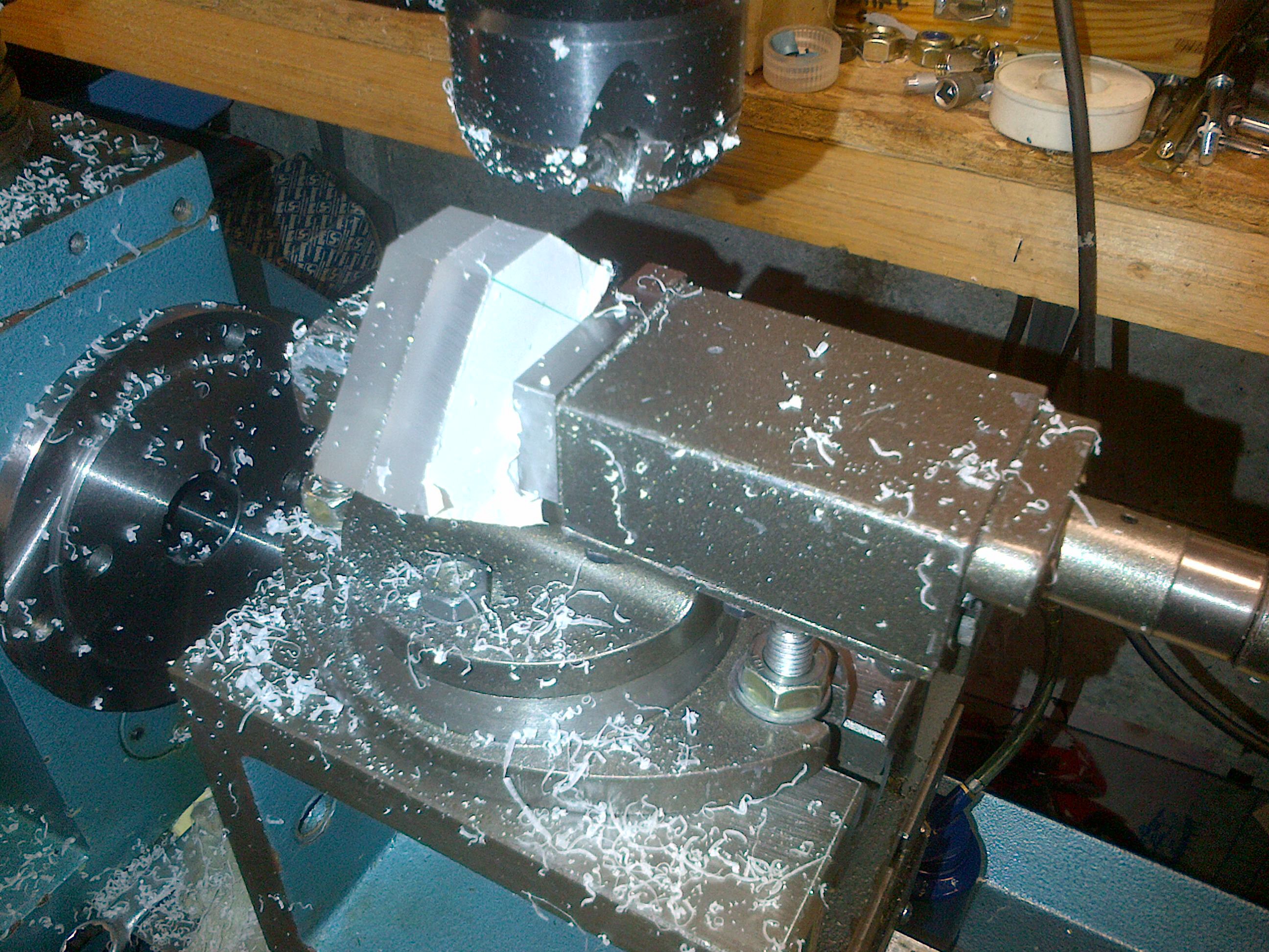

Bob

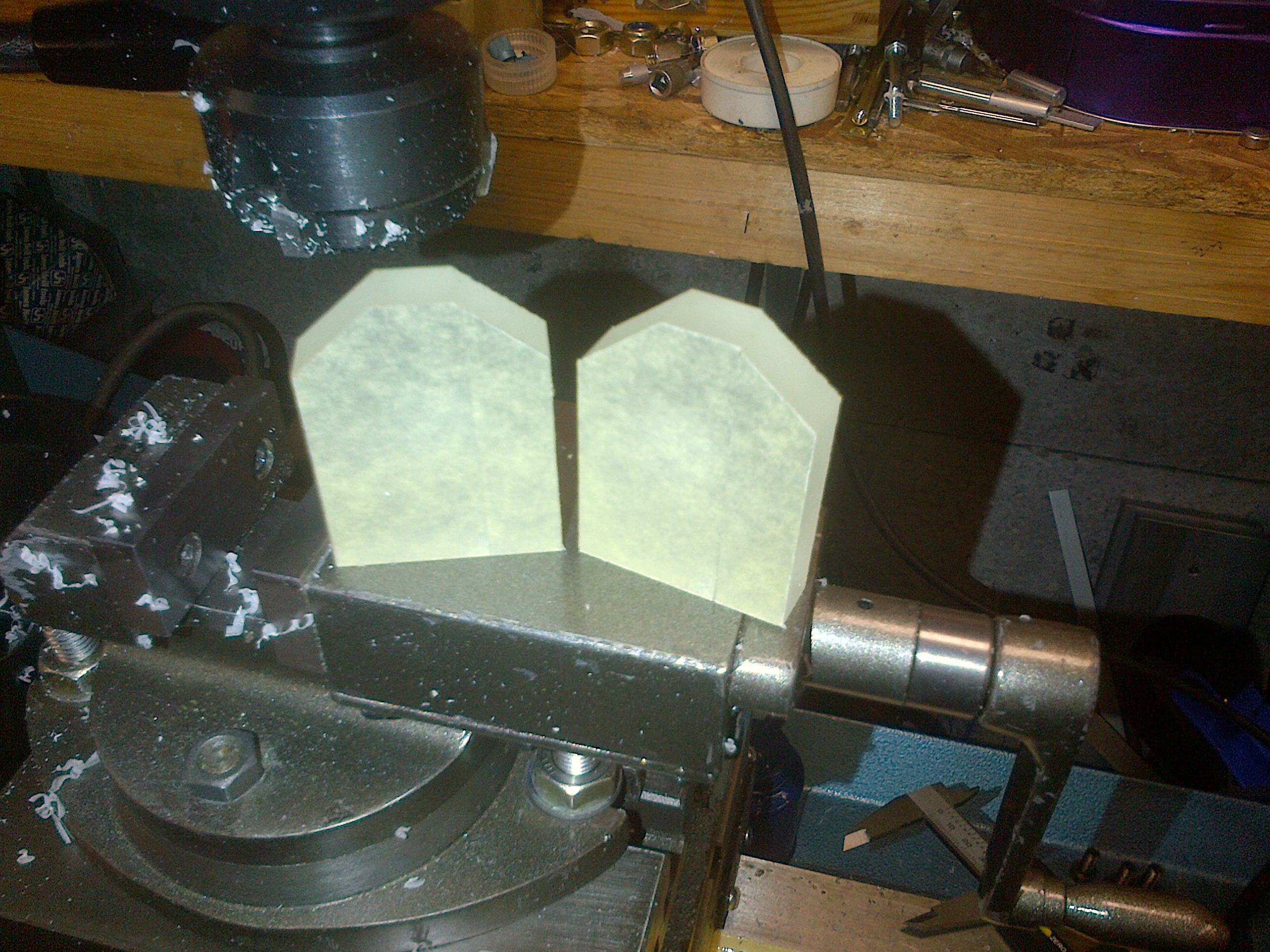

Have got your strobes underway...
All finished, will be in the post for Saturday...
I will be making some more PCB's for the lighting system towards the end of November if anyone else requires them, I know a bit later than I expected but I had a new garage roof to put on...
Alan
