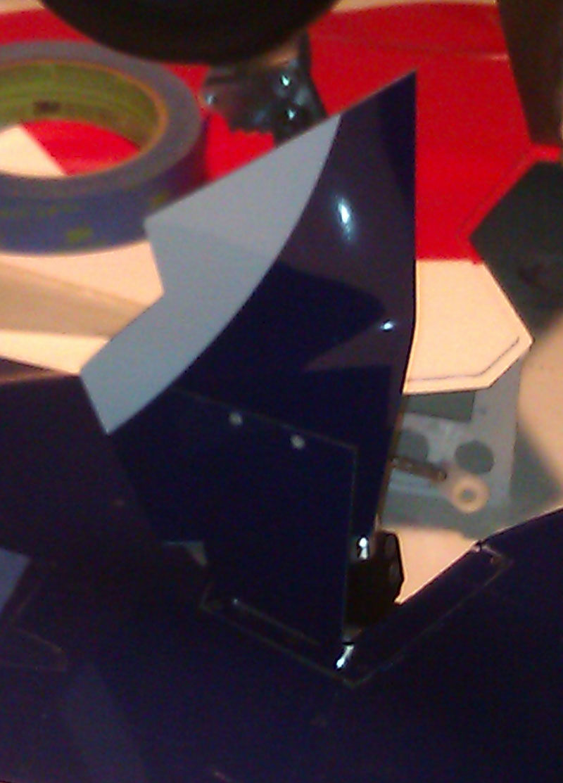

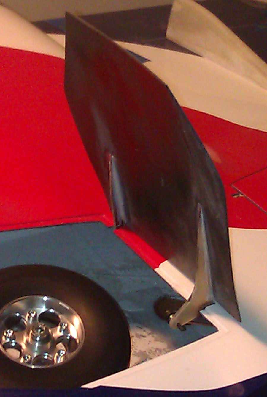

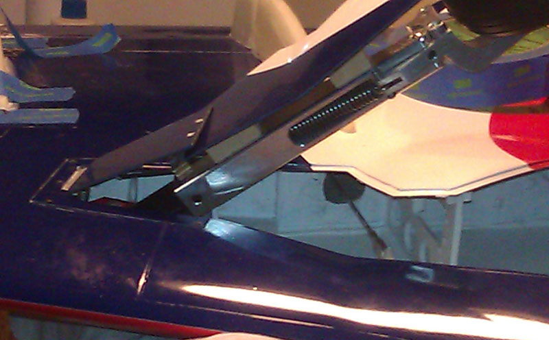

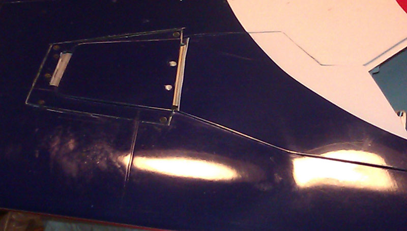

I posted before how I cut a larger hatch to get at the landing gear screws. It made installing the landing gear with proper blind nuts MUCH easier.
Having done so, I wanted to see how difficult it would be to make the outside doors actually operational. It turned out to be fairly easy.
The outer doors are hinged to the hatches I cut out and the entire assembly screws into blocks on the wing skins so that they can be removed to service the gear.
There is a tapered plywood piece glued to the back side of the middle gear doors that push the outer doors open when the gear come down. The outer doors rest on this piece when the doors are closed.
There are two small rare-earth magnets embedded in the outer doors and the tapered plywood piece to hold the outer doors closed when the gear is up.
There is an elastic cord between the middle doors and the outer doors that holds the outer doors against the middle ones when the gear is down and pulls the outer doors closed when the gear goes up.
Bob

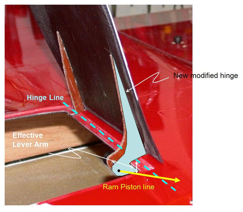

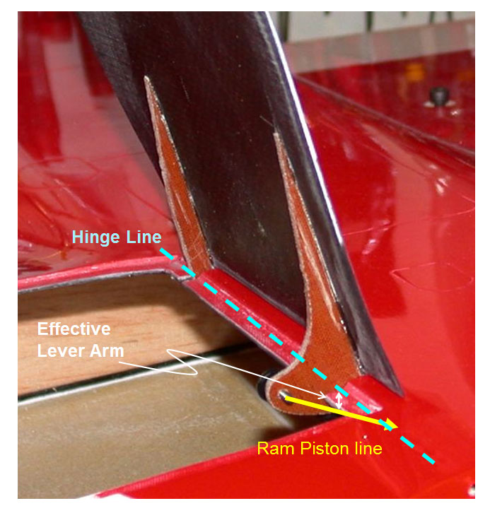

Dave,
The problem is not holding the doors closed once they are closed, its getting them to close once they are open and the air stream catches them.
The on doors I have seen where this is a problem, they open up so far that the attachment point for the door rams on the hinge is essentially in line with the hinge point when the cylinder is fully extended and the door is fully open. Thus the door rams have, in effect, no leverage to pull the doors closed from the open position - the ram is essentially just trying to pull the hinge wire off its mounting.
This could be solved by moving the ram's attachment point further outboard so that the doors do not open as far and there is still some leverage to close them. My modified hinge/door lever adds a bit of extra help to this problem by making the lever arm longer, *and* moving the attach point lower into the wing when the doors are fully open.
My mod is probably not necessary if the door hinges and rams are positioned properly, but I wanted to make sure that they worked and I didn't have to fuss with them in the future...
Bob

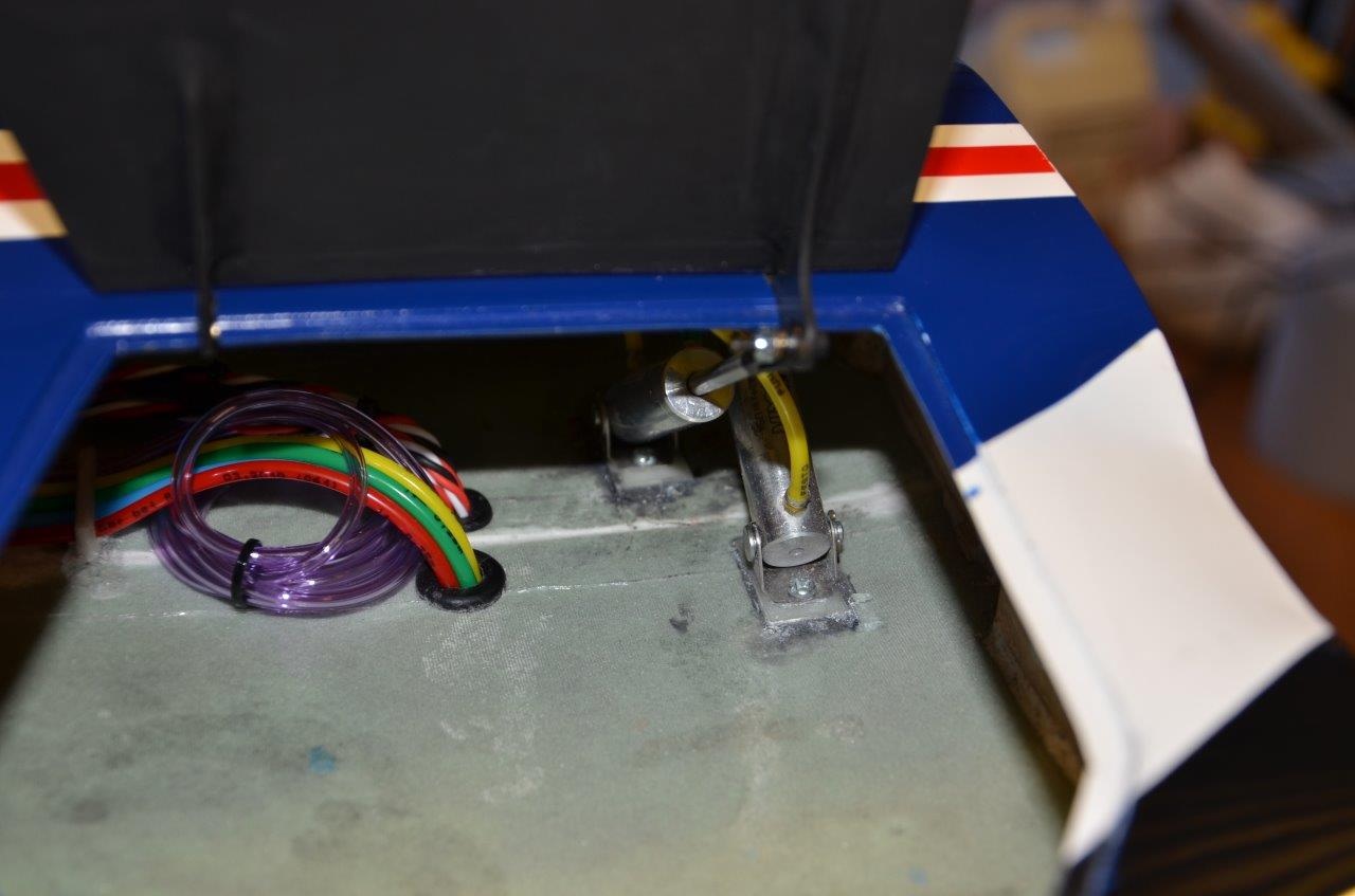

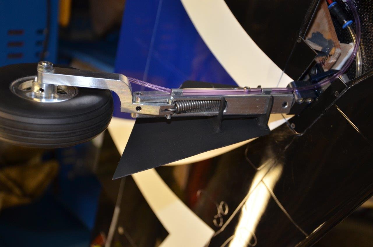

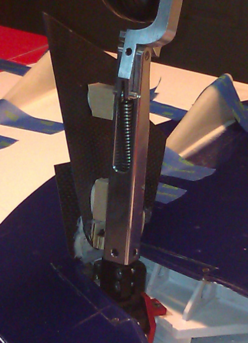

Did mine the same as Dave and as long as you are not doing Mach 1 then the wheels go up nicely and the doors stay up
Also I remade all the hinges making them out of thicker fibreglass sheet
Forgot to say my doors are at 100psi and legs are at 120 psi
Some pics how I fixed the doors to the legs as well
Alan

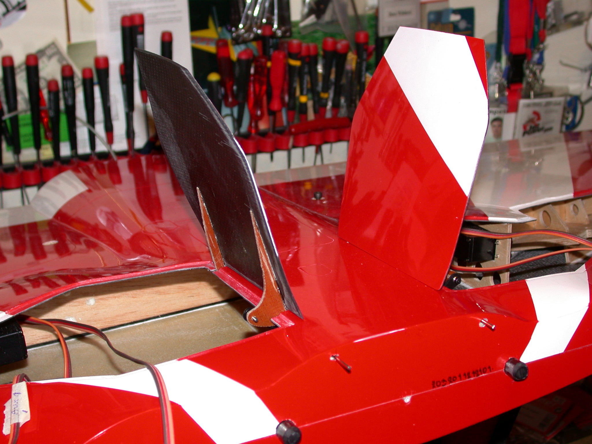

Dave,
That is very similar to what mine look like - in that the hinge is setback well from the edge of the opening and the door doesn't open too far. Even so, you have a fairly small effective lever arm to move the doors closed.
Now image if the doors were mounted with the hinge line closer to the opening (more to the left in the photo) and the door was allowed to open more. First, the door ram would actually be touching the side of the wing skin (I've seen that in an installation), and the lever arm would be even smaller.
So what I did was make a (slightly) modified door hinge that puts the ram piston attach point further out and down into the wing when the door is open. Likely not necessary, but I have *very* positive door closing leverage that should be able to overcome almost any air flow... Just a bit of insurance and I figured that while I was at it, why not?
Shown installed...
Bob

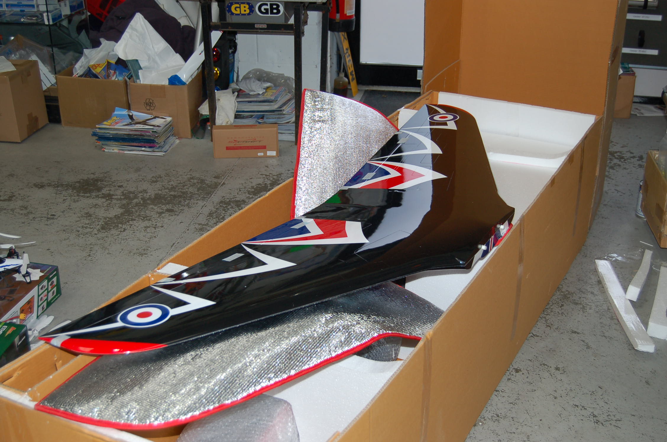

What you have done is obv fine and improves what we had, still not seen a single Hawk with an issue closing the doors over here, but yours can work against any operation airspeed :-)
Today another Hawk kit arrived from CARF, my unit now has four 2010 schemed Hawks in it, one SG and three 1:5.5, the EDF and now two for turbine P-140RX...need to talk the next guy out of this scheme :-)) Least the SG kit leaving Germany today is white...unfortunately I think the owner is going to have it painted...in 2010 scheme too!
Dw

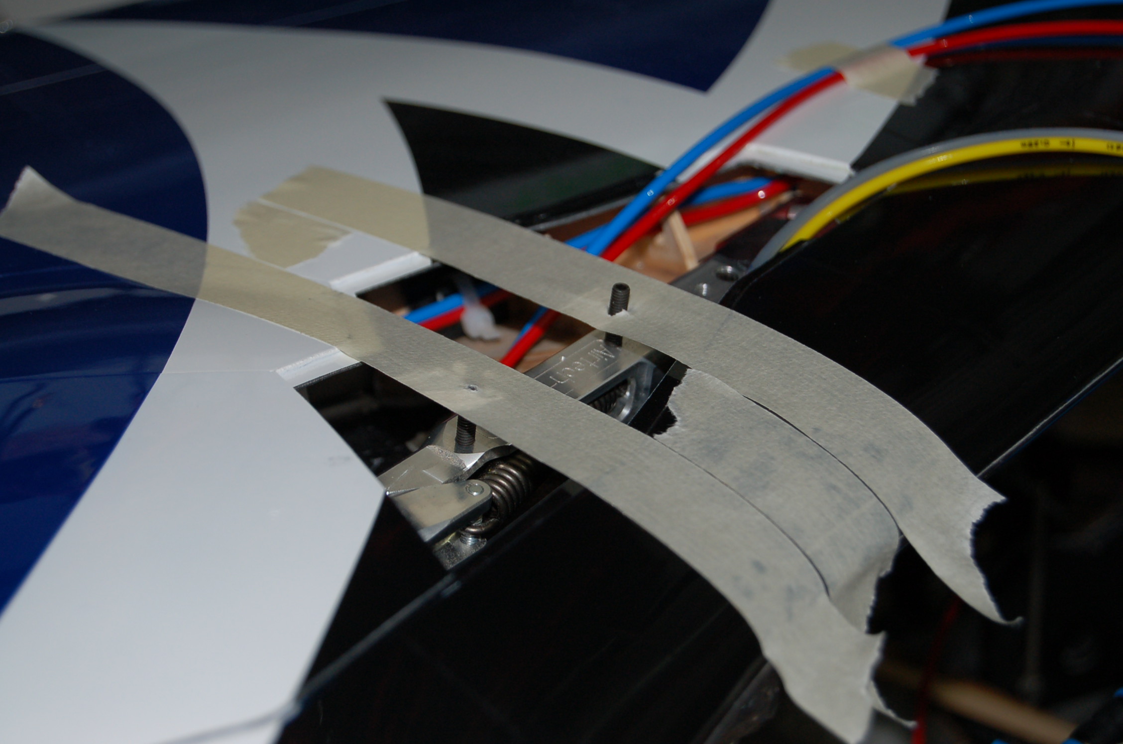

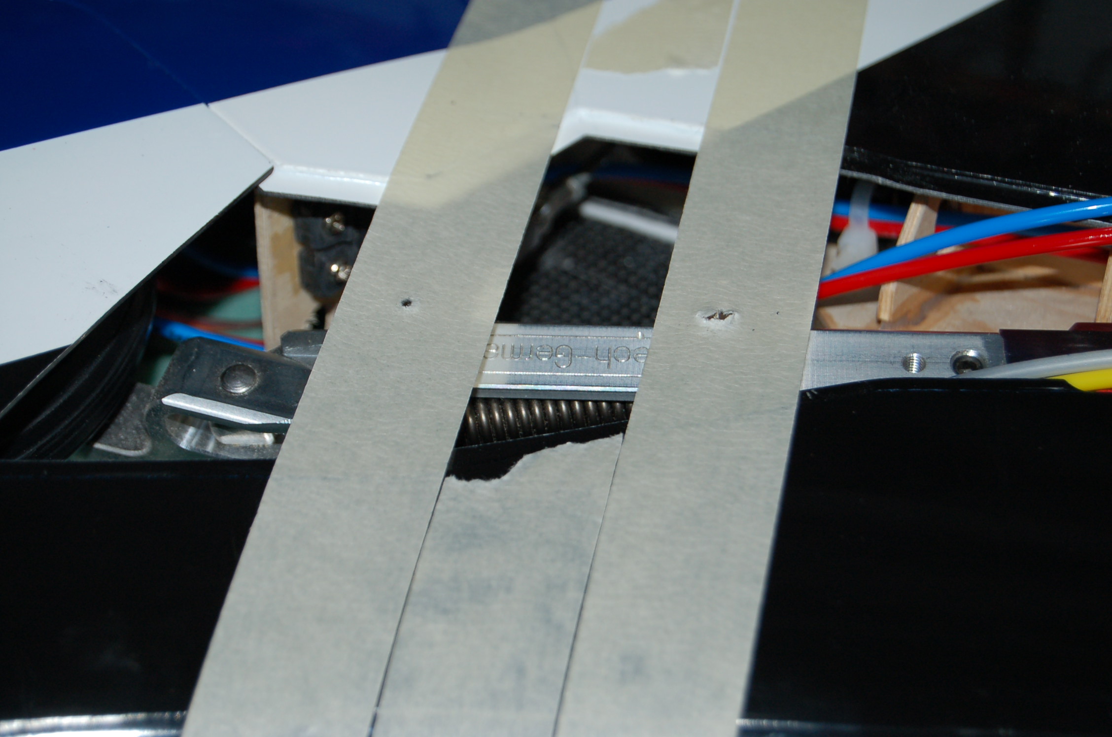

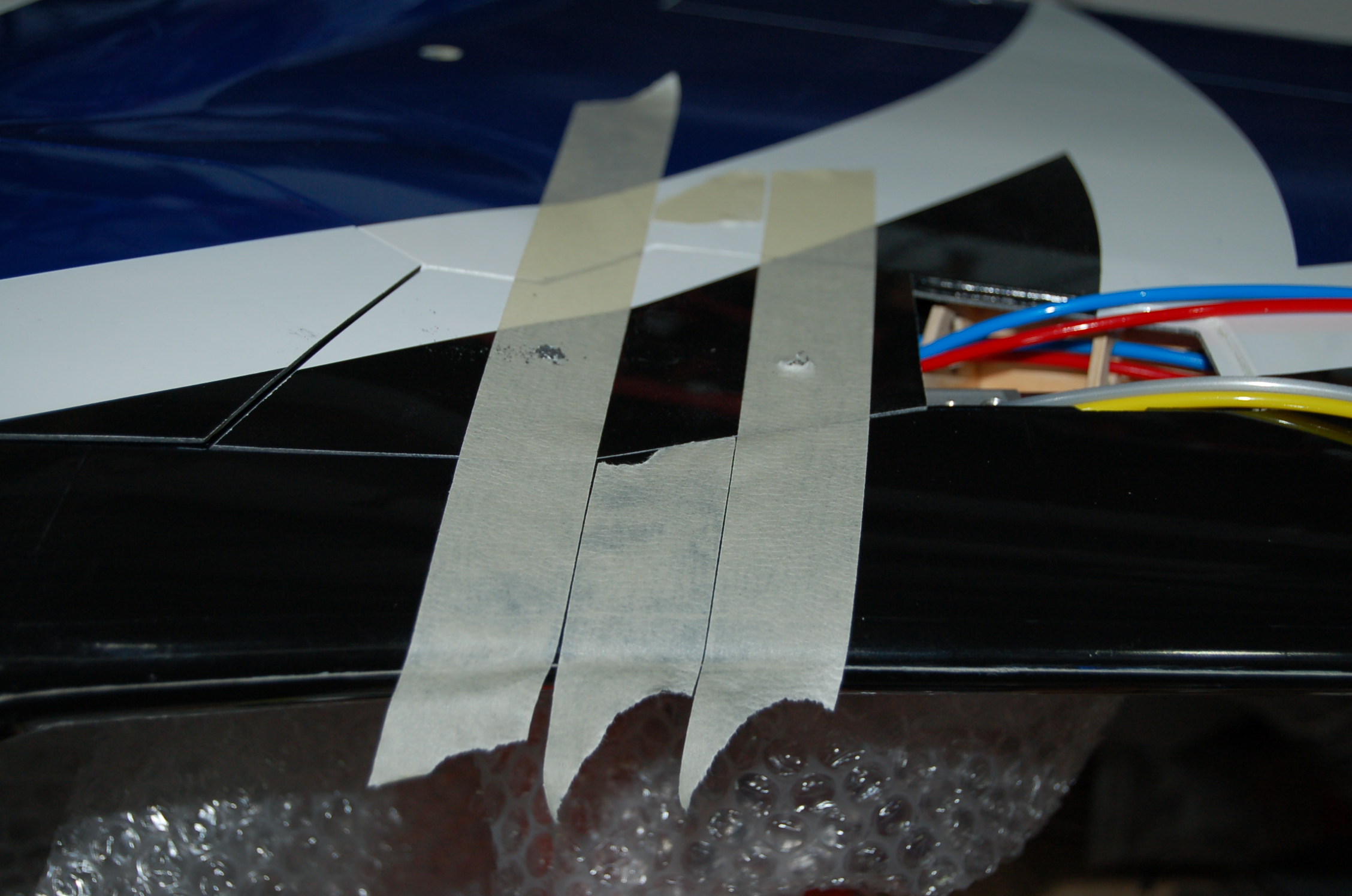

All this talk of gear doors saddled me with another 2010 Hawk to do for a customer. While I was doing it thought I'd show how I do main leg doors. Pics hopefully explain much of it. The extra tape is to position two strips that are peeled back after finding the set screw marks.
Std masking tape is perfect width!
Dw
