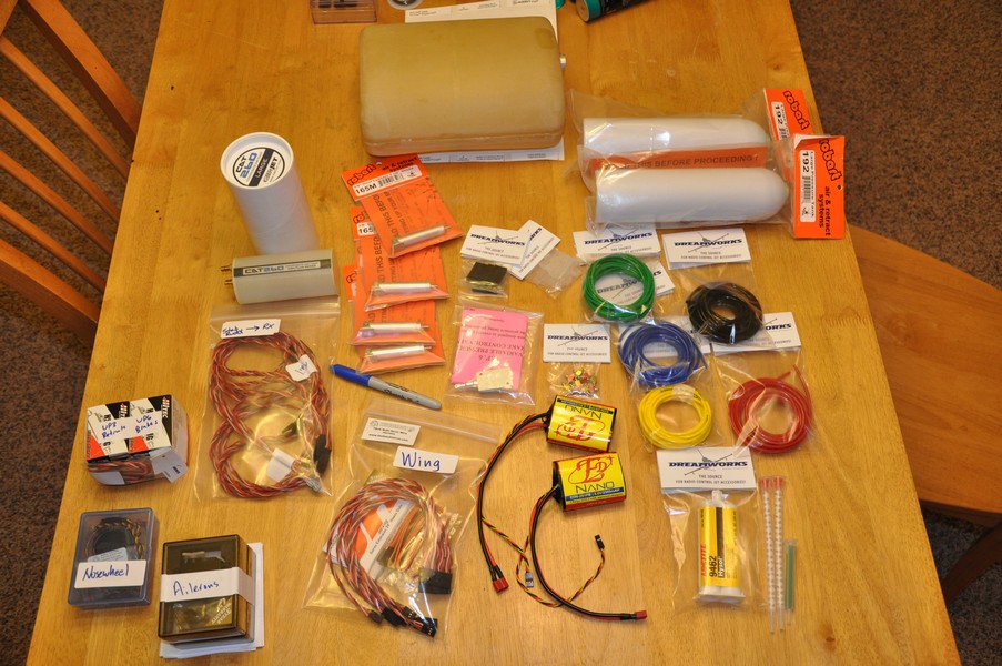

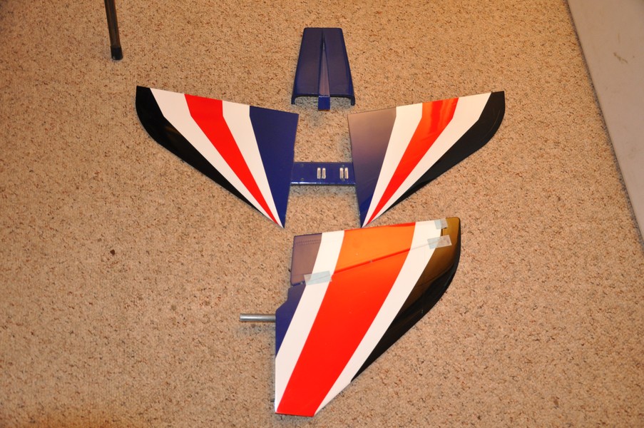

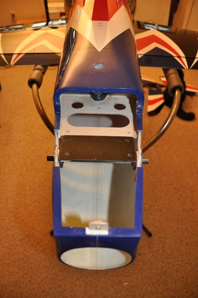

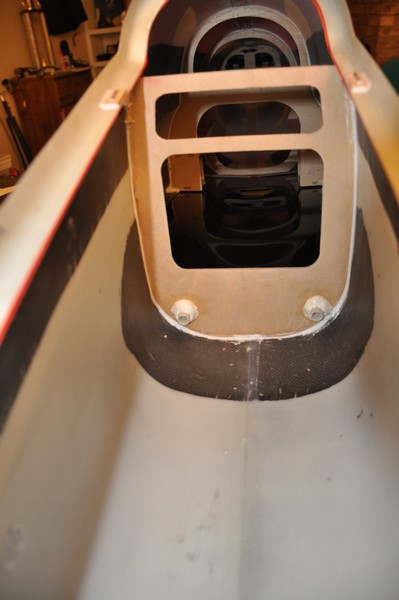

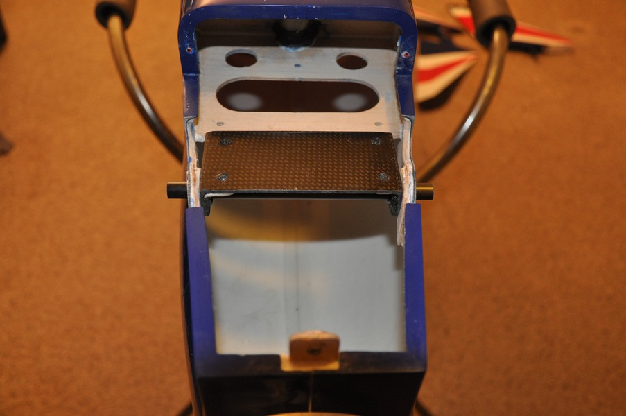

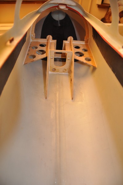

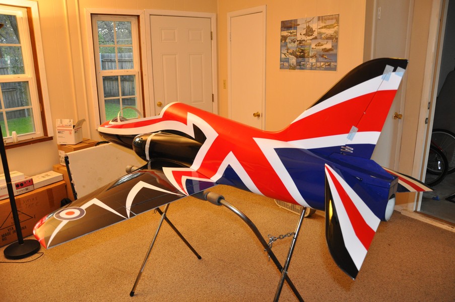

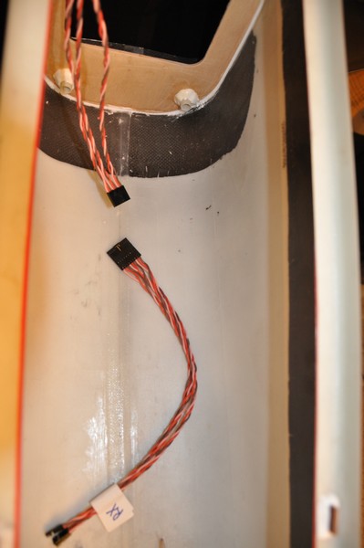

Still amassing items for the assembly. Will be heading to Wichita, KS in two weeks for B-1 Bob to do a quick build on BobTV

Is your vertical stab spar aluminum?
Old 11-10-2013 | 07:27 PM
  #1612
husafreak's Avatar
Joined: Dec 2004
Posts: 1,205
Received 50 Likes on 42 Posts
From: Livermore, CA
Looks familiar... I liked the shot with all your goodies spread out. Who makes those great servo extensions with the big block connectors? Those are cool!
Old 11-10-2013 | 08:27 PM
  #1613
smitty1001's Avatar
My Feedback: (29)
Joined: Jun 2002
Posts: 1,962
From: River Oaks, TX
Thunderbolt r/c - Todd has them
Smitty turned me on to those also, they are awesome
Old 11-11-2013 | 04:59 AM
  #1615
rhklenke's Avatar
My Feedback: (24)
Joined: Jun 2002
Posts: 6,005
Received 34 Likes on 21 Posts
From: Richmond, VA
Get some Ashlok connectors, wire, and a crimping tool from Todd, and you'll never have to buy a servo extension again - and every one is exactly the length you need.
http://www.dreamworksrc.com/catalog/Ashlok-176
You can get the unassembled JR connectors from Todd too so you can make ends that plug into the servos and RX:
http://www.dreamworksrc.com/catalog/...Set-Jr-%284%29
The same crimper as the Ashlok will work for those too.
Bob

I usually make up my own extensions, (unless Servo City is doing a sale), those JR connectors are pricey though. I wish I had seen the Ashlok connectors, of course I just ordered from Dreamworks a few days ago... It looks like I can use my el cheapo crimping pliers with the Ashlok pins, they look the same as regular servo connector pins. But the el cheapo crimpers are a fiddle to use, it is hard to control the pins until you actually do the crimp, are the expensive ones any better?
Old 11-11-2013 | 12:01 PM
  #1617
rhklenke's Avatar
My Feedback: (24)
Joined: Jun 2002
Posts: 6,005
From: Richmond, VA
You can get the "RC" type connectors for much less, in bulk, here:
http://www.hansenhobbies.com/product...rvoconnectors/
Keeping the pins on the wire until you crimp is sometimes a bit$#. You can get crimpers from Molex that hold the pin in place and allow you to insert the wire easily without dropping the pin. However, they are really pricey (> $200)
What I do is, hold the wire in the pin at the proper place, and then, using a small set of needle nose pliers, I squeeze the part of the pin that goes around the insulation just enough that it holds the pin on the wire. Then its easy to insert it onto the crimper the proper distance and do the final crimping. Squeezing the pin a bit like this doesn't effect the final crimping at all, but it makes getting the wire, pin, and crimper all lined up as necessary for a good, secure crimp *much* easier.
BTW, the proper crimper is an "all in one" that does the whole pin in one shot and has the ratchet release - like the one that Todd sells. If that is what you mean by an "expensive" one, then, yes, by all means, make that investment. Its much cheaper and neater to make your own in the long run.
Bob

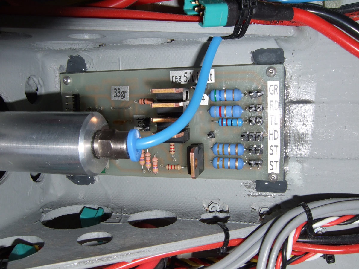

Ashlok are actually Molex, took me a whole evening to source the correct bodies and pins male/female also you can choose type of material that pins/sockets are made out of, I went with the 22AWG that are gold plated I do have all the part numbers saved. I get mine from RS components but you can get them from Digikey in the US. I have made my own connections on all my models since about 2004 never had a failure also use them for my lighting sets.
Alan
Bob
Picture of PCB note resistance for strobes @5.1v supply
Cannot up load any pics... RCU not working at moment..well not on my PC but iPad worked...

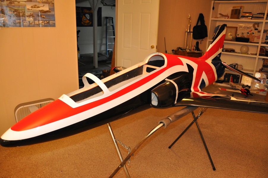

Time for more pictures as I had such a great day flying mine yesterday!
Taken by DW a few months ago - I just love it (pic and especially the model)

http://www.youtube.com/watch?v=MLHsYGiAc04 Bob
Think I already posted this but you get the idea of the two strobes, the reason I put the white rear LED in the centre was that the full size has it positioned to the right and I would not have had room for the 10mm LED that I used there is not a lot of room between fuselage and elevator, I guess you could squeeze in a white Rebel but again would need heat sink making. The heat sink assemblies that I make for the red/green are around 3.5" long
Alan

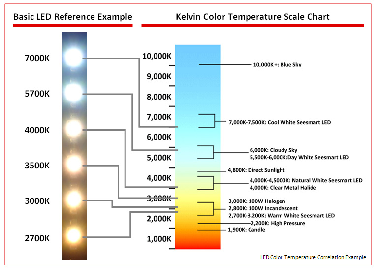

Alan,
That looks great. What temperature of white LEDs did you use for the strobes and the landing light? From this chart, 4100k looks fairly neutral. We bought some 5000k CFL's for the kitchen the other day and it made it look like a Dr's office - too blue...
Bob

Bob
The strobes if I remember right were around 5700k-6000K I will check on my invoices. Strobes are obviously not incandescent lamps so are usually a cool white which is normally up to 6000K, one of my orders I had to send back as the rebels were definatley not 6000k like they were advertised, in fact compared with my strobes they positively looked yellow, the strobes need to be a cool white. Now the headlight I had same problem, my headlamp in the video is a 6000k K2 which you can not buy anymore, I did try a warm white which is more off white but then again the full size lamp is incandescent but in the air the cool white just appears to stand out more. I am currently getting lists together of parts for more lighting kits.
Also some leds I'm not so sure that the temp rating on some are not strictly correct. 6000k is 6000k and some definitely vary in colour.... Well strictly speaking white and black are not colours
Did if you get my pm?
