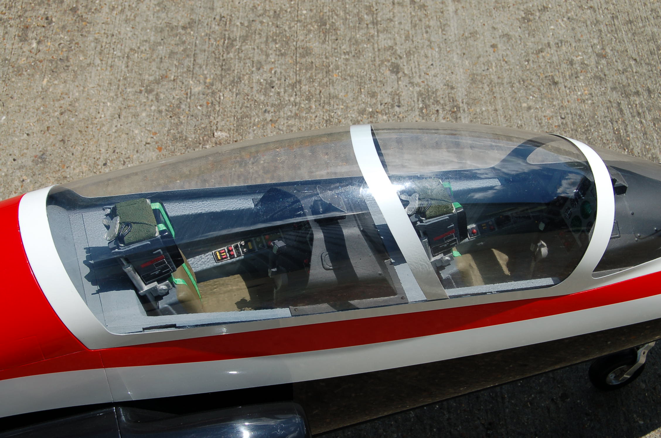

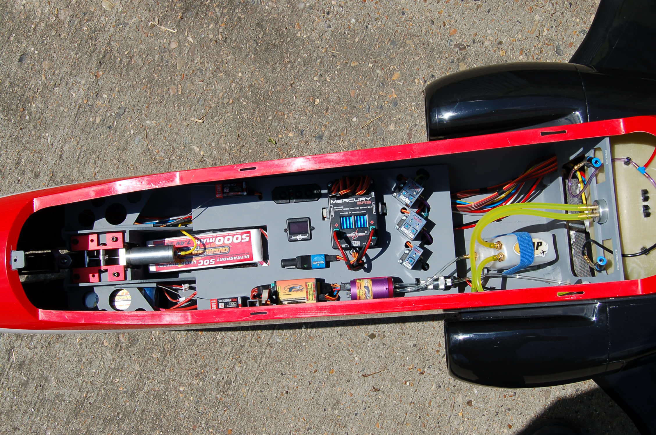

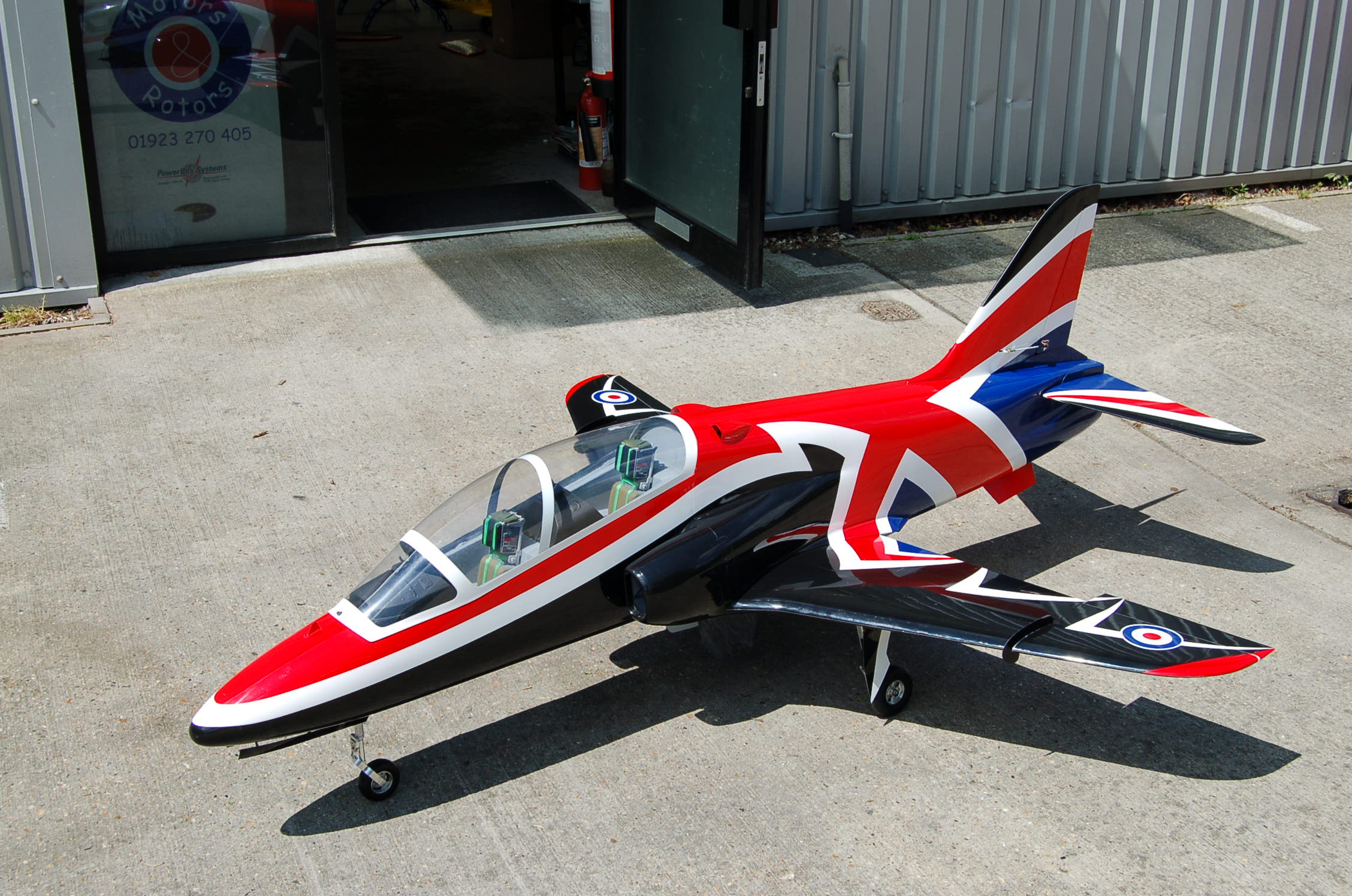

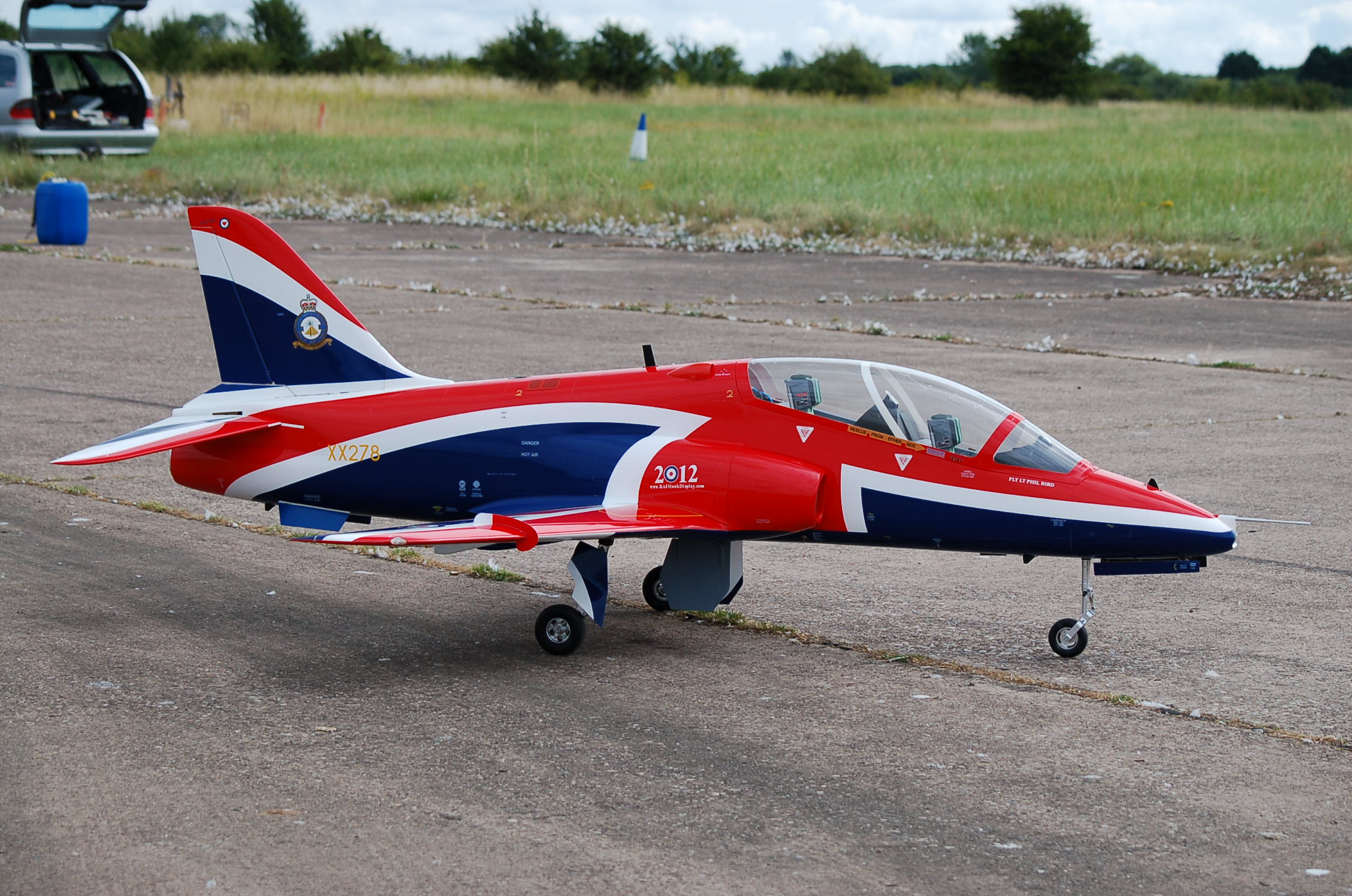

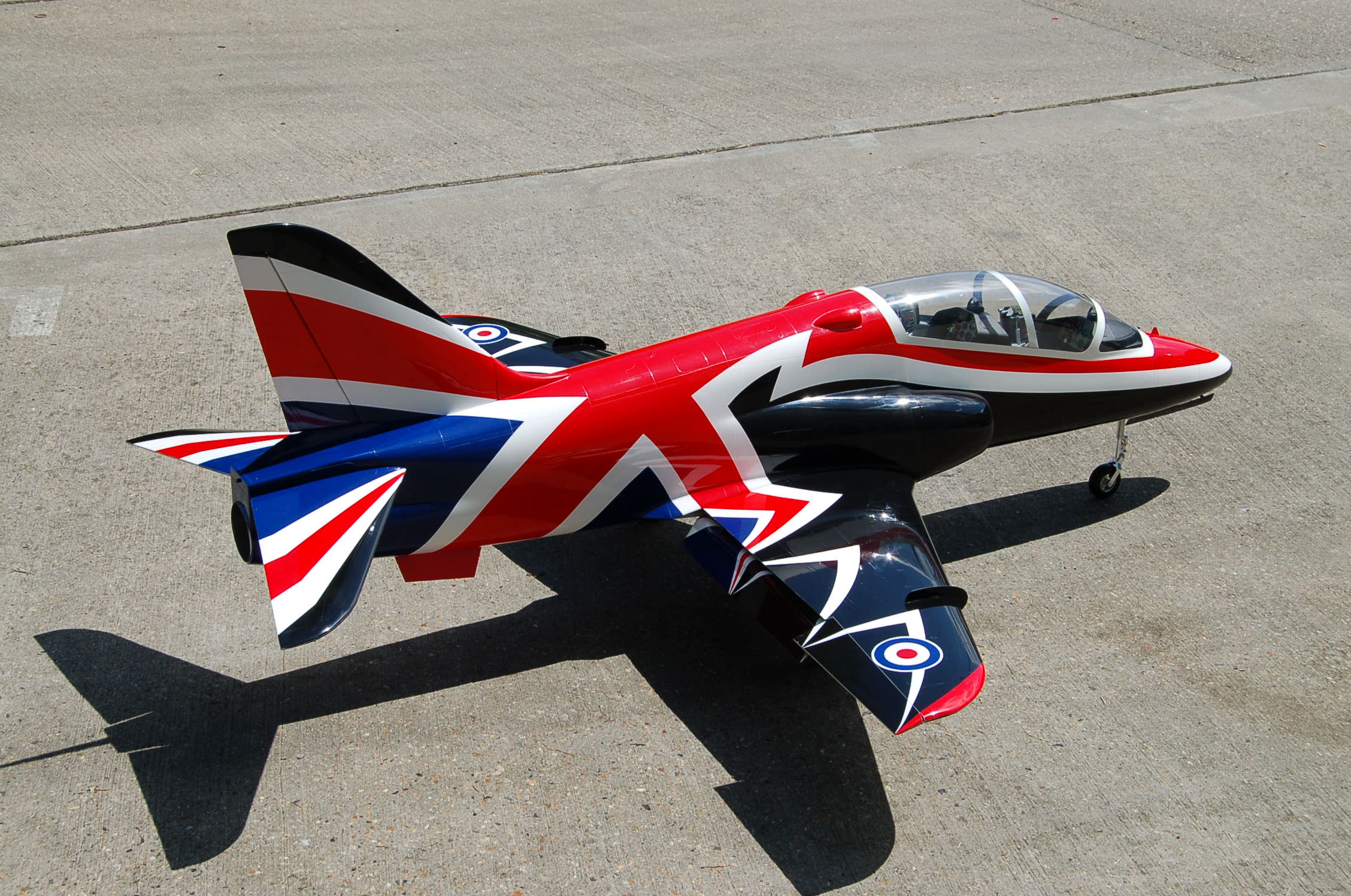

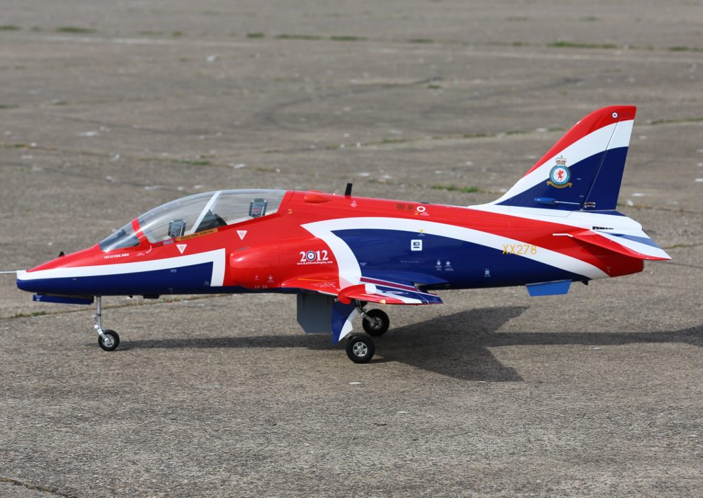

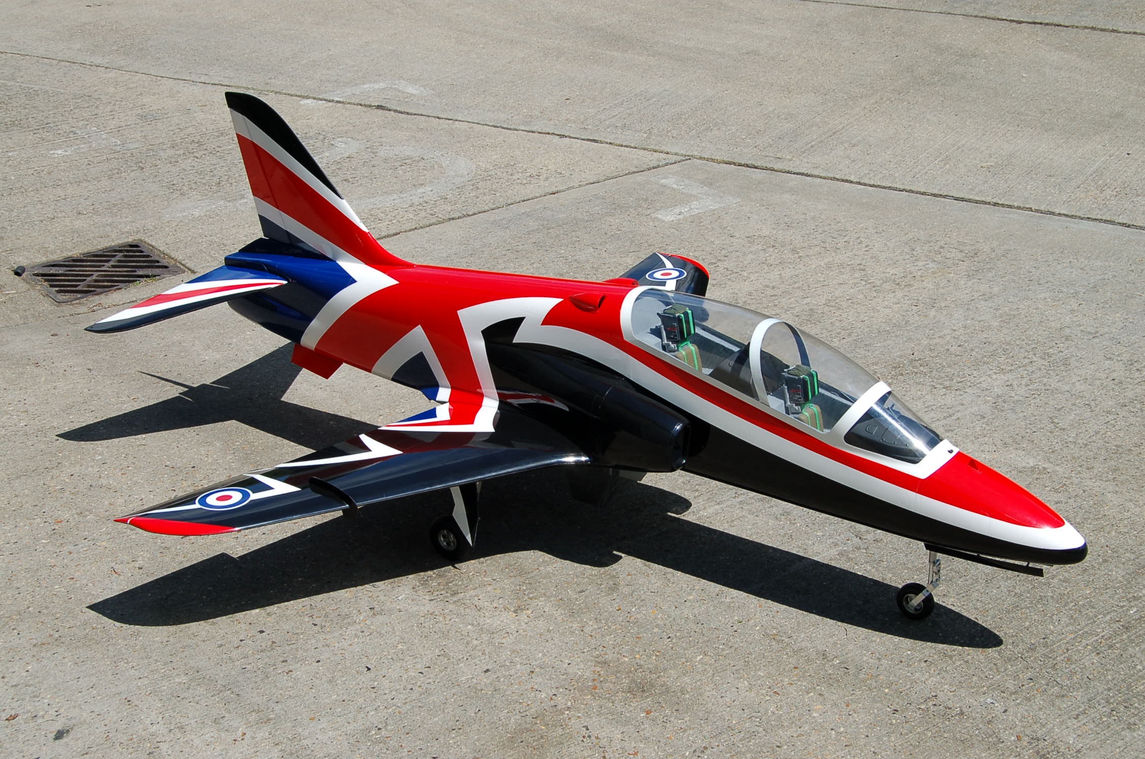

Another Hawk just finished for a customer, expertly assembled by M&R's finishing school expert Roger.
Tidy simple install with minimal bling to keep weight down, this has a PB Mercury with the gyros. Will be set up in a JR 28X and has a JetCat P-140Rx for power. Derjet cockpit, it will have the Tailor Made decals and det cord added soon.
DW

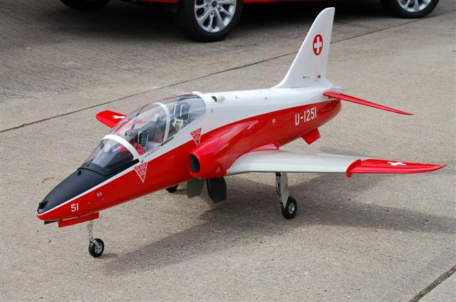

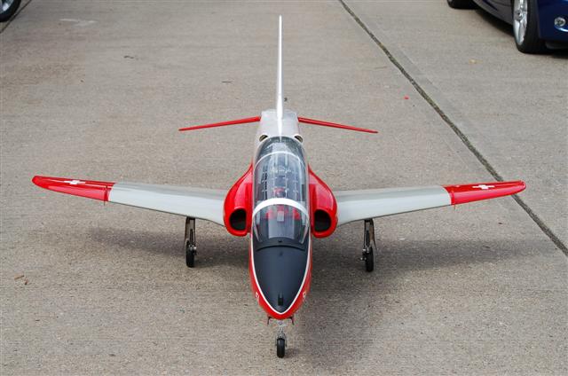

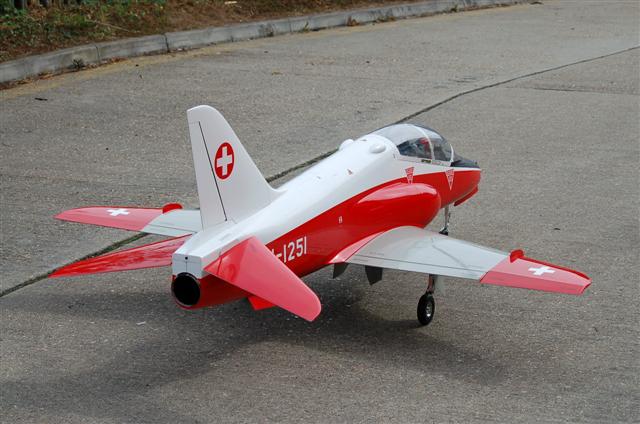

Another CARF Hawk is ready for operation at our local grass site club. This Swiss scheme version was again assembled by M&R's favorite builder Roger (this being the 5th he's done for us) Owner Sam is pictured with the JetCat P-140Rx powered model just after hand over. As always the final check over and turbine test was done here by me. Test flight is scheduled for a meeting we have next friday ( perfect timing before a trip to JetPower, so Sam can start thinking about what next ;-) )
JR servos and Powerbox Competition SRS, 18MZ Tx.

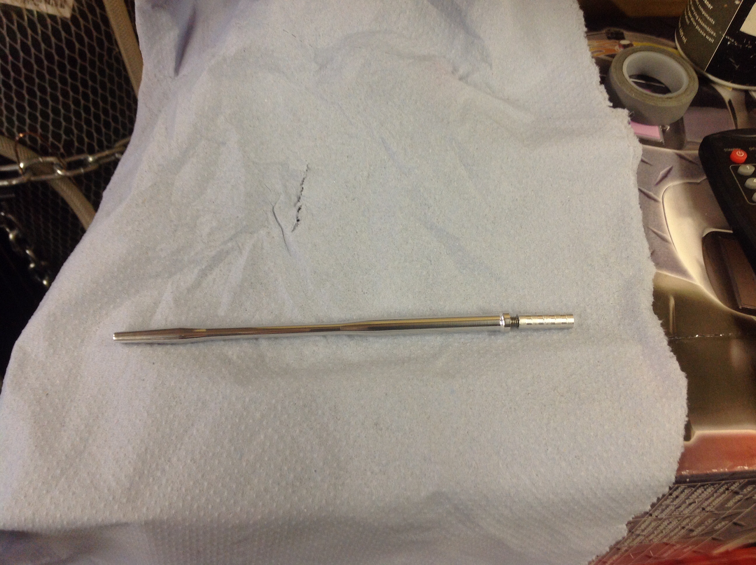

Originally Posted by fireblade5437
Bob
your new probe is in the post..
Alan
I'm getting ready to start a F B Hawk build and ran across this probe. It really looks great and was wondering if this can be made to order or information on how it was done. I had mine done in the Redhawk scheme and this would look awesome on the nose. Thank you for your time and any information will be greatly appreciated. Ken
