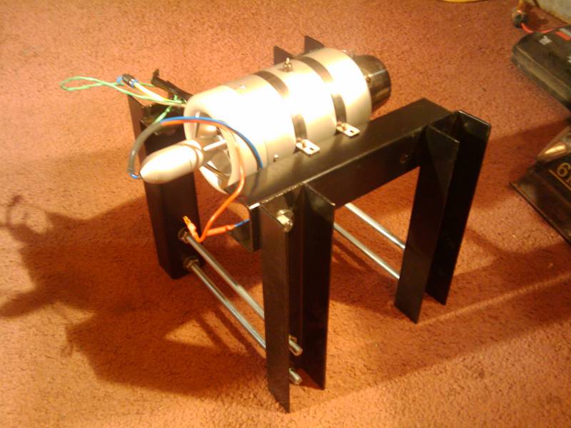

This is what I made for all my engines. Any size nitro beam mount, radial mount gas engines and turbines. I have other mounting plates for the nitro and gas engines. The two sliding plates are 3/8" cold rolled steel. I use a 50 lb.fish scale to check the thrust. The legs come off so you can take it to the flying field to run up your engines.

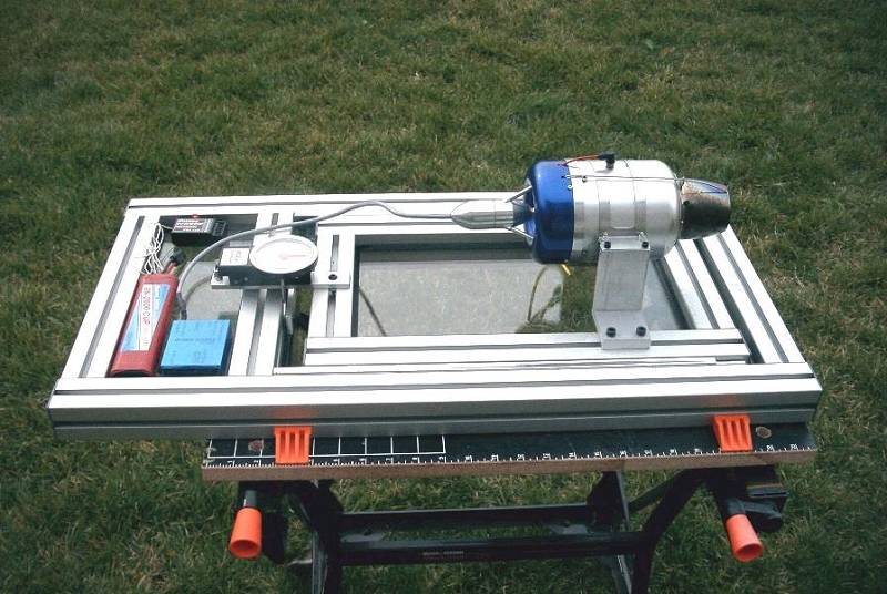

Here is my P120 on the bench.

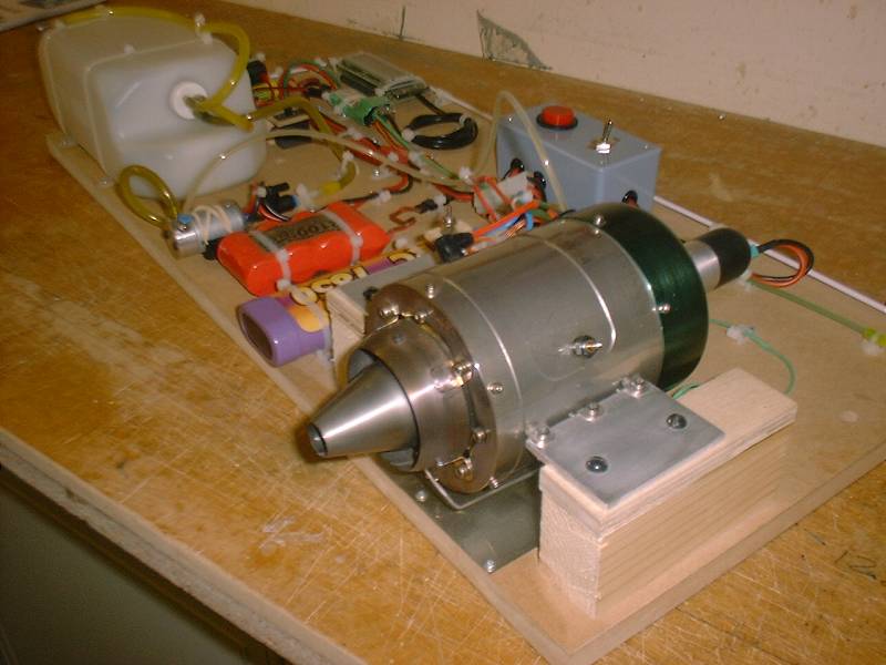

Here's mine. Altecare sells them.

Nice, but $275? [X(]

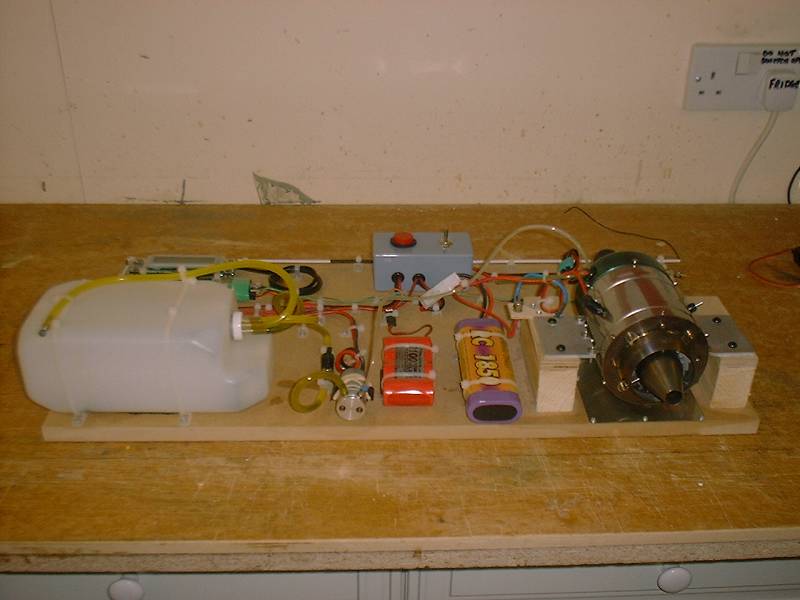

Here is the one I used to test run my Wrenn SS as it was my first turbine I thought it might be a good idea to learn about turbines on the bench. A little agricultural but I thought it was sufficiently strong to contain the beast.
The most memorable moment occured when on the second run when I advanced the throttle towards full power AND the turbine moved.
After bending the throttle stick on the slow down I found that it had moved in the holding straps. This was cured by lining the straps with wet and dry sandpaper.

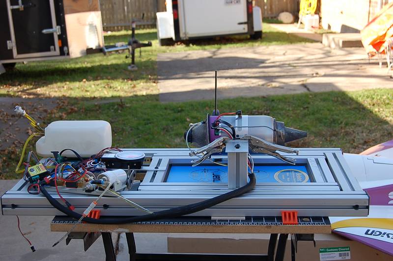

For the first turbine it's a good idea to lay everything out on the bench and run it before installing in a plane. Then you can figure out where everything goes in the plane knowing that it's right. And of course for the tinkerers and homebuilders like Jeff it's an absolute must.
Here's a pic of my sophisticated set-up...

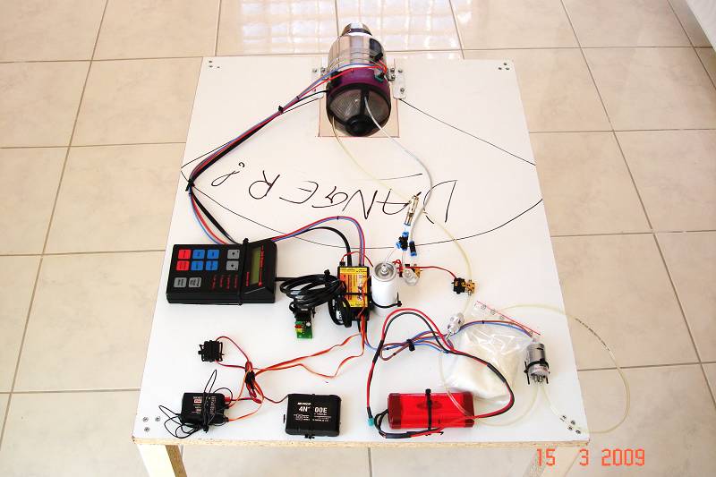

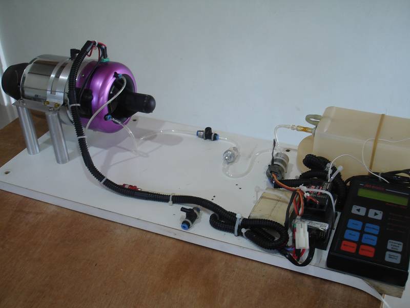

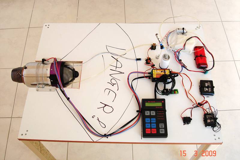

Here's a test stand for you!
Made in Greece!!!

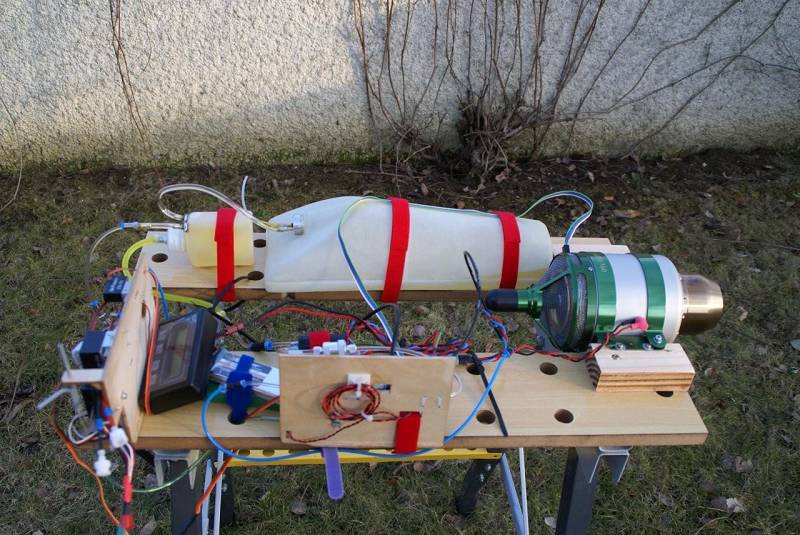

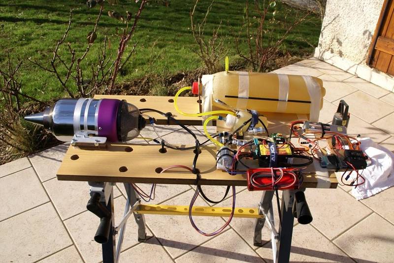

Hello,
Here is my favorite test stand used for my P80 and Wren 160.
Before fitting your turbine in a plane, you can easily learn how it runs and also test the kerosene feeding system.

it depends on how long you plan on running it at the time and the size of the turbine. i use a 32oz that's also my start up/taxi tank, i see raptorlogo used the main tank out of a Flash, it's 2.2 liters.

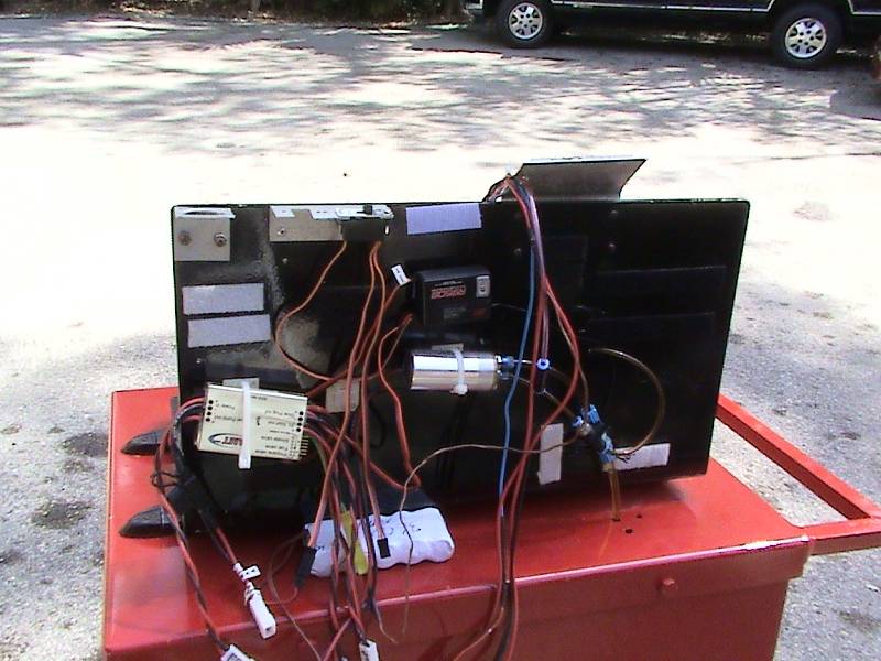

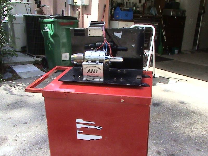

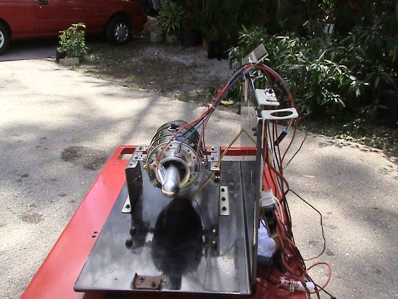

Here is my stand had this made back when I had a hobby shop so we could demo our turbines and when we worked on them

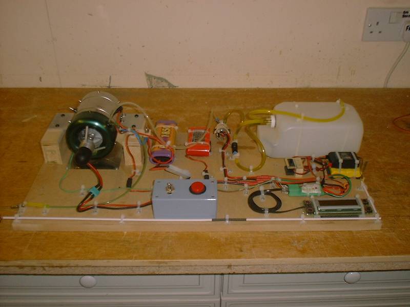

Here's mine, made it to test run my Wren, engine and test rig both sold now

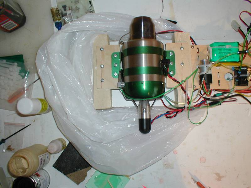

Hey guys, Does this look ok for the stand? I have not made an accesories tray yet.
Thanks, Peter

nice clean set up
