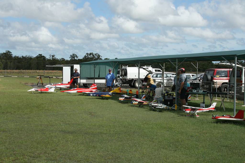

PS ALL YOU GUYS if you have any spare time in JULY you can come to our jet meet in QUEENSLAND AUSSIE

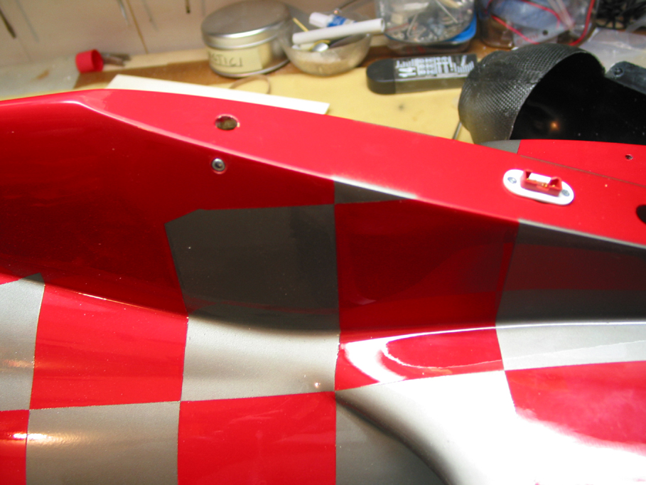

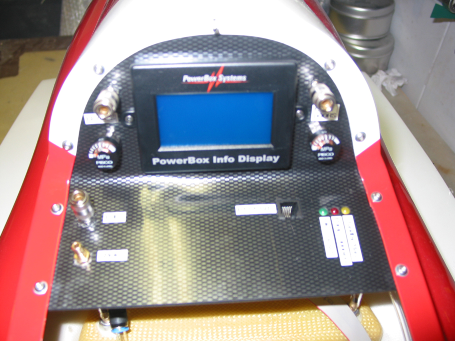

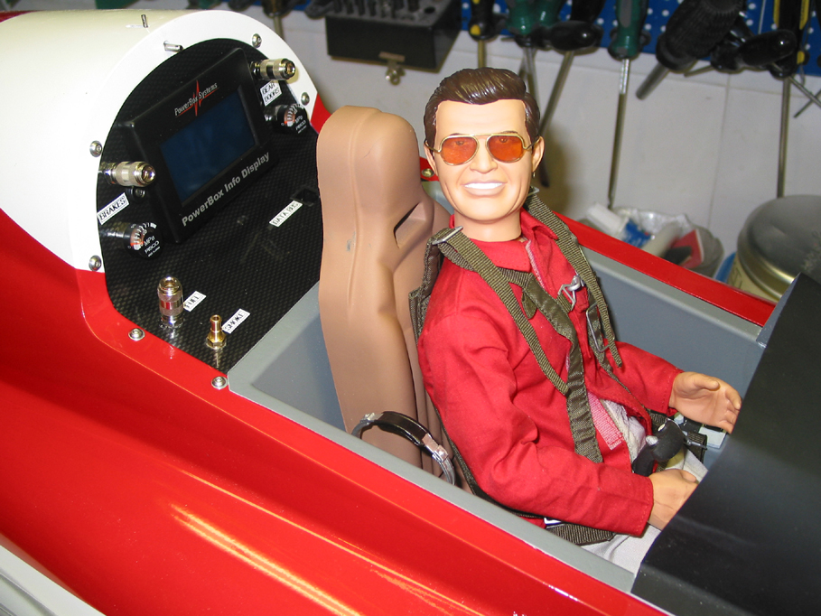

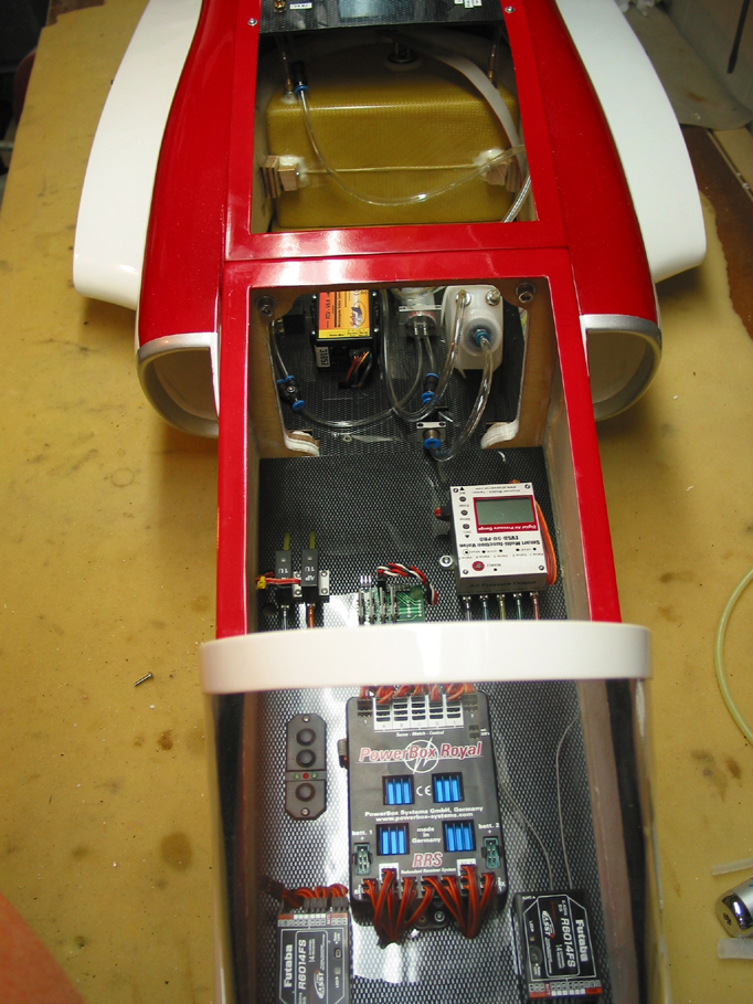

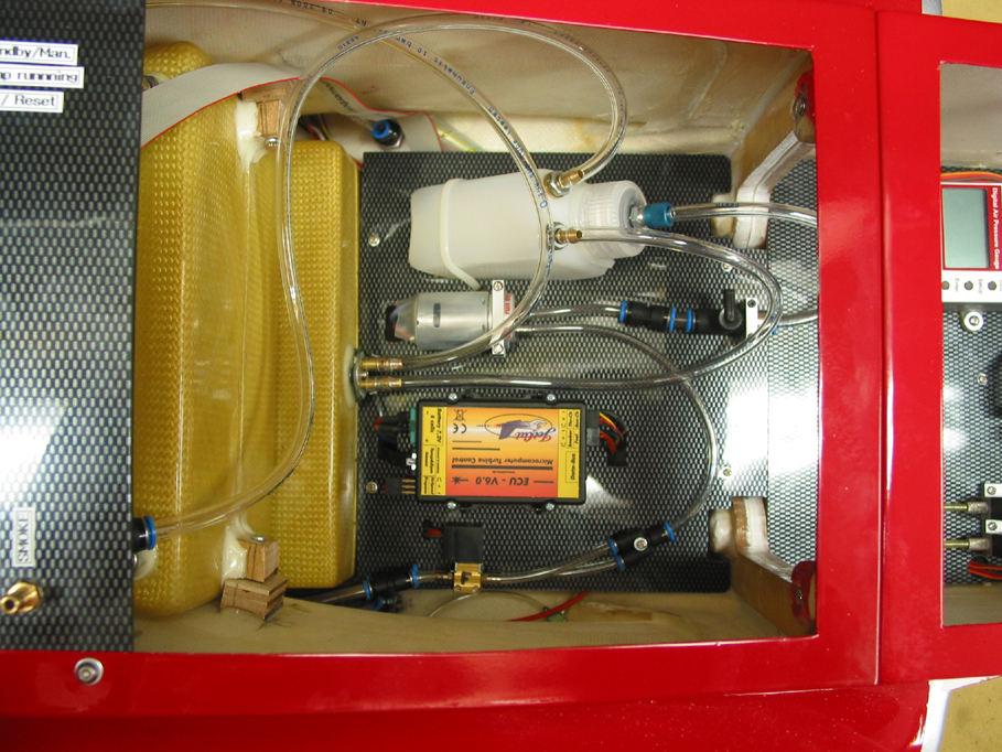

Yet another viper installation, this is my child
in random pictures.
I'm very near to the maiden flight (I thought this also one month ago...).
I'll post some more pictures when all is really finished.
Thanks you all for the precious help!!!
