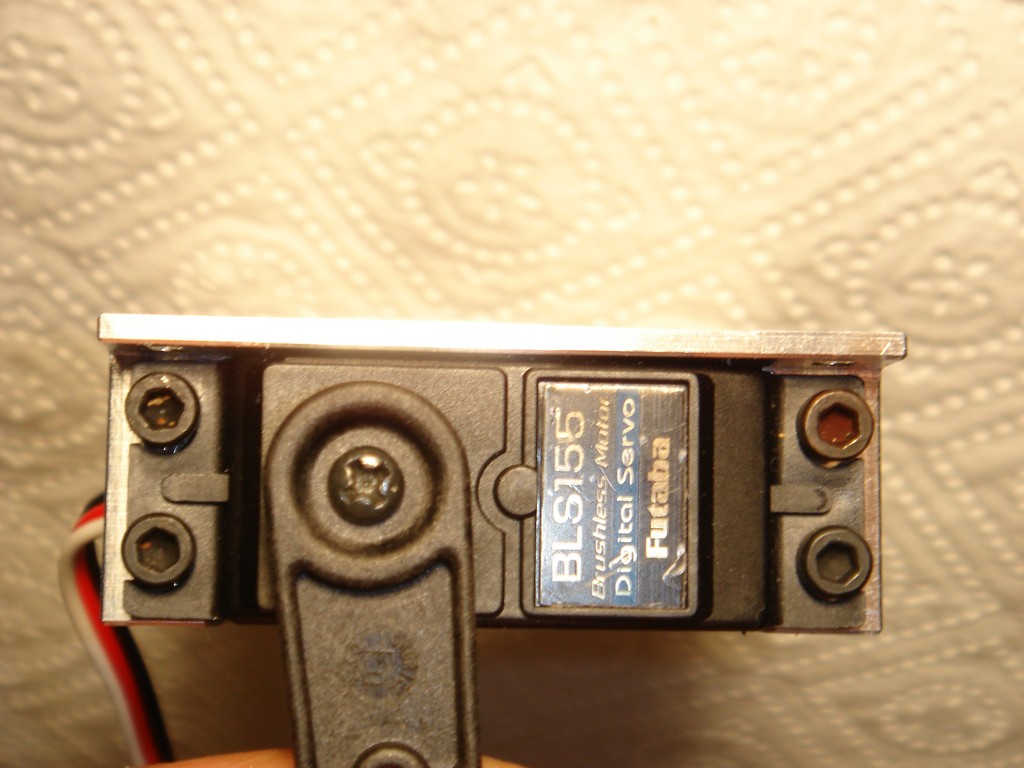

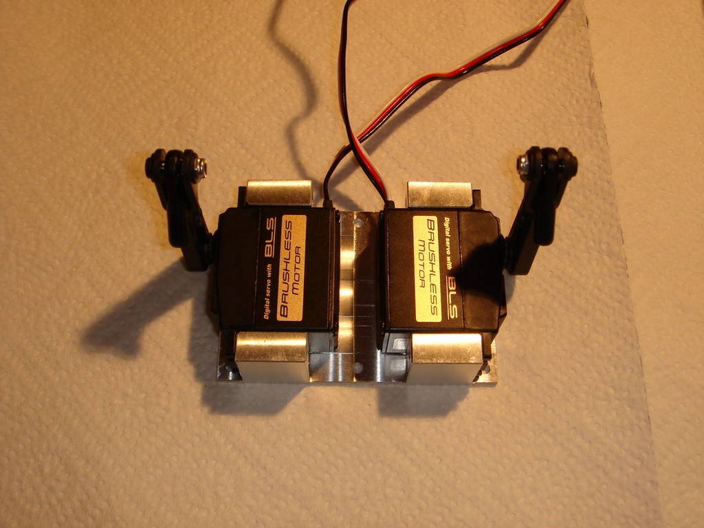

A lot of space inside even for my BLS155 Servo. Could anyone provide me with some photos how to built them in ?
From my point of view i need a separate wooden plate inside to mount the servos, or i need 75 mm Servoarms
Kind regards
Rainer

Something like this is how SM wants them.

Hi "Yeti"
Thanks for the Pictures. Now i understand what SM meant with "L-Shape".
Did you have/found enough wood inside the aileron to fix the horns or did you put a lot of glue inside ?
Kind regards
Rainer

Yes and no, placement of the control horns might have been a bit off from optimal, used Hysol were I didn't strike wood.

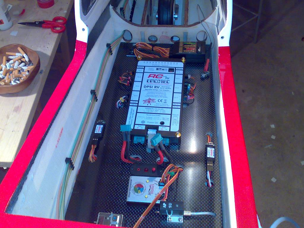

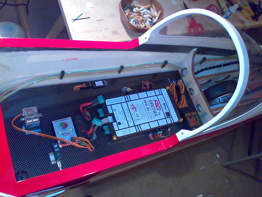

Old 08-13-2010 | 04:13 AM
  #1520
Joined: Nov 2009
Posts: 14
From: ROMA, ITALY

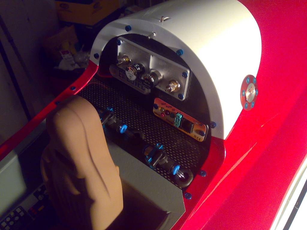

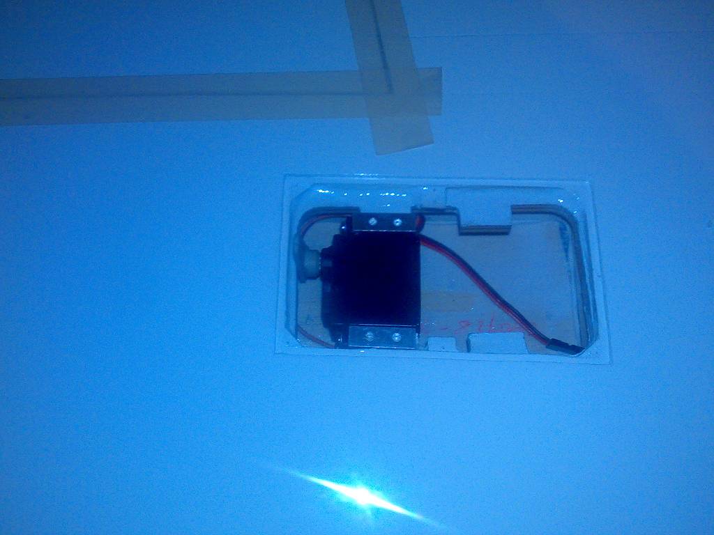

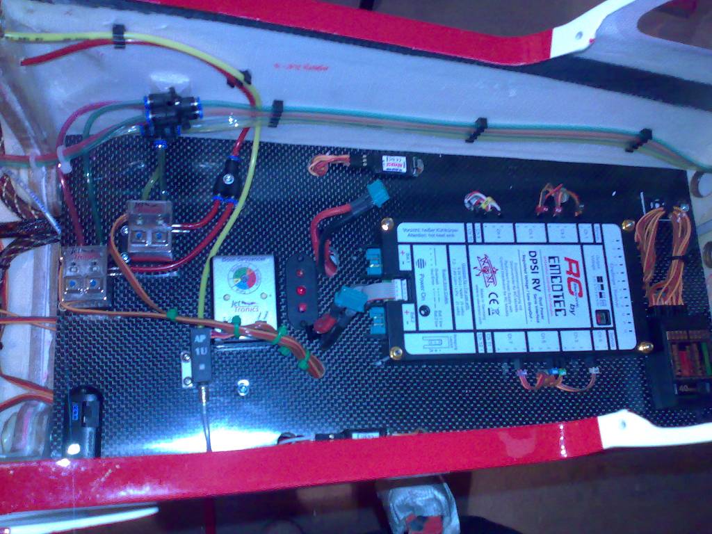

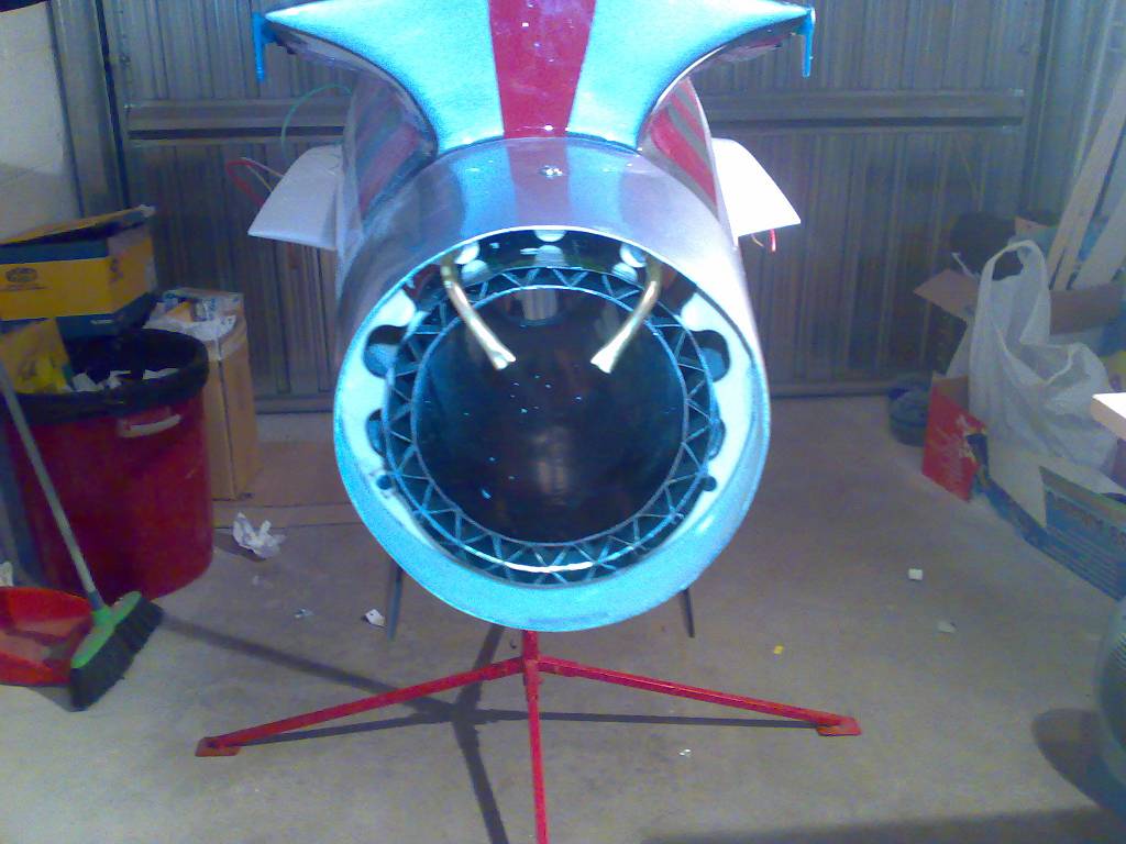

Default RE: Another Skymaster Viper
Hi Rainer
This some pictures of my viper

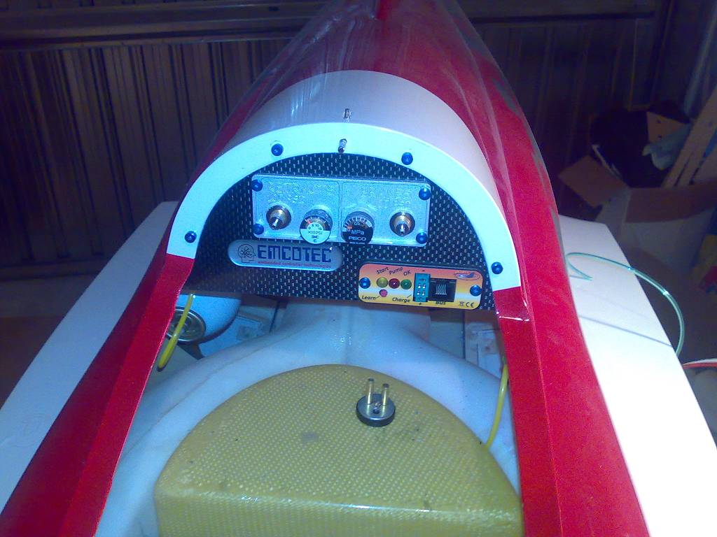

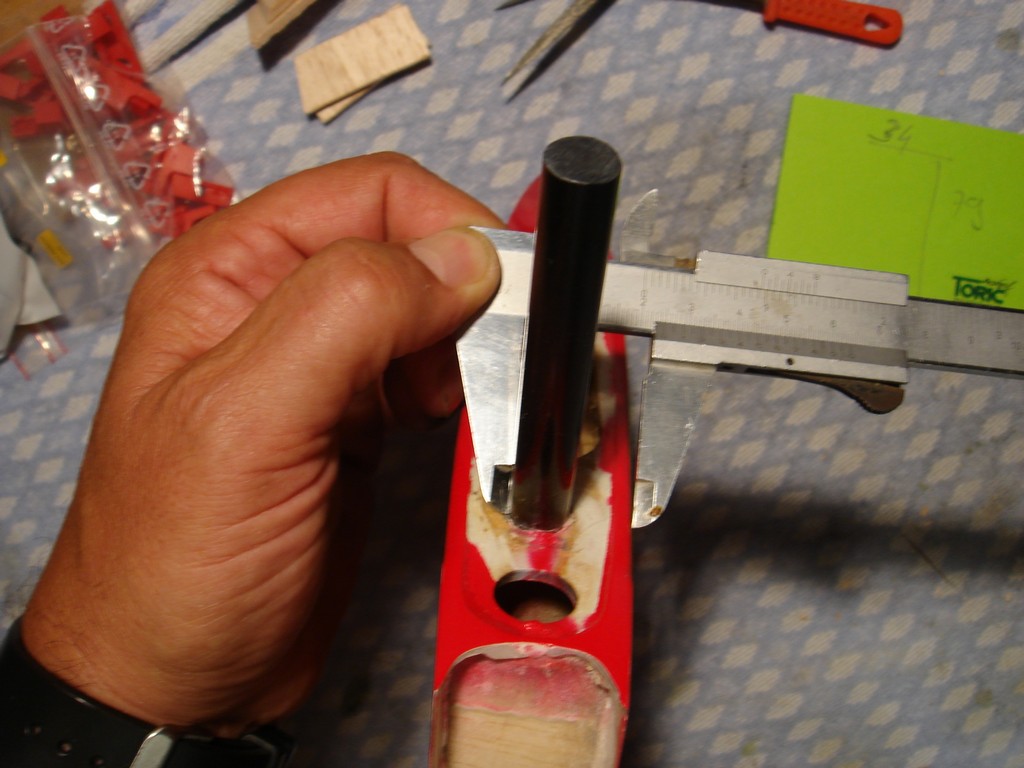

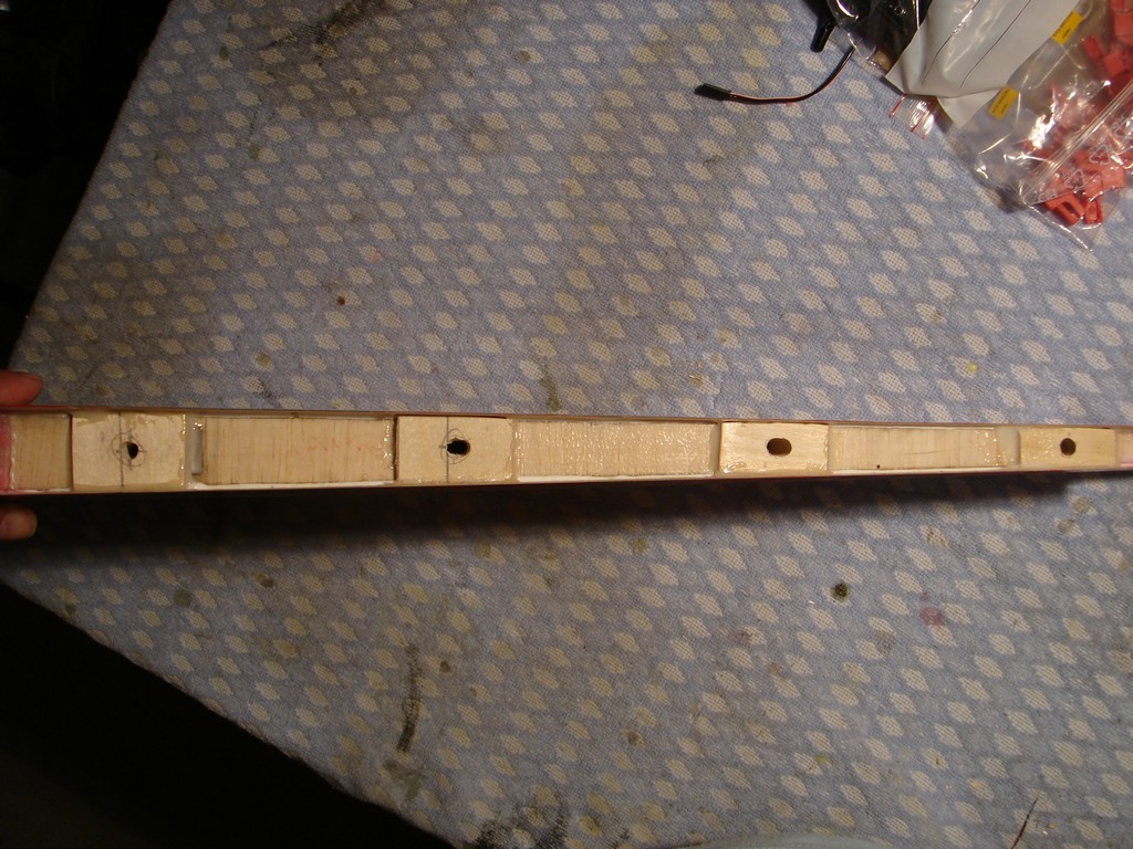

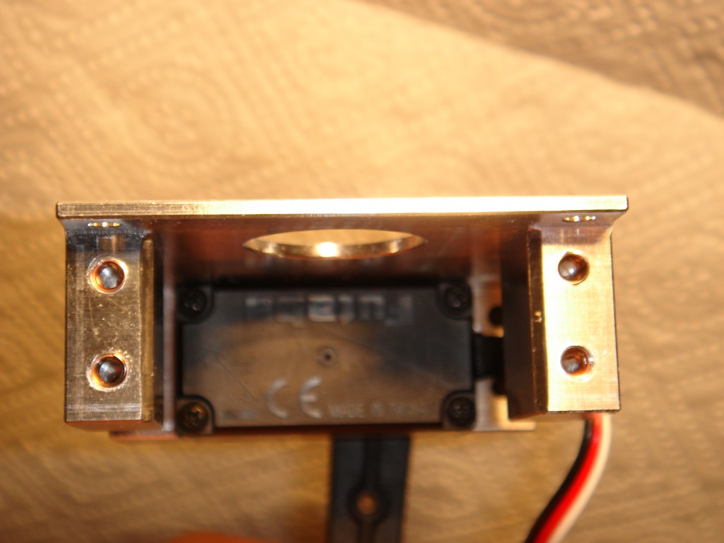

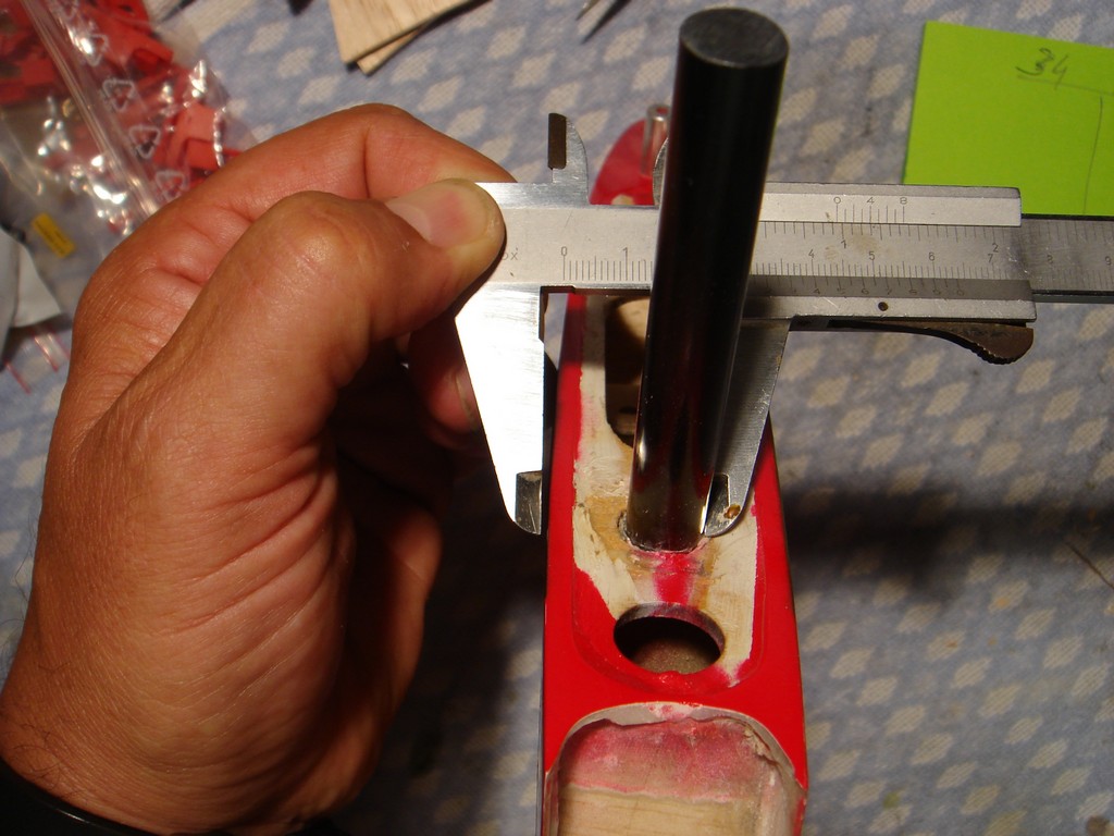

Hi at all
A little bit surprised while mounting the rudder to the fin.
The drillholes are not alligned to the drillholes in the rudder. After i added some 4mm plywood with 5mm holes to shorten the distance between for the hinge mounting between rudder and fin, i find out the drill holes are not correct alligned. The two middle ones have a deviation of app. 3 mm. Originally the rudder fitted, probably the wide distance between fin and rudder allowed that, but now if have to sand out an oval hole for a correct alignment of the rudder. Hopefully the fixation with 2K glue comes well.
The carbon tube of the rudder is not correct mounted in the middle of the rudder. Deviation of 1.5 mm. At the moment i have no idea how this affect the flight line, because the small metall one in the front of the rudder is exacteley in the middle of the rudder. Correction is not possible, or i have to remove the passtube in the fuselage, remove the carbon tube of the fin and replace everything to correct them.
My youngest boy suprised me with the ultimate servo fixation :-)
Heavy Grade Airplane Aluminium and only 48 grams. For the screws he inserted self locked heli coils into the aluminium to have more resistance for the screws.
This Fixation will placed on a plywood plate in the wings for flaps and aileron. Total additional weight of servo mounting and plywood plate and and stabilizers 59 grams. Not too bad ..., or :-)
The L-Shape Aluminium hasn't had really my certification for high power servos :-). Pictures of the wing mounting will come later on.
Rudder Horns and reinforcements for the landing gear from Sandor arrived today and the complete Illumination of Optotronix too.
Kind regards
Rainer

Shaz I know nothing about the Viper, but I do use crow on my Flash. This is what I do. I have the crow mixed in with my flaps on a mix switch so I can land with or with out crow. I find that in high winds crow turns the Flash in to a kite. So I don’t use it on landings in high winds 20+ MPH. I drop my gear, then flap and crow. Make a lap or two to get the feel of it and the speed right then come in for a normal landing. You will find it will come in a little nose high like your F-15. When you cut the throttle it will sink faster than with out crow so be ready.
You must be standing on a high point at Chatfield. When I fly the elv is about 5400ft. But at 95deg the density alt is about 9500ft...
