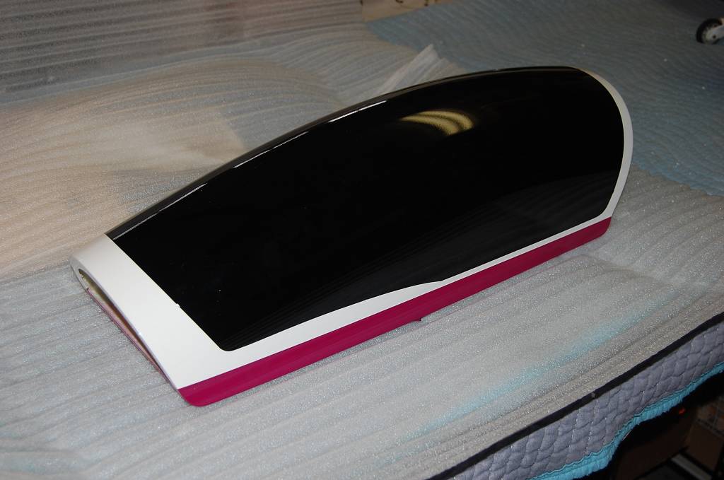

I got a very large box in the mail today...the Viper has arrived!! I took a few hours to unpack and inspect, have to say that the work, fit and finish is first rate. Jeff at RCI down in southern California was a huge help with the custom color I wanted and all the other items I wanted and/or did not want on the jet, thanks Jeff.
First off, you will notice that it has a black-out canopy, not a big fan of full cockpits but wanted the extra strength of the fiberglass. Second, I will be doing all my own plumbing and gear door installation with BVM airline, RAMs, and CF hinges on all the doors. I will also be mass balancing all control surfaces.
Would like to take all of you that have gone before me and posted all the VERY helpful info on what you have discovered, I'm sure that I will be asking a lot of questions.

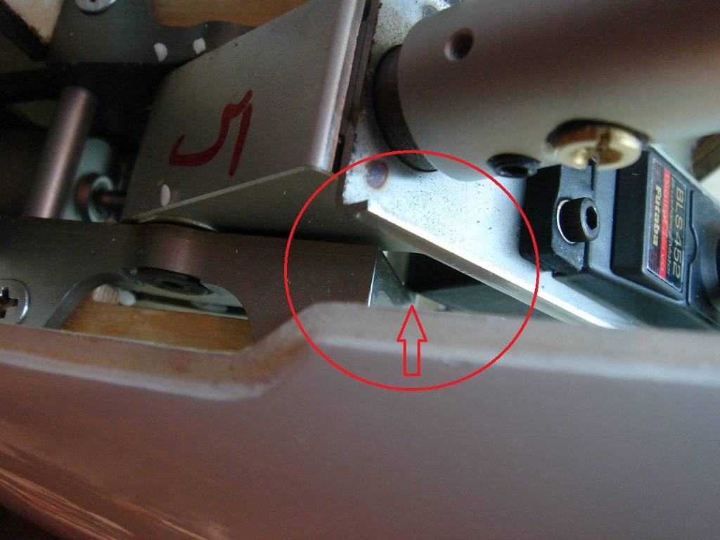

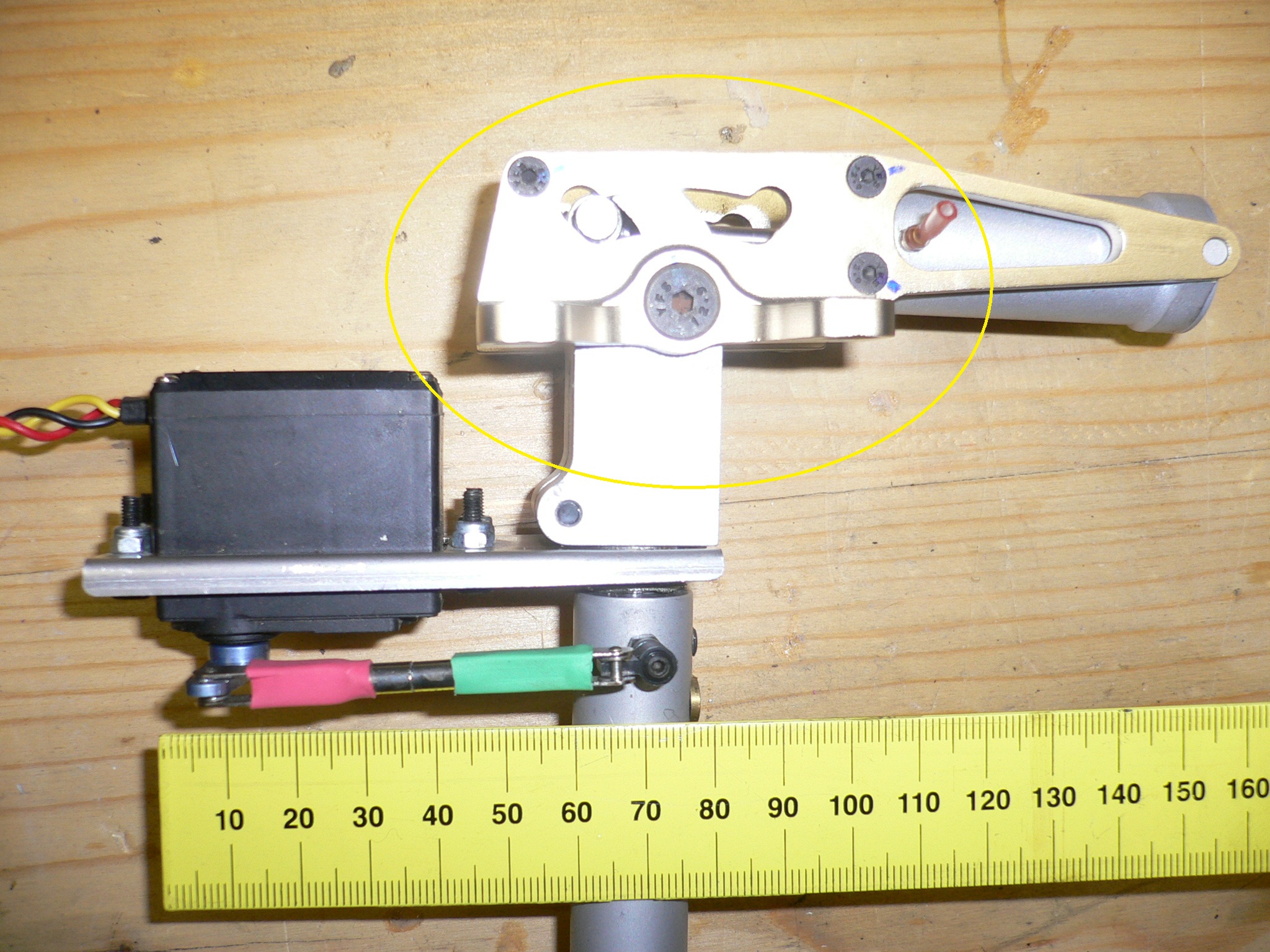

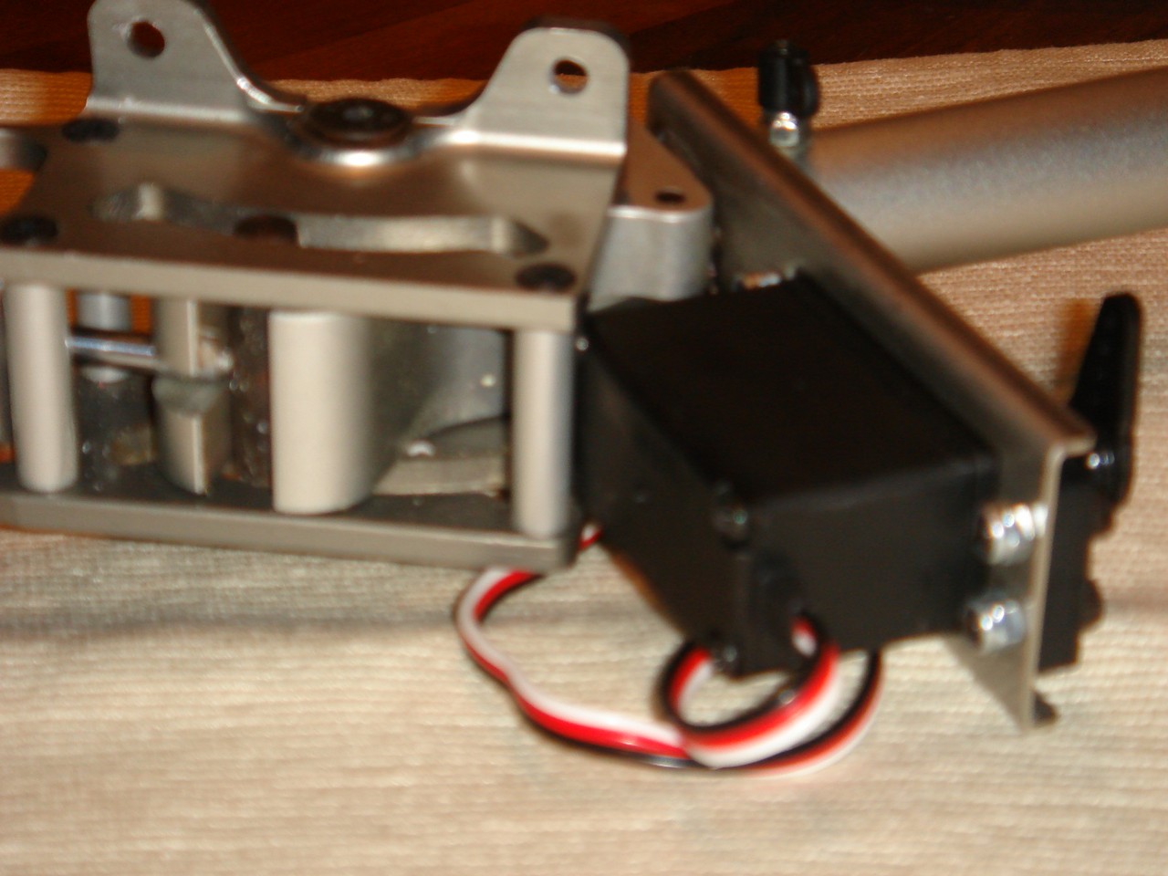

I'm sorry for a simple, and perhaps, stupid question,... but i need help for a Servo Installation :-(
How did you do the servo installation in the front gear. I use a Futaba BLS 452, and if the servo is installed, i can't retract the gear because the servo block on a metal rod on the gear ?
The DS8511, which is used in the user manual, has the dimension 40x21x38 mm instead of 40x20x37 mm at my Futaba Servo
Any idea how to solve the problem ?
Of course, one solution could be to remove the rod, but i think there was a reason to mount it :-)
Best regards
Rainer

Joined: Jul 2010
Posts: 24
From: Sachseln, SWITZERLAND
Hi Dave
Thanks. This would be one Solution. But due the rotation, if the gear is retracted, i have only 11 mm space between the rod and the Servo. So a shim of 1/8 inch perhaps didn't solve the problems. But i will try it out to be sure.
A upside down installation of the servo and the gear can be retracted. But this couldn't be the solution.
With upside down mounting the angle of the push rod is app. 45 degree !!
The best would be to shift the servo app. 7 mm away from the Gear,... but here the metal plate ends before. Perhaps i have to extend the mounting plate with another metal plate. I will try out that.
I mean, there are so many vipers on the market, and i didn't heared anything about difficulties with the servo mounting in the front gear.
Best regards
Rainer

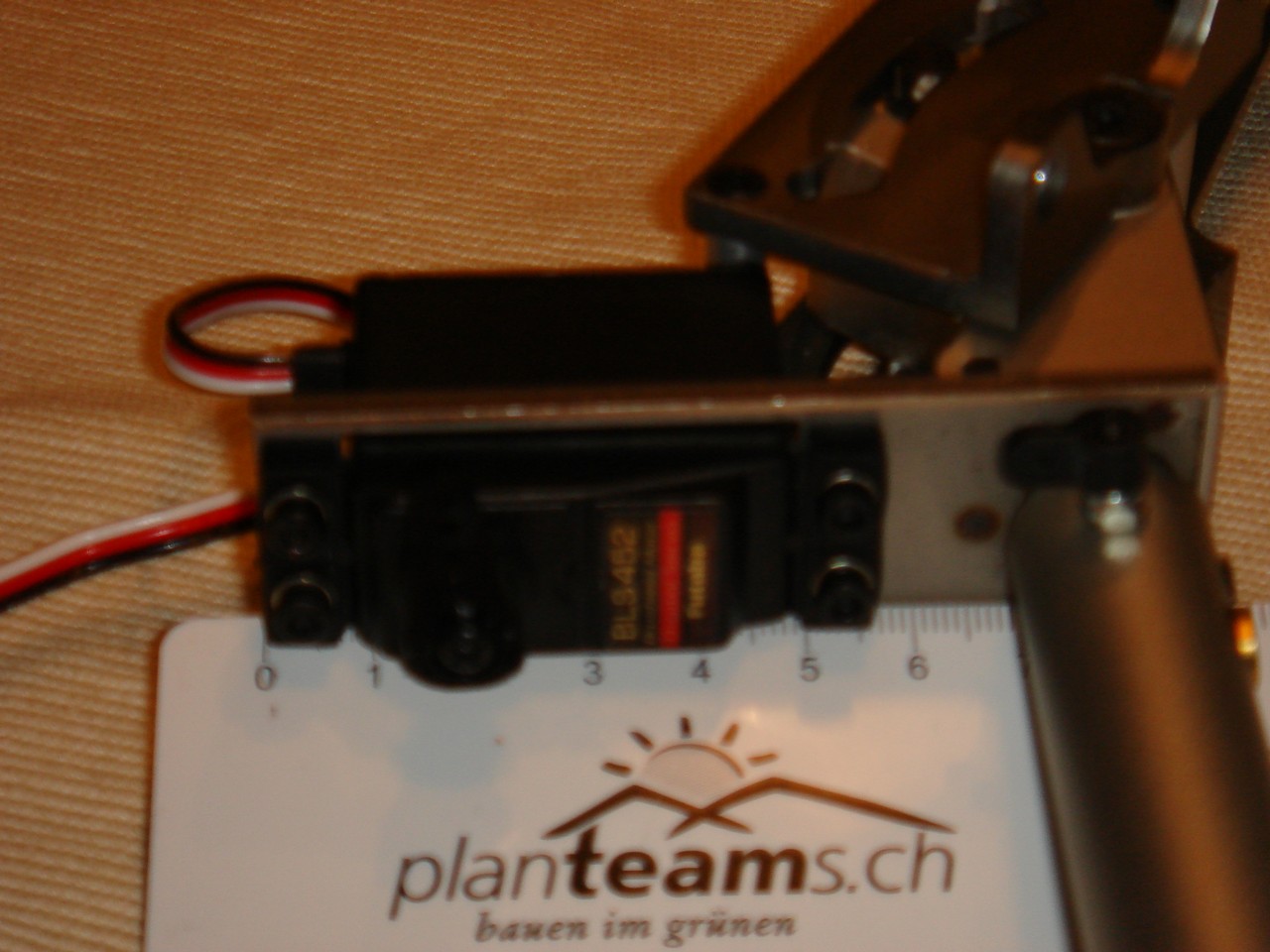

Joined: Jul 2010
Posts: 24

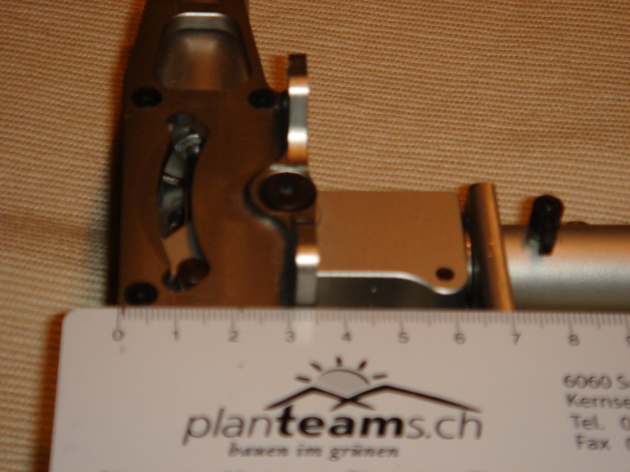

Hi Duncan
Thanks for the input. But the problem is, it seem so, a wrong mounting plate at nose gear. A colleague of mine, which is flying the large viper too, told me, his mounting plate is a little bit longer and he has app. 6 mm space between the metal rod and the servo.
I sent already a Mail to SM. Morne has no idea about that, but a replacement is not yet in discussion :-(.
I attach some picture with a ruler. Perhaps you, or anyone else, can check the distances at your Viper. Sorry for the european ruler :-) everything is in mm.
A calculated solution would be to mount a seperate 4mm aluminium plate onto the already installed servo mounting plate to move the servo app. 10 mm more into cockpit direction. Then the gear should retract,... but i'm not yet ready and really willing to that. The landing gear costs a lot of money and i expect a working one for the money :-)
Best regards
Rainer

Joined: Jul 2010
Posts: 24
Dear all
The failure was found. It is a not tested and modified, or complete wrong, gear mounting plate.
Will see what SM is doing now.
Thanks to all who read my former mail and tried to help me.
A colleague of mine built off his working gear and then we are able to compare those gears. On the left picture the working gear, right the non working gear.
Best regards
Rainer
