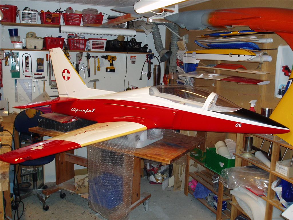

Default RE: Another Skymaster Viper
ORIGINAL: Selleri
Congrats Hans.
Now I'm getting pretty excited to get mine in that scheme!
Colors turned out better than I hoped for. I didn't know the blue was metallic [8D][8D]
@Ali: Rookie is in the bin, Viper on the table

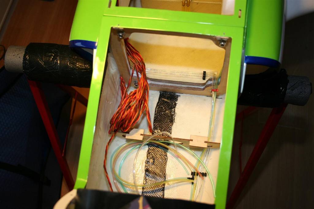

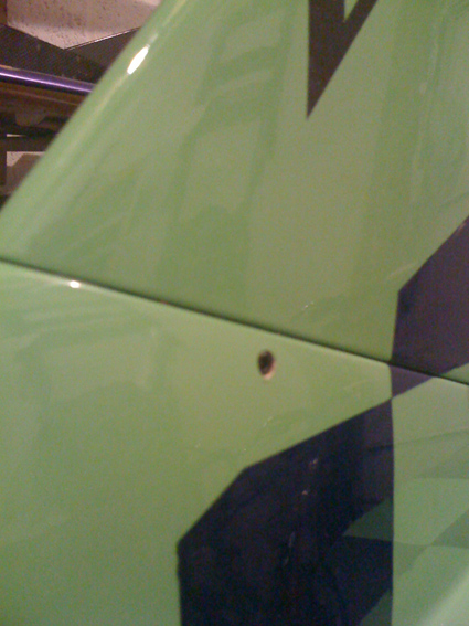

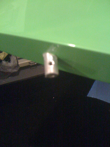

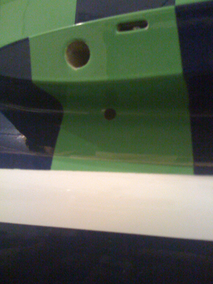

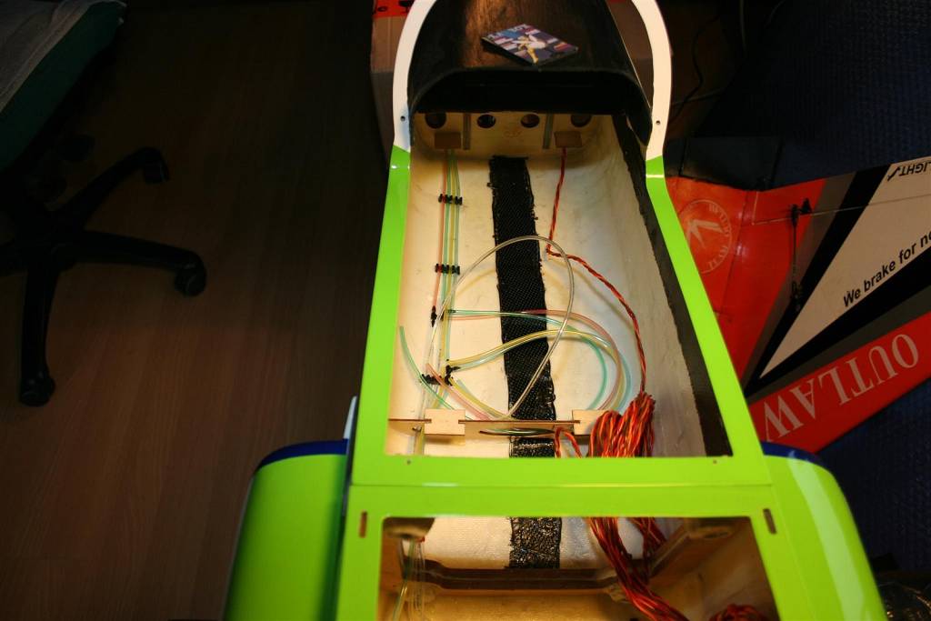

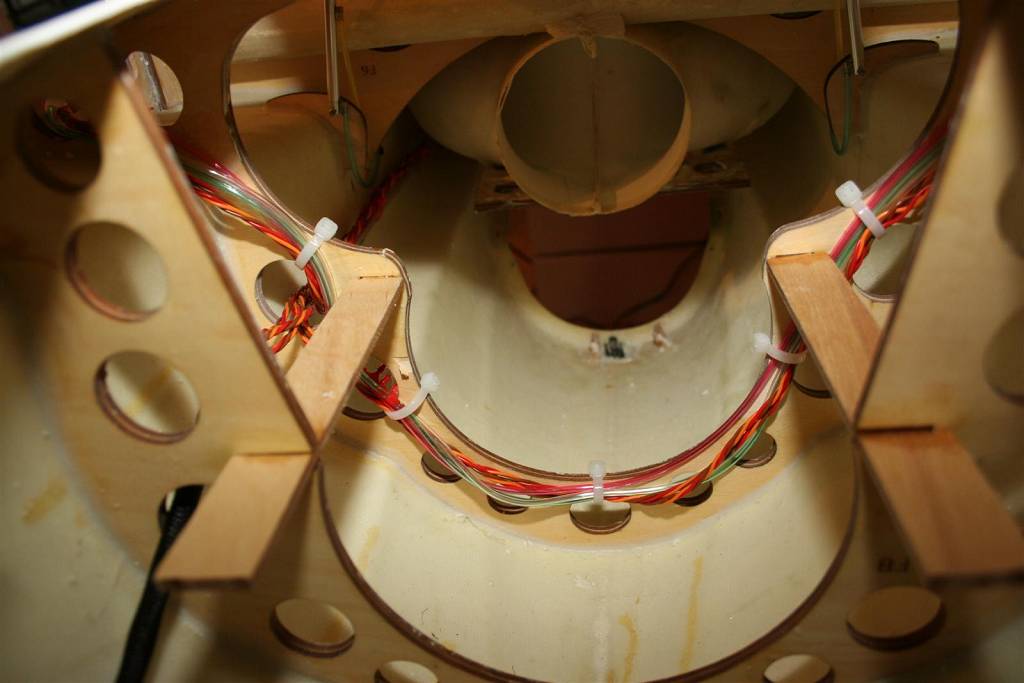

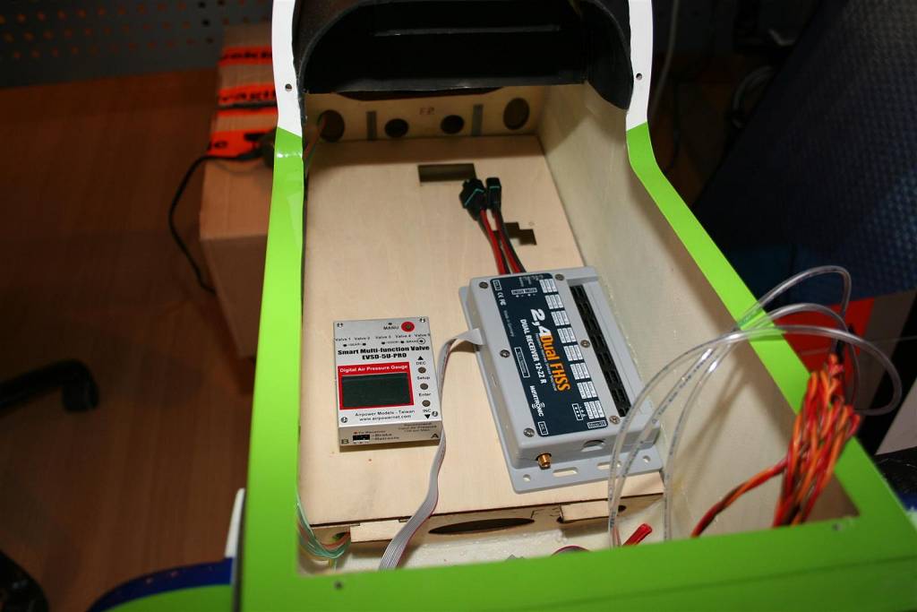

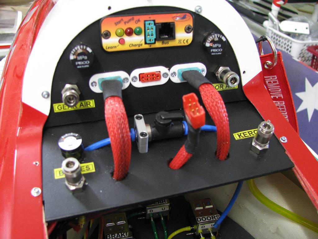

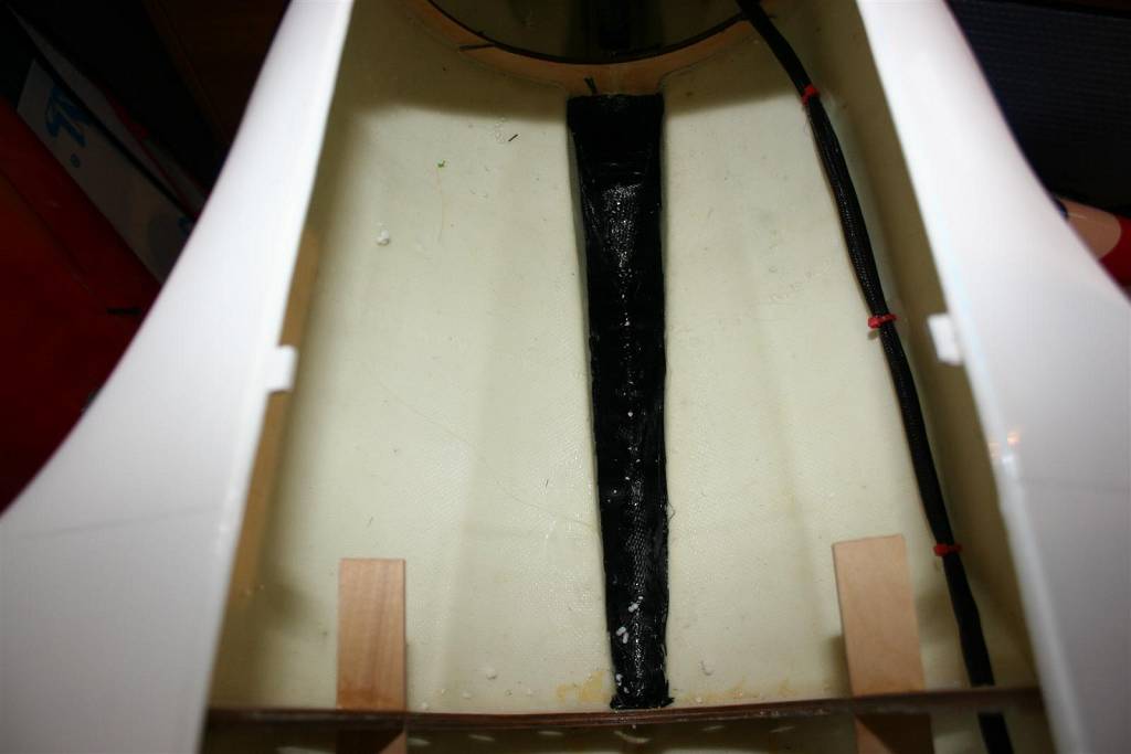

I have removed the brace at the back of the canopy, and made to "hooks" instead, works perfectly. That enabled me to place the filling couplers for air and fuel behind the backseat.
I also made some reinforcements, particularely the "spine" from the vertical fin (the raised part) is very soft on the sides, that one got some carbon, made a lot of difference. Also the front part of the plane is soft, both the sides and the bottom, carbon there too (not too much to shield 2.4 GHz )
Cables and airtubing has been installed, planning the install of the equipment now (the Weatronic and the valveblock makes a nice and simple install!)
Thrustube for the P200SX ordered, so it's getting close

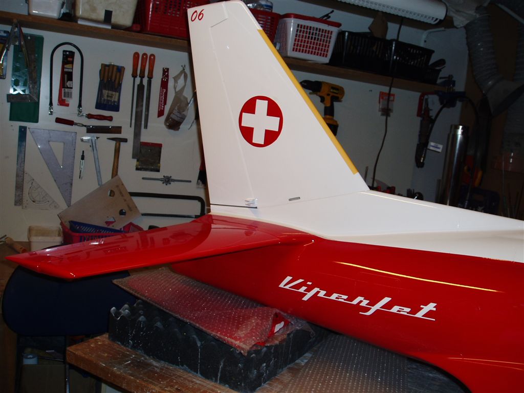

Made my tail fin removable. I drilled & tapped the forward carbon rod. 3mm allan screw through the side of the fuz just down from the tail root. I drilled holes either side of the fuz, under the stabs, in line with the clamp bolt & nut for access. It 's a five minute job to remove & fit. Very secure.

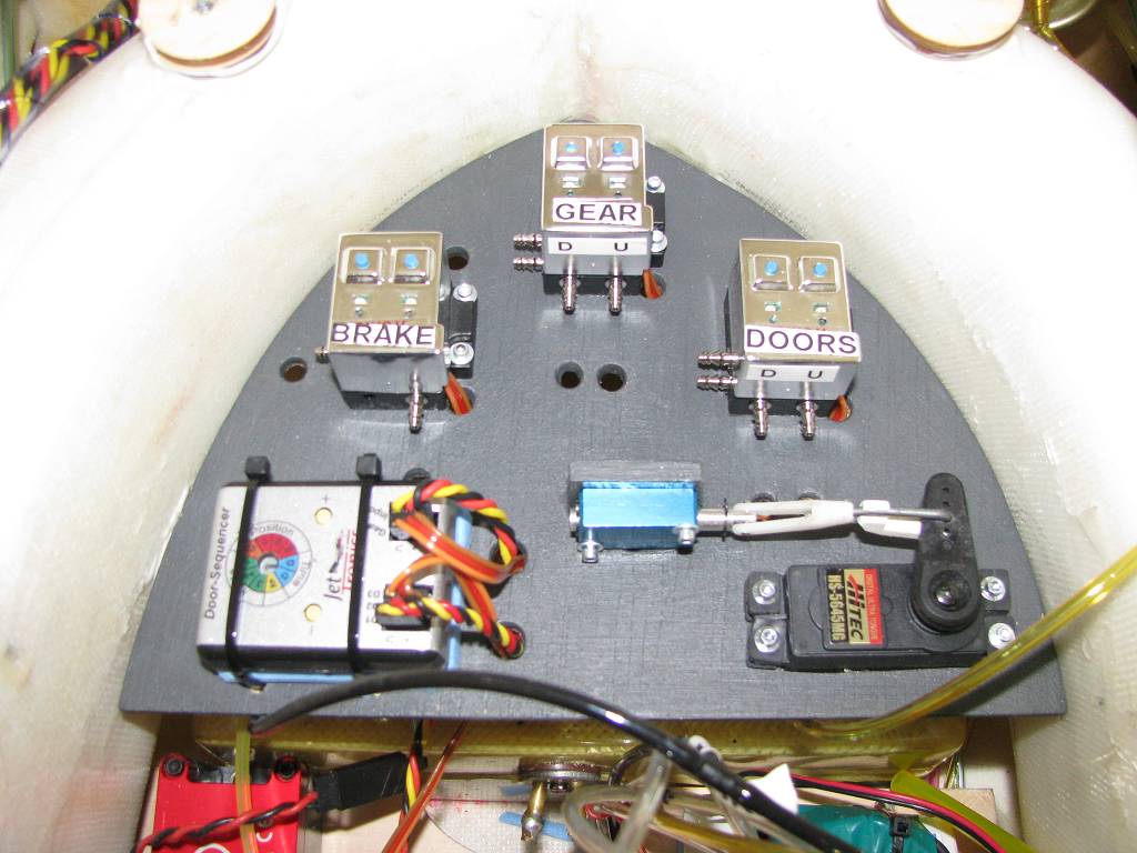

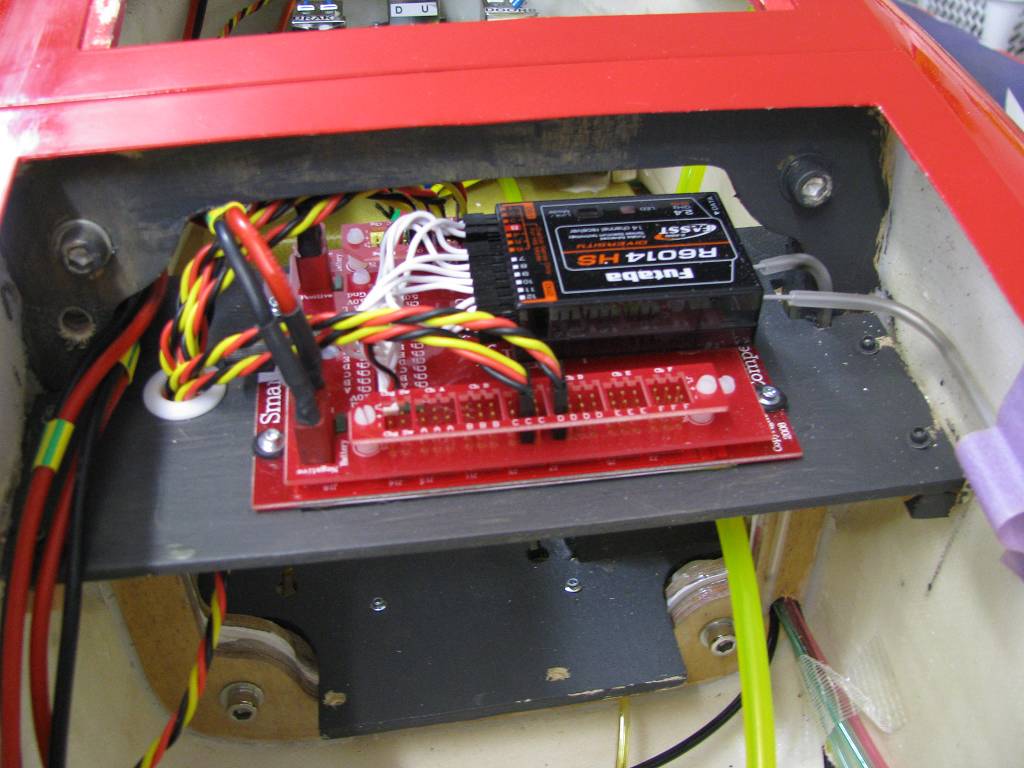

Would appreciate any shots of you turbine fitouts, am on to my finale fitout on my of all the bits and pieces and any would help, This forum has been more than helpfull the viper is sure one great plane,This is only my second jet am currently flying a PST REACTION it also is a pleasure to fly as a trainer not much better,Shall add some shots of my viper fitout.
REGARDS

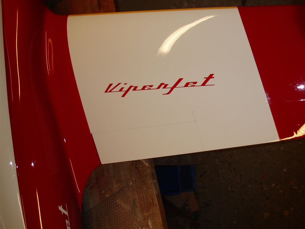

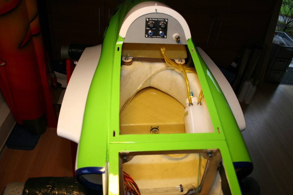

I decorated my ViperJet this weekend. Now I can start mounting the bits and pieces.

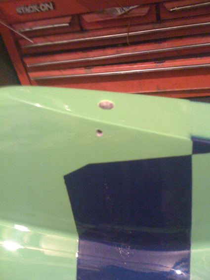

Hi Murray
Here are the pics of the rudder mod, making it removable for travel, it's only a 20 minute job (after the hysol has dried). I first drilled a hole under the stab and in line with the metal clamp which holds the rear carbon rod in place. Then on the inside of the fuz i added a fillet of hysol either side of where the front ali peg sits. Then with the rudder in place and locked by the rear clamp, i drilled a 2.5mm hole in the side of the fuz and through the ali peg. This was then tapped to 3mm and a countersink ground, so the 3mm bolt sits flush with the fuz when in place.
hope that helps
