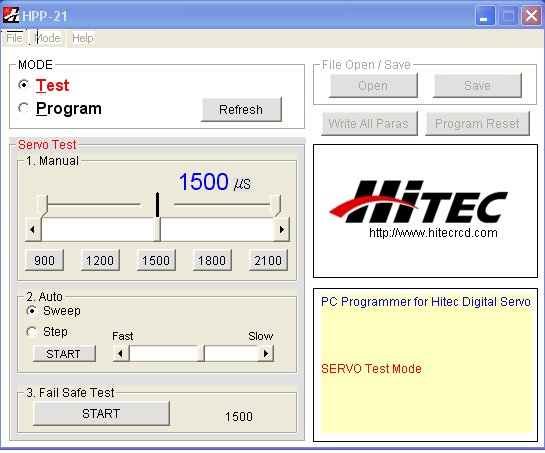

All Hi-Tec digital servos have the capability to have there speed programmed, did you verify the settings on a Hi-Tec programmer?
The Hi-Tec HPP-21 is a handy tool and it is relatively inexpensive.
Also (as a test) can you mix two separate channels together to verify the servo operation on independent channels to eliminate any possible influence that Y may have on the operation.
As mentioned, it could be as simple as the geometry of the linkages
Edit - I see you checked the linkages

Rich, so am I guessing right on this servo programmer? If I had one inline, I could make the offending servo stop at or change it to stop at points to match the other servo?? I see five Ref/stop points in your screen shot of the programmer. Thanks for the input KC. Your nail on in what I was thinking. If this be the case than the programmer would be a fast fix. Is the programmer set-up to work with servo in plane in line or do you have to take it out to link it up with a PC?

Rich, so am I guessing right on this servo programmer? If I had one inline, I could make the offending servo stop at or change it to stop at points to match the other servo?? I see five Ref/stop points in your screen shot of the programmer. Is the programmer set-up to work with servo in plane in line or do you have to take it out to link it up with a PC?
Yes you can adjust the servo;s to match each other, as long as you have a long enough USB cable you can leave the servos in the plane, however I usually make all adjustments prior to installation.

Rich, That looks like a neat gadget to have around for the price but gotta ask. I noticed in the Tech notes that it had Several features. Speed, Dir, EP and failsafe. Will this programmer allow me to even out say, the 90 Deg. flaps position and not change the 20/25 Deg.pos or the up flaps Pos? I have the servo's working great on the all up and at the 20/25 Deg. Pos. it's when I start moving down for more flaps that I need to adjust. They are not signaling the same linearity. I guess I need to bone up on this. I don't use many Y's as I just like to put everything essential on it's own Ch. and control it from the TX or use the feature for this on my Smart-fly boards.
Interesting question on the linearity.
I have found that if I adjusted my center points and end points the same there has never been an issue with the linearity.
