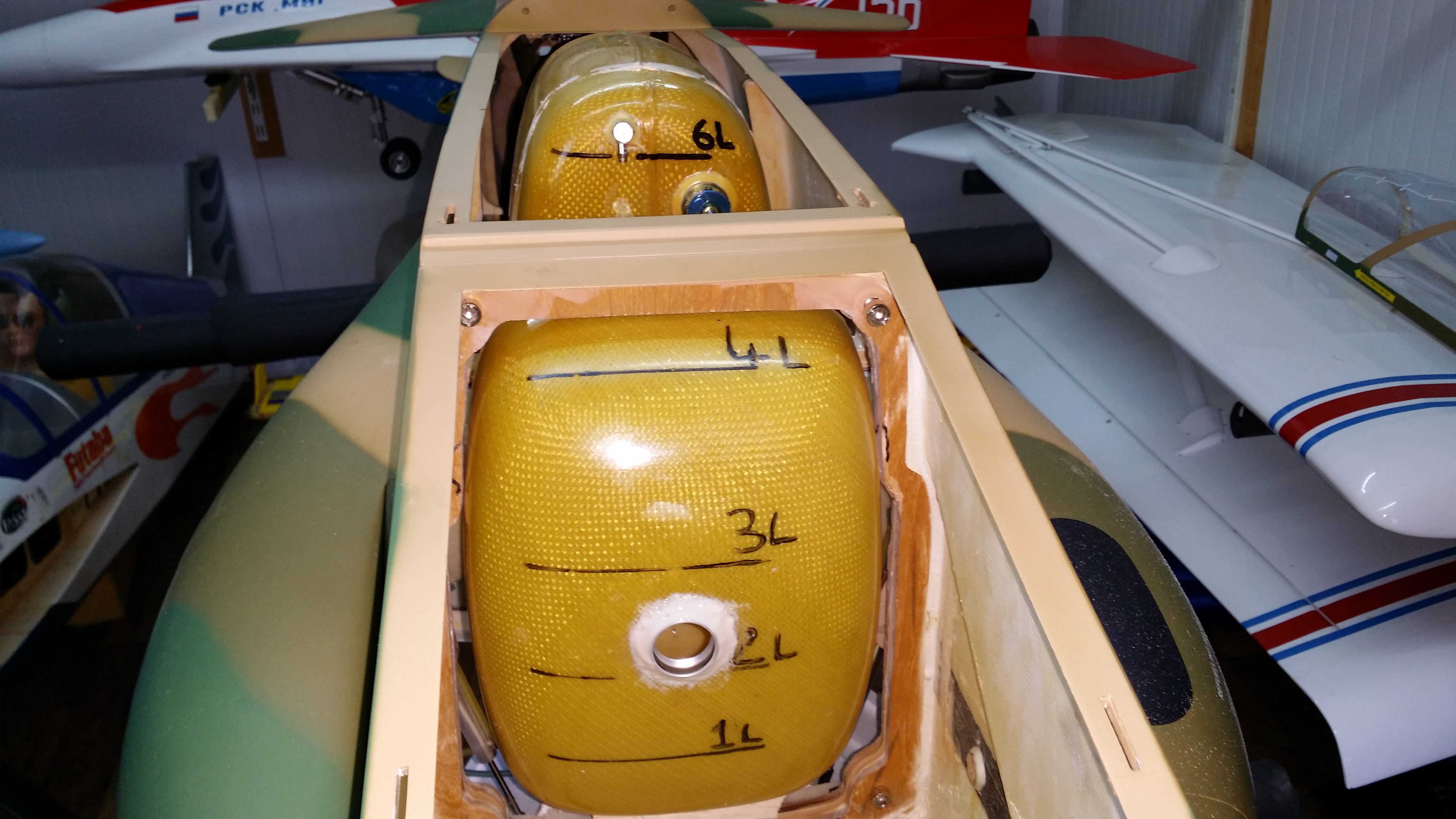

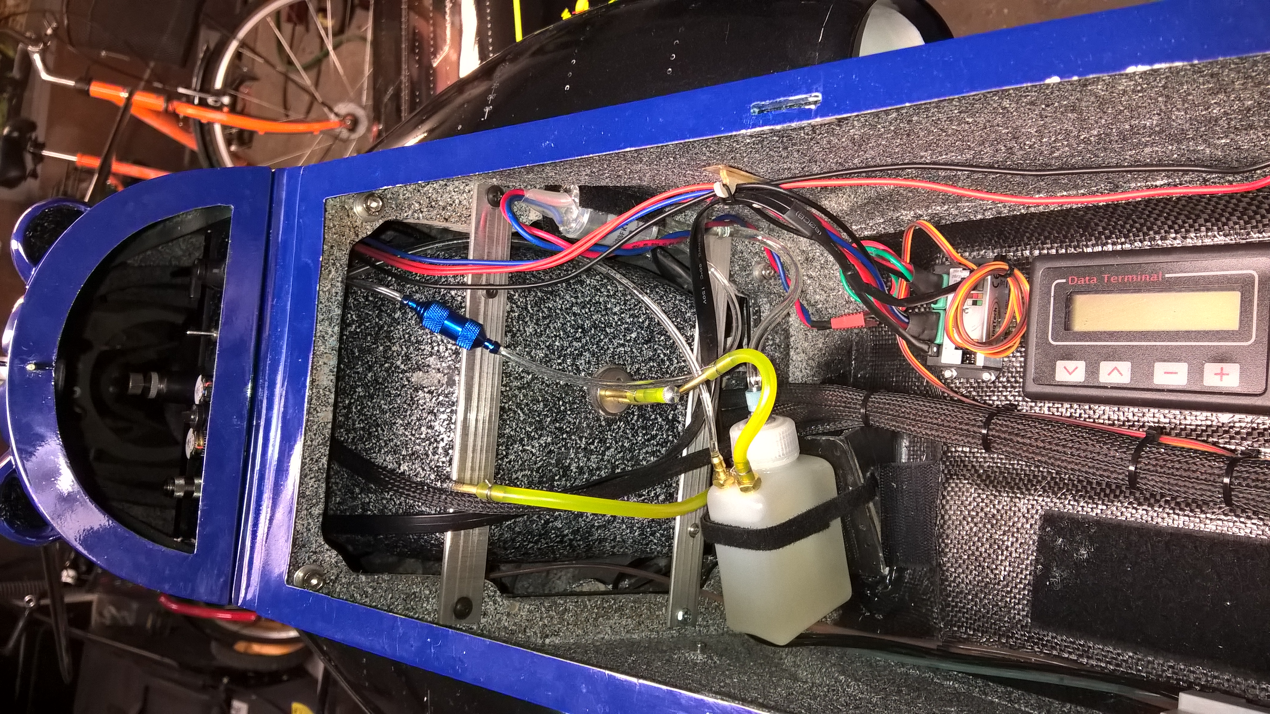

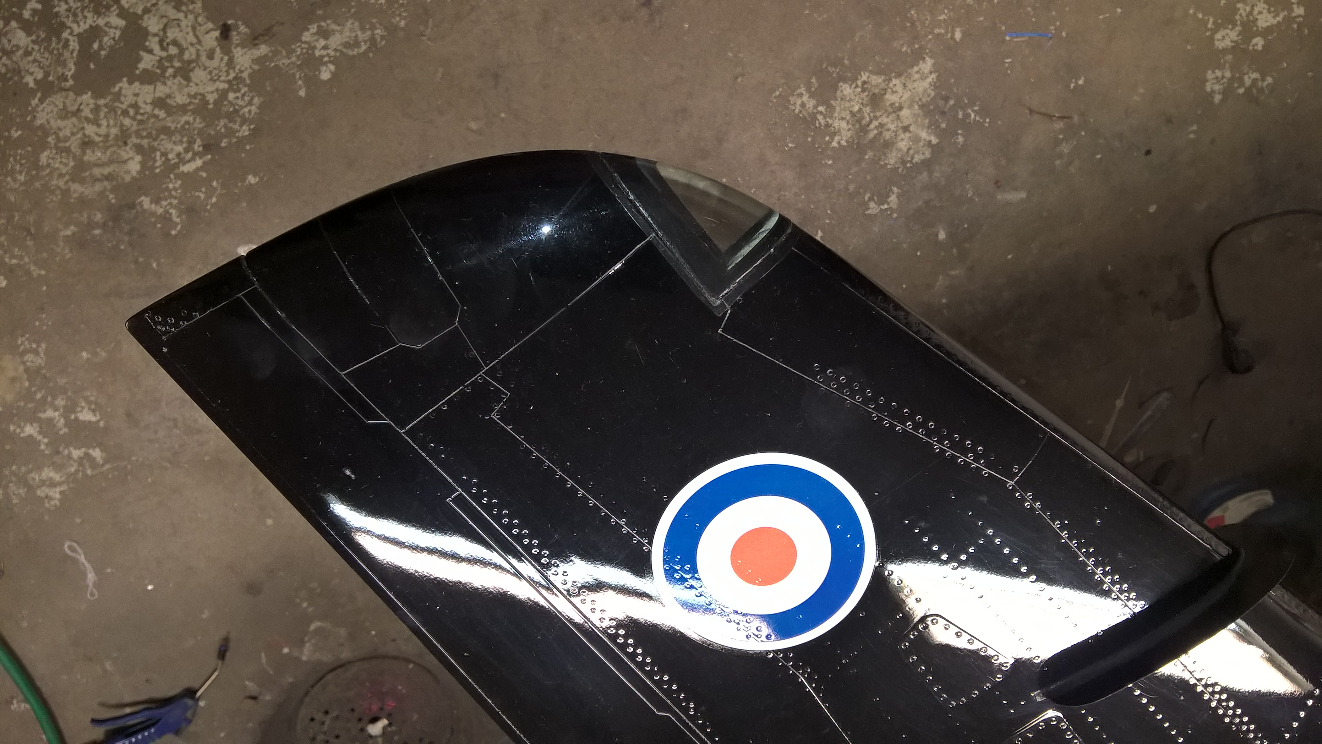

Please see attached pictures. If you need closer pictures of tank installation, please let me know.

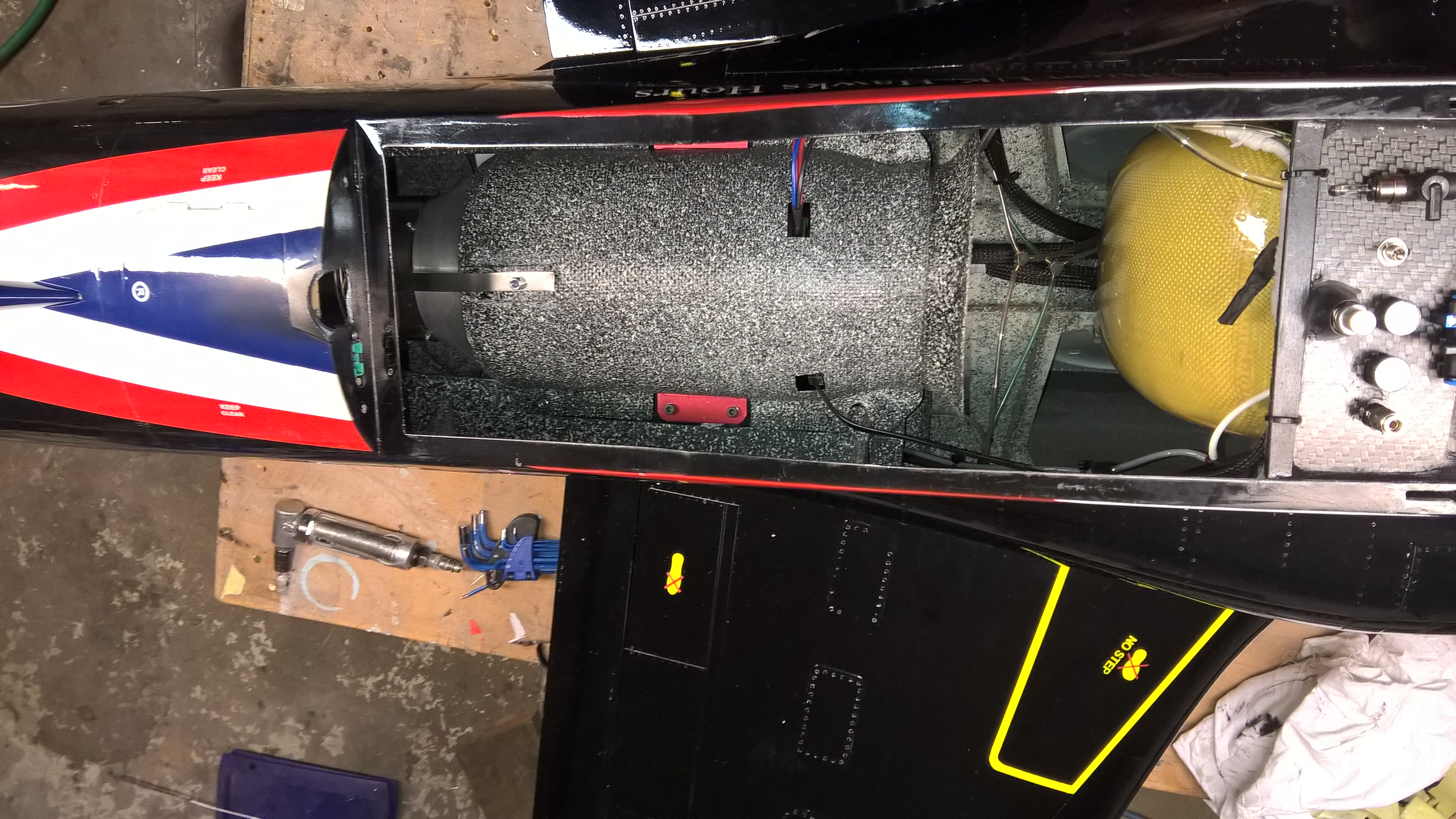

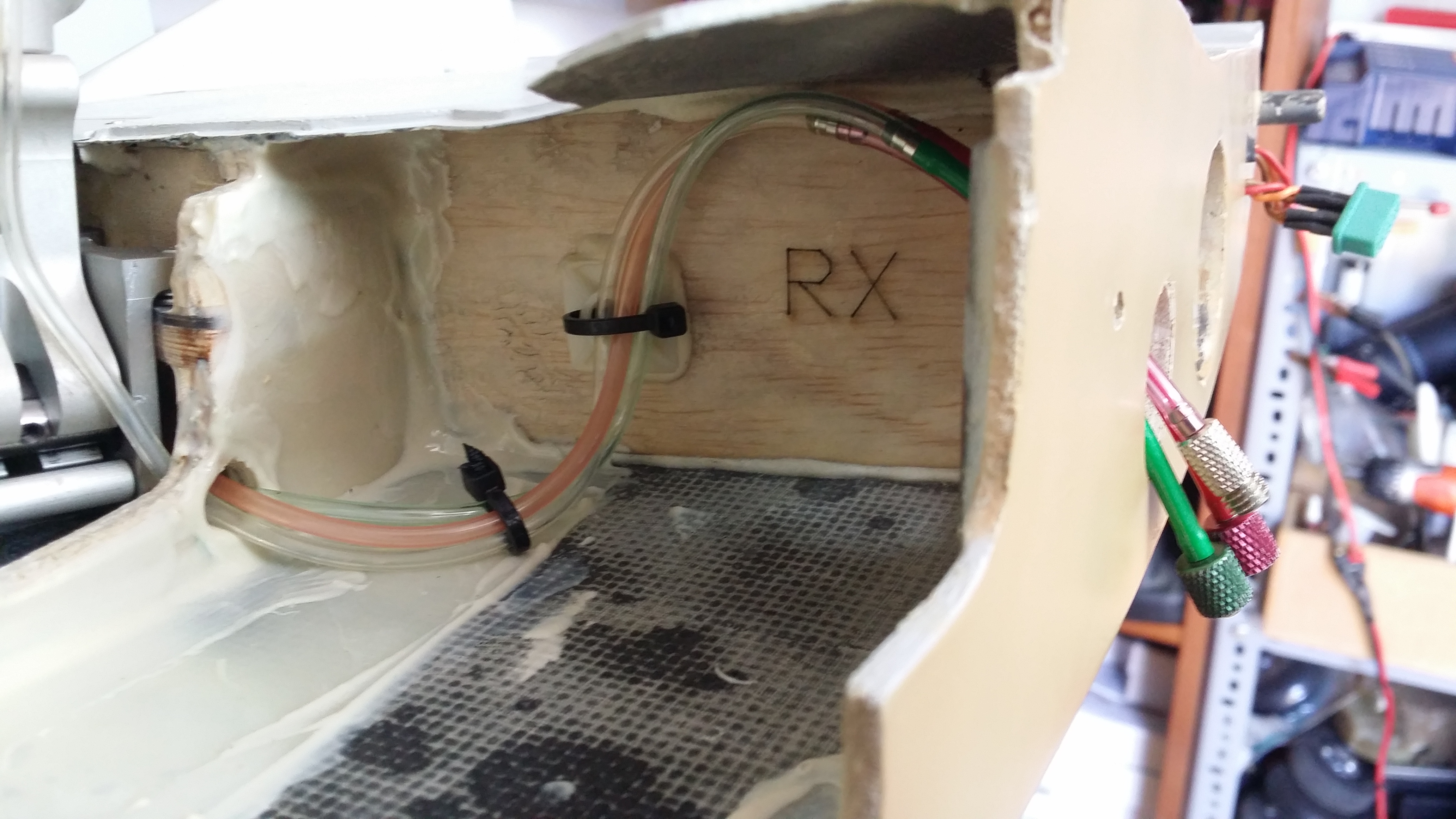

Hello Guys,
Thanks for your input, Another question is where do you run your Air lines from wing into the Fuselage. My servo leads are OK , but the Air lines look like they should be run forward near the gear.
John
Old 08-30-2015 | 04:25 AM
  #553
mhadjiky's Avatar
Joined: Dec 2006
Posts: 122
From: Nicosia, CYPRUS
John,
In the attached picture you can see what I have done on my Hawk

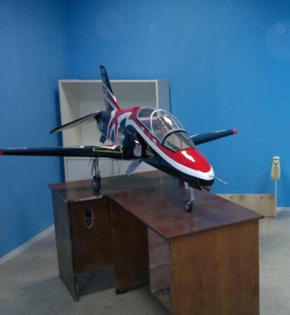

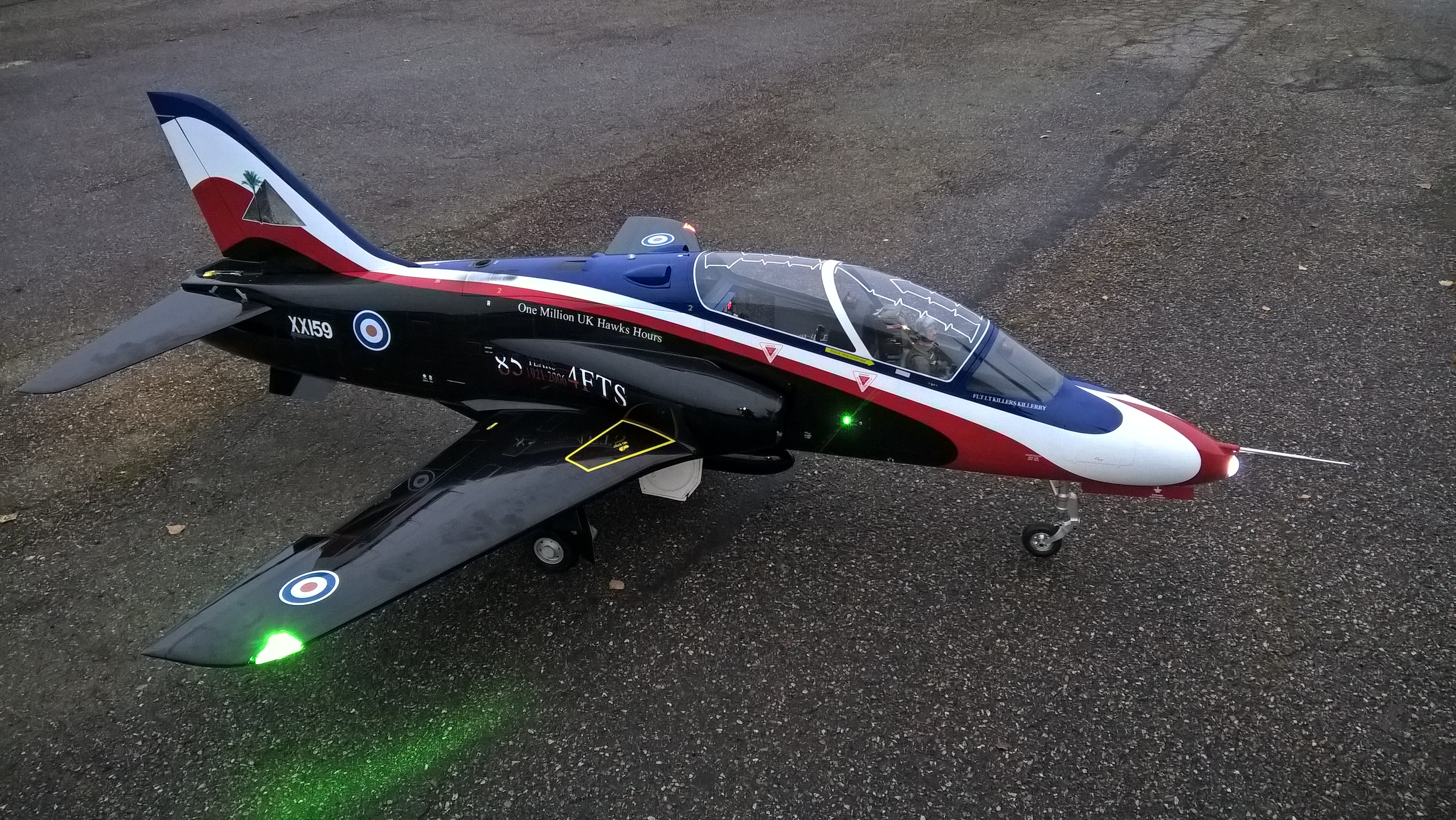

Hi friends,
I'm starting to build my dream the Hawk T1 4¾ scale in 2010 scheme.
The first view is - she is Great!
But I have a question- does anyone build for their Hawk vortex generators? If yes, are they work or just goode scale view?
I'm asking just because worry about not to have OFF elevator when deploying the flaps to landing position.
The second question- l'm planing to install the Kingtech K-140G, will it be enough? Any comments please.
Thank's
Kind regards,
Sergey

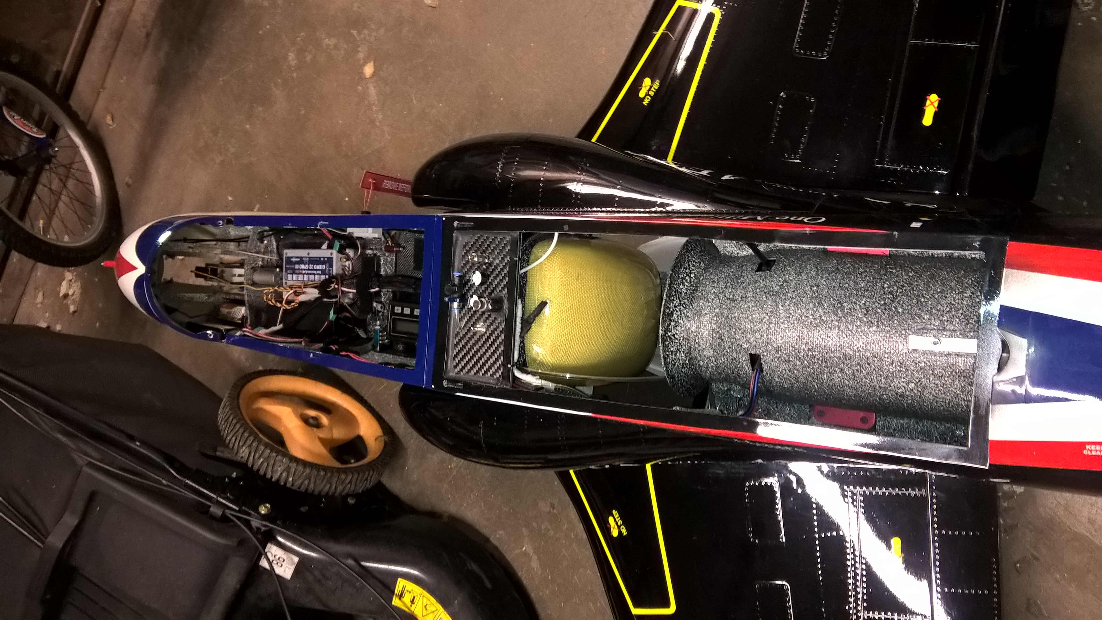

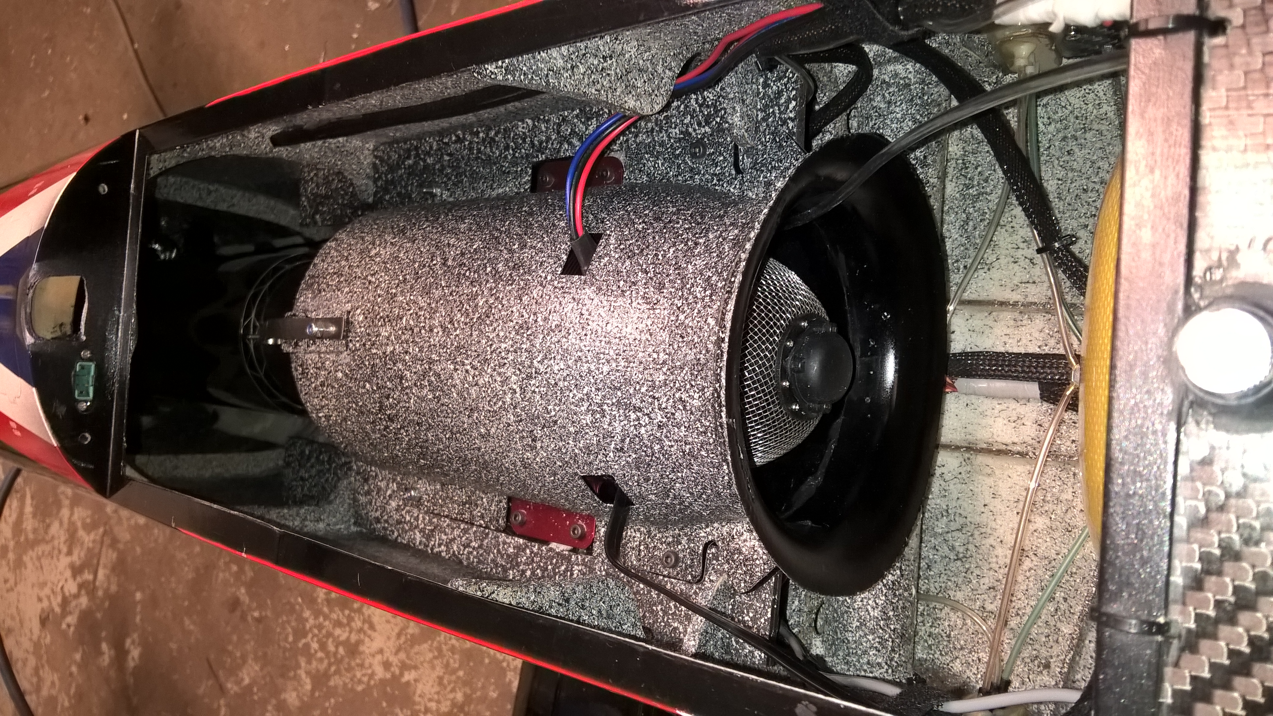

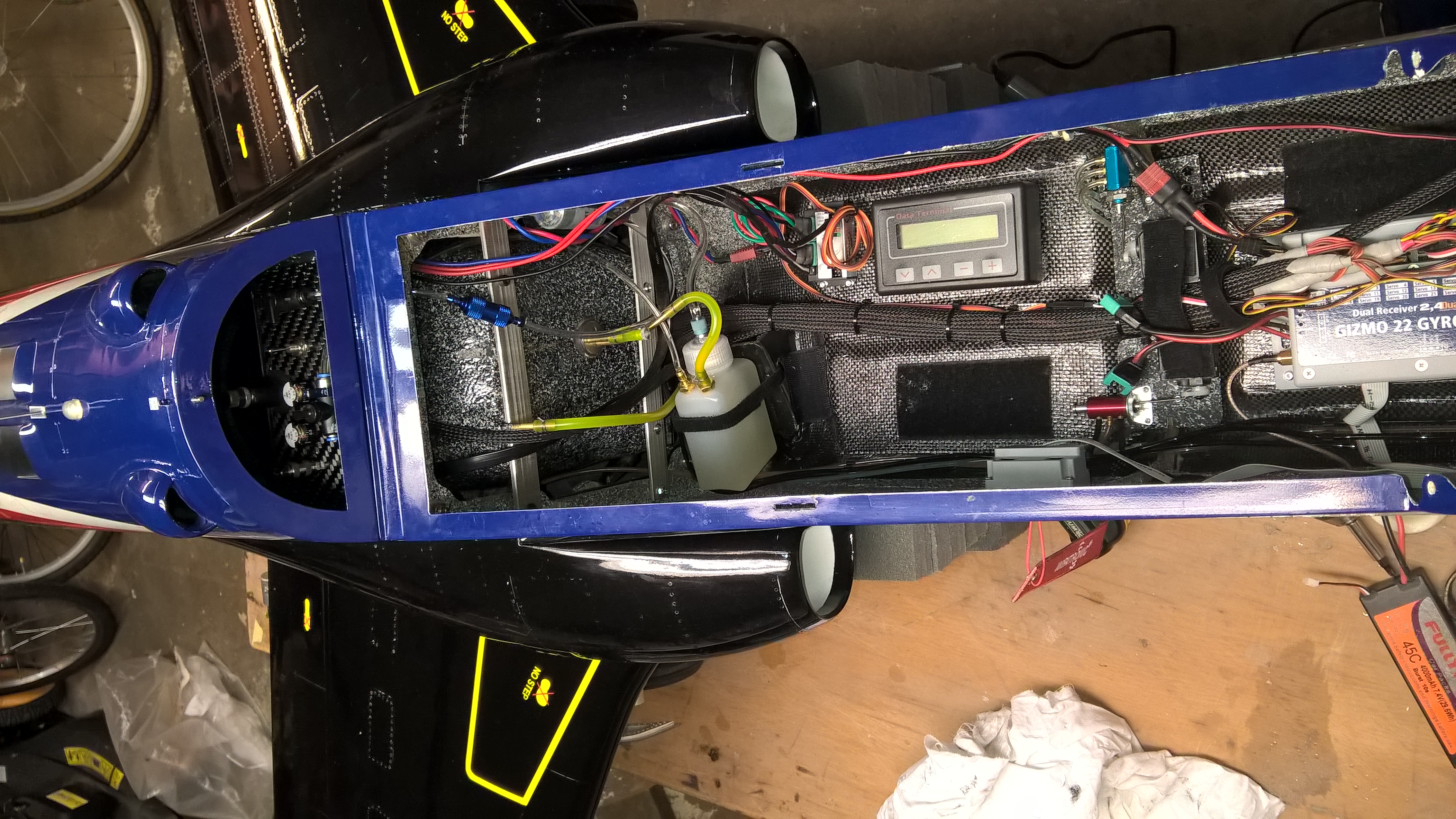

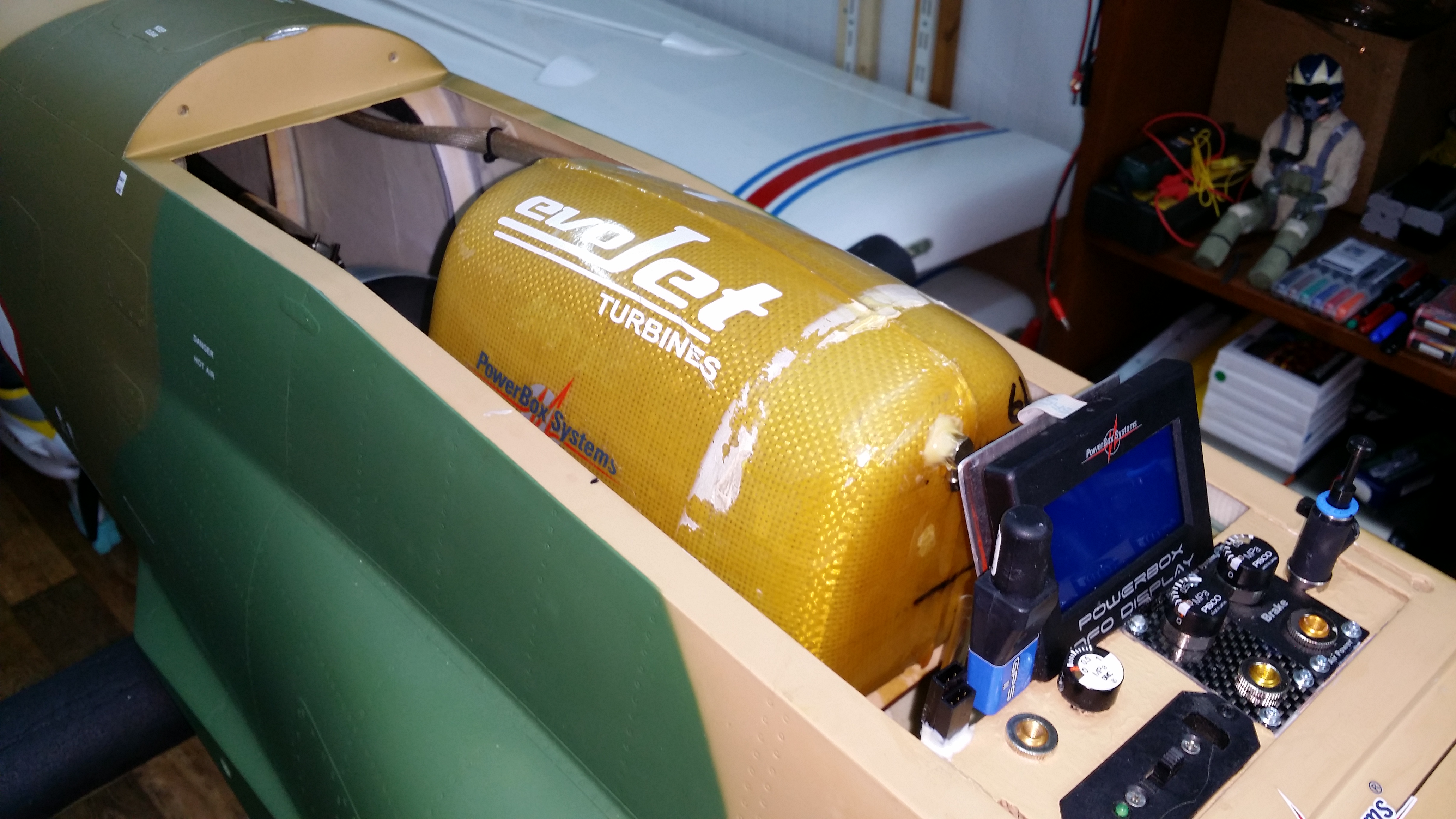

Here is my solution in place of the tank near the CG and more space for the cabin
ID:	2141493   Click image for larger version
ID:	2141494   Click image for larger version
ID:	2141495   Click image for larger version
ID:	2141496   Click image for larger version

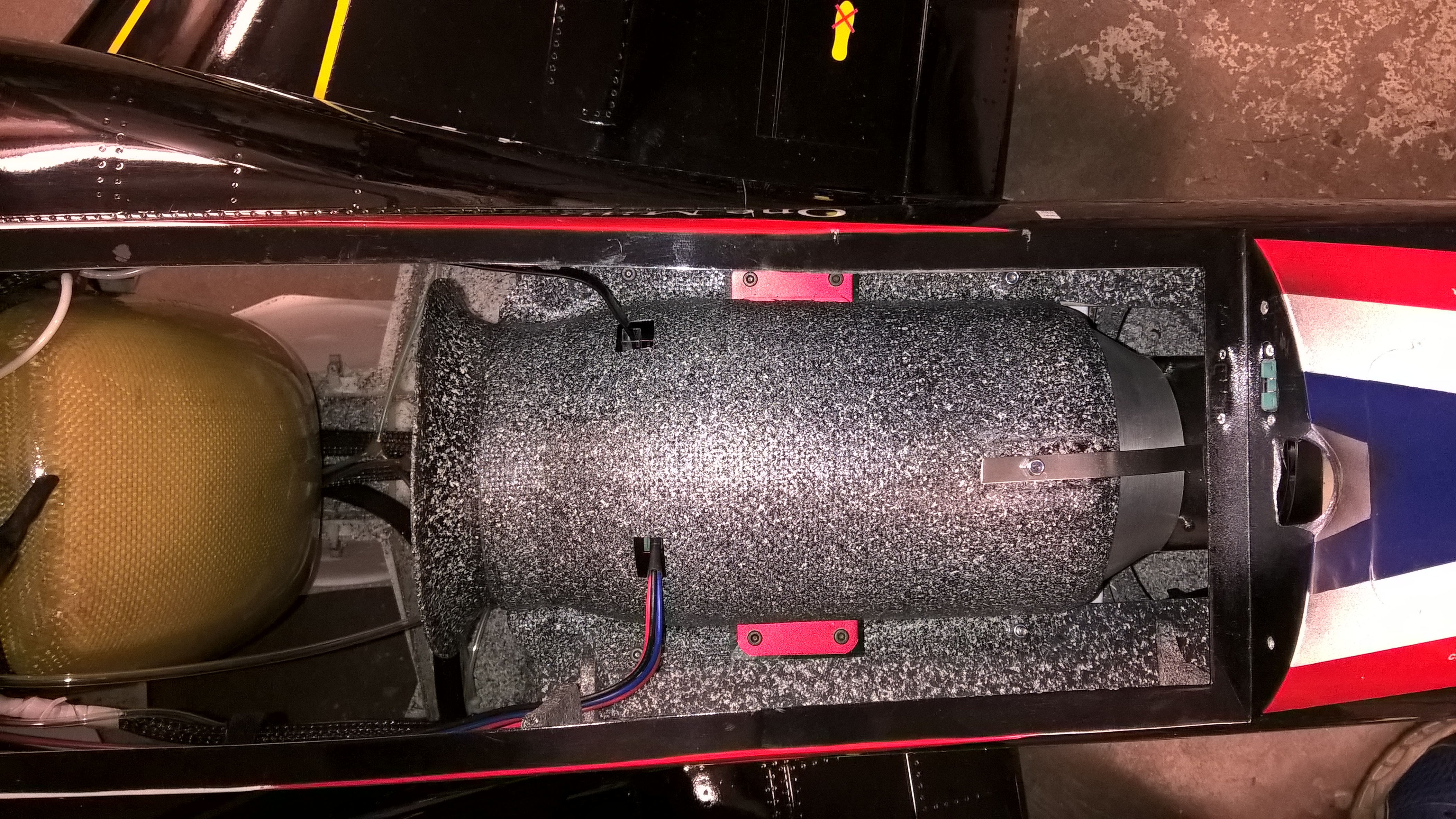

more pictures, cut the channels so I can put the tank where I want it
ID:	2141498   Click image for larger version
ID:	2141499   Click image for larger version
ID:	2141500   Click image for larger version
ID:	2141501   Click image for larger version
