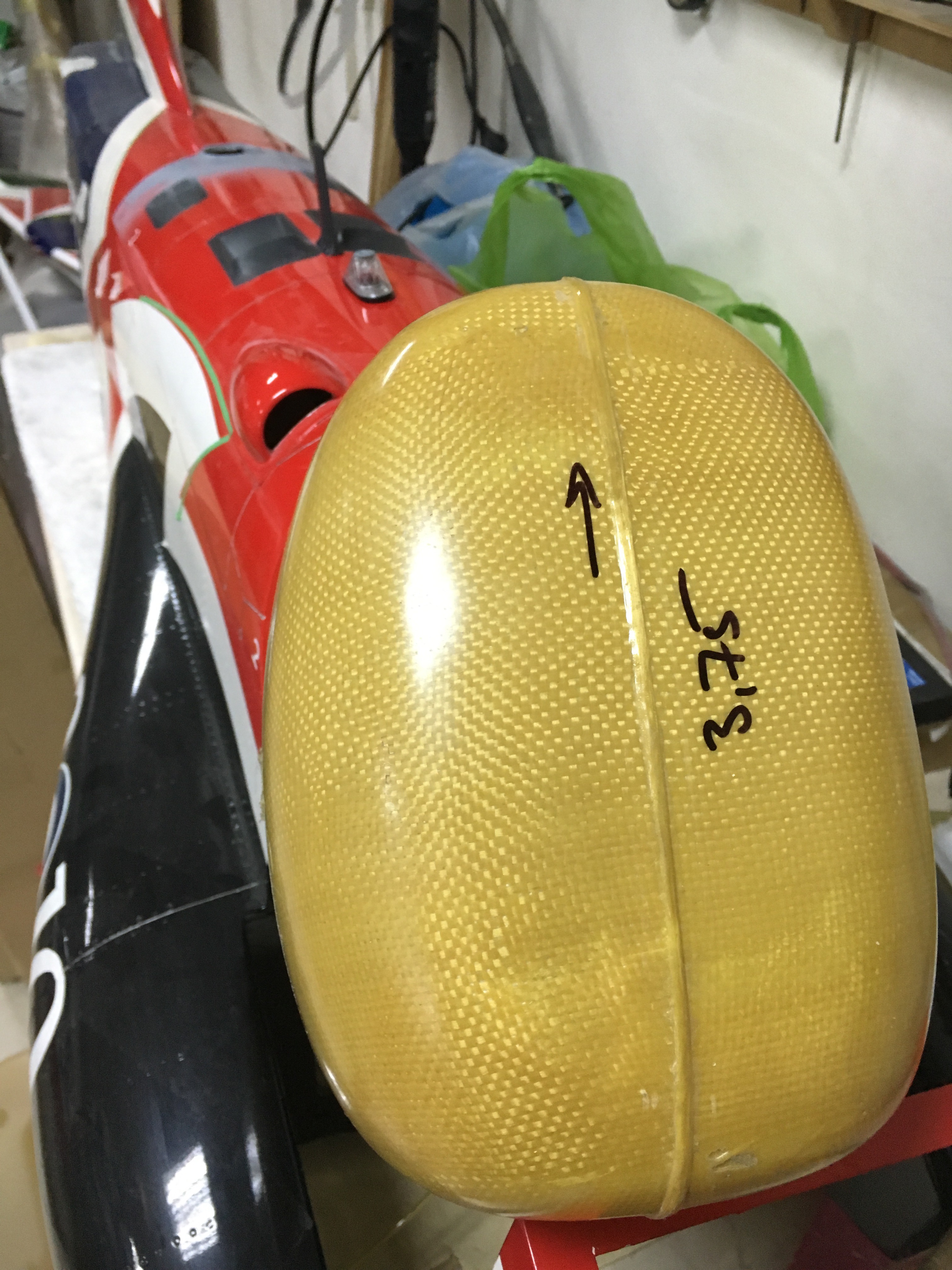

Old 08-22-2016 | 01:01 PM
  #606
helifox's Avatar
Joined: Apr 2014
Posts: 125
From: Krasnodar, RUSSIAN FEDERATION

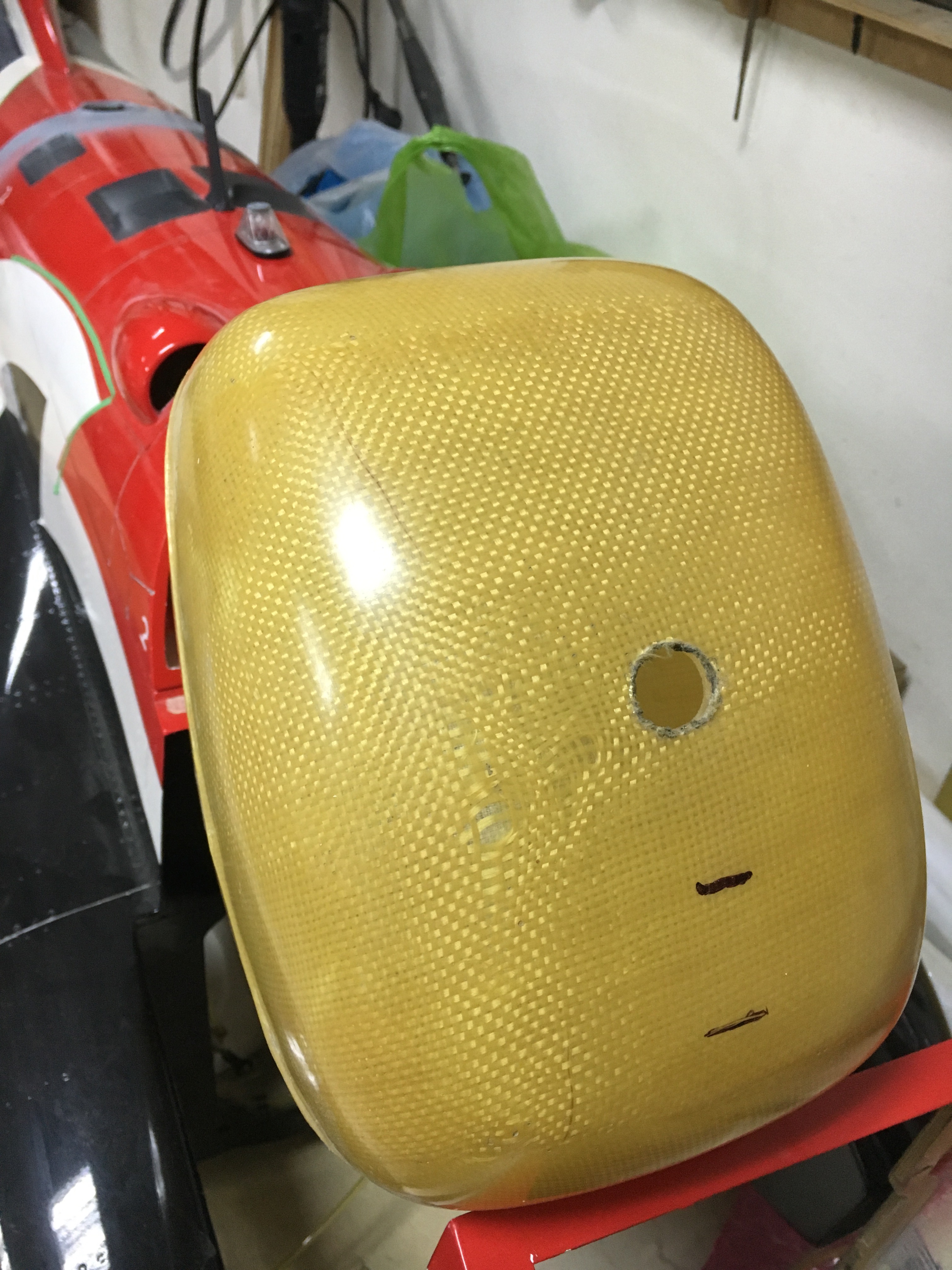

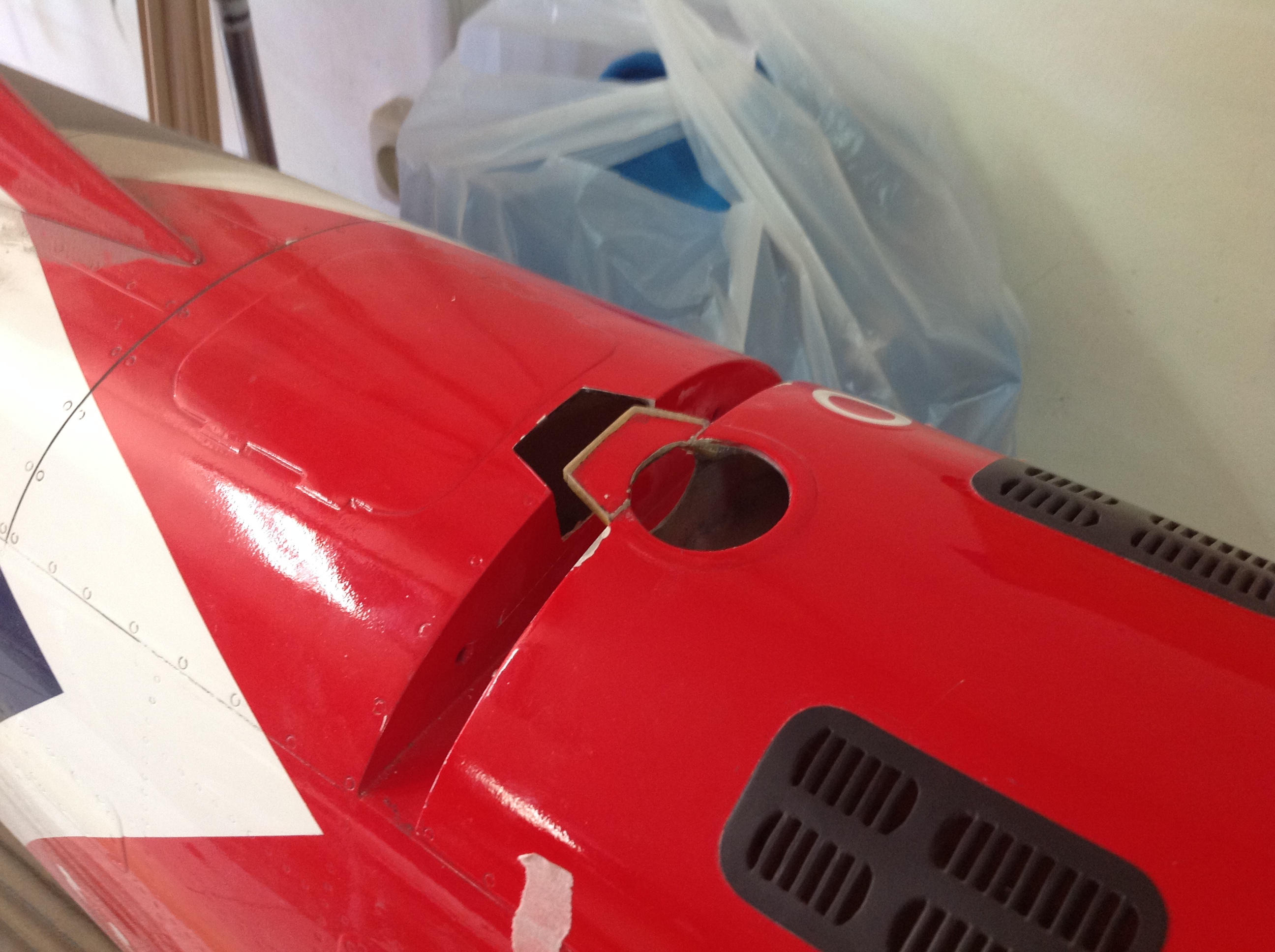

Hi friends,
i have one very important question for me, what of fuel tank are you using? Are you using standart (from SkyMaster) one?
I just megured mine it's 3,75 lit and I'm worried it's not enough for K-160g (fuel consumption is 490 g/min), about 6-7 min of flight max to empty (I prefer to have in remaining 0,5-0,7 lit after landing in case of go-around).
Kind regards,
Sergey

Old 08-22-2016 | 04:20 PM
  #607
My Feedback: (16)
Joined: Sep 2003
Posts: 504
From: Fremont , OH
I added a 48OZ tank in the turtle deck.
K.O.

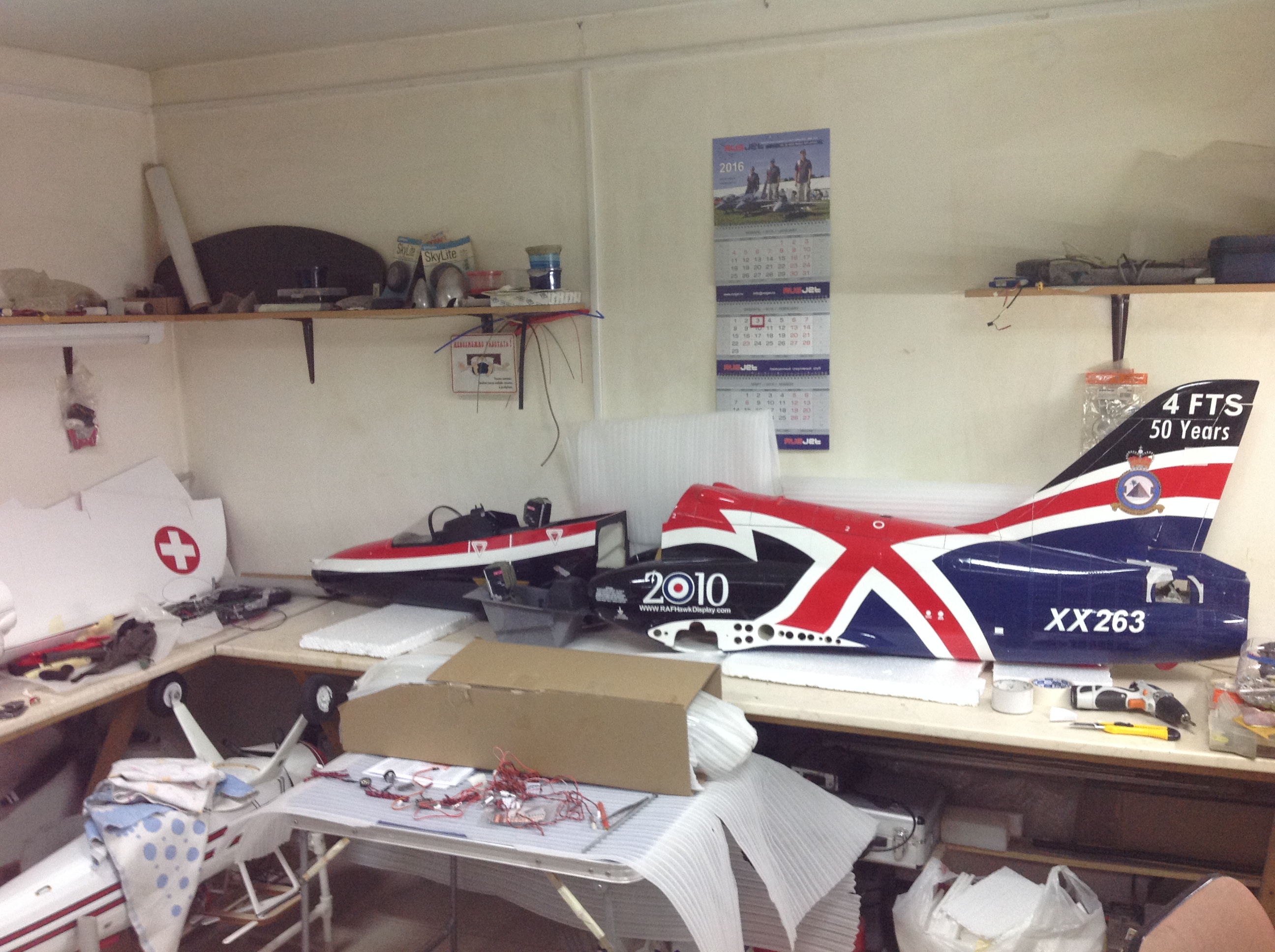

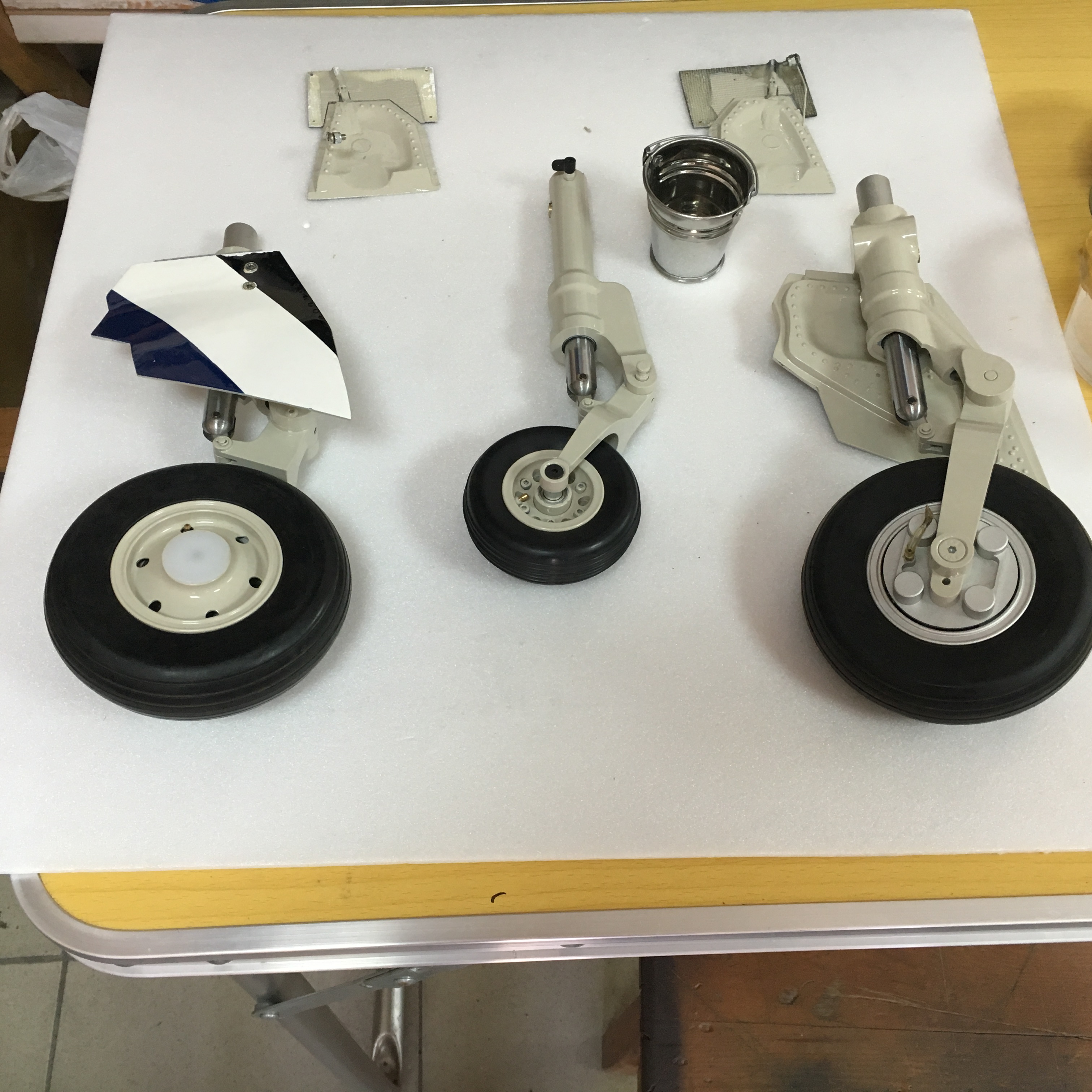

Old 09-03-2016 | 11:49 PM
  #609
helifox's Avatar
Joined: Apr 2014
Posts: 125

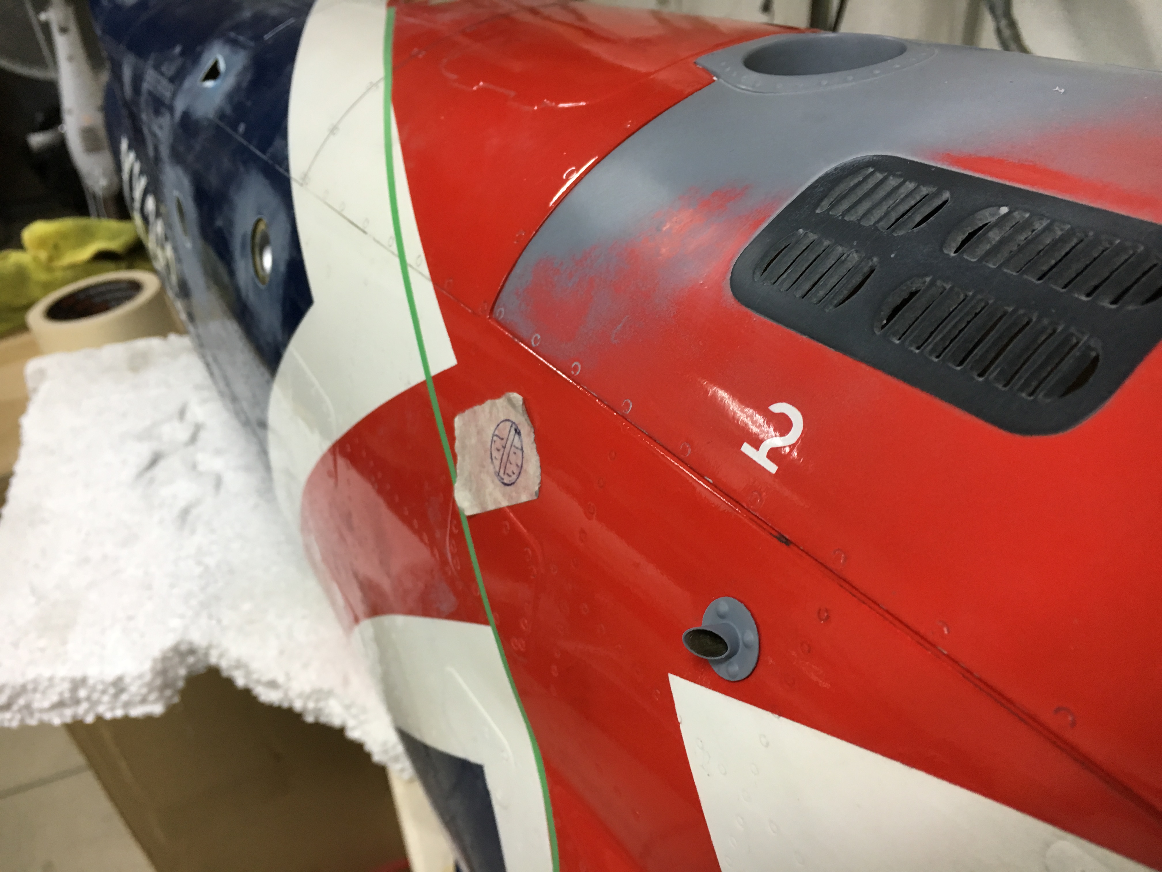

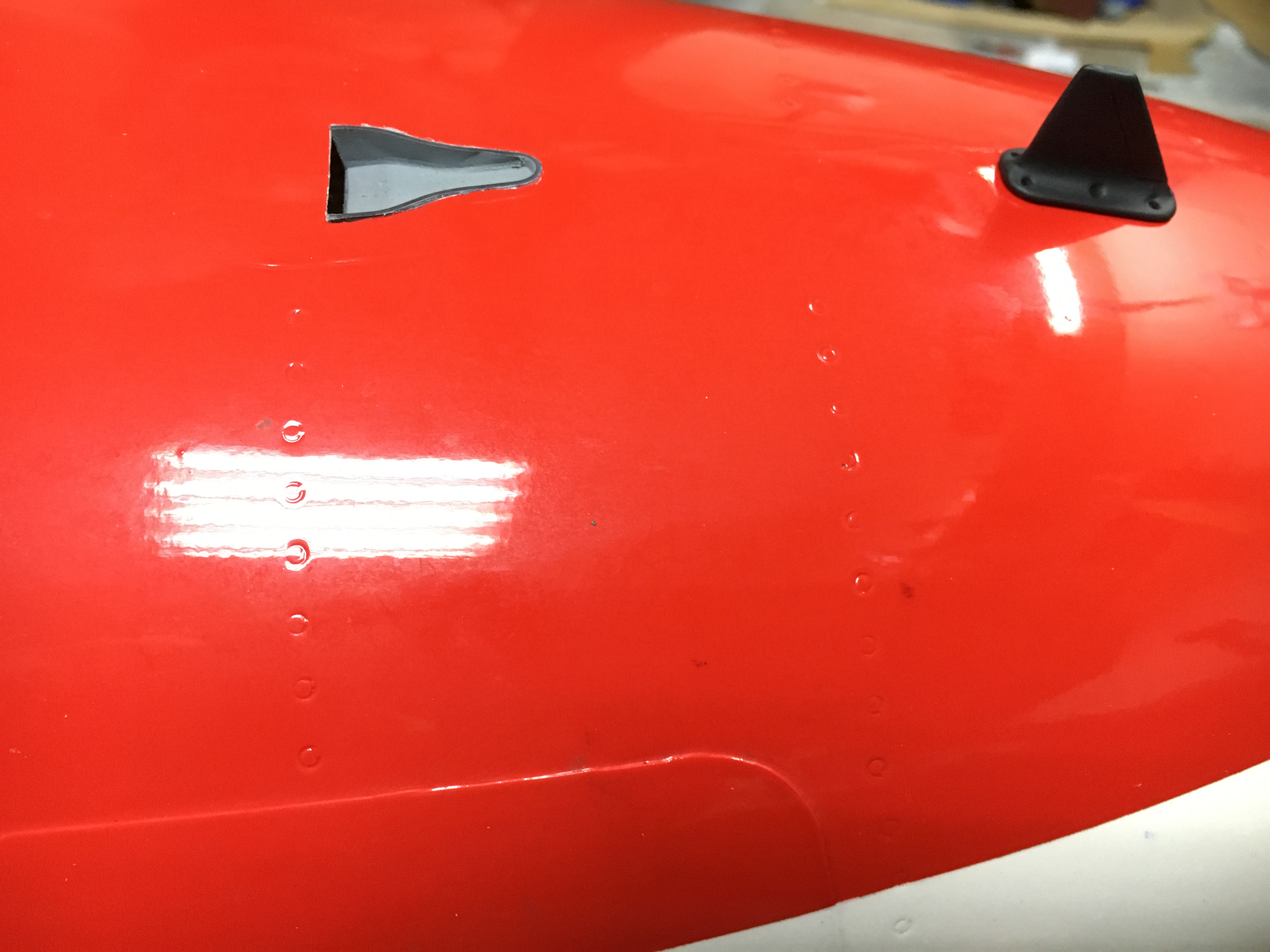

Hi to all,
there is my progress to build the simple ARF more scale
Will repaint Hawk partly, there a lot of mistakes with library around model. On my opinion - to have more scale model is better to by unpainted.
Kind regards,
Sergey

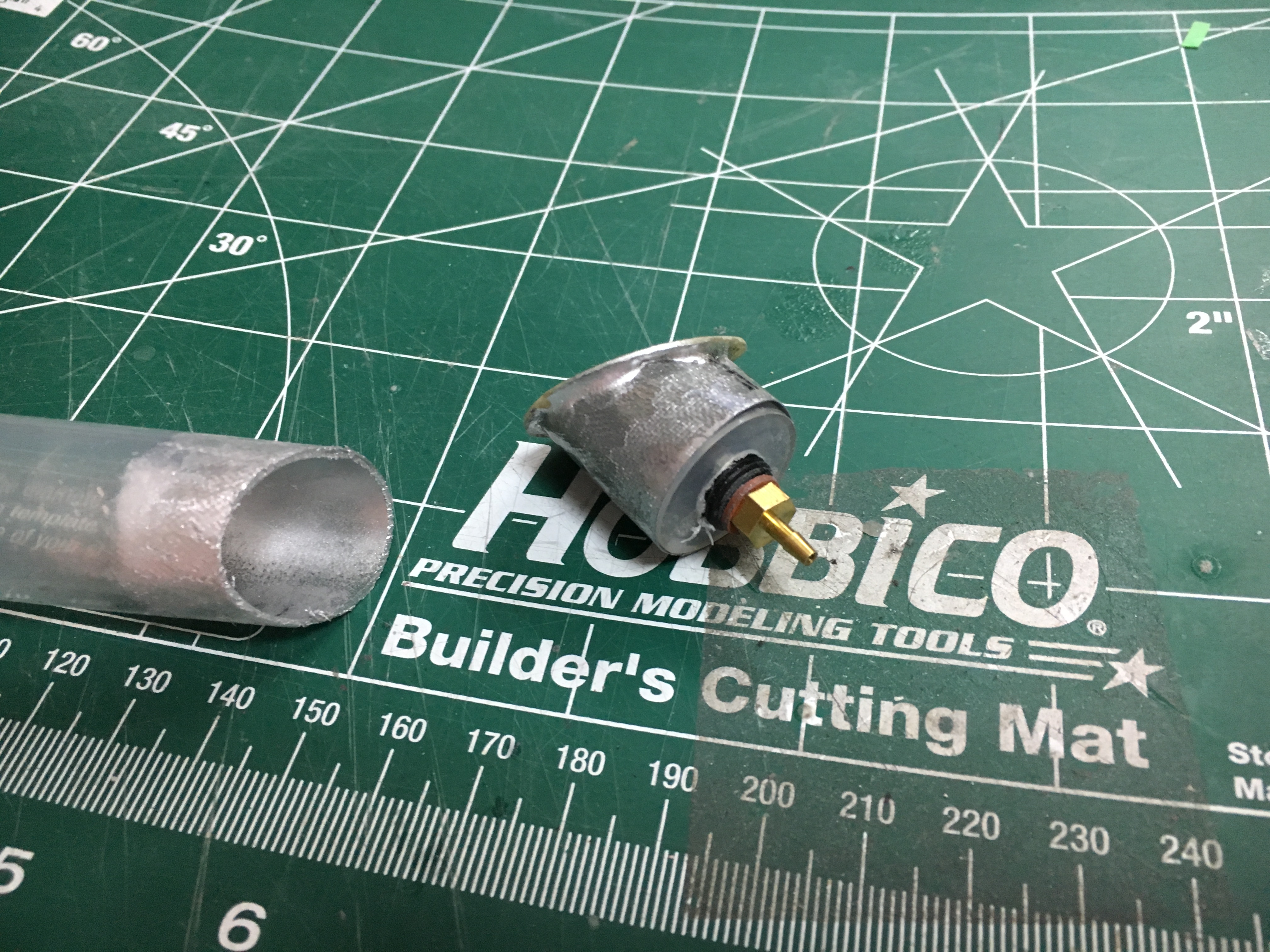

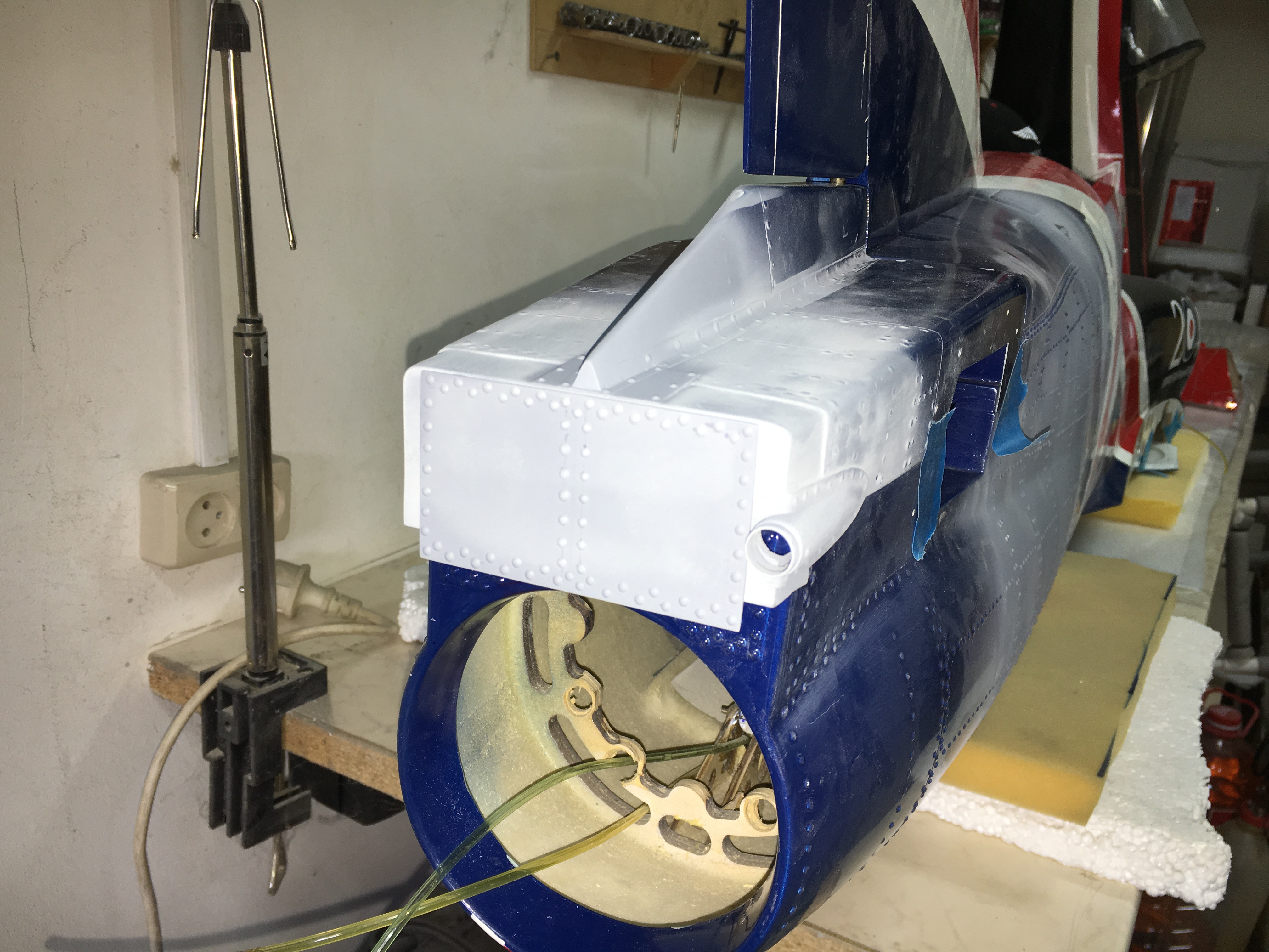

Old 09-05-2016 | 08:55 AM
  #610
helifox's Avatar
Joined: Apr 2014
Posts: 125

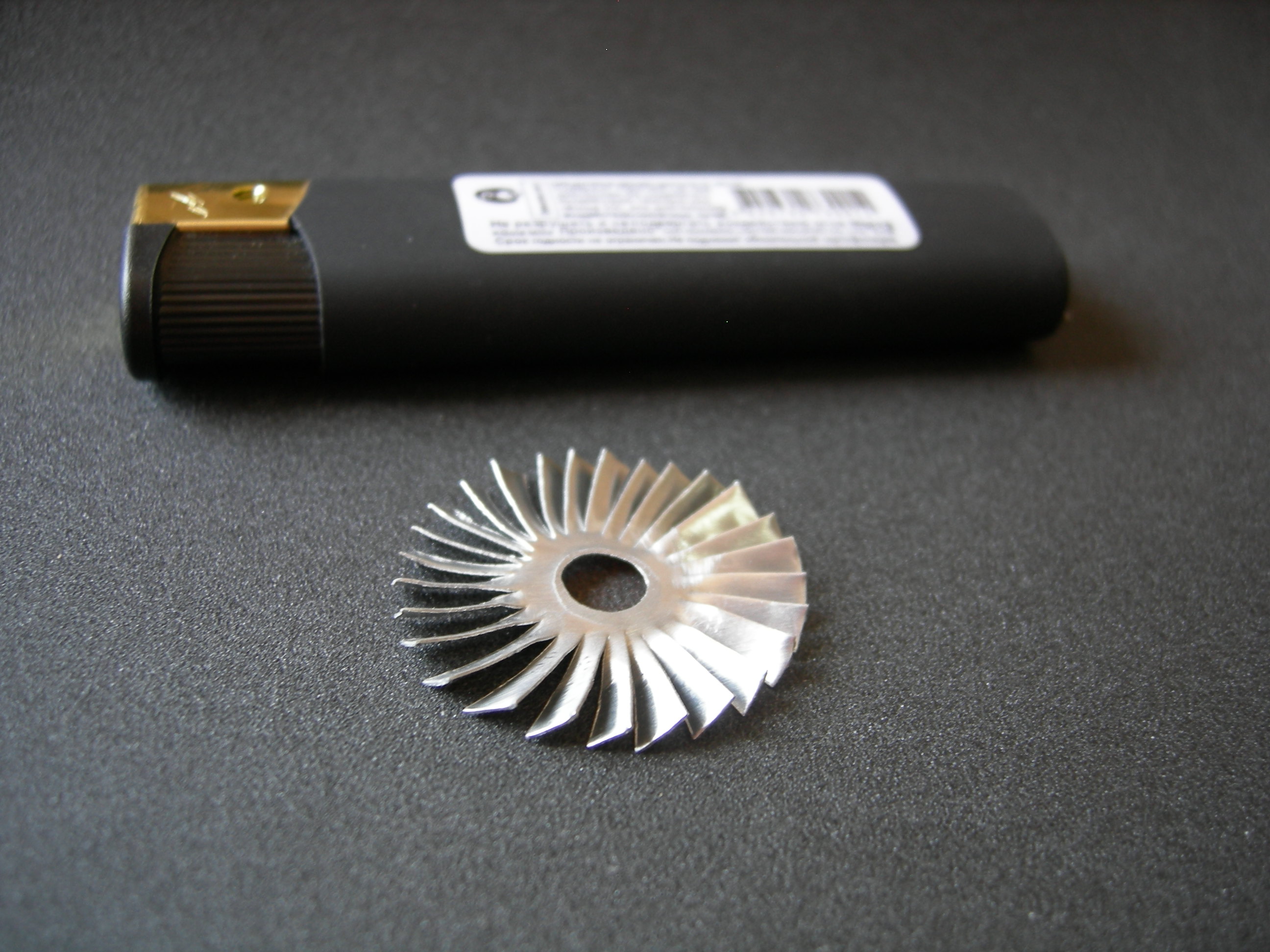

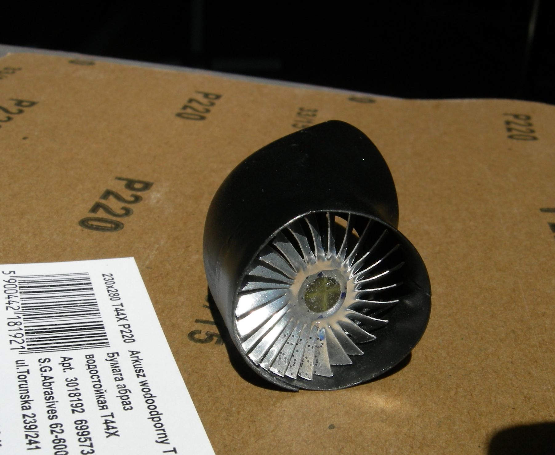

Just for relax..
the EPU exhaust pipe with imitation of turbine wheel, later will integrate to the engine bay cowl
Kind regards,
Sergey

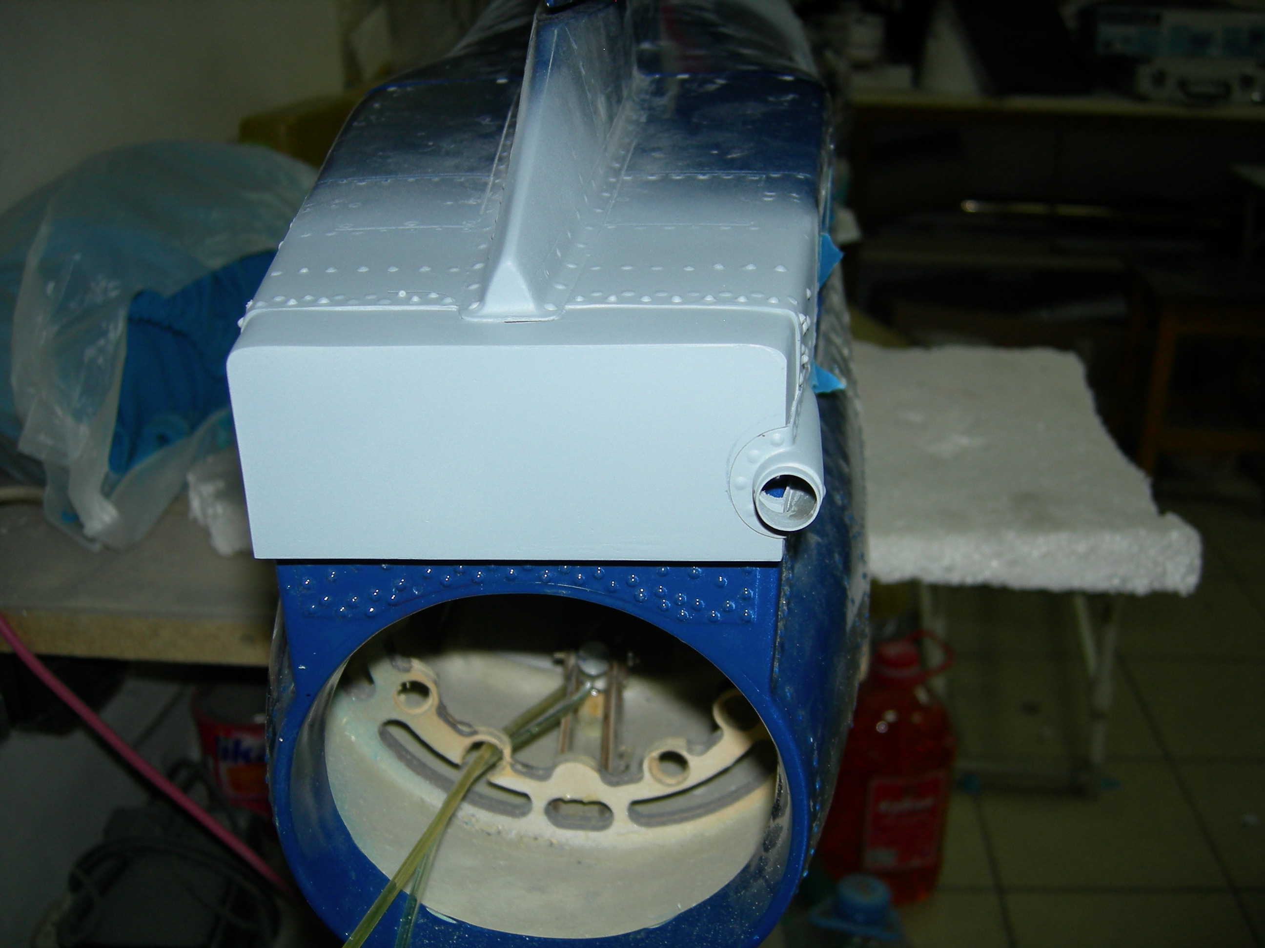

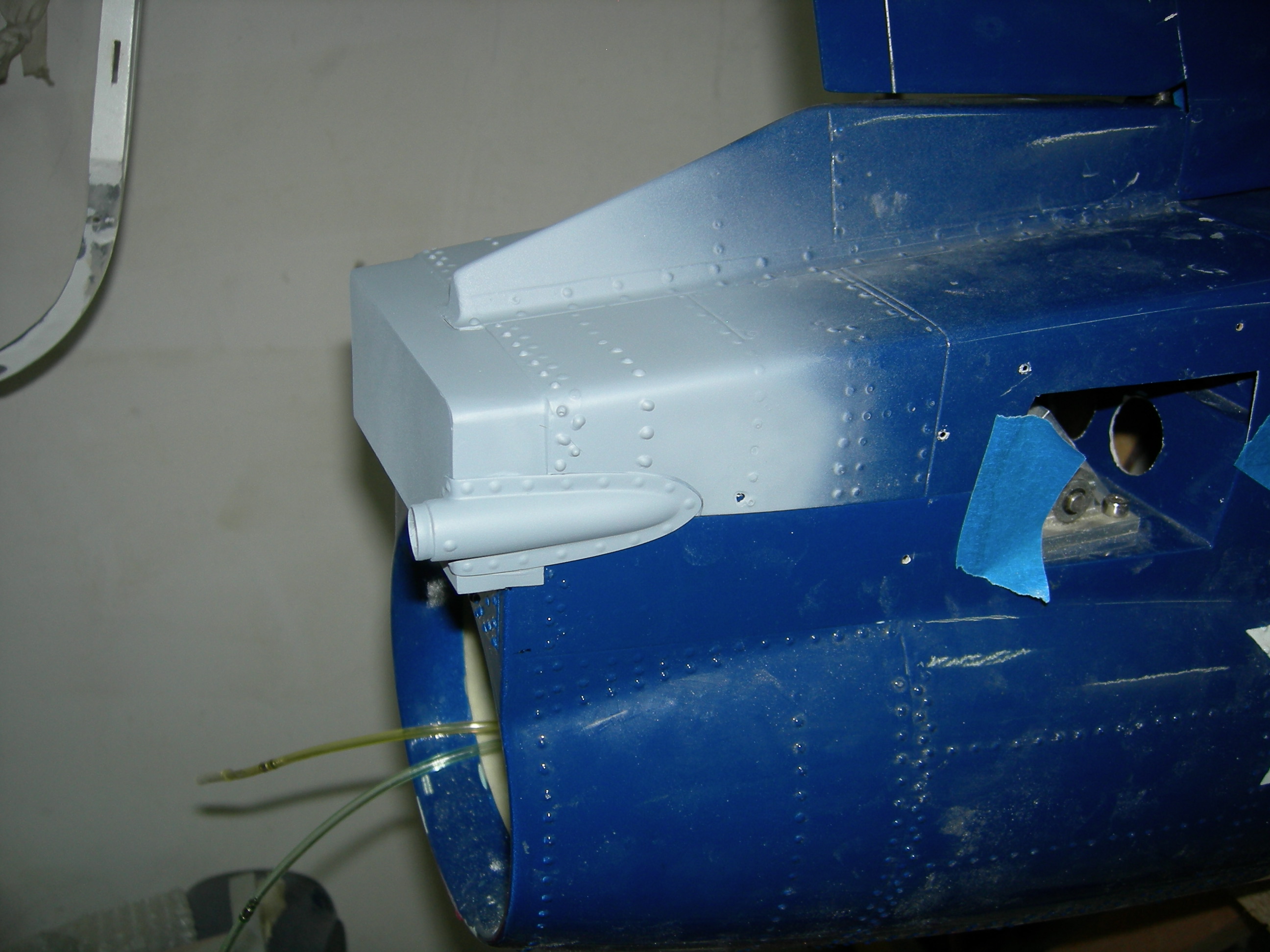

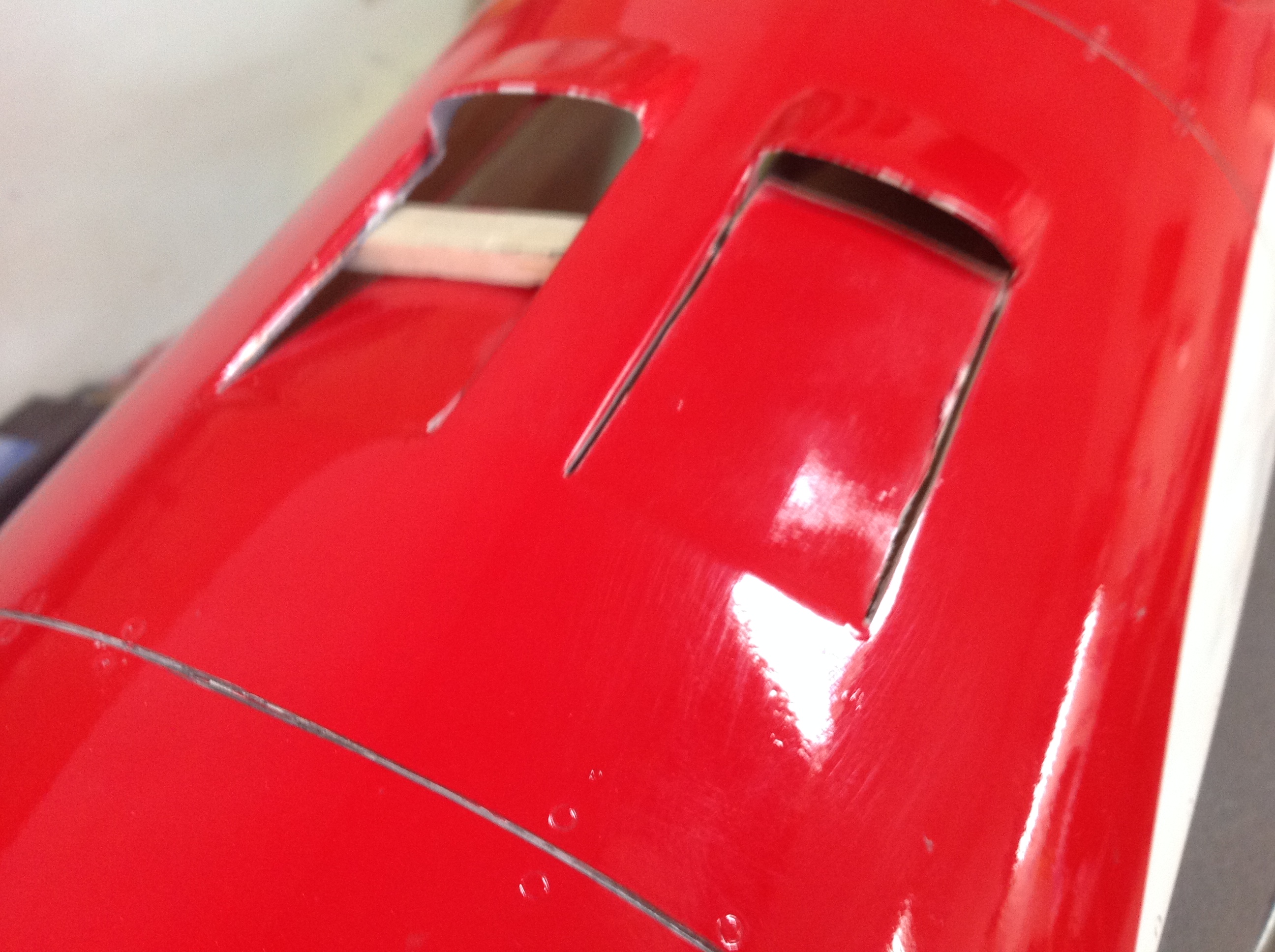

Old 09-30-2016 | 08:44 AM
  #611
helifox's Avatar
Joined: Apr 2014
Posts: 125

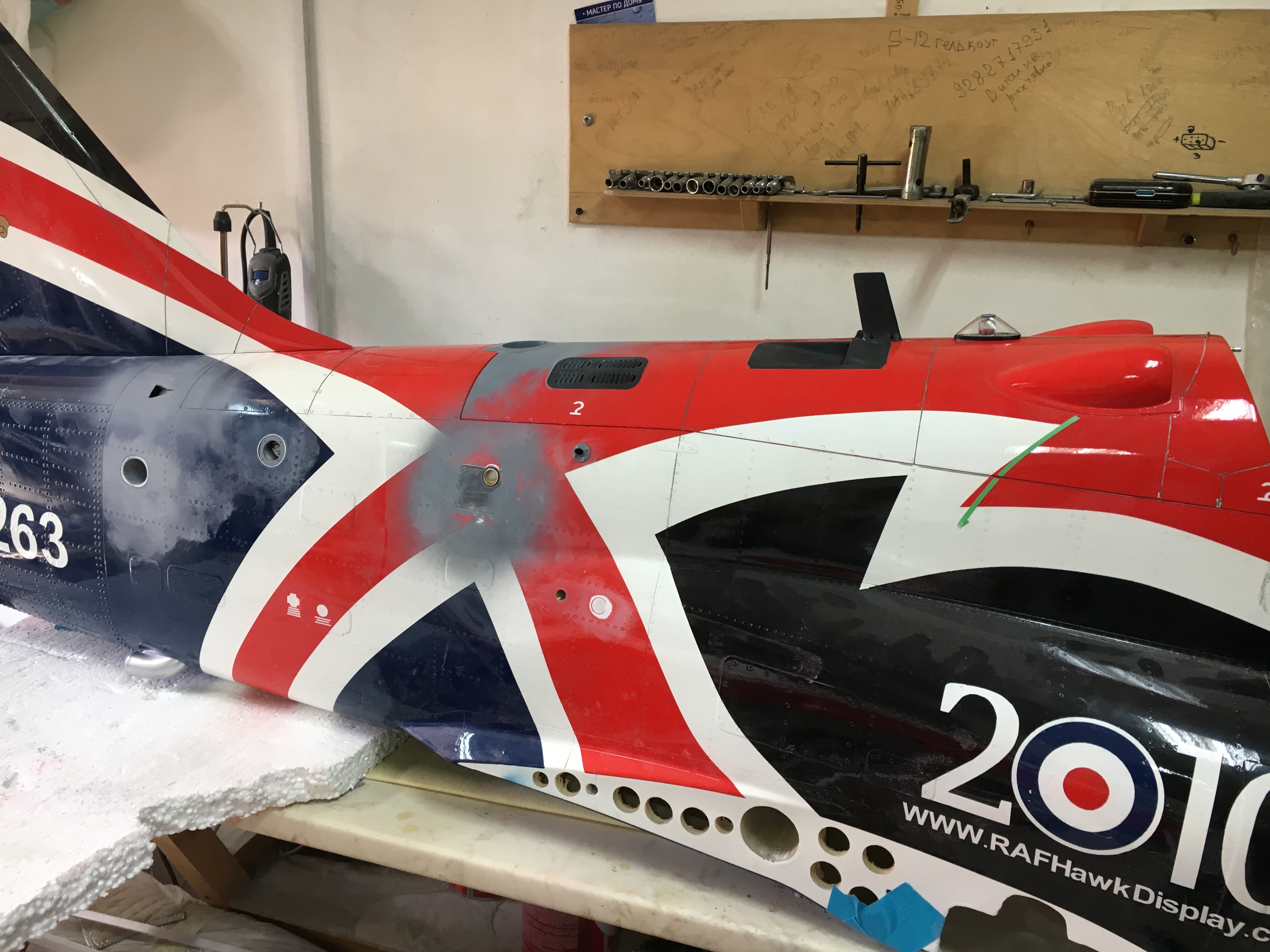

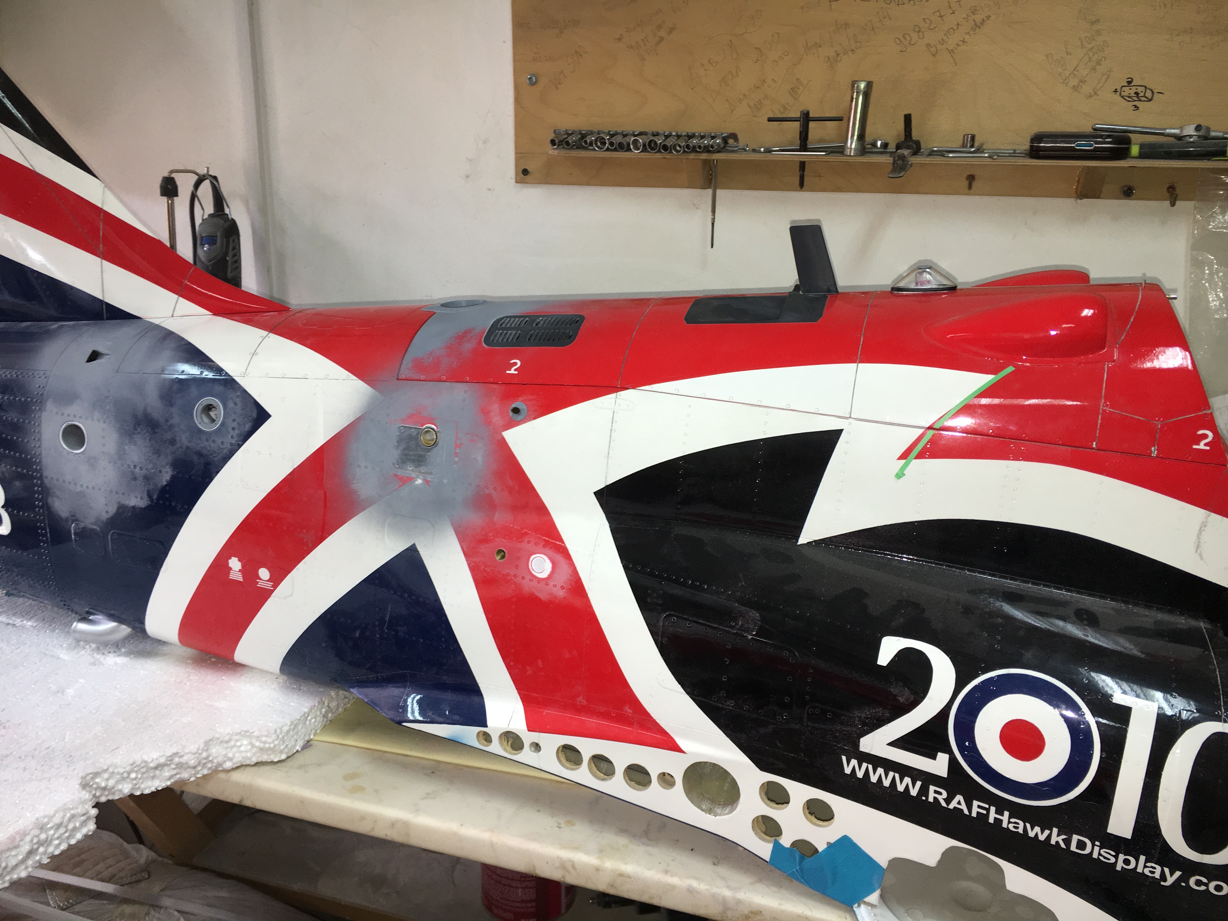

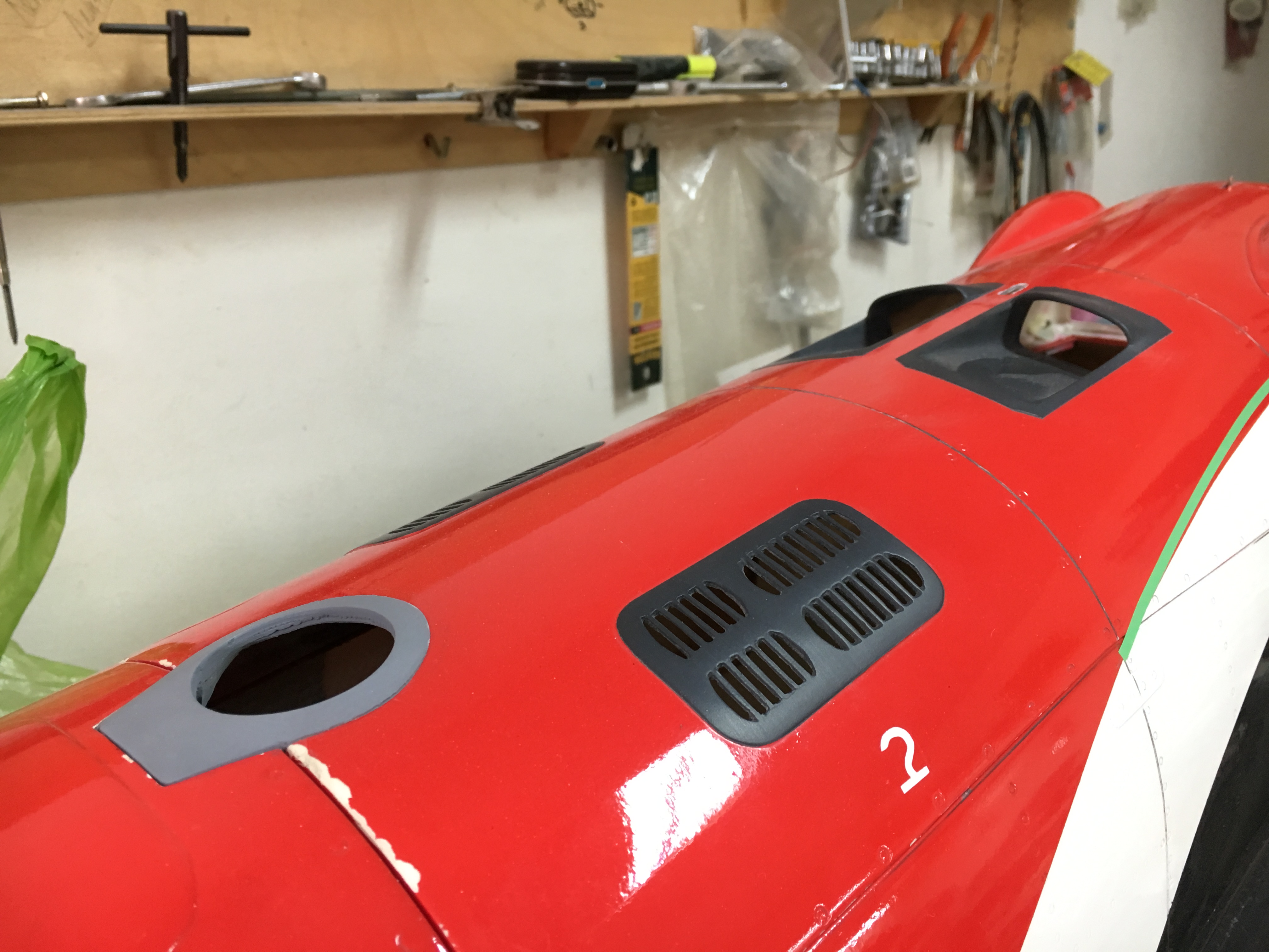

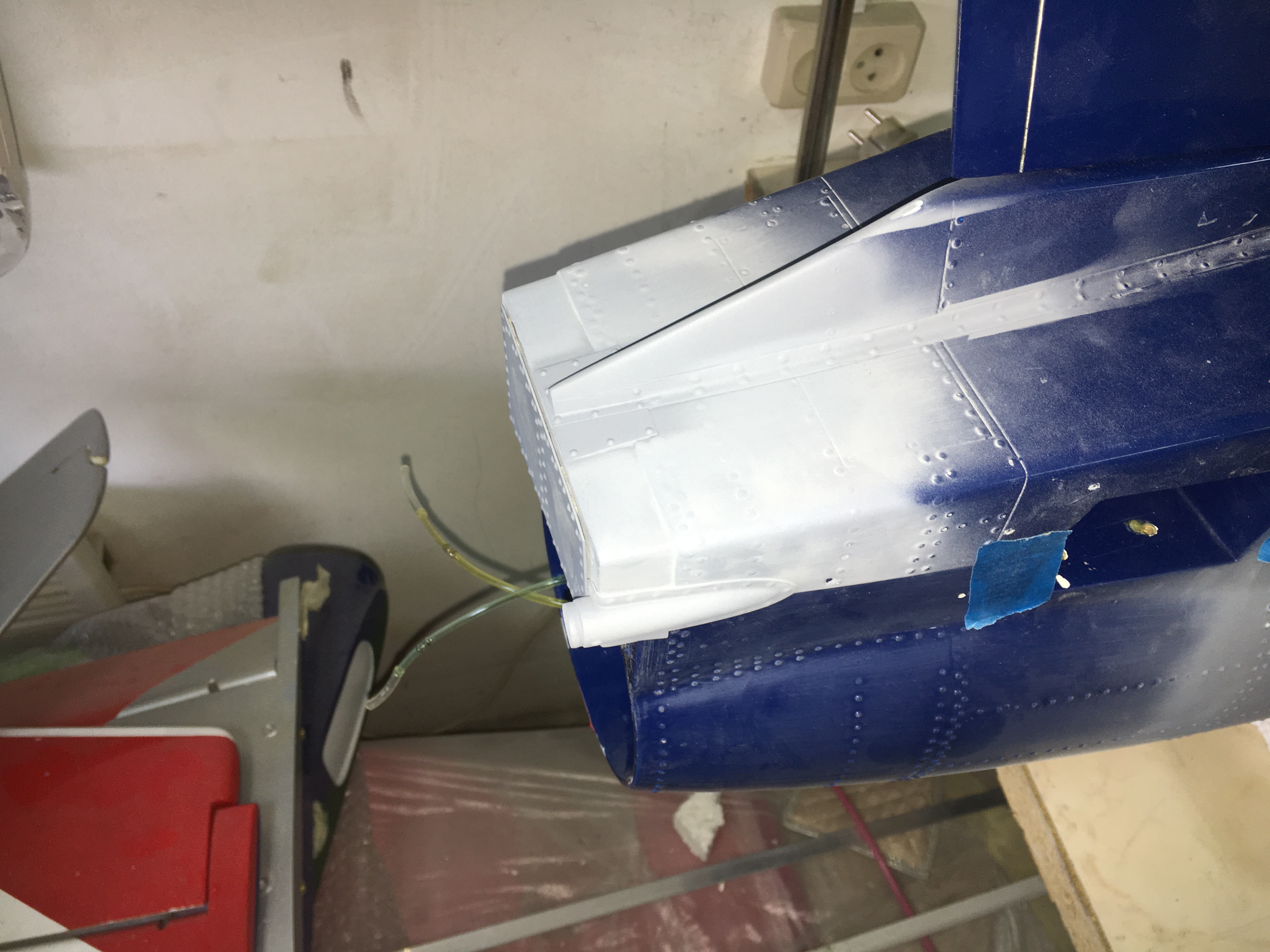

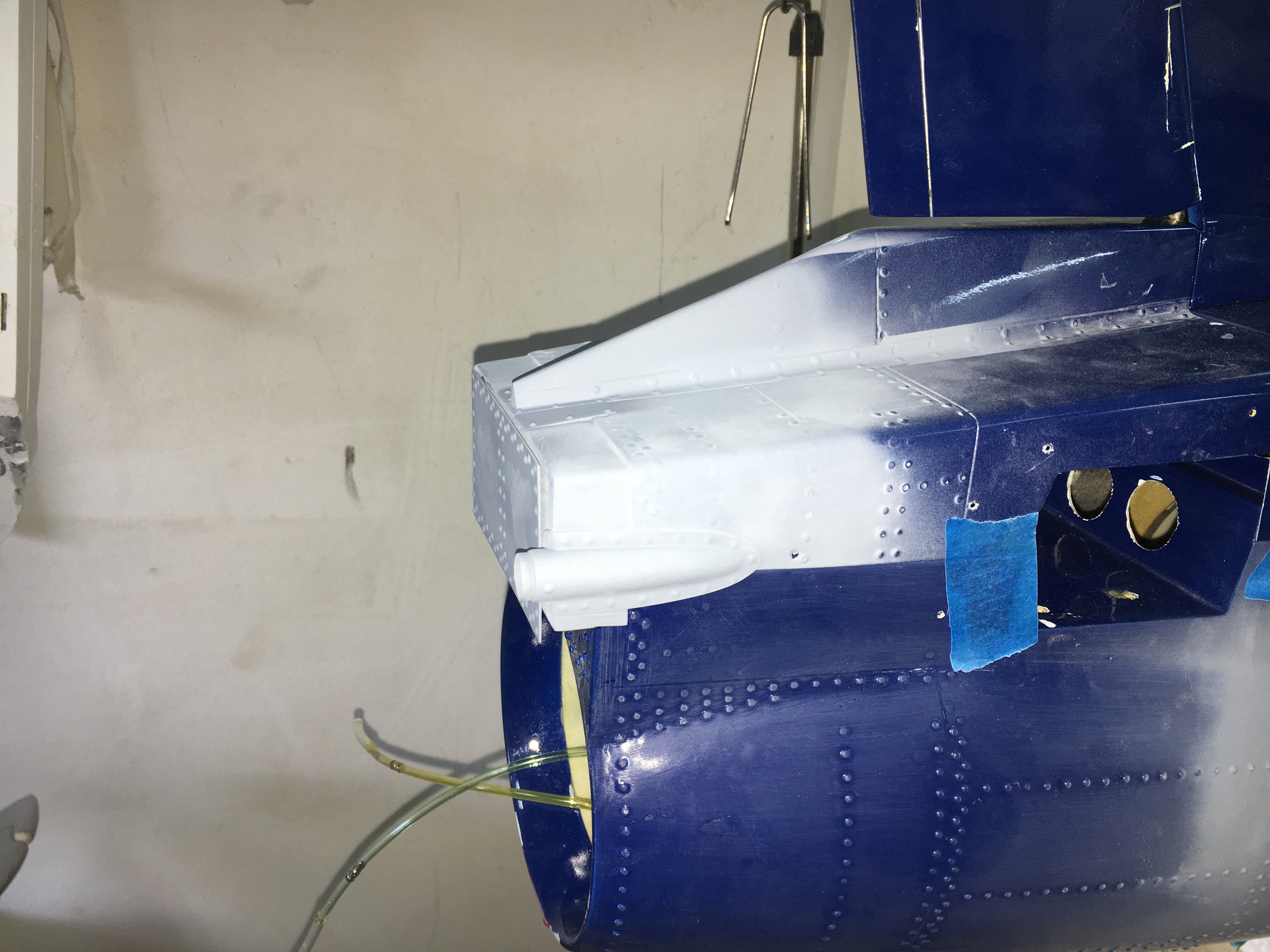

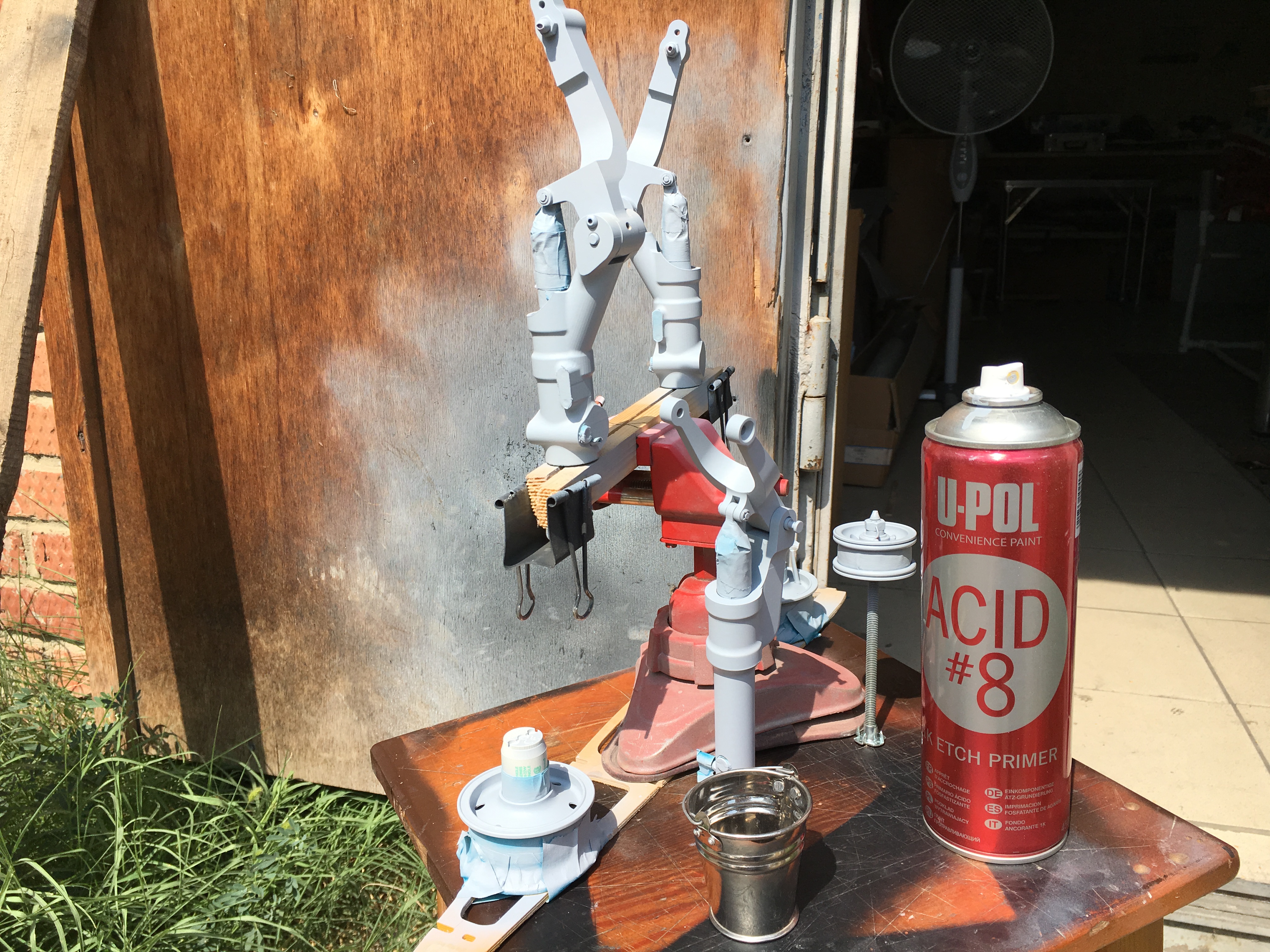

Hi friends,

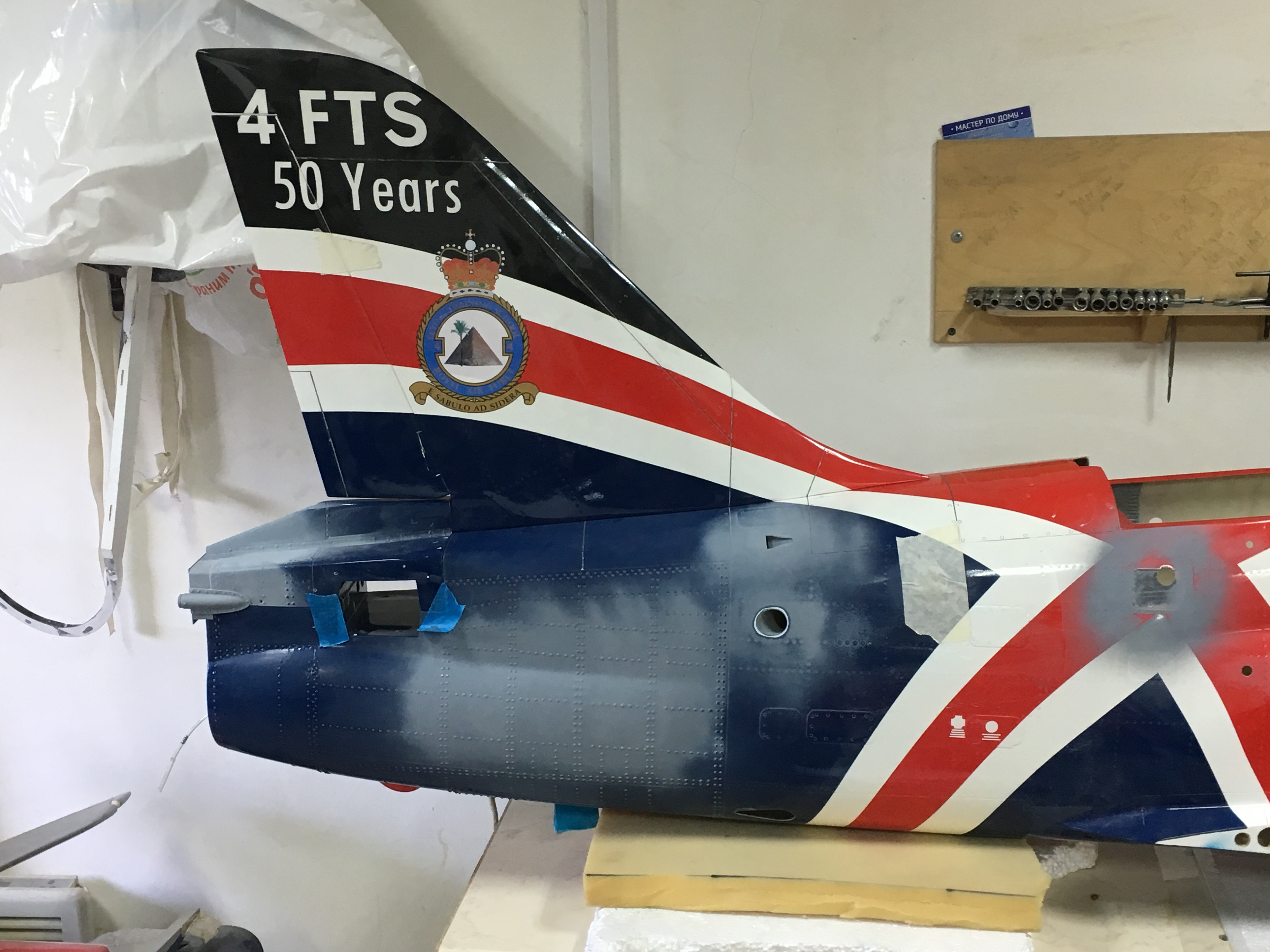

there is my progress to bring stock model to more scale, almost works with airframe have done. The next stage is to operate with wings, then to repaint according to prototype paint scheme (the blue color is too dark, lots of mistake with line configuration....).
Kind regards,
Sergey

Old 10-01-2016 | 05:40 AM
  #612
Joined: Dec 2002
Posts: 1,426
Received 6 Likes on 6 Posts
From: PERTH, AUSTRALIA

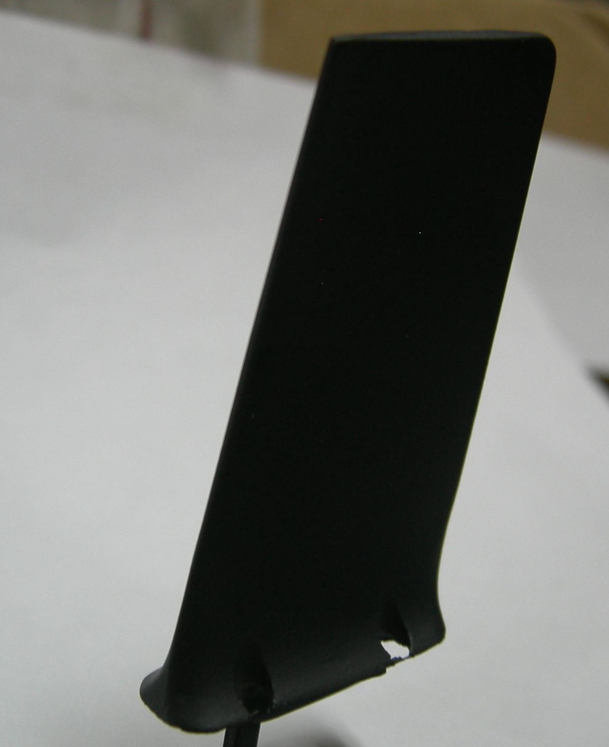

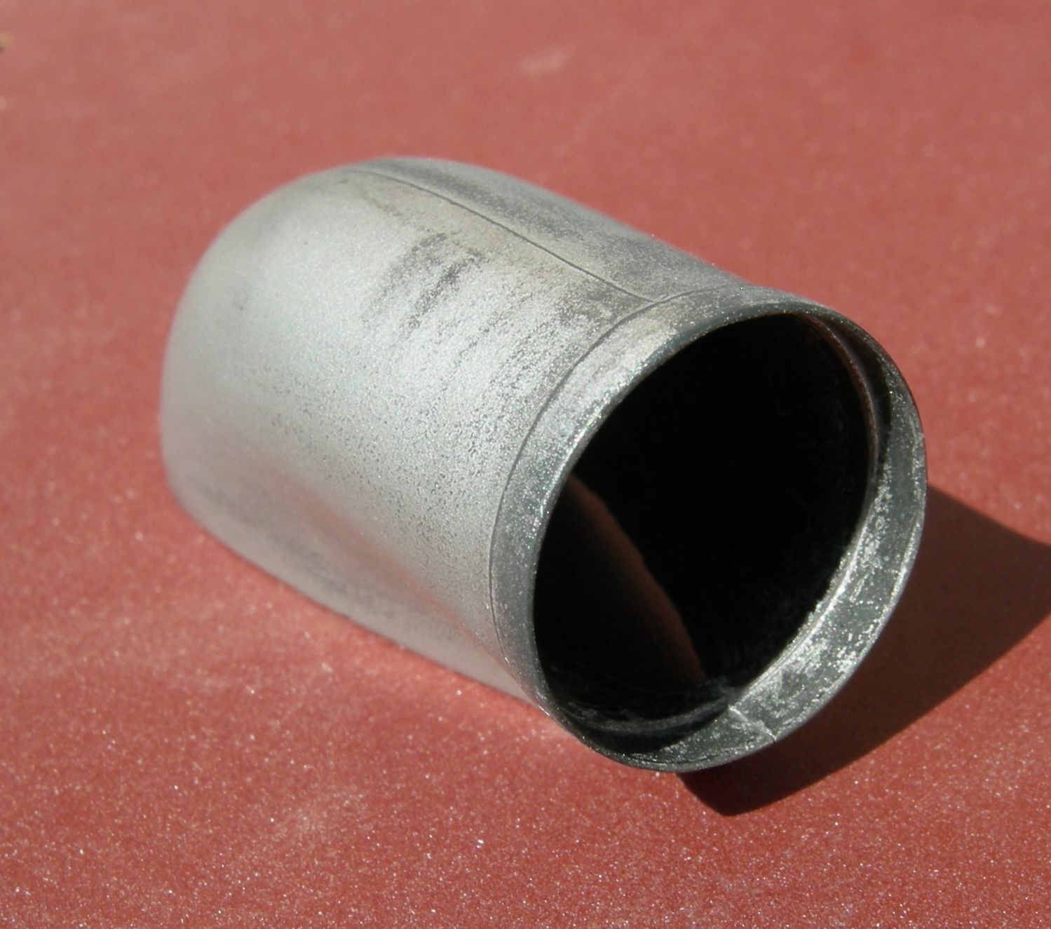

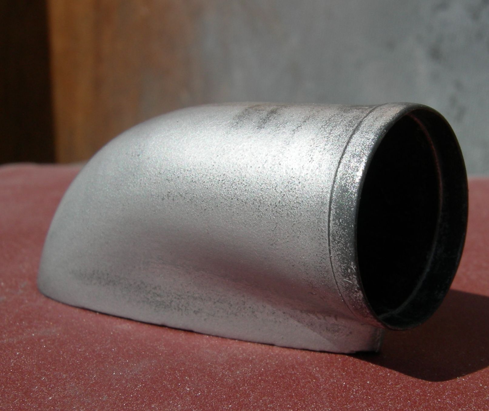

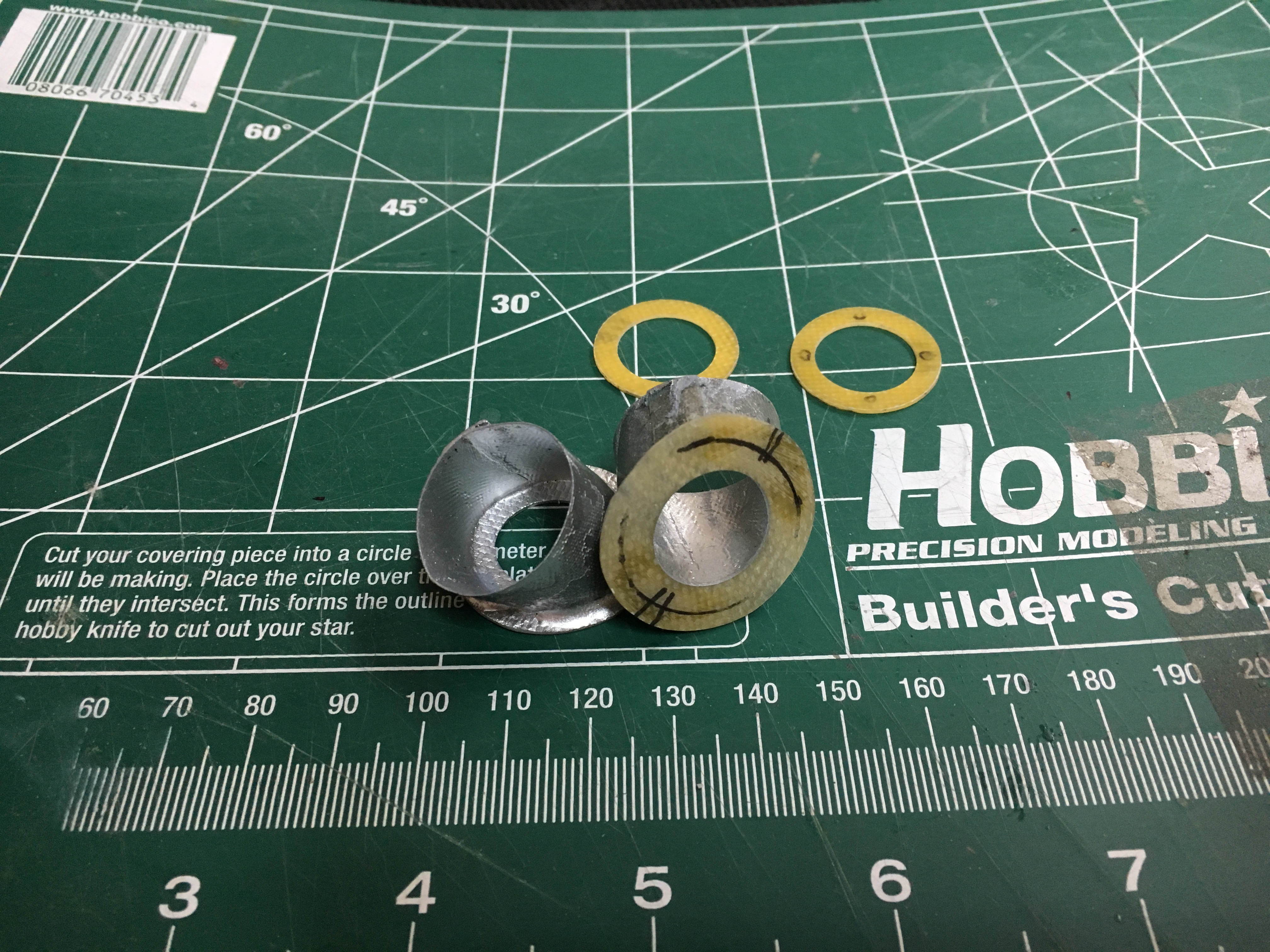

Looks great Sergey. How did you make the scale parts?

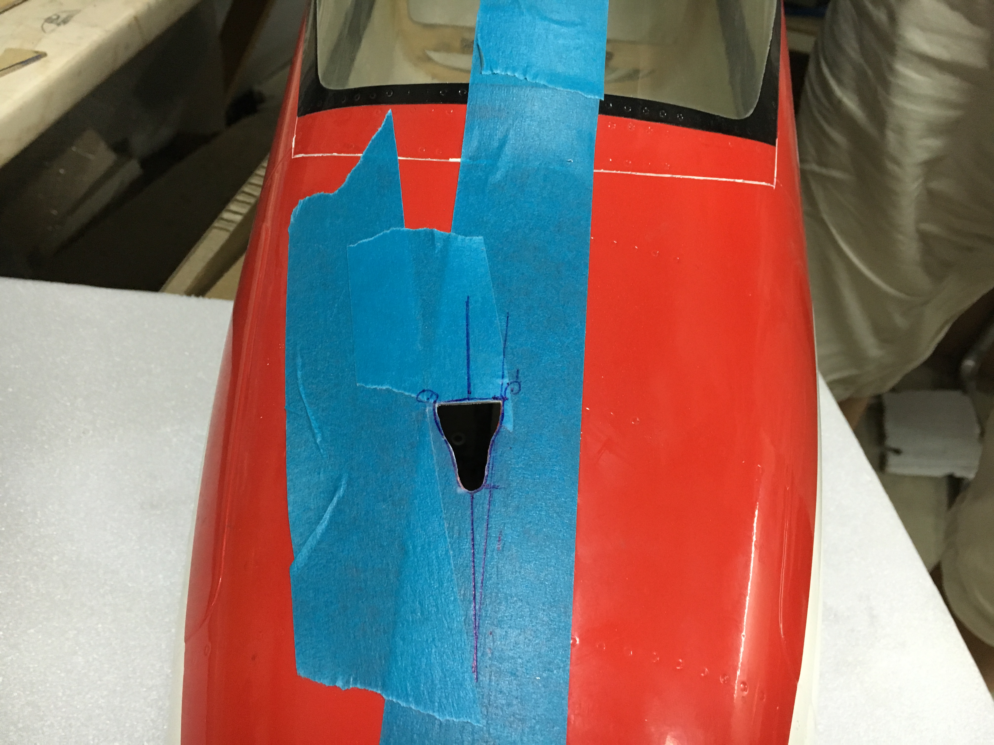

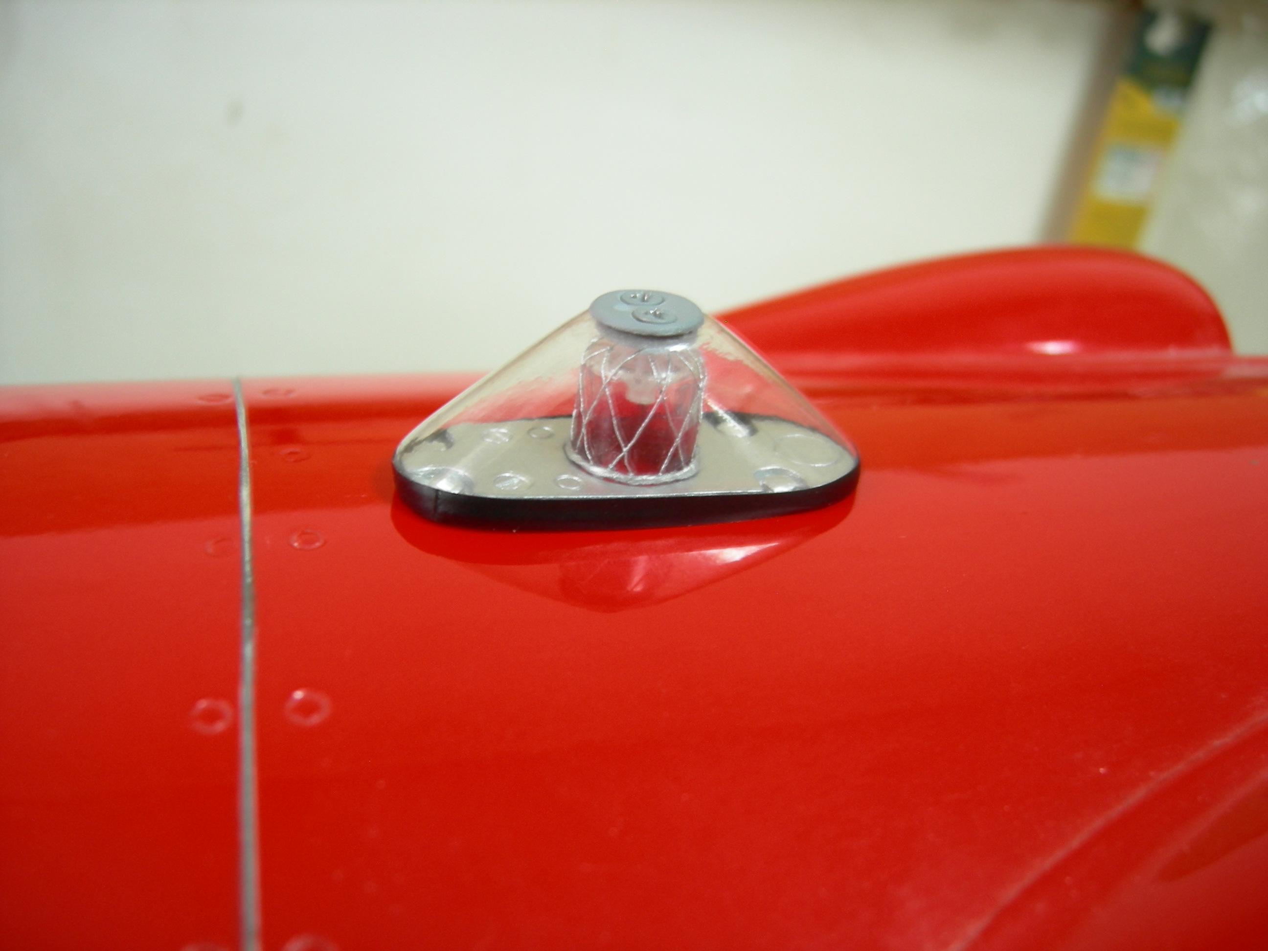

Old 10-01-2016 | 08:46 AM
  #613
helifox's Avatar
Joined: Apr 2014
Posts: 125

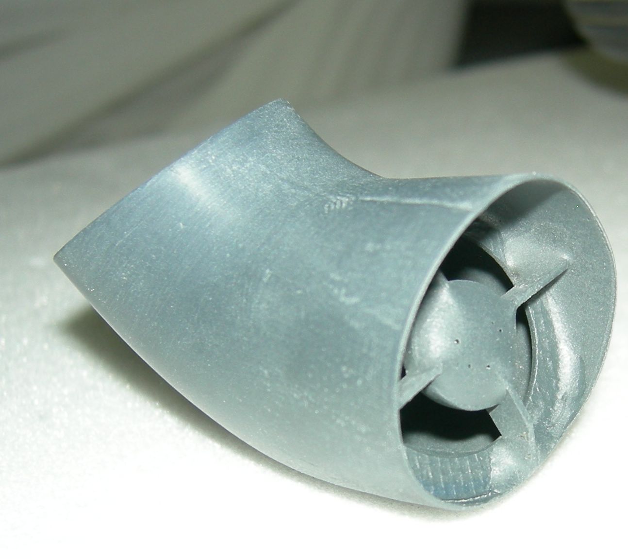

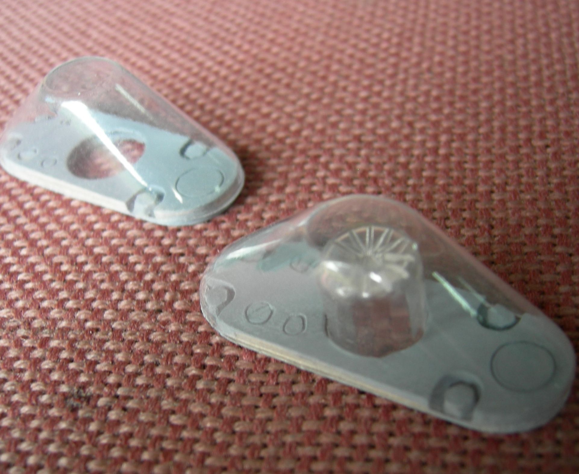

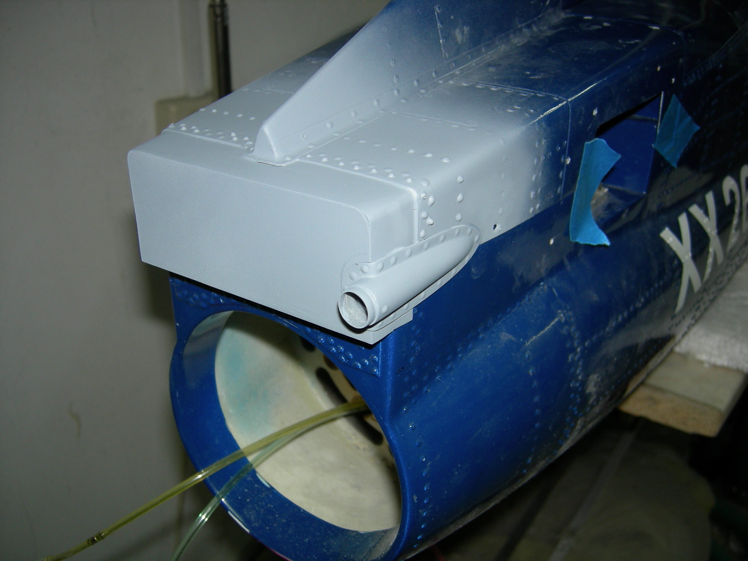

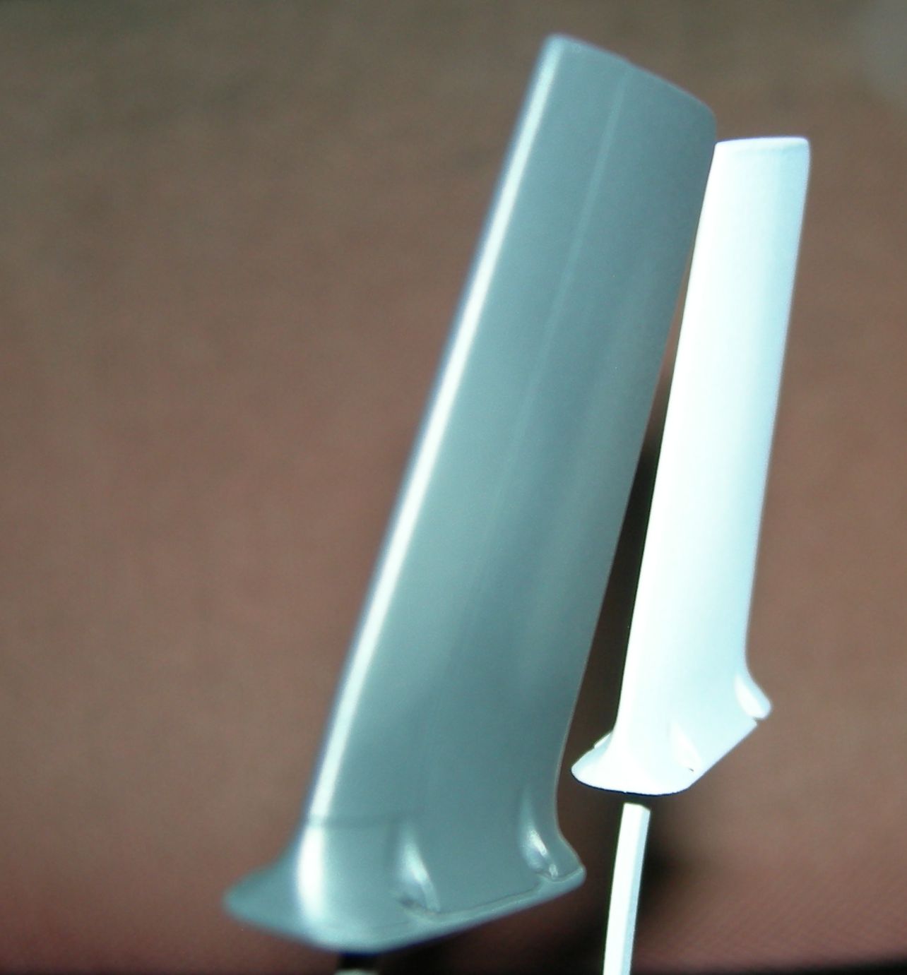

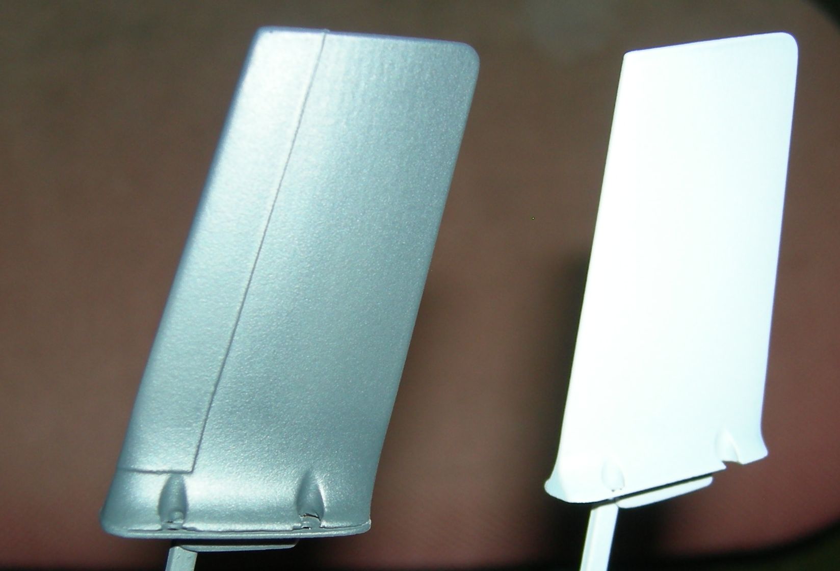

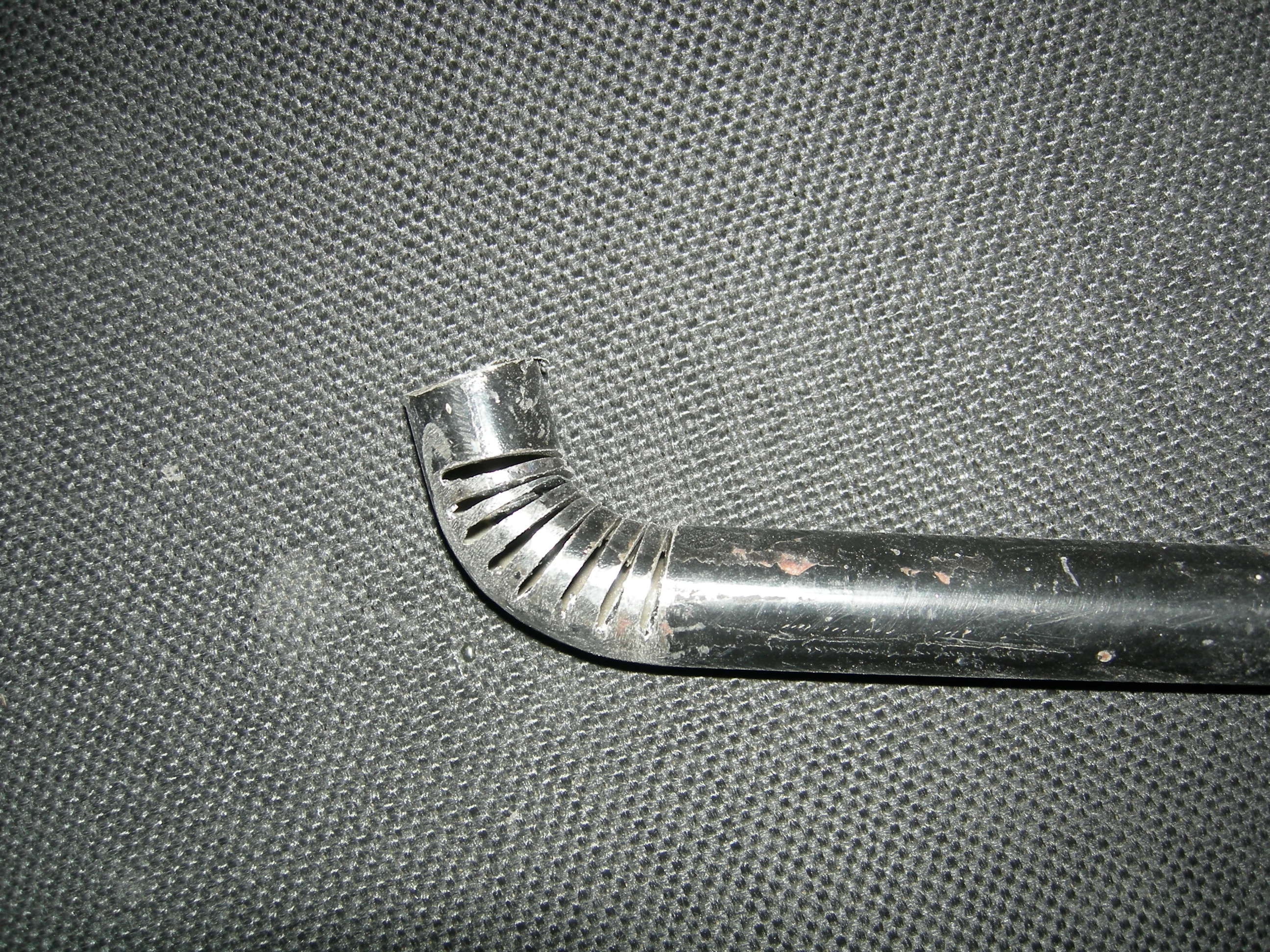

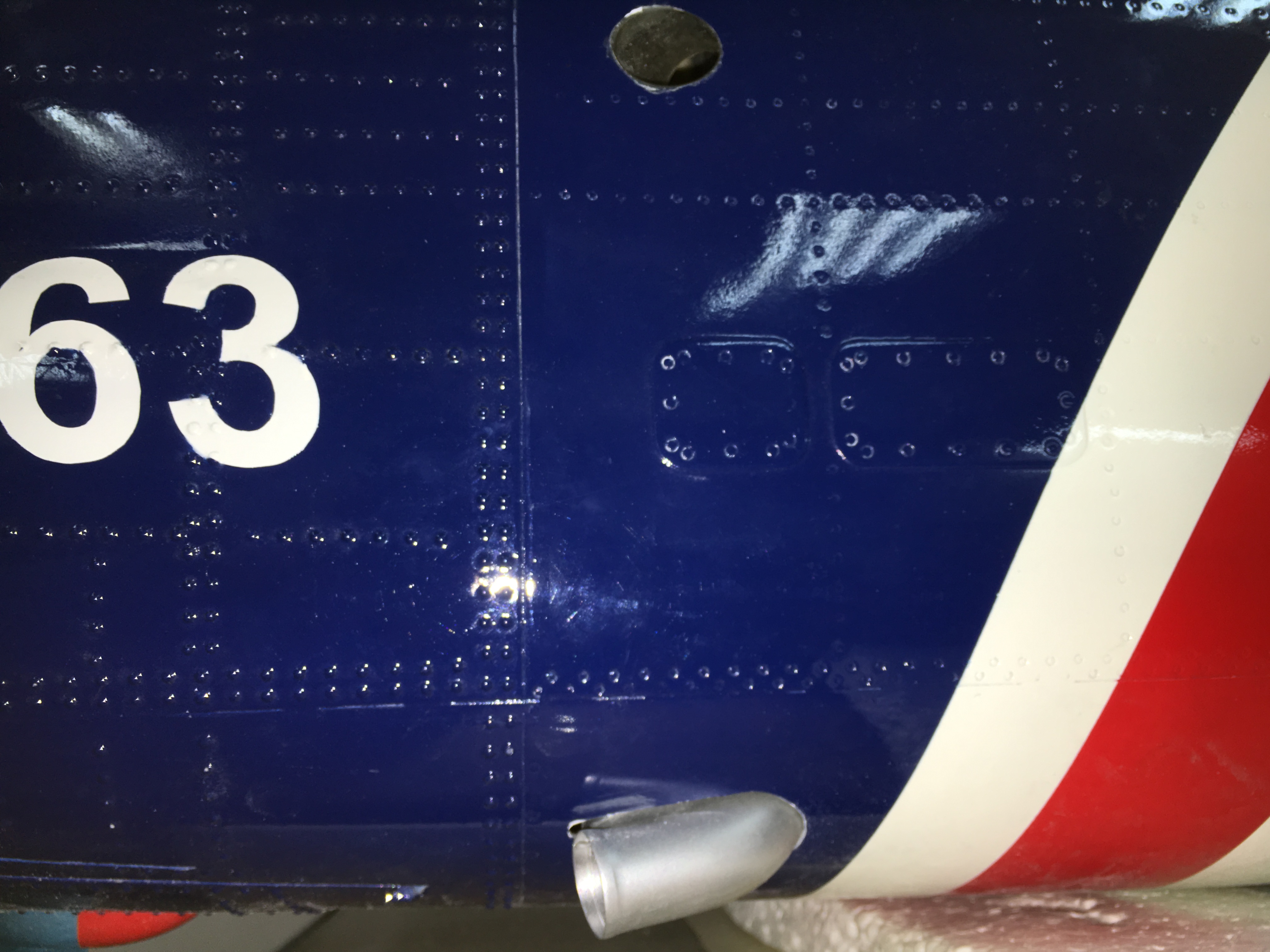

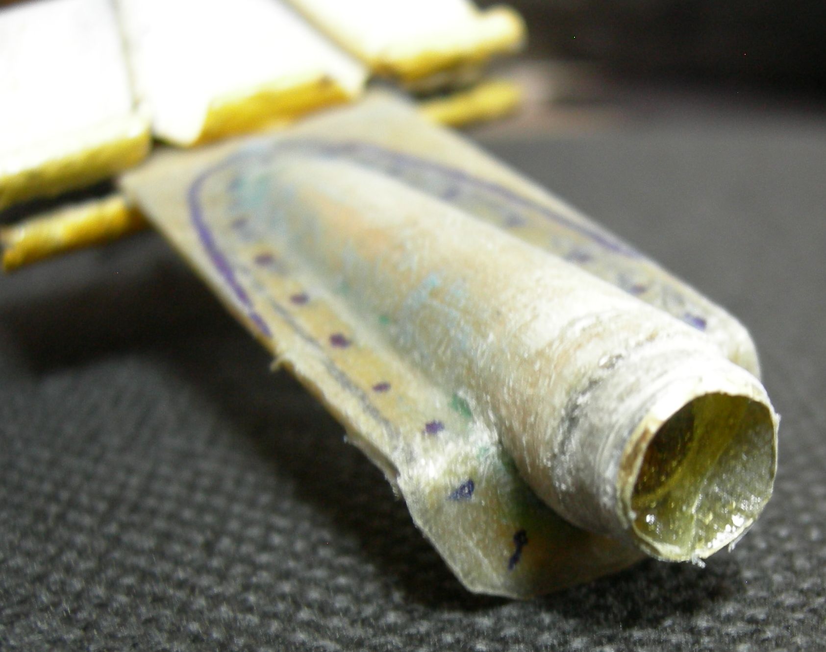

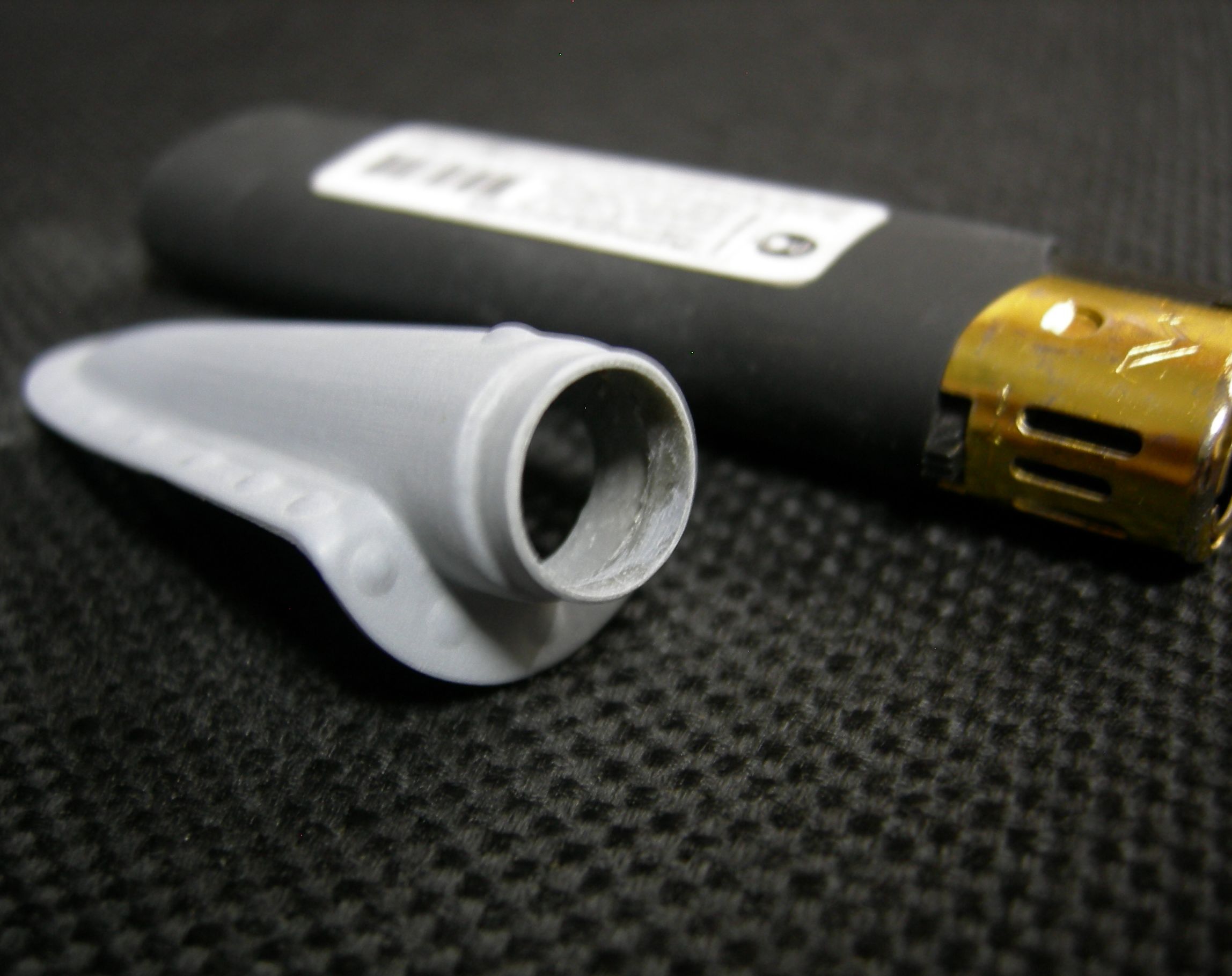

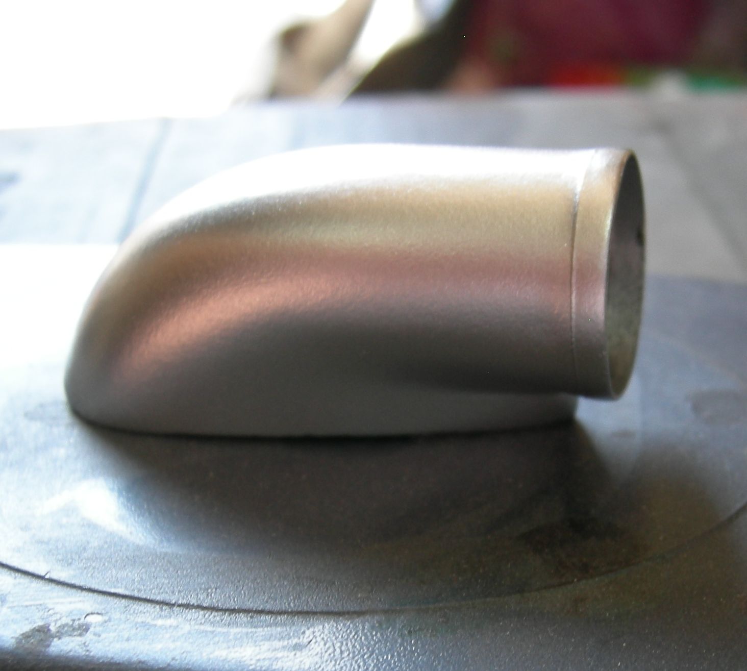

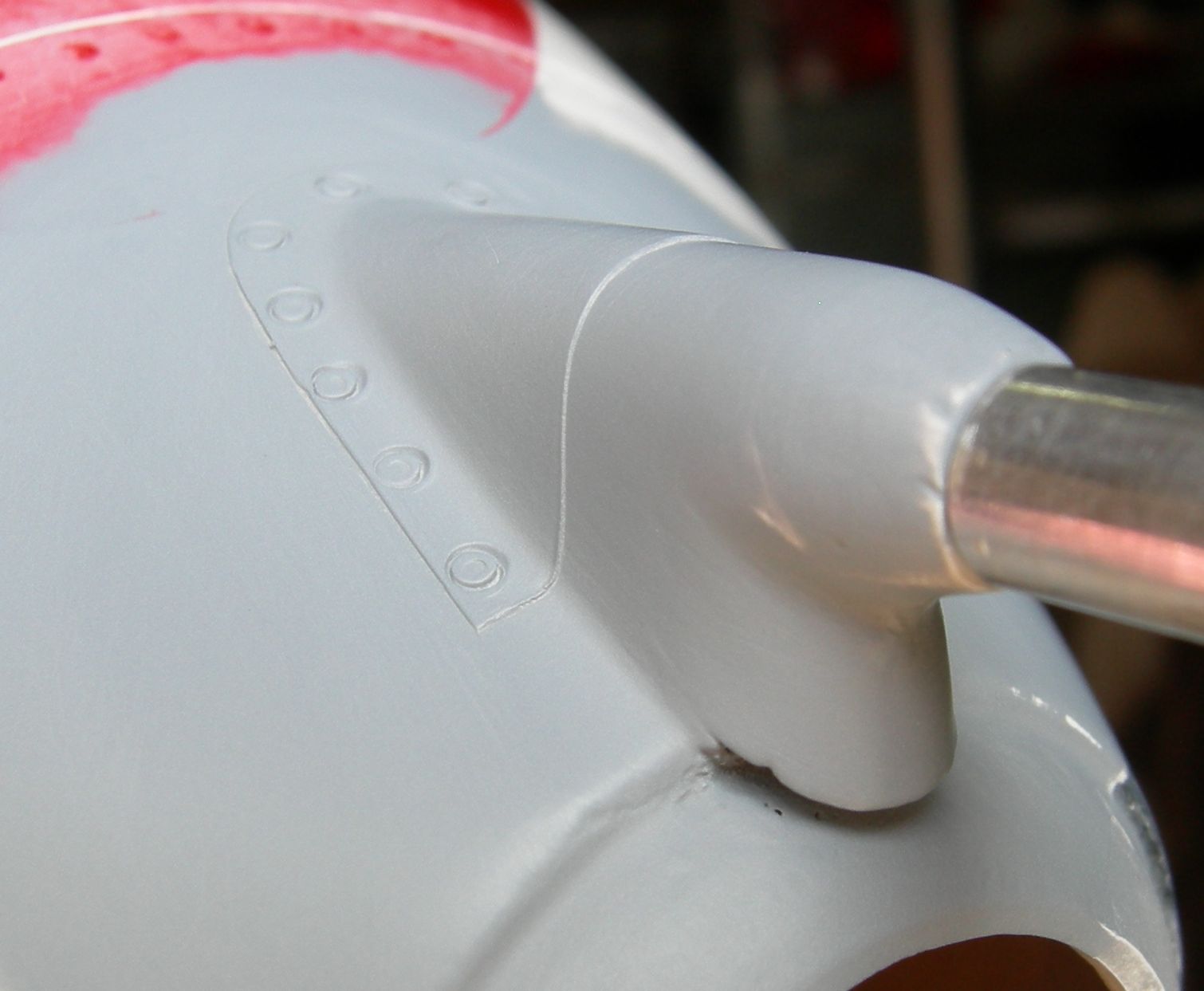

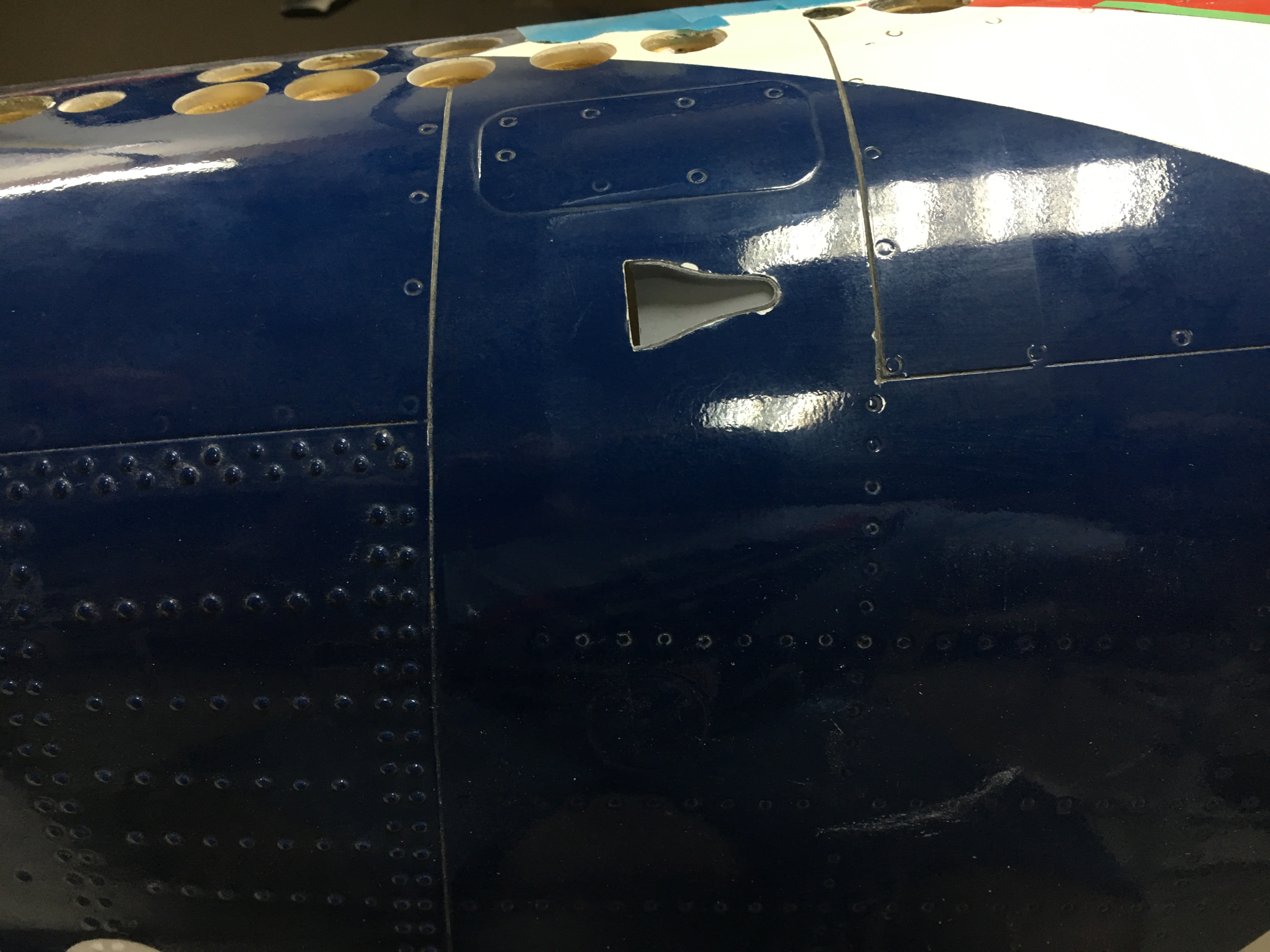

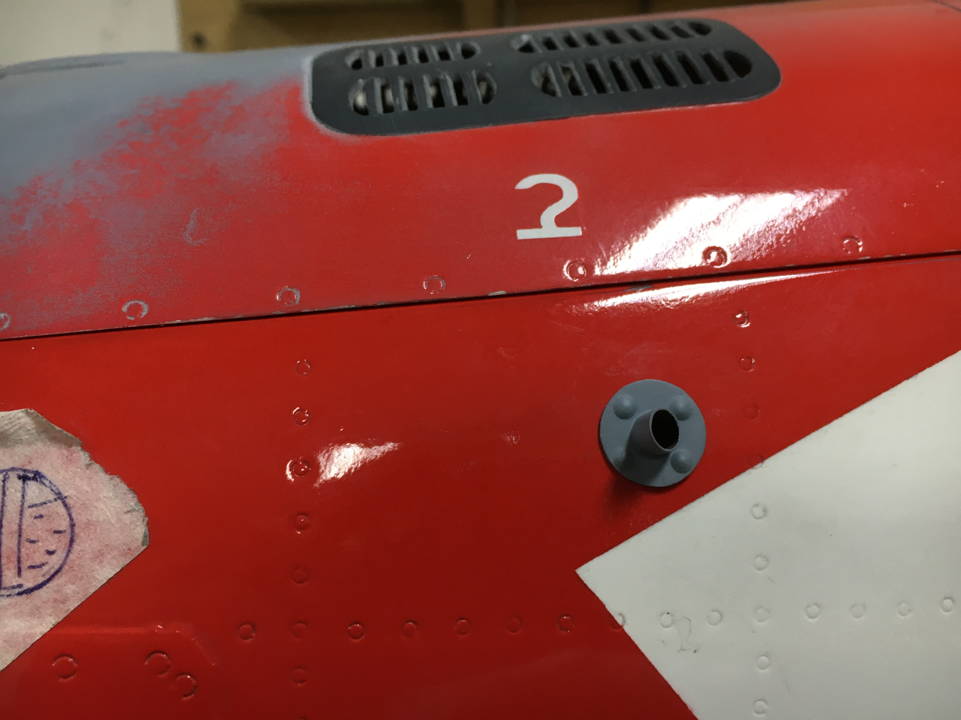

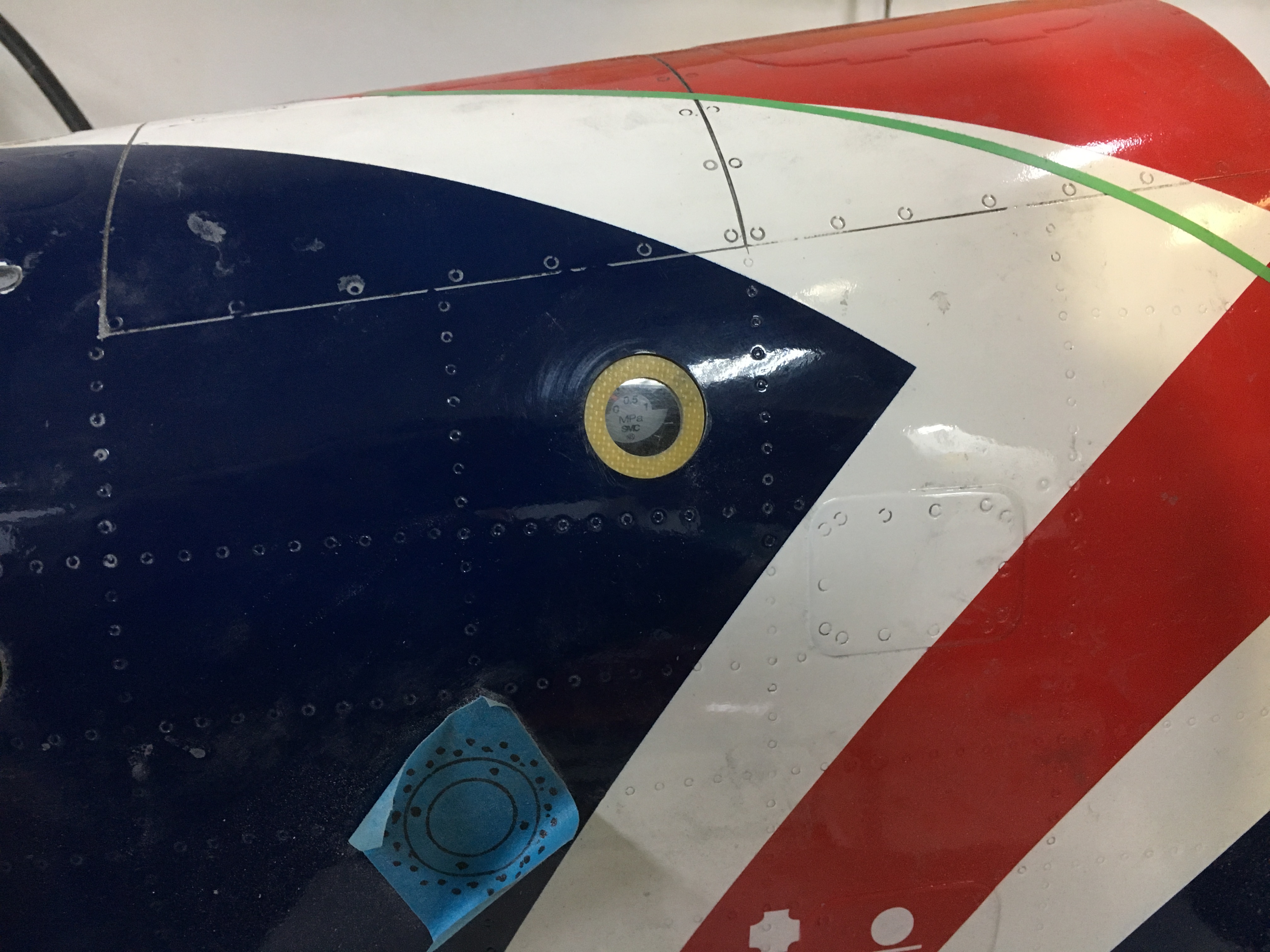

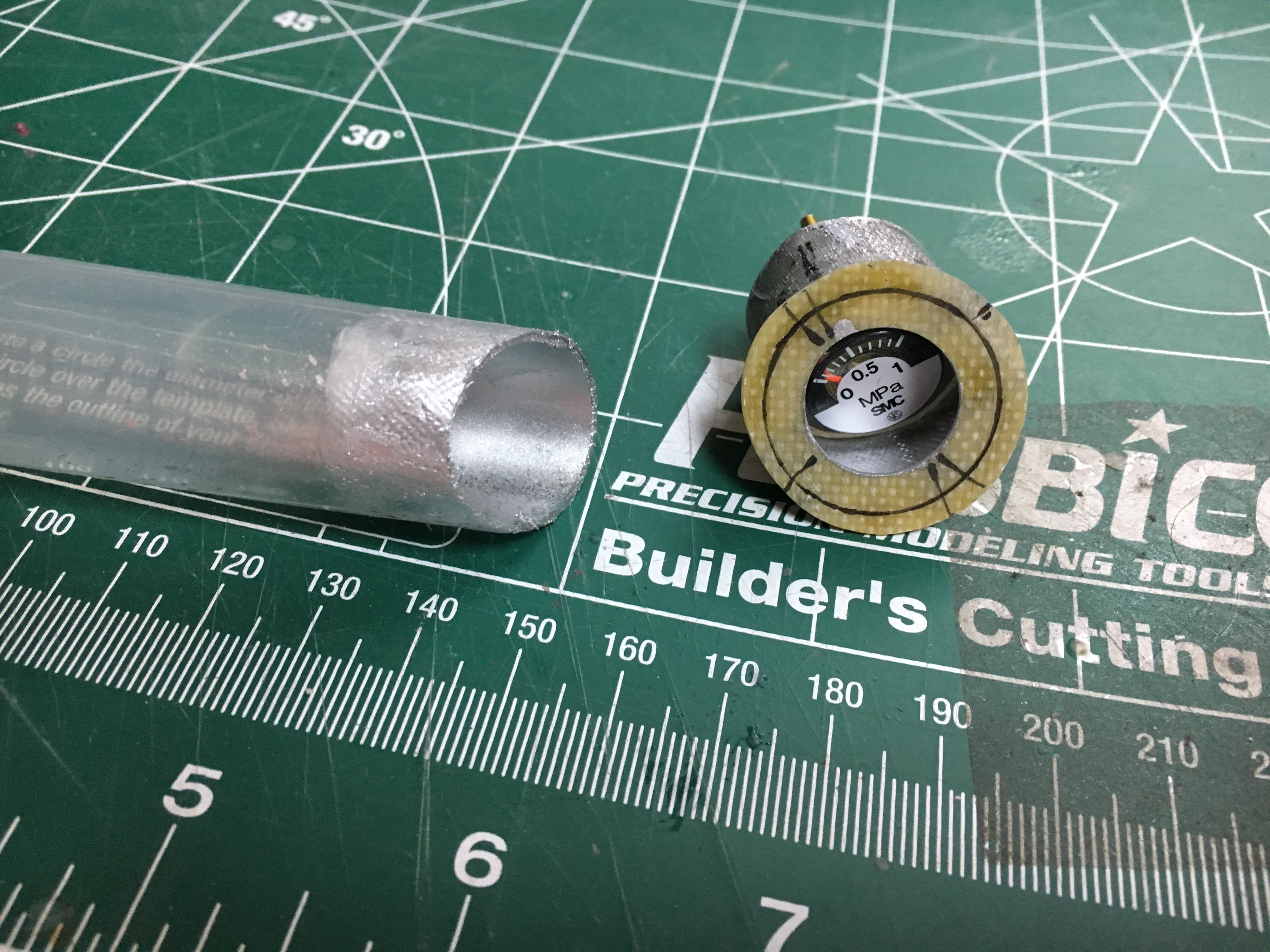

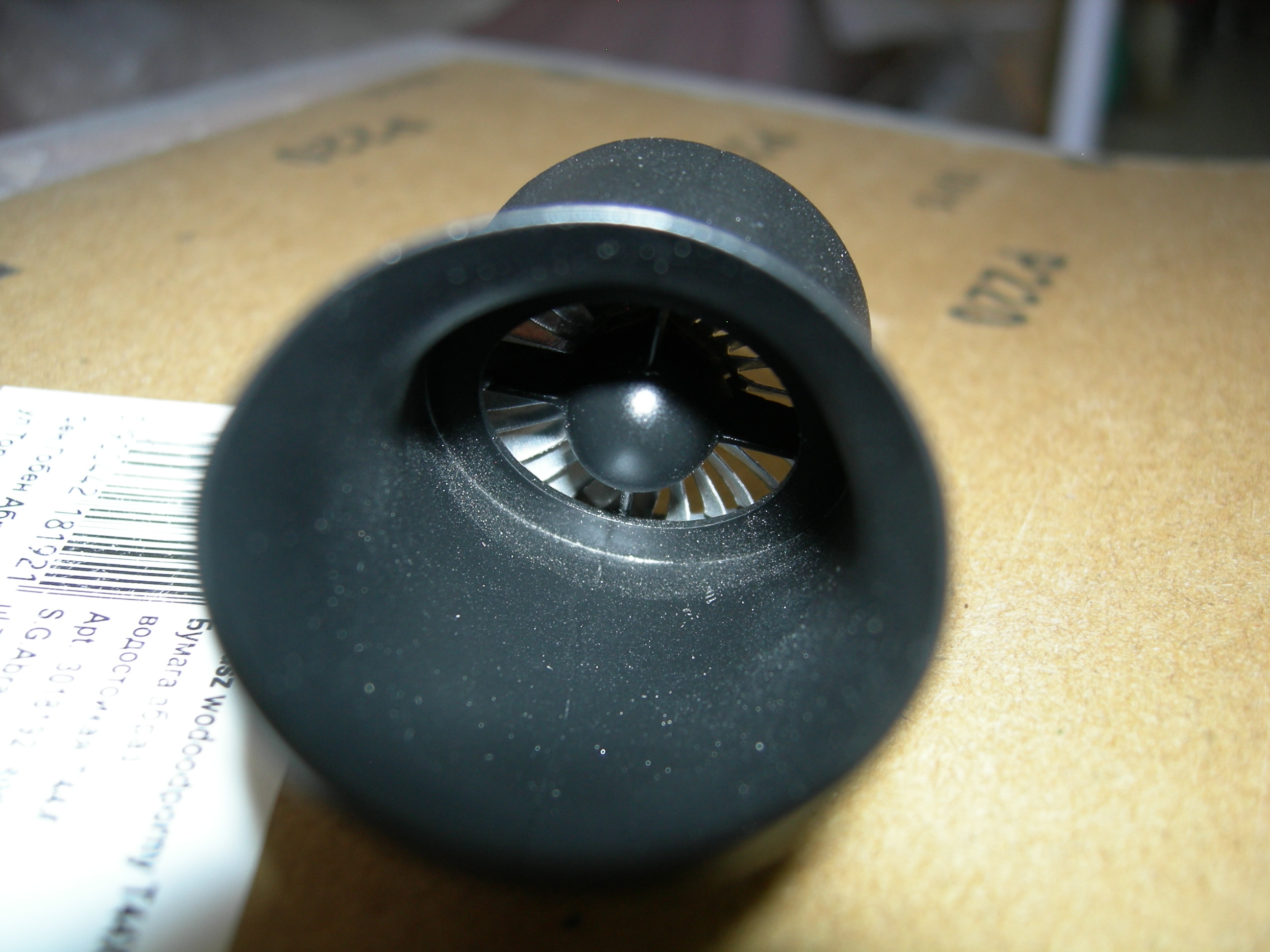

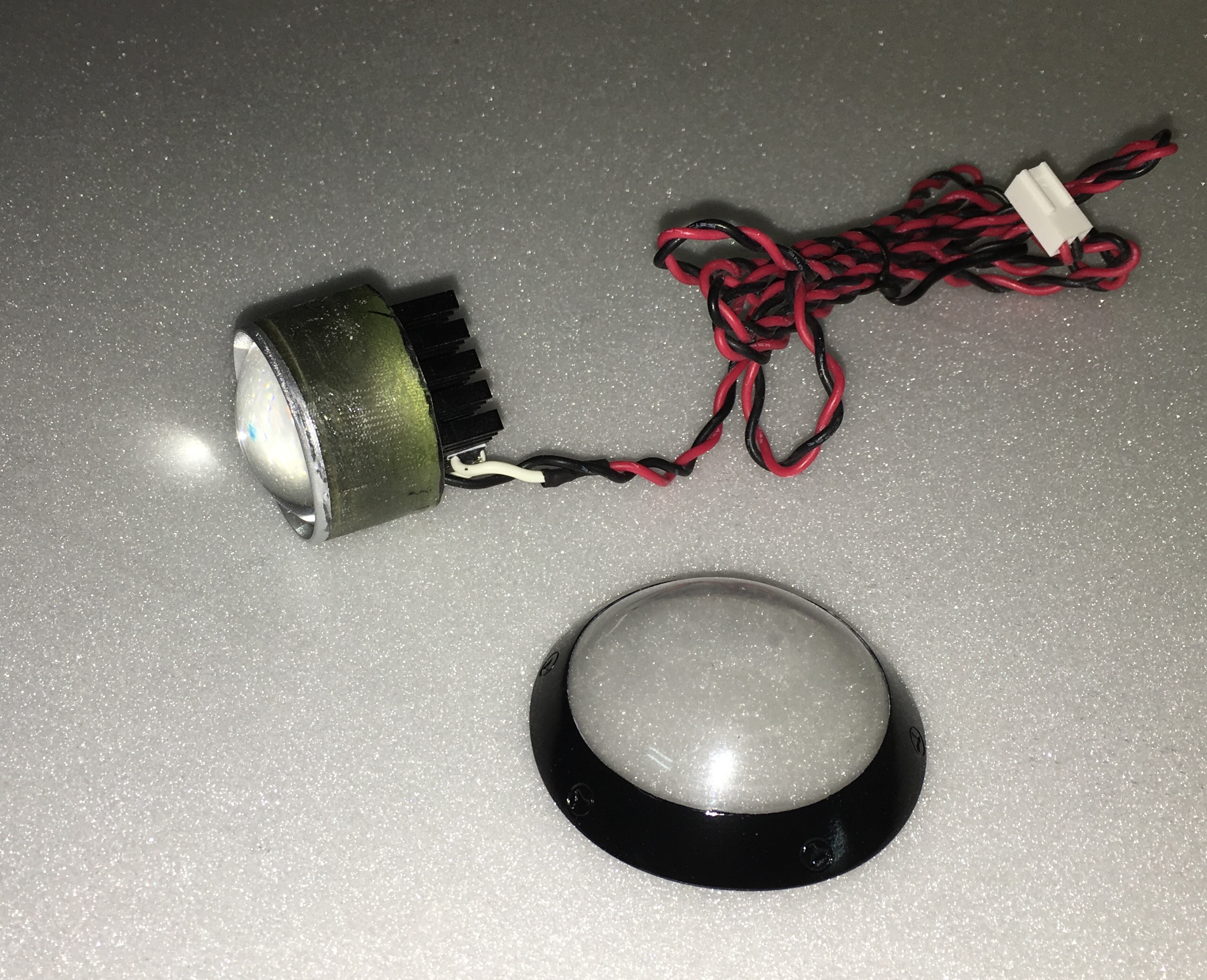

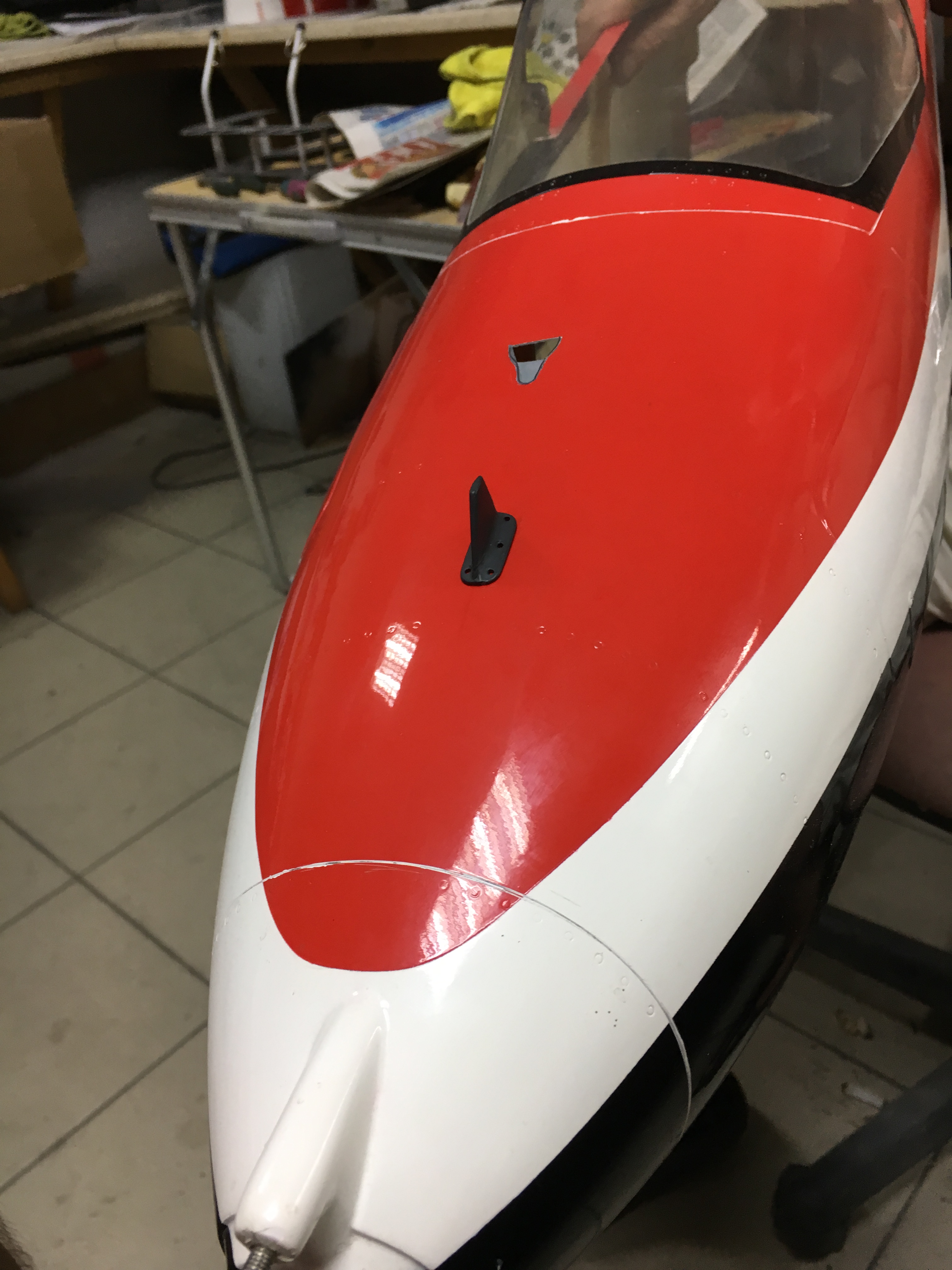

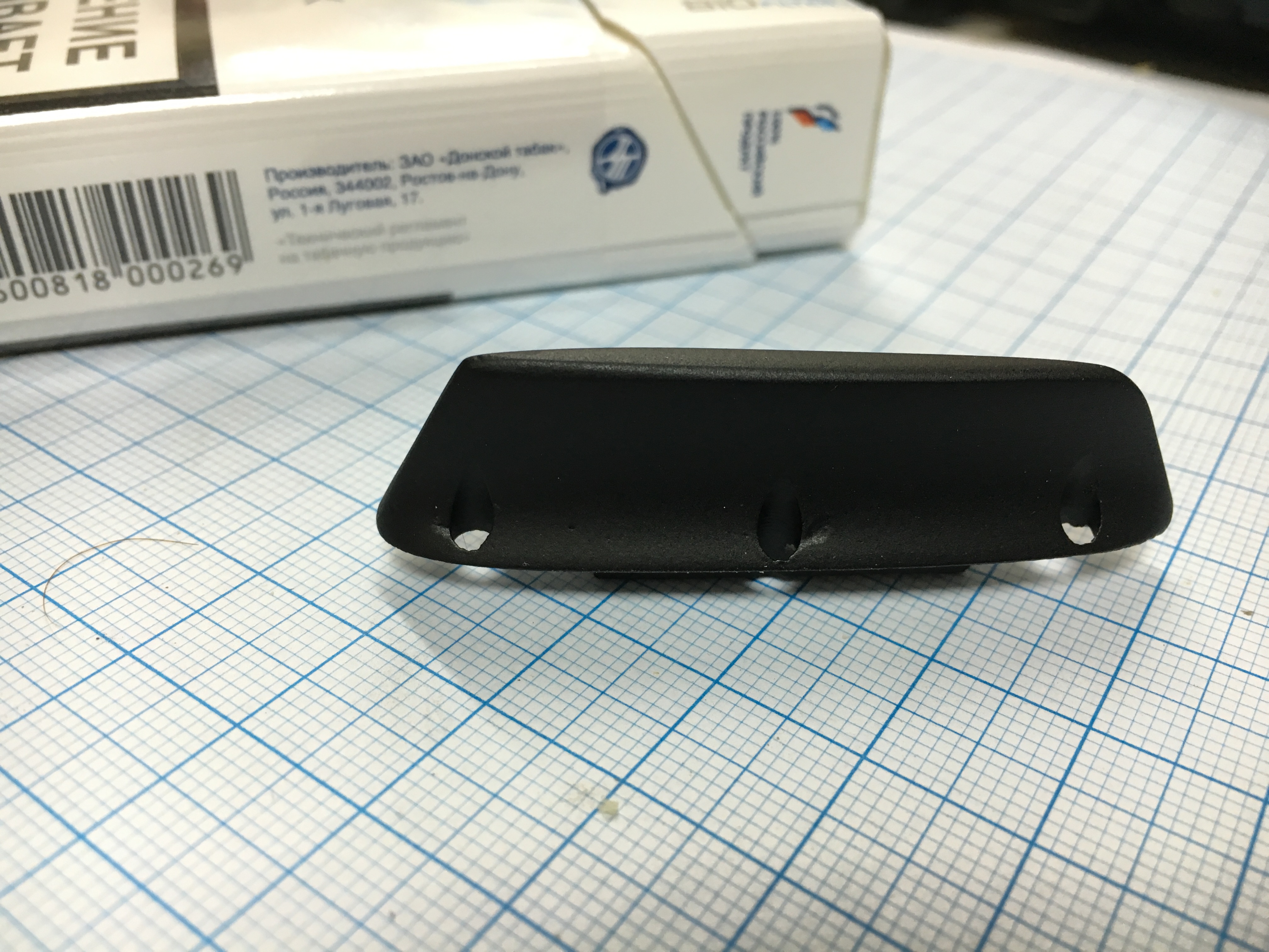

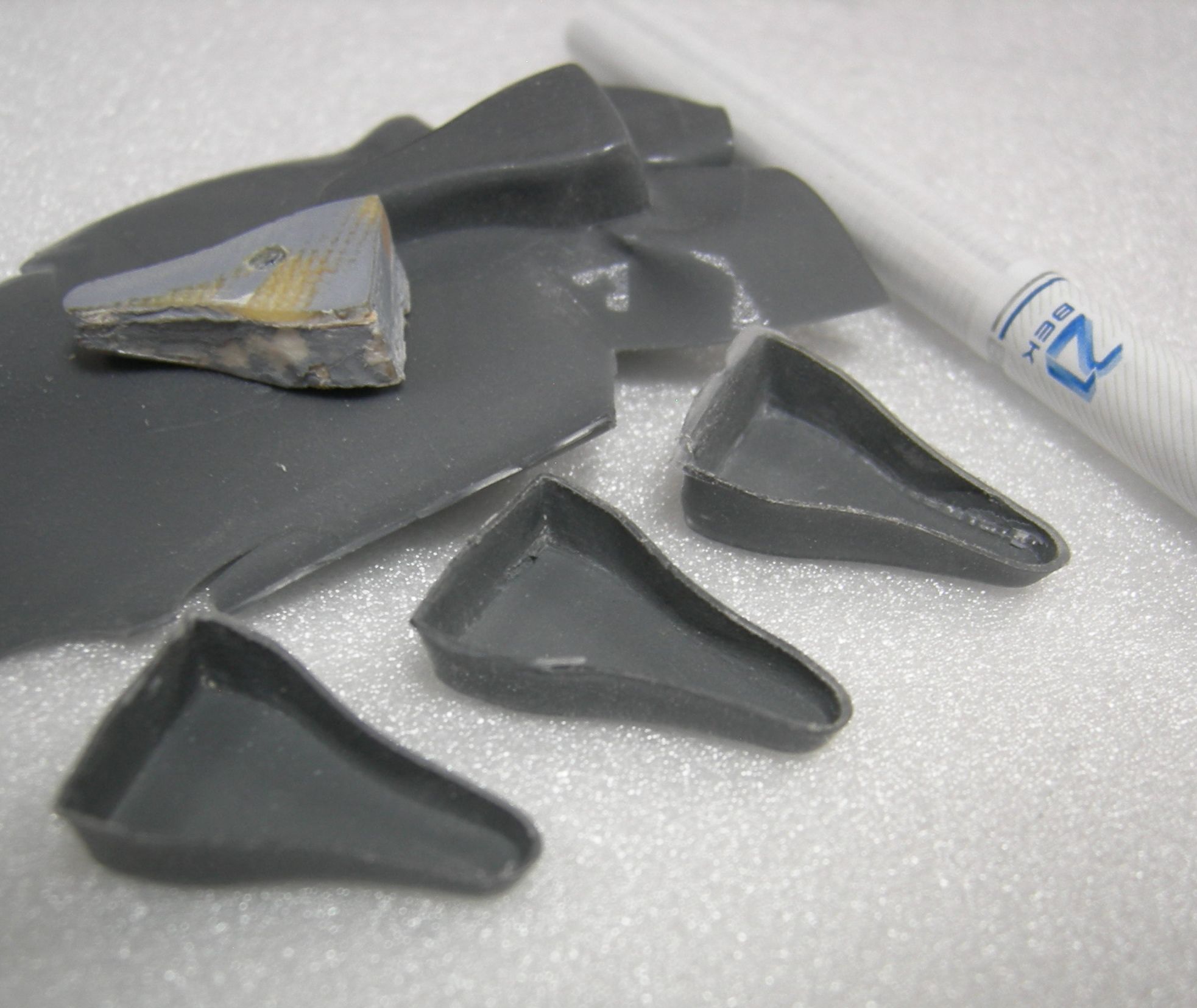

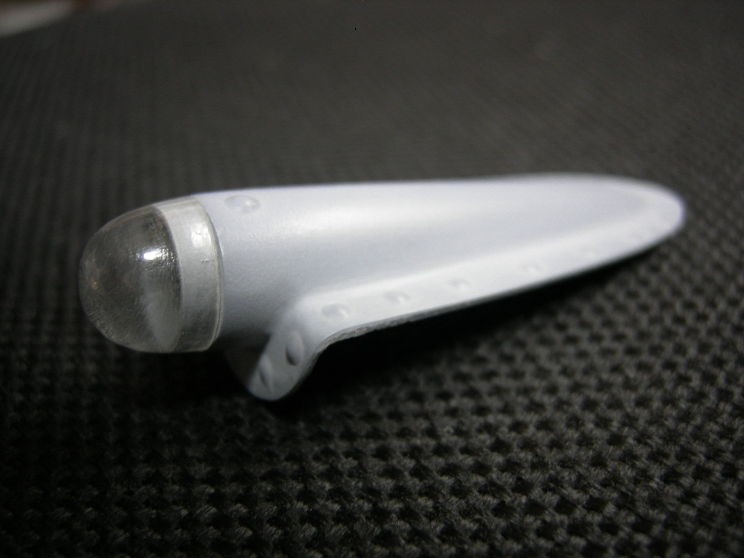

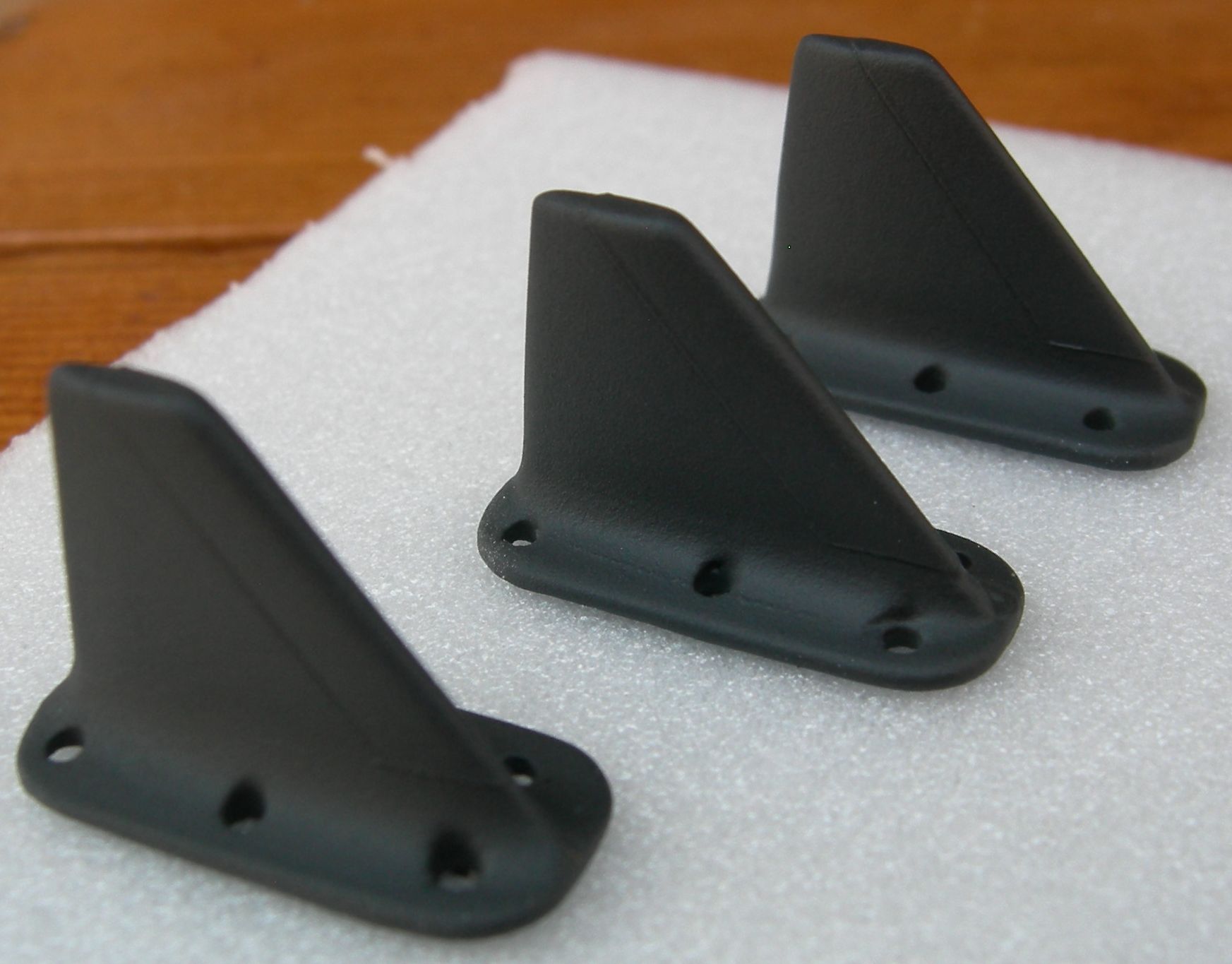

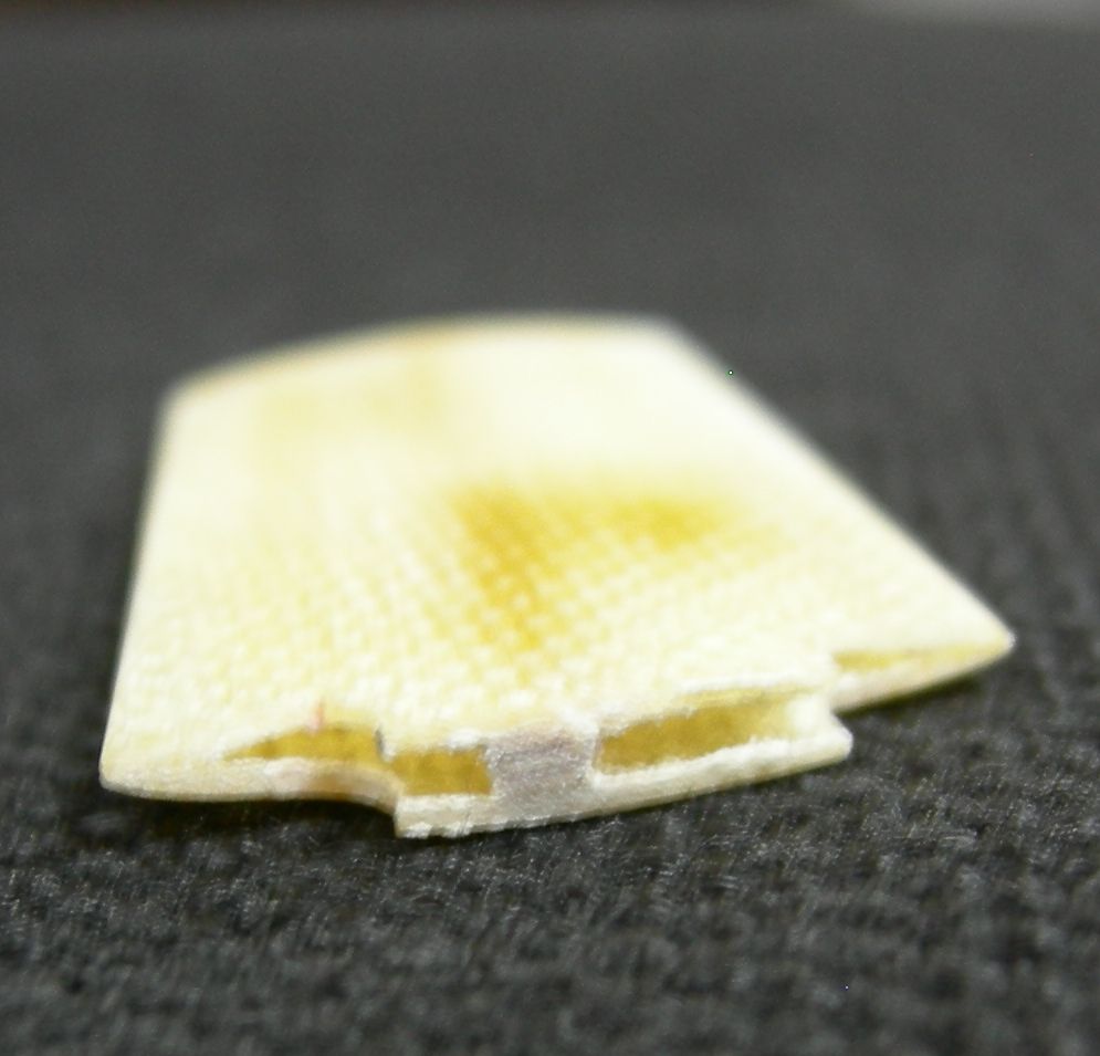

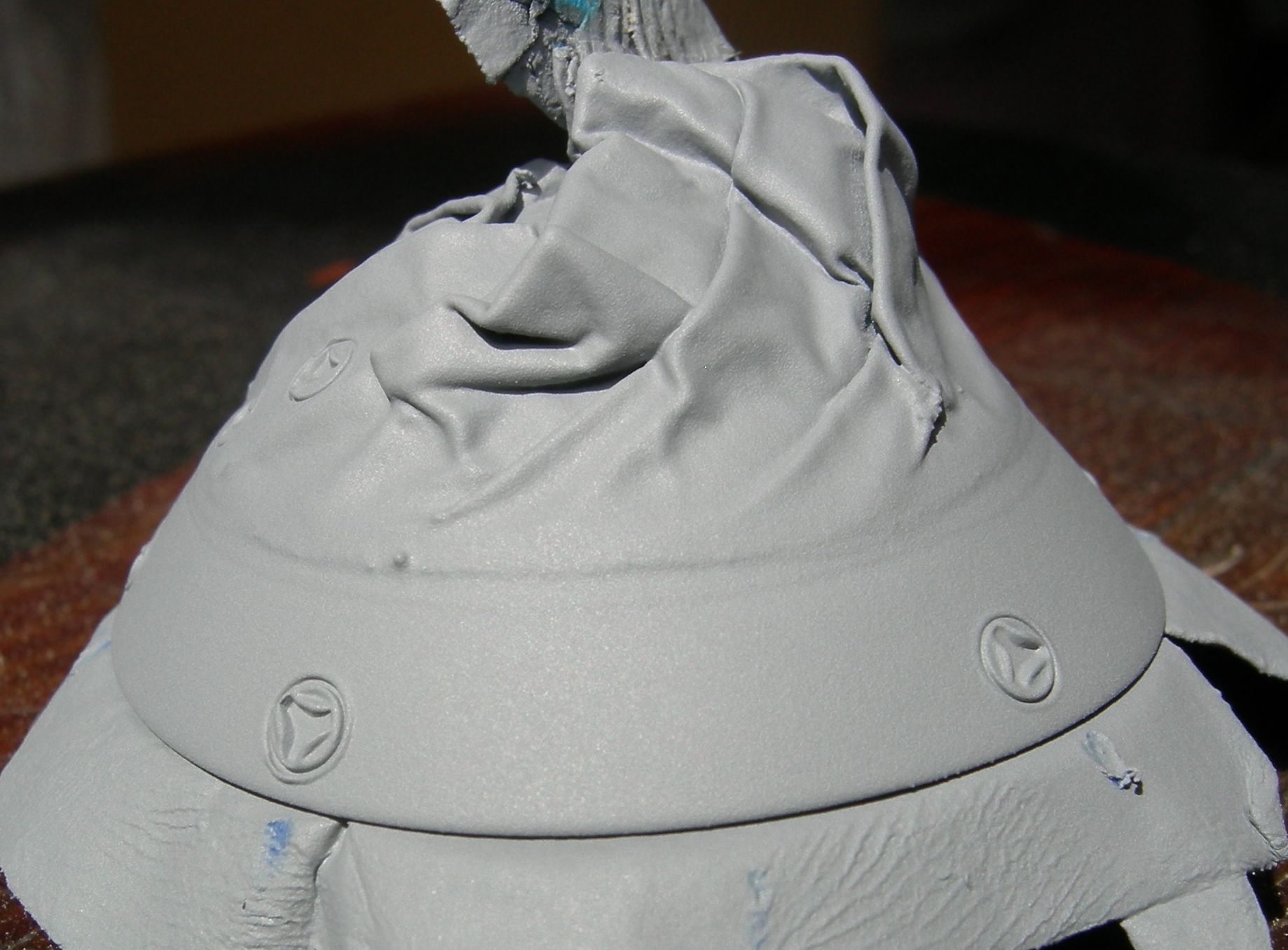

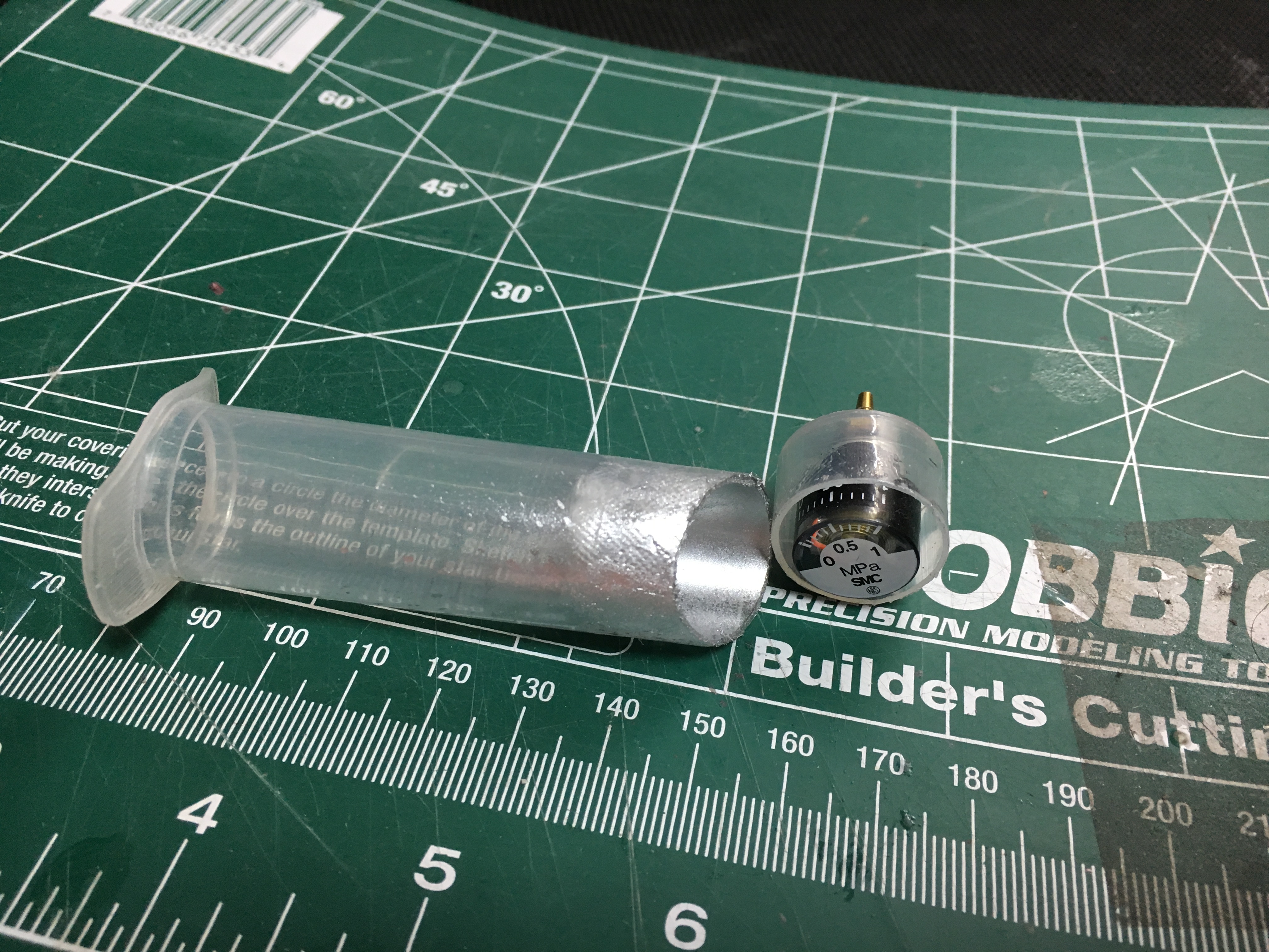

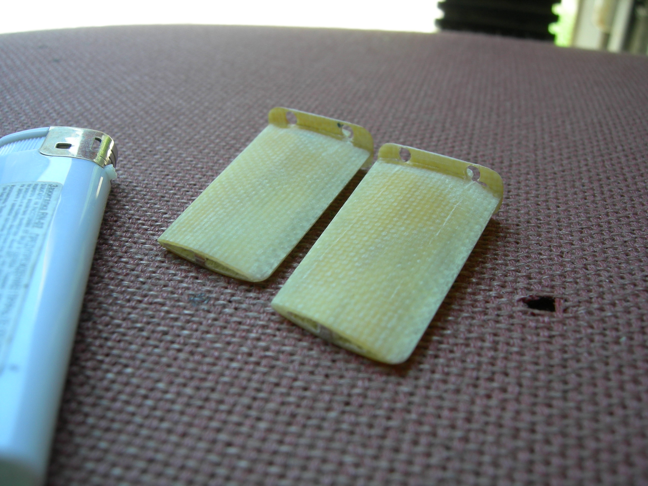

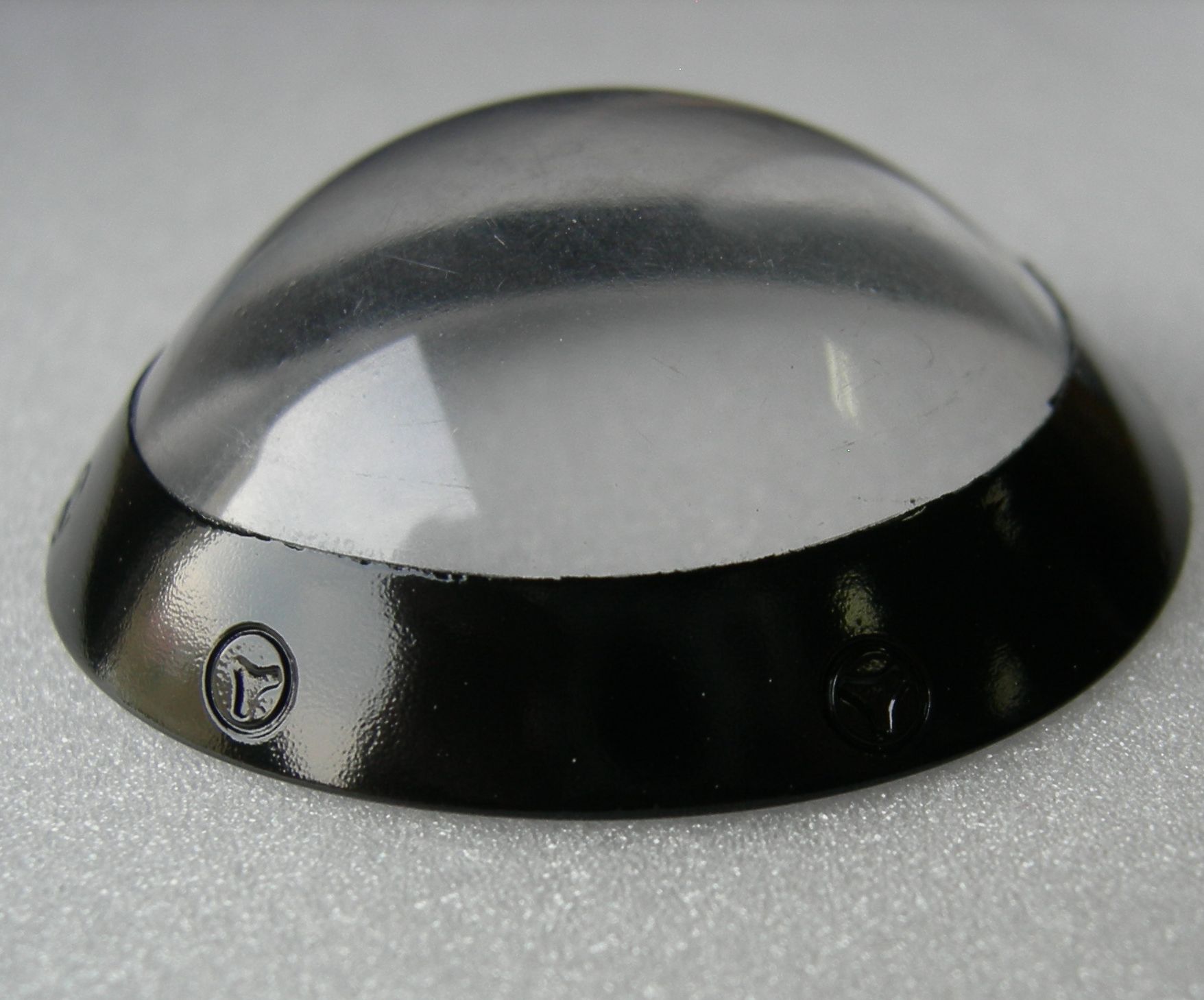

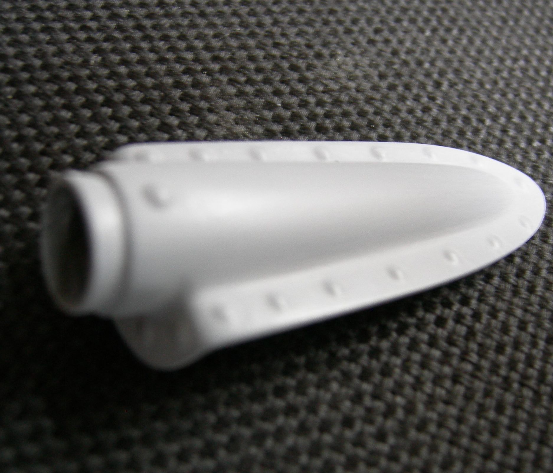

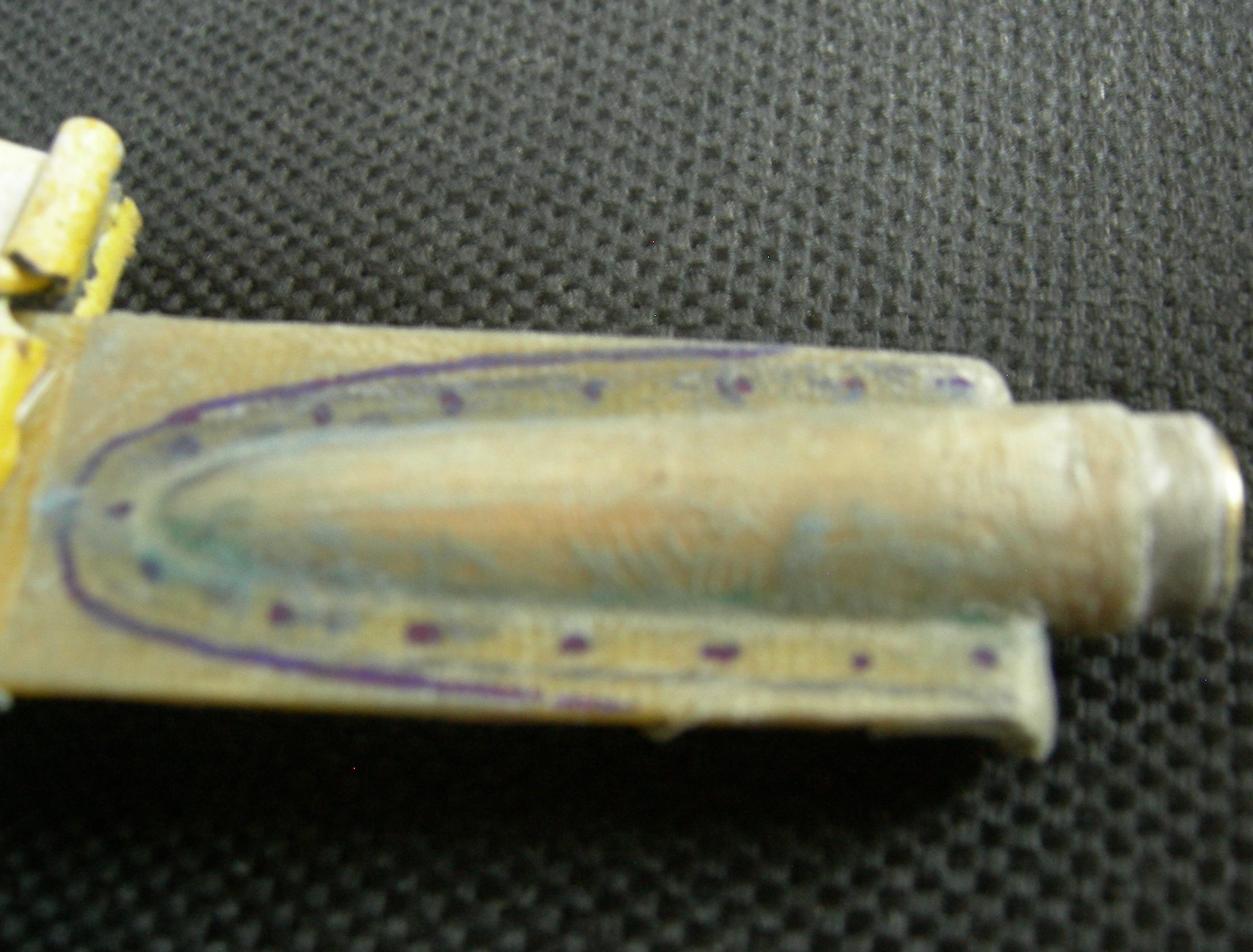

Hi Craig,

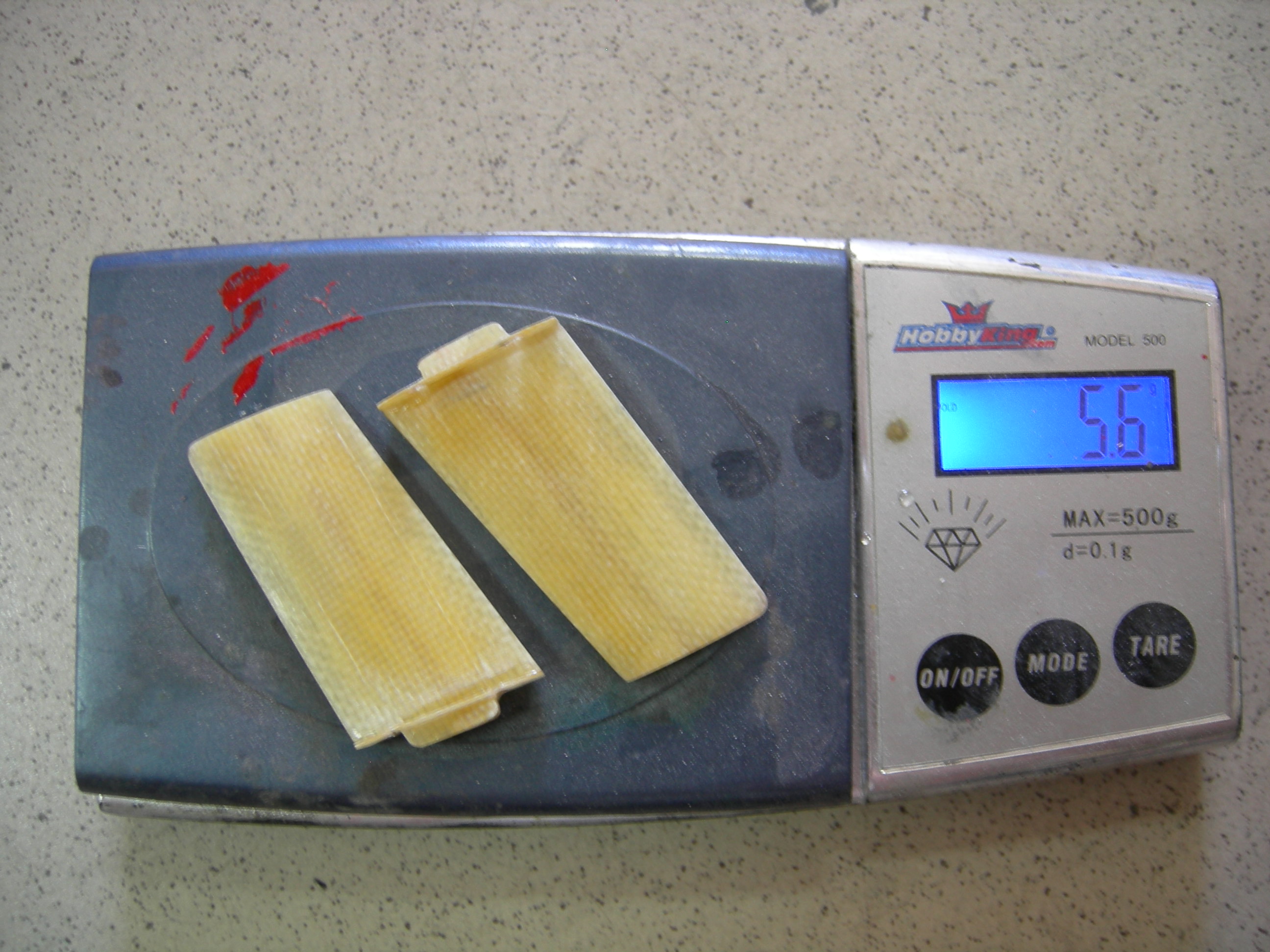

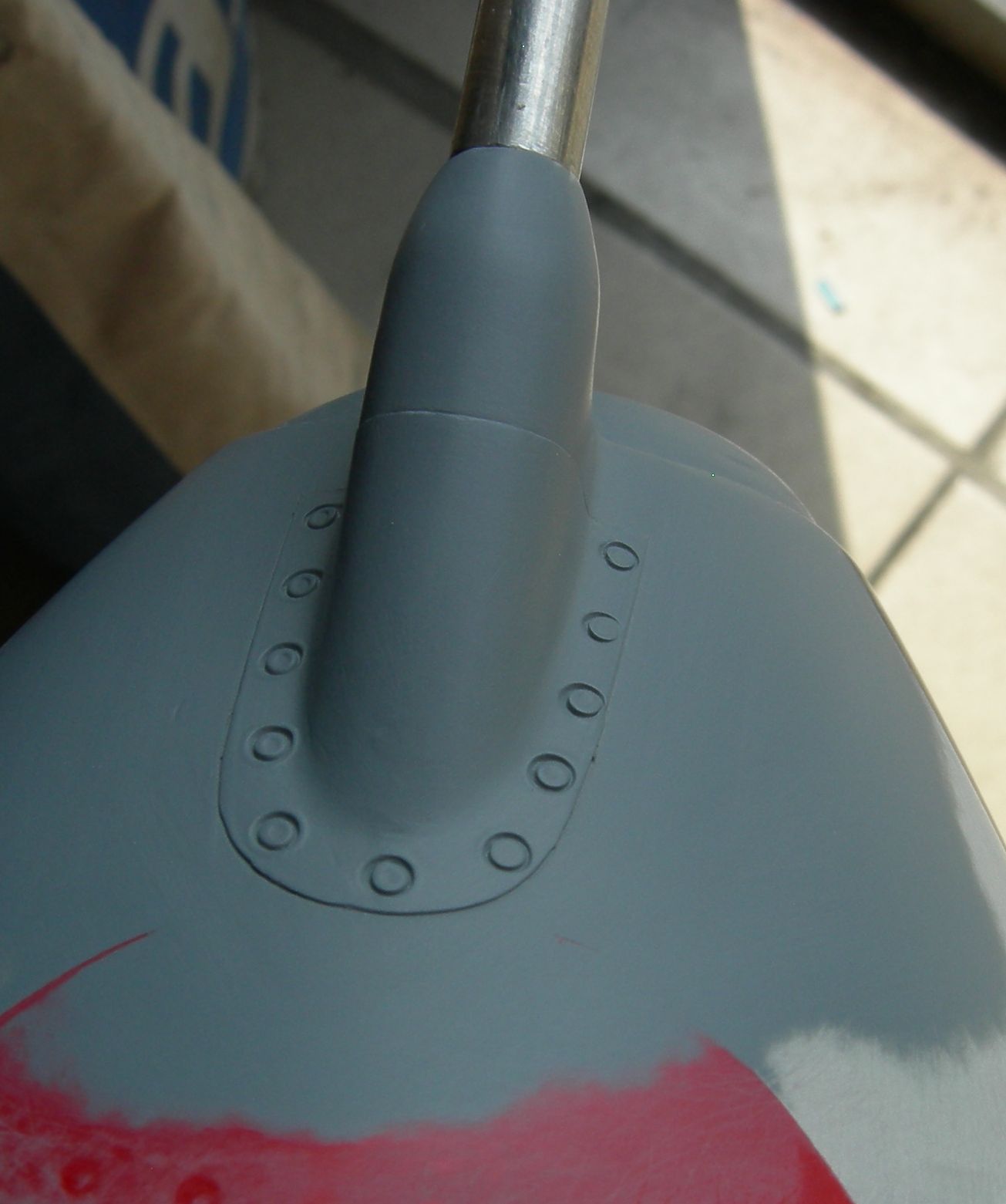

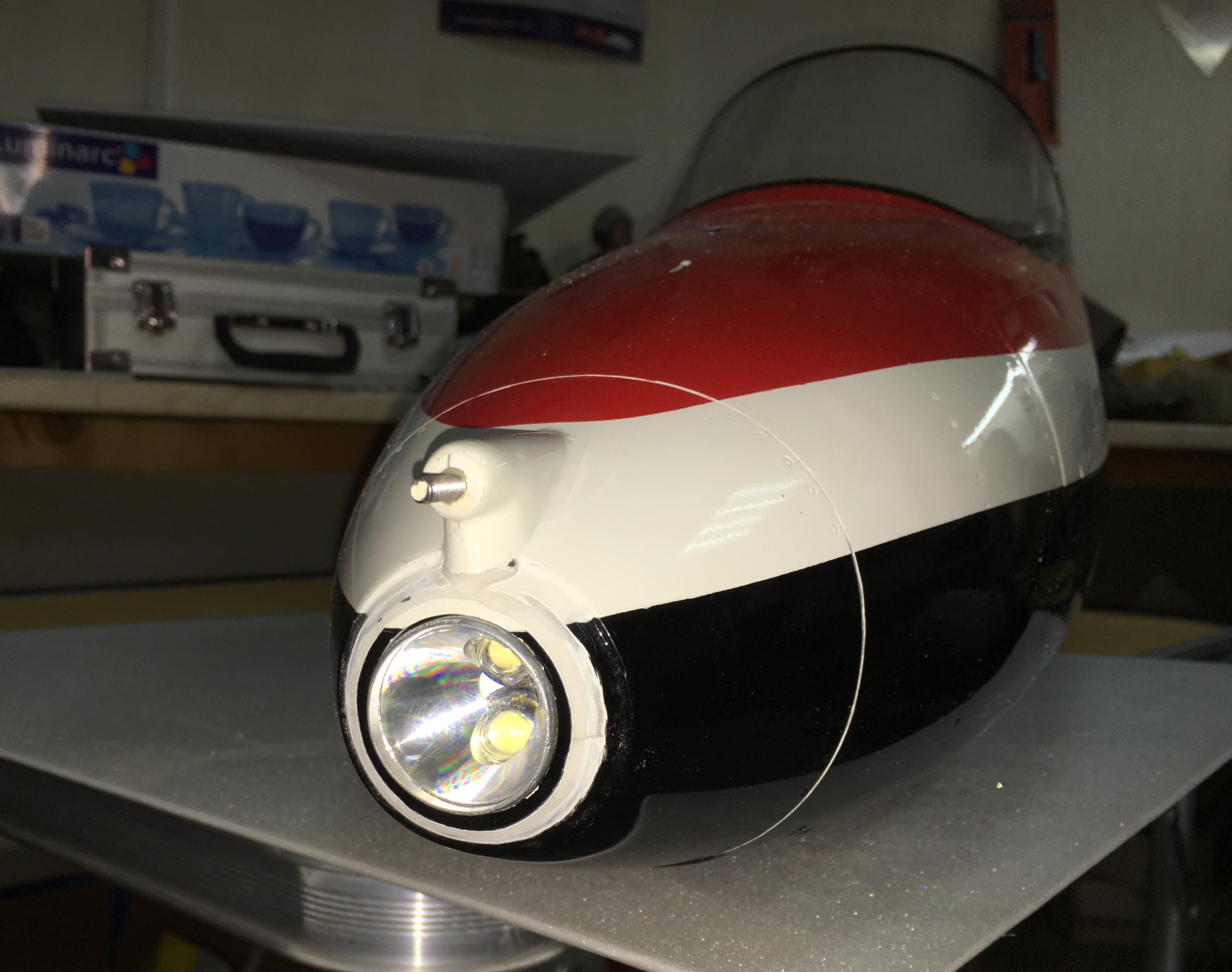

almost scale details are made from "rubbish"
Antenna:
Some composite sheet, wood spar, glue, body primer
EPU exaust:
Same composit technology, plus pies of Cola can for turbine wheel
Hot Air Pipe
Tail NAV light:
The reverts is glue drops, then body primer. The clear lens - hott wacuum forming.
" Fire extinguishers windows"
Composite technology around 20ml syringe
Drain tube:
Kind regards,
Sergey

Joined: Apr 2014
Posts: 125
Thanks friends,
There is last point in fuse scale work- parachute dor imitation before repaint. Hope she will look better then now
After all of modeling she got about 60gr + another 150gr max repaint = 210-250gr - not so critical (hope so).
Also hope she will fly good (l'm dreaming about that).
Kind regards,
Sergey

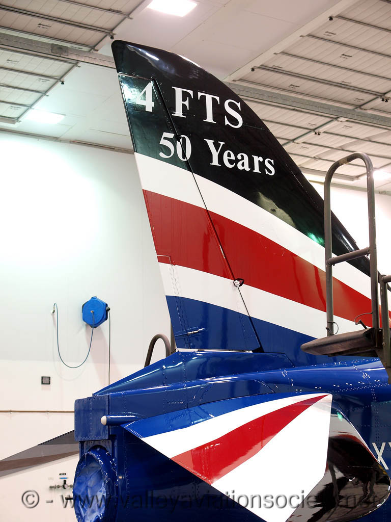

I'll be very appriciate if somebody know the part number of blue color on prototype paint scheme.
One friend of mine told me "BS 381C 110 Roundel blue", but I'm not agree with him, the Roundel Blue looks too dark.

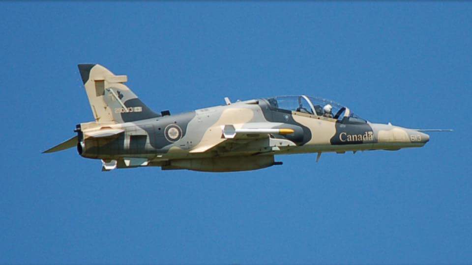

Hi Friends,
A small flight video of my 1/4.75 hawk (T-45) :
https://www.youtube.com/watch?v=5ZICz9WJh4Y
Thank you Fabrice.

Nice flying Fabrice! Great landing too.....that's how it should be done. What engine you running in yours? Are you running crow on the ailerons for landing or just flaps?
Old 10-18-2016 | 02:14 AM
  #623
Joined: Jan 2004
Posts: 92
From: Blagnac, FRANCE
Hi Craig, engine is a Merlin 200 and on landing, I'm just lowering the flaps (around 45°).
