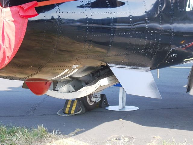

Hi Jack, The hawk T2 definitely use's the speed brake, I'll double check with the guy that did the acceptance trials for the RAF but 99.9% sure they do use it.
Don't envy you installing that rudder without the speedbrake opening [X(]
Here's a photo of a T2 on the ground with hydraulics not pressurized the speed brake is drooping slightly............
Alex

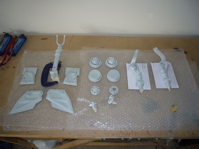

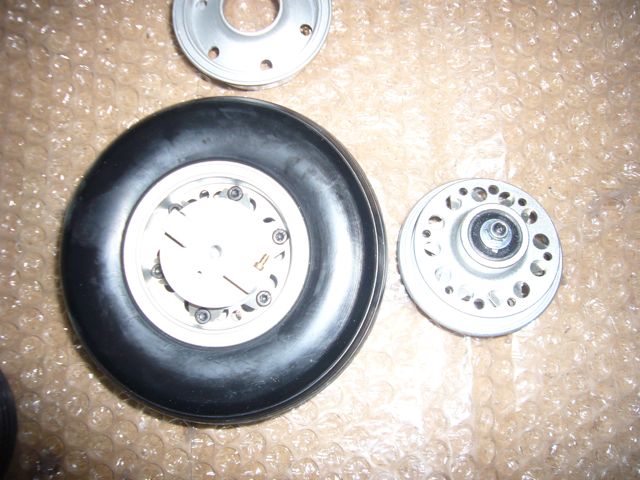

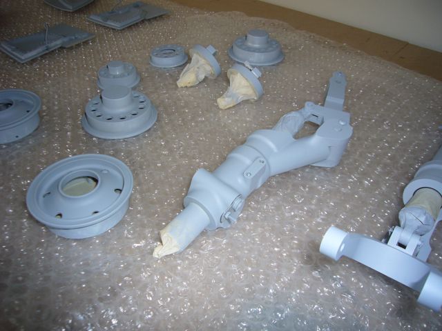

The gear is going to be painted with matching gear doors. Never a job a look forward to on these builds.......... The gear is normally very greasy and because these are oil damped oily too. I degrease the oleo's about 5 times with an automotive engine degreaser. Masked them up and sprayed them with an acid etch primer. I left them for a good 48 hours to cure. I then scraped my nail along the oleo's and wheel's to see if the primer had adhered properly, it had thankfully. Next I sprayed them with a hard wearing enamel a sort of light dove grey. One thing to note is the valves for the oil are not all that strong I managed to shear one in half when tightening it up [] I didn't put much torque on it either, just something to watch if any of you do the same..............an embarrassing email later and one should be on it's way to me.
Be good if SM had painted gear as an option.
Cheers, Alex

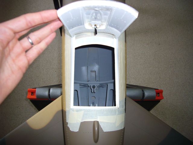

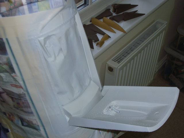

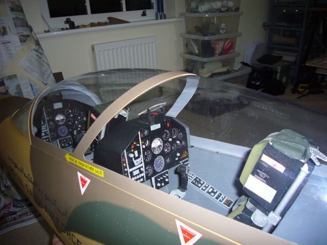

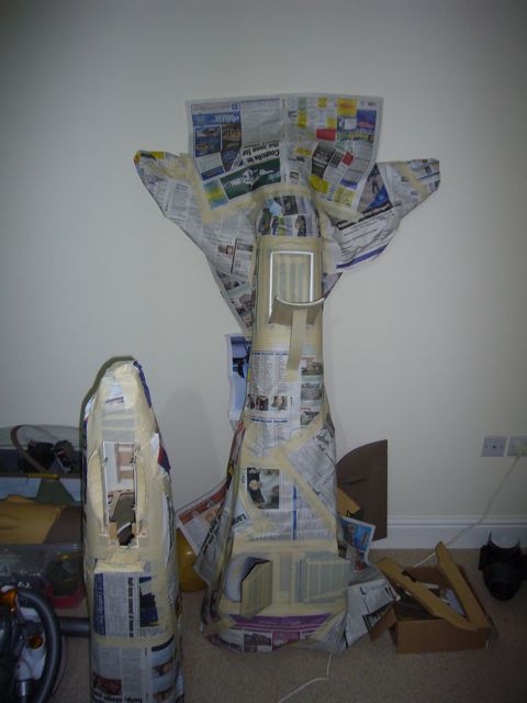

I've had my fill of masking for the next few months................All the internals have been sprayed grey. Gear doors and the speed brake have been sprayed the same dove grey as the gear. The photos don't really show the state these were in. All the gear doors needed painting because the way it came from the factory just wasn't up to standard. Its just a matter of fitting the fuz out now. Haven't made much progress on the wings as I'm waiting for flap hinges.
Ive included a photo of the cockpit with the frame sprayed up, such a little detail makes a huge difference to the finished model, well worth doing...............
Not the most exiting photo's but none the less.............
Cheers, Alex

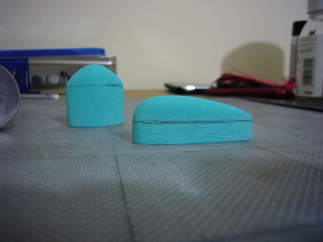

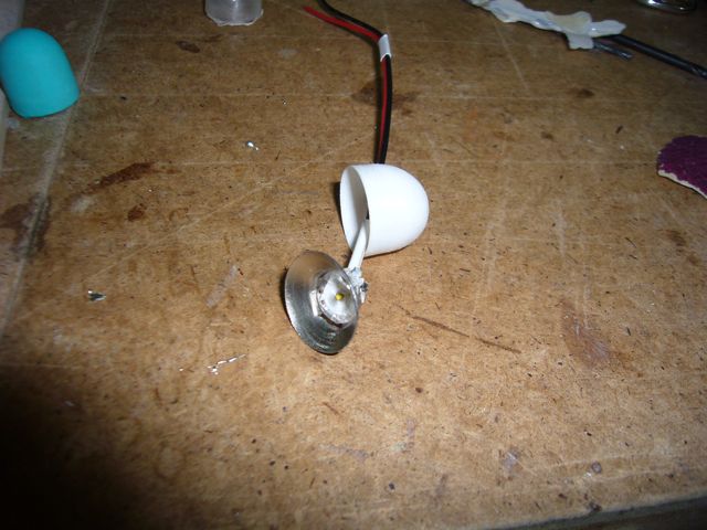

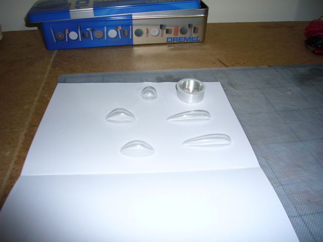

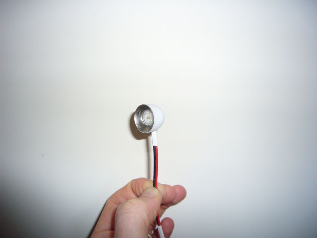

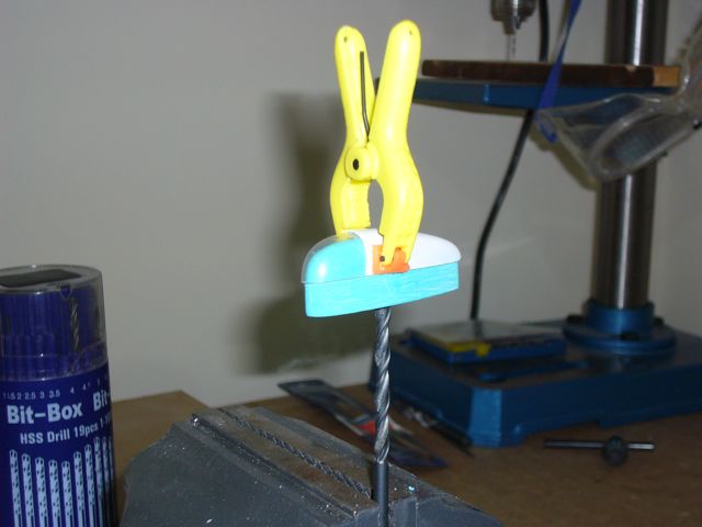

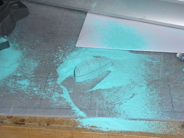

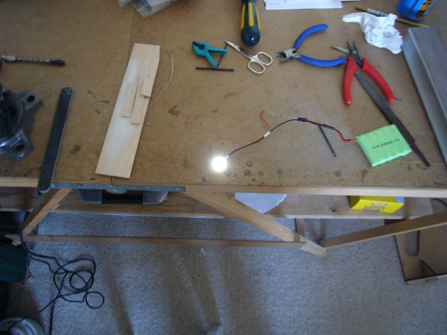

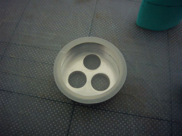

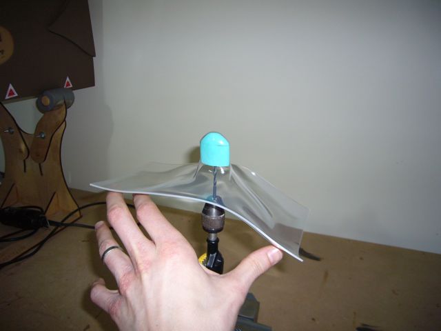

This is going to have a full complement of lights. I'm hoping this will be something special. I've sourced some very powerful devices for this. Included will be the large landing light in the nose which will be made with a cluster of three high power white lights over 100000 MCD's worth. One retractable landing light in the nose wheel well, two strobes with a proper flash, flash , pause sequence and an alternating Anti collision light (not strictly scale but should look good). The Nav lights are very high power and also true colour lights unlike the low power mass produced LED's you see in your LMS. The only lights that are LED's are the strobes, Although I have someone purpose building the circuitry for these new high power lights to be used as strobes. It's all experimental atm so not sure what they will look like in the real world but they will at least be as good as anything else on the market.
All the lenses had to be made from scratch, I used the plunge molding technique, the pictures should explain things.
For the large landing light I've made a litho plate housing that slots into the nose. You can also see the start of the little retractable light I'm making. The pictures you see with the little landing light illuminated are taken in full sun with the camera flash on. If you look directly at these lights you get a nice white blob follow you around for hours, as I found out..........
Cheers, Alex

The plastic is about 2mm in thickness. Just like vac forming the temperature of the plastic is the most critical thing.
I've had a few emails regarding the lights I'm using. I may make a full lighting package for this model as I've had a few requests. For those that have enquired I'll get back to you on pricing. I just want to make sure everything is good with this one and the lights are actually better than anything else on the market. The first few flights should show what they're like.

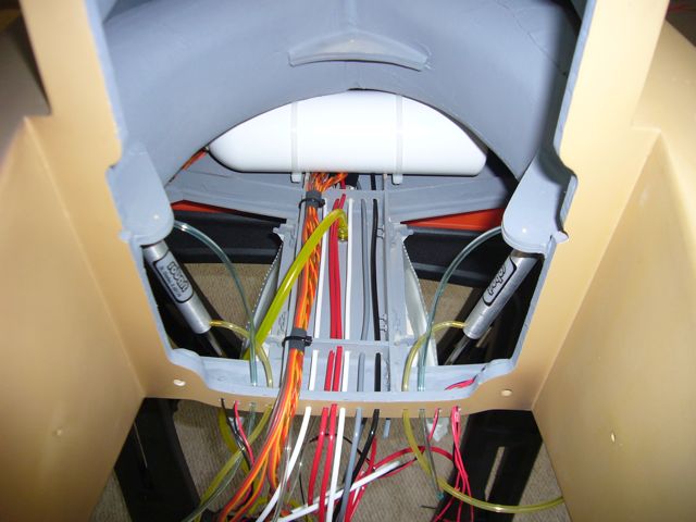

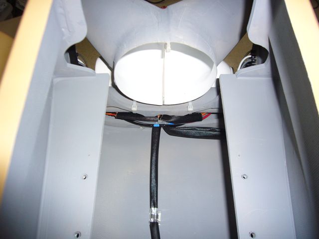

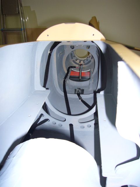

All the wiring and pneumatics in the back end have been protected with heat resistant sleeve and held down with aluminum clips. I think I suffer from OCD with these installations, I just have to make it all neat or I go a bit cranky. I drilled a few holes and ran all the wires and tubing through them careful to keep the strobe wiring away from everything else.

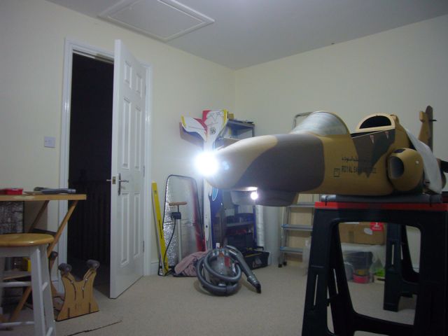

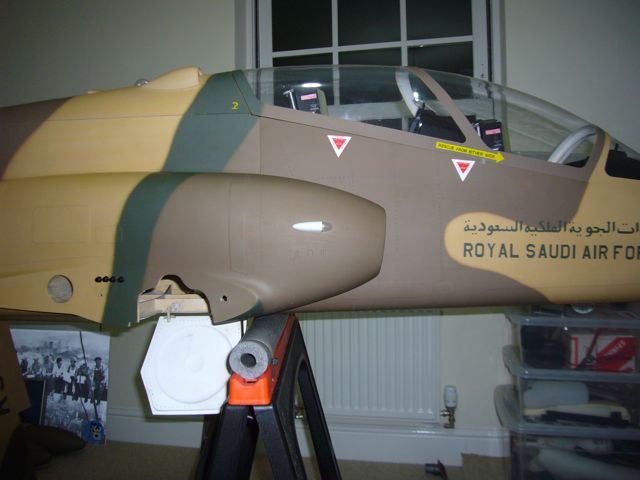

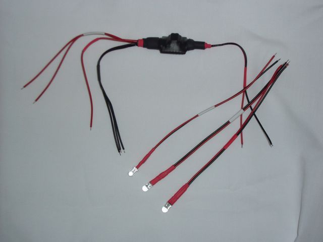

All the lighting has been installed, unfortunately we couldn't make a strobe unit to accept the high power lights as we kept burning out the chips we tried, so these lights are the conventional LED's on the strobe system consisting of 2 whites and one alternating red. The top strobe light is mounted on the turbine hatch. I crimped four contacts onto the respective parts allowing the operator to slide the hatch on without worrying about lighting connections.
The Nav lights are true colour Ultra lights and should be very good, far better than LED's. The small retractable landing light that's fixed to the gear door is also an Ultra light. The main landing light consists of a cluster of three very powerful lighting devices, these must not be looked at directly within 10 feet or risk damaging your eyesight, they're extremely powerful! I'm looking forward to seeing them on in the air. The Navigation and strobe lights will be on a switch housed inside the forward fuz. Both landing lights will be on a rc switch selectable from the transmitter. All the light lenses will be installed at the end of the build. The picture with the lights on was taken with the daylight bulbs in the workroom up at 200W so it was pretty bright in there.

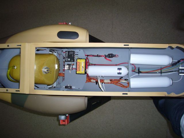

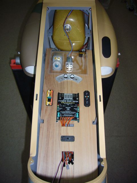

The main equipment trays have been replaced for my own design. I've done the installation in two layers. Under the main tray we have three air bottles the forward two for the brakes, tank release and air brake with the larger one behind for the gear. This is tee'd into a much larger tank housed under the intake ducting. At the back Ive installed all the sequencers and ECU, all the lighting wiring, air tubing and servos enter under the sequencer tray. The top tray houses the powerbox, rx and switch's etc... I had to lower the rx and PB to clear the cockpits. The fuel system components are mounted on a removable plate which gives easy access to the ECU and sequencers. Just four screws hold the plate down allowing good access to components underneath. I wanted to house all the switch's and filling stations under the cockpit as you have to remove this to get the turbine hatch off anyway.
I could have just mounted everything on the top tray but I think this would have looked cluttered and lacked symmetry. I think the extra effort was worth it...................
These are the pictures of it all during the installation, I'll take some completed photos of the trays later.

Are there any room for smoke tank(s) anywhere near the CG in the Hawk?
Old 02-27-2010 | 01:44 PM
  #71
Joined: Nov 2003
Posts: 551
From: Caracas, VENEZUELA
Default RE: Large Skymaster Hawk build
Staale:
Yes. Plenty of room.
Jack

Thanks.
Any other availiable places behind the main tank, over or under the intakes? Would prefer a lower installation of the smoke tank to get it more out of the way.
Old 02-27-2010 | 04:08 PM
  #73
Joined: Nov 2003
Posts: 551
Plenty of space under the bypass too.
I put 3 large air tanks for the retracts in there. After realizing how little pressure is needed to operate, it is definitely an overkill.
Jack

Hi guys
As Jack said loads of room for a smoke tank, not fond of the stuff myself.....
I'll take some photos of where you could fit one. Abroad testing with a customer atm so will do it when I get back

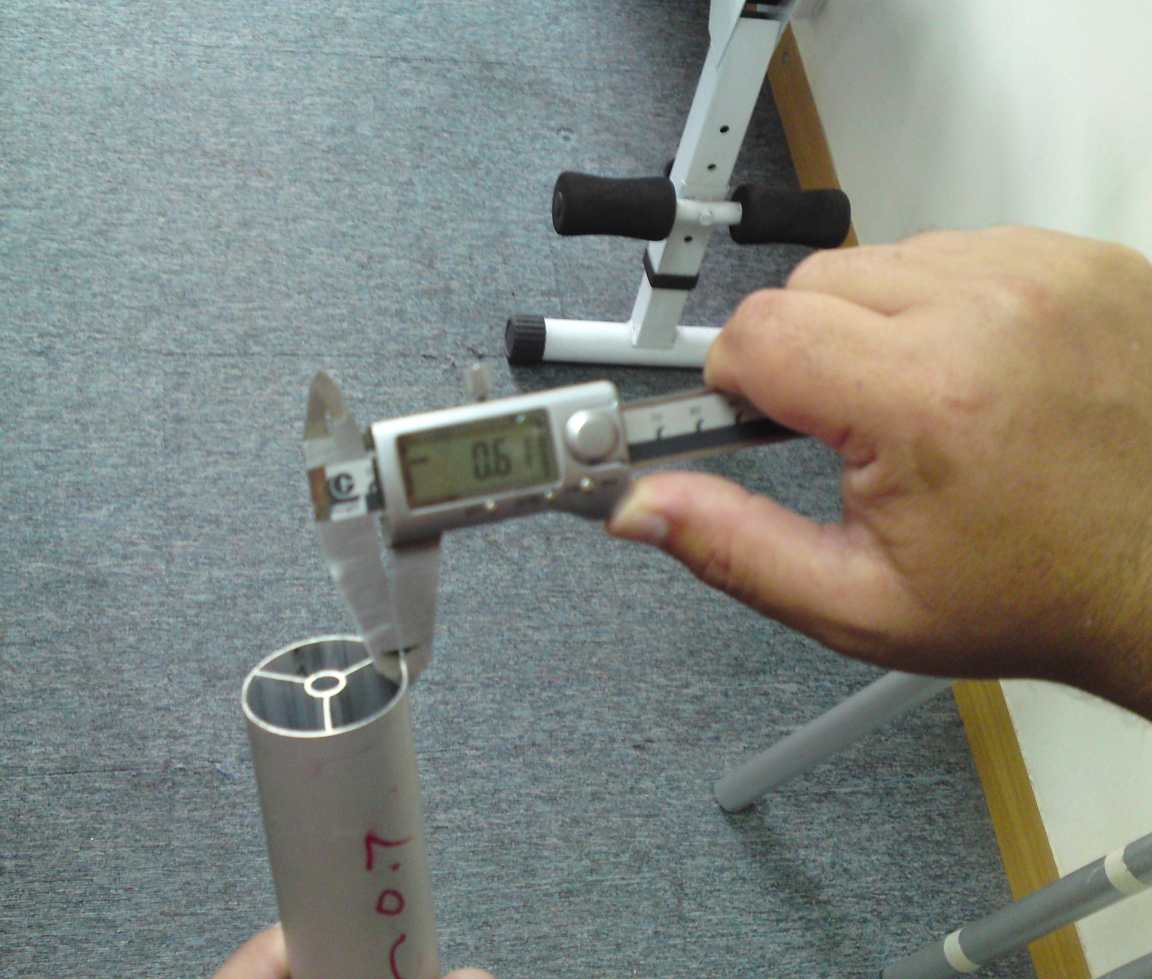

Here is the pictures showing the difference between the 2 pipes. If your pipe is 0.6mm please e-mail us and we will replace free of charge. We will take some pipes to Florida Jets to echange for USA customers. So if you are not attending or know of somebody that will, please collect the pipe from us in the Florida Jets.
For UK and rest of world we will send via EMS.
This problem only for Viper large and Hawk Large. So please check and send us e-mail before flight.
Best Regards
Anton
