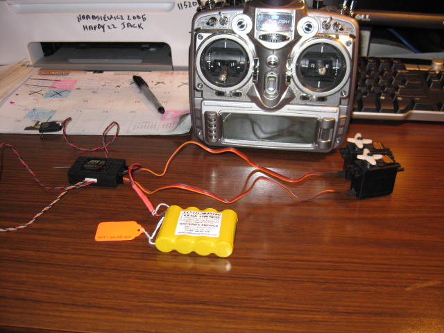

So I was re-doing a radio install on a King Cat today and had the elevators on two separate channels using JR's dual elevator function. The channels used were Channel 3 and 10. When I moved the elevators, they moved at different rates. It's almost like the signal was being processed at different speeds.
When I put them both on the same channel (using a Smart-Fly EQ-10) they move at exactly the same rate.
So, since the servos speed is not the problem, it is either a problem in the EQ-10, although I doubt it since it just transfers the signal from the receiver, or it is a difference in the receiver.
Any help or insight appreciated.

JR 1221 receiver, EQ-10. Elevators were on channels 3 and 10, and servos were not in sync. When both were put on 3, they are identical.
Chad

HI Chad, you must be doing some thing wrong, I just set up a brand new model and works fine, 2x 8611 servos, check you don"t have a servo speed ajustment (24).
Rcpete

I'll try bypassing the EQ-10 and go direct to the receiver and see if that makes a difference.
Chad
