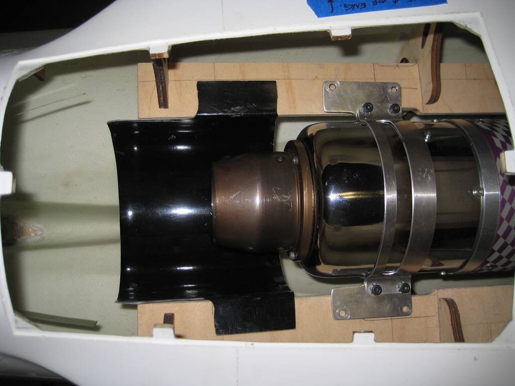

#389

ORIGINAL: skydell
An additional issue was that the upper fuselage was heating up severely during taxiing in. I have a Jetcat P-80 SE with stock pipe, 3/4'' between end of engine tail cone and front of pipe bellmouth. I cut the cheater holes in the bottom fuselage, between the strakes, as suggested by prior posts, and they helped only slightly. Then I mounted a 0.016'' thick aluminum plate covering 1/2 the diameter of the inside of the upper fuselage as a heat shield, and that cured the problem.

Well I want to congratulate my friend Cliff, he maidened his 2M Viper tonight.
It flew great from the get go, no adjustments required other than maybe a click or two of aileron. He used my C.G. fixture and set the C.G. to 12.5 mm. See post #314
He is using a Jet Central Falcon for power and it pushed it with authority!
The only issue he has is with the pull pull steering, so now he wants my direct drive version, see post #308.
Oh like I mentioned in post 389 the heating problem is solved

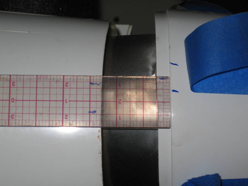

#398
My Feedback: (12)
Joined: Jan 2005
Posts: 141
From: Anaheim Hills, CA
Tail Pipe Length Issue.
OK here's where I'm at.
I've installed the JC as far forward as the front fuse bulhead will allow the engine mount to go, andthe pipe isa over 1 1/4" too long. This is with the pipe inserted all the wayinto the tail cone (TC) until it's even with the exit end.
[Aside] The SM instruction manual says the pipe should extend past the former a minimum of 10mm. That seems like it may cause the tail cone to get pretty hot. I saw on the thread someone adding BVM Heat Shield to the inside of the TC.But I'm wondering, if thepipe were further inserted past the former a ways further (maybe not to all the way to the end), would this eliminate the TC heat damage possibility?
Here's the pipe with a 20mm gap between the exhaust nozzle and the pipe and the resulting1 1/4" excessive length as measured at the TC.
So I attempted to move the engine further forward by reversing the engine mount (which puts the CG of the engine too far back IMO). The engine mount would then allow the engine to move an additional 1/2" forward. Not enough to solve the problem. Plus the starter cone is now touching the intake center web.The center web has already been cut down as far as I dare, which left 1/4" of material at the glue joint. I don't think I want to cut any further in to it. This also precludes 'notching' the engine mounting bracket to fit around the forward fuse bulkhead as this would still net only a 1/2" (with the engine mount in it's original position) gain due to the intake duct limitation.
Any ideas? It seems like I'm going to either have to shorten the pipe, or buy a new one that fits. Thanks!!
Best regards, Jim
Best regards, Jim
