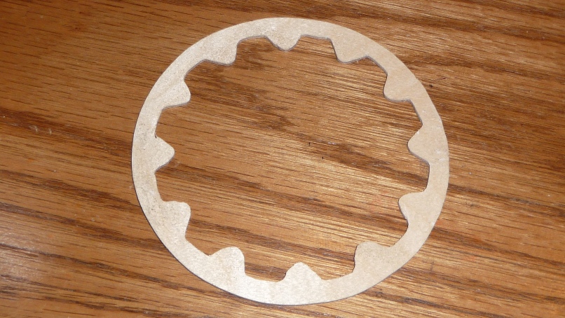

As mentioned in a previous post I used a Jet Legend T-45 pipe, the pipe diameter is slightly smaller than the Skymaster pipe so I made an adapter ring.
See attached PDF for a template.

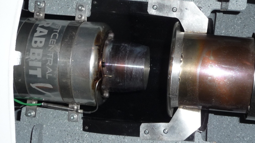

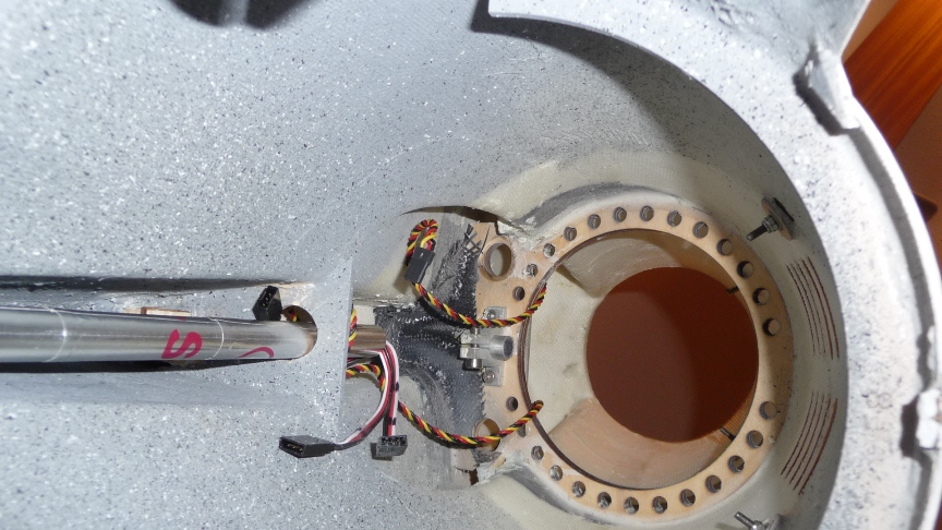

I had to take the Rabbit out of the Flash to check the C.G.
I had a bypass section from another jet so I decided to use it, it helps shield the air tanks and wiring
I used a cardboard tube wrapped in Aluminum tape for the wiring duct.
I like the Jet Legend pipe mount much better that the Skymaster system

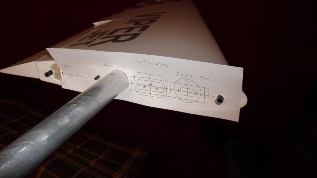

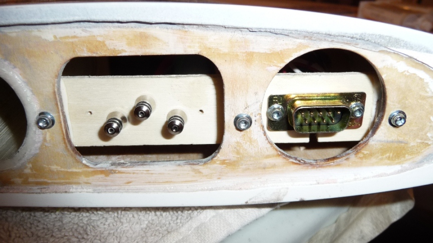

Some shots of laying out and installing the wing fittings, the PDF templates are included

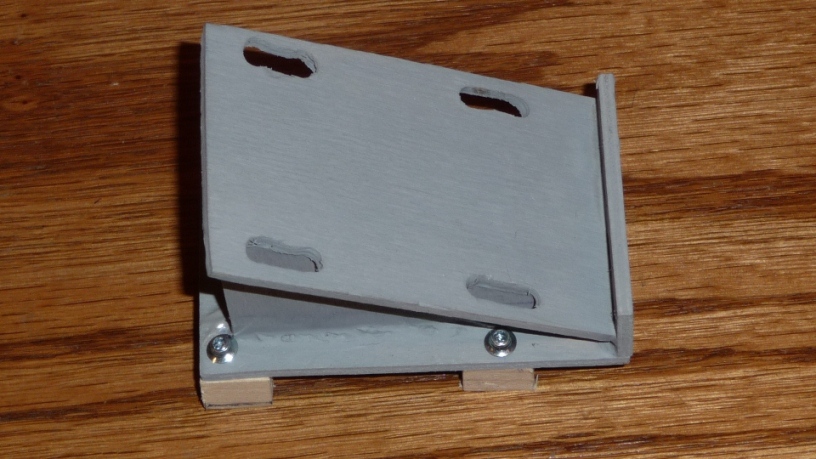

UAT mount and wing pin locking plates for the front locating pin

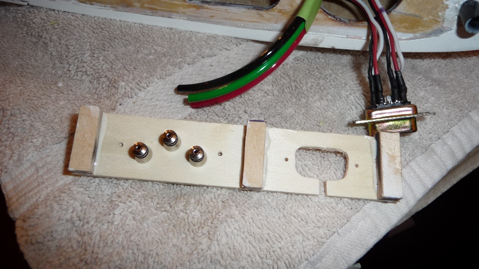

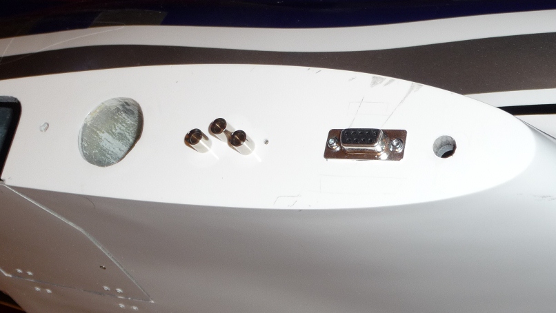

In post #334, where did you get those air connectors?
And are they reliable?
Old 04-25-2011 | 08:44 AM
  #346
3DHELINUT's Avatar
Posts: 1,063
From: Rahway, NJ
Default RE: Viper Jet 2M Pointers/ tips.
Todd has them
[link=http://dreamworksrc.com/catalog/product_info.php?cPath=13_19&products_id=796]http://dreamworksrc.com/catalog/product_info.php?cPath=13_19&products_id=796[/link]
Thanks I've been using these... no leaks yet... but obviously they take more time to connect/disconnect...
http://dreamworksrc.com/catalog/prod...roducts_id=799
