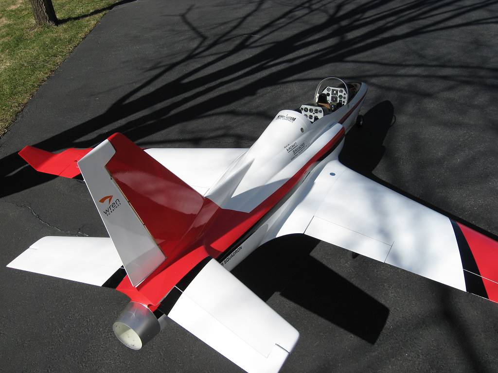

My buddy Cliff's Viper cockpit installed into the canopy frame, he made it so it can be removed with screws

Using screws was my first thought. Going up through the bottom of canopy frame like in the pics was what I had in mind, but how to secure the screw into the flimsy plastic of the cockpit tubs has been the hold up.
Bond 1/8" plywood strips under the plastic of the cockpit, then the screws have something to bite into

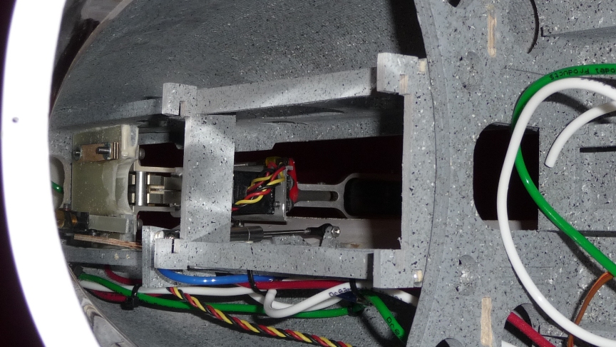

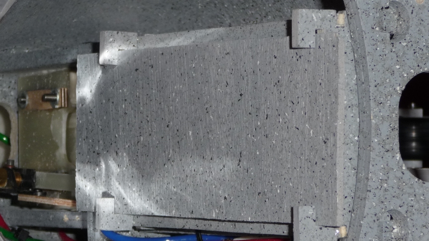

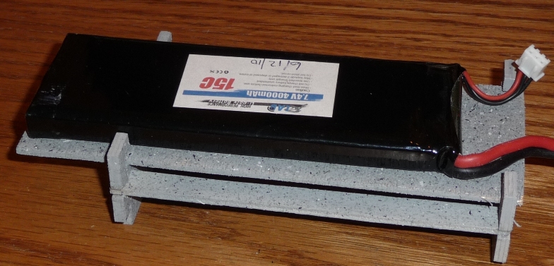

I been experimenting with mounting of the batteries as far up front as possible, Skymaster does give some room in the front; however it allows the batteries to press against the fiberglass and will cause distortions over time on the outside skin.
So I designed a battery carrier, I need to add a holding mechanism for the tray, and some slots for the battery hold down straps... other than that it should work

Old 04-27-2011 | 10:49 AM
  #358
My Feedback: (13)
Joined: Apr 2004
Posts: 699
Received 40 Likes on 24 Posts
From: Las Vegas, NV
Default RE: Viper Jet 2M Pointers/ tips.
RCISFUN,
Thanks for all the PDF files...big help. I may end up building the tray at some point. At the very least I'll pass it off to my buddy who's building one now.
I was racing to get mine done so I could fly it the weekend prior to CA jets. I ended up finding, even with the batts on either side of the nosegear, that I needed a full cockpit with two pilots (ok one pilot, and one Barbie liberated from my daughter's stash (which she asked to get it back after Barbie was a double-amputee by the way!)) to balance it. I flew it with a ~15mm forward of the center of the main spar CG (mains empty, UAT full) and have found that I'd like to move it back a bit. The elevators are deflected up a couple mm for straight and level, though the inverted down lines feel pretty solid.
All in all I was quite disgusted by the time I finished the build with SM/XJ, but flying it took most if not all of those feelings away. It really flies quite well.
One note after 22 flights, the sheer pin in the nosegear is more of a bend pin. I had a series of very nice, although a bit fast, landings and ended up bending the pin enough that I did a couple gear passes to make sure the nose gear was all the way forward and locked. I'd recommend changing that pin before even flying it (thanks for the help Henry at CA Jets). Food for thought.
Dave

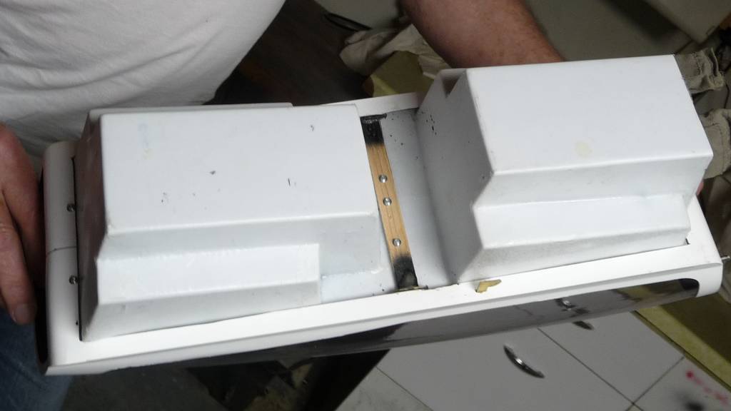

Well I have been busy for the past week fabricating the cockpit tubs for the viper, I was going to try to purchase them and even PM'd Anton asking for price and delivery...no reply[]
So I said the heck with it and borrowed my Buddies to copy, I started by drawing all of the part in Auto Cad, attached are 1:1 PDF files of all of the components.
It was better to do this anyhow in my mind as the Skymasters were too deep and didn't allow any clearance for the trays below.

Here is the beginning photo and the progress to date photo, my parts are Grey, I have not made the fine details of the instruments yet.
I will post more photos of the build later
