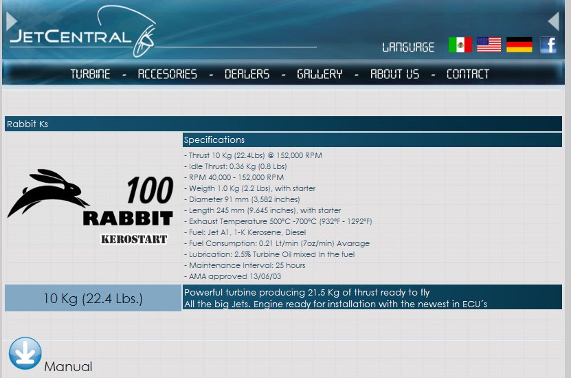

Rich,
Thanks for the reply. Tell me about the Jet Central Rabbit please. I am curious as to how it compares with the JetCat 100RX.
I would appreciate your input.
Old 12-07-2012 | 07:06 AM
  #482
RCISFUN's Avatar
My Feedback: (44)
Posts: 6,931
Received 34 Likes on 30 Posts
From: Erie, PA
Default RE: Viper Jet 2M Pointers/ tips.
http://www.jetcentral.com.mx/rabbit.html
22 Lbs Kero Start, you won't be sorry

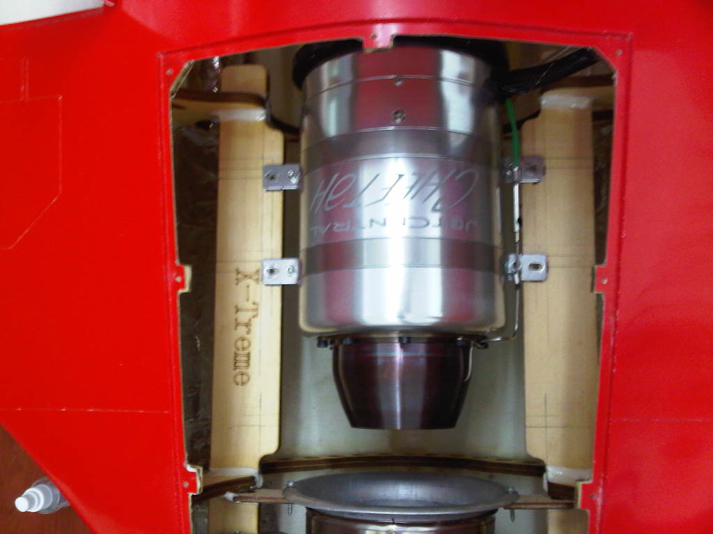

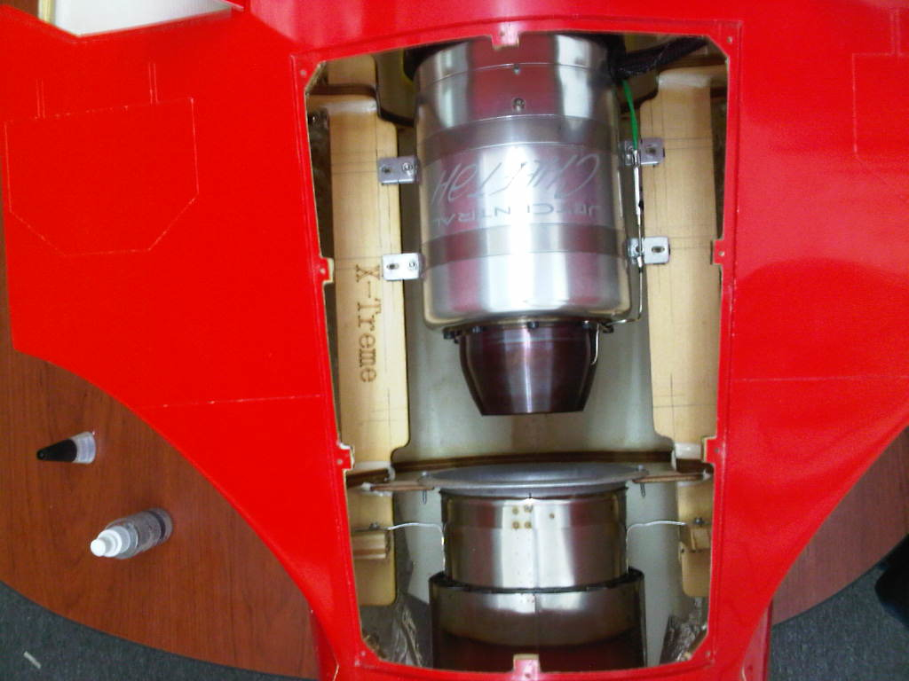

To the folks that have built the Viper, do you epoxy the keying slots on the rails that the turbine mounts to or is the turbine its self used to hold the rails in their keying slots?
Old 05-03-2013 | 08:02 AM
  #490
My Feedback: (10)
Posts: 1,109
From: North Port, FL
Mark:
With the three 2m Vipers built by Bill Hatcher and myself, (make that 4) we trial fit the turbine mount rails then Hysol in place. We put aside for 24 hours. This completes the rigid bond/assembly between the two formers/bulkheads.
BTW, when installing your Cheetah, place the turbine on the rails with the name Cheetah toward the top of the fuselage. Therefore, from the bottom through the hatch, you will see the turbine but not the turbine name. Nozzle should be no more than 1" from the entrance to the metal pipe. . .no less than 3/4." This will give you optimum performance and proper cooling for the pipe.
Regards,
Eric
Old 05-03-2013 | 03:10 PM
  #491
Joined: Jun 2004
Posts: 63
From: villahermosa, MEXICO
This is what I did.

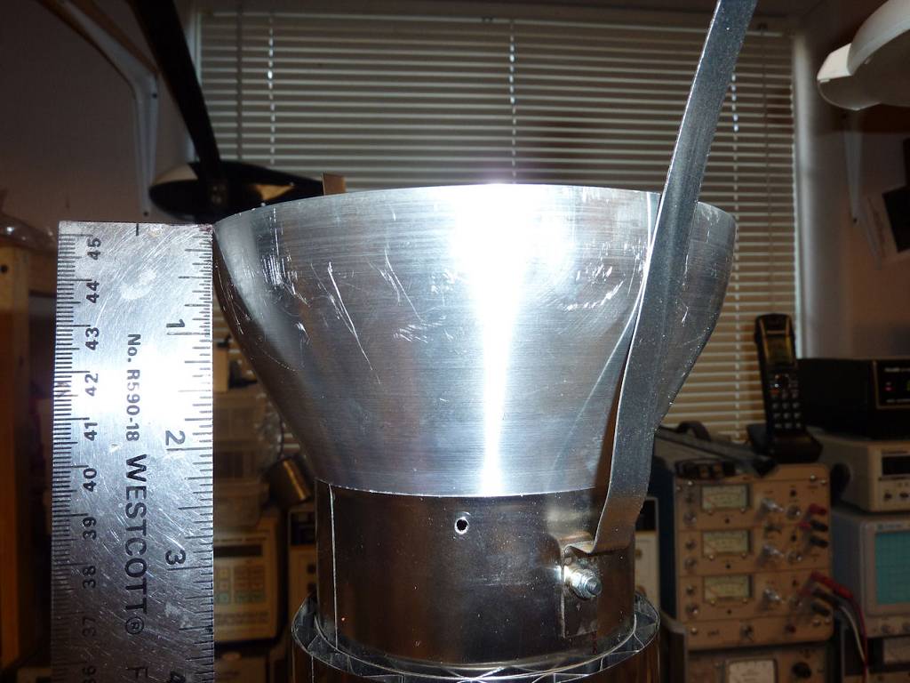

It seems that the bell mouth supplied by SM on my Viper is noticeably different than the other SM supplied bell mouths . The large end opening is a whopping 5.5 inches across and 2.5 inches long. I'm thinking of cutting it back some because its so wide it interferes with the mounting rails.[img]

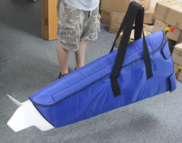

we will support the new wing bag for 2M viper / $39.00 USD
