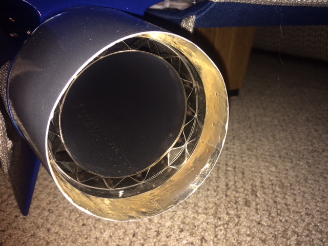

Looks like this thing is gonna be way tail heavy... Where are you guys putting the end if the pipe in the cone ?? If you put it 10mm aft of rear former ( which is the front of the add on tail cone ) the end of the pipe is gonna be way inside the the add on tail cone. Even with Heat Shield is heat gonna be a problem for the add on cone ? Seems to me it would be on the ground an idle. I need help here. I don't want to end up with a ton of ballast in the nose... some, well, ok, but not a couple of pounds !!!. What an I missing here ?? These are short airplanes to start with and most the weight is behind the spar/CG. Is the pipe too short ?, I think I'm still gonna be tail heavy even with the engine ( Cheetah ) all the way up to the inlet split, but then the pipe ends up a couple inches inside the tail cone...I normally don't worry to much about total gross weight, but everyone seems to indicate here and elsewhere that that is important with this airplane. Any Ideas would be appreciated !!!

Danno,
I have a cheetah in mine and was able to balance it without any added weight. I have the batteries all the way up front and created a tray for the turbine battery that was listed here in the thread. It worked great. The turbine is as far forward as I could get it. The tailpipe comes all the back through the fiberglass tailcone to almost the end. About a 1/2" of the tailcone is exposed.
Let me know if a picture of the mount will help.
Gary
Gary

Rcjet,
Mine was the same as gbarnes. I did have the paint bubble slightly on the fiberglas tailcone. I ended up lining it with heat blanket covered in Aluminum tape...that stopped it. I had no weight in the nose of mine, but did have a heavy cockpit. I ended up with mine balanced on the back edge of the wing tube if I remember correctly.

Gary and Dave,
Thanks so much !! I have come to the conclusion as you both have indicated that the pipe cannot be flush with tail cone. I'm putting the Cheetah front mount tabs 1/4 inch behind the front mount former. Pipe bellmouth will be 28-30 mm behind engine exhaust cone, and the pipe will be aprox 3/4 - 7/8 inch from the end of the fiberglass tail cone. I have stretched all the components as far as I can !!!
All this could have been avoided if the pipe were a bit longer... Oh well... I have BVM Heat Shielded the inner of the tail cone and will also put some Hi-temp foil tape.. See what happens. I am not opposed to talking an inch off the fiberglass cone if I have to.. Everything else is shaping up !!.

Another idea Danno.
As you know the Viper comes in tail heavy so you need as much weight forward as you can.
What I did was cut the inside of the intake ducting, mount the turbine as far forward as possible (to assist cg), mount the pipe wherever it needs to go, then cut the end off the fibreglass tail cone so it's only 10mil longer than the pipe. I think I cut 30mil off the pipe. The result is my Viper is balanced perfect with no lead anywhere, and you can't tell the difference. It also enlarges the gap at the back for hot air to escape as the standard set up is very cramped.
