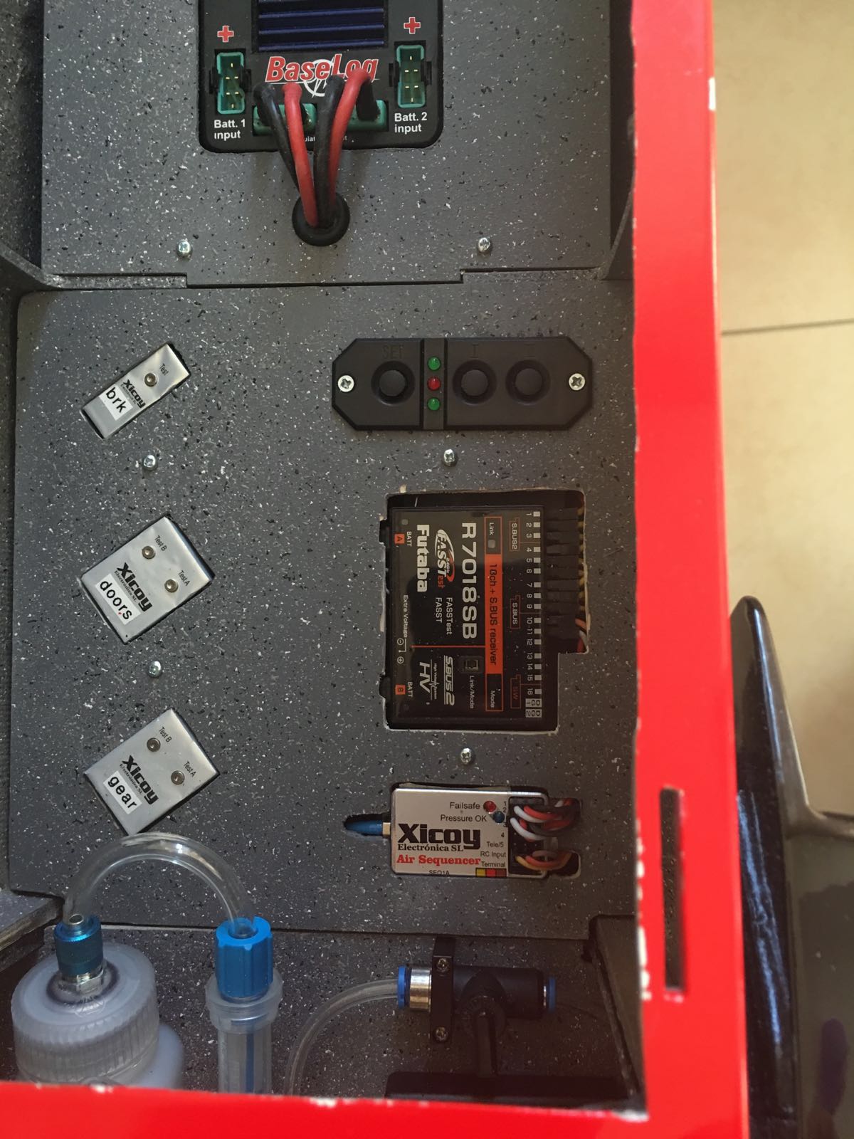

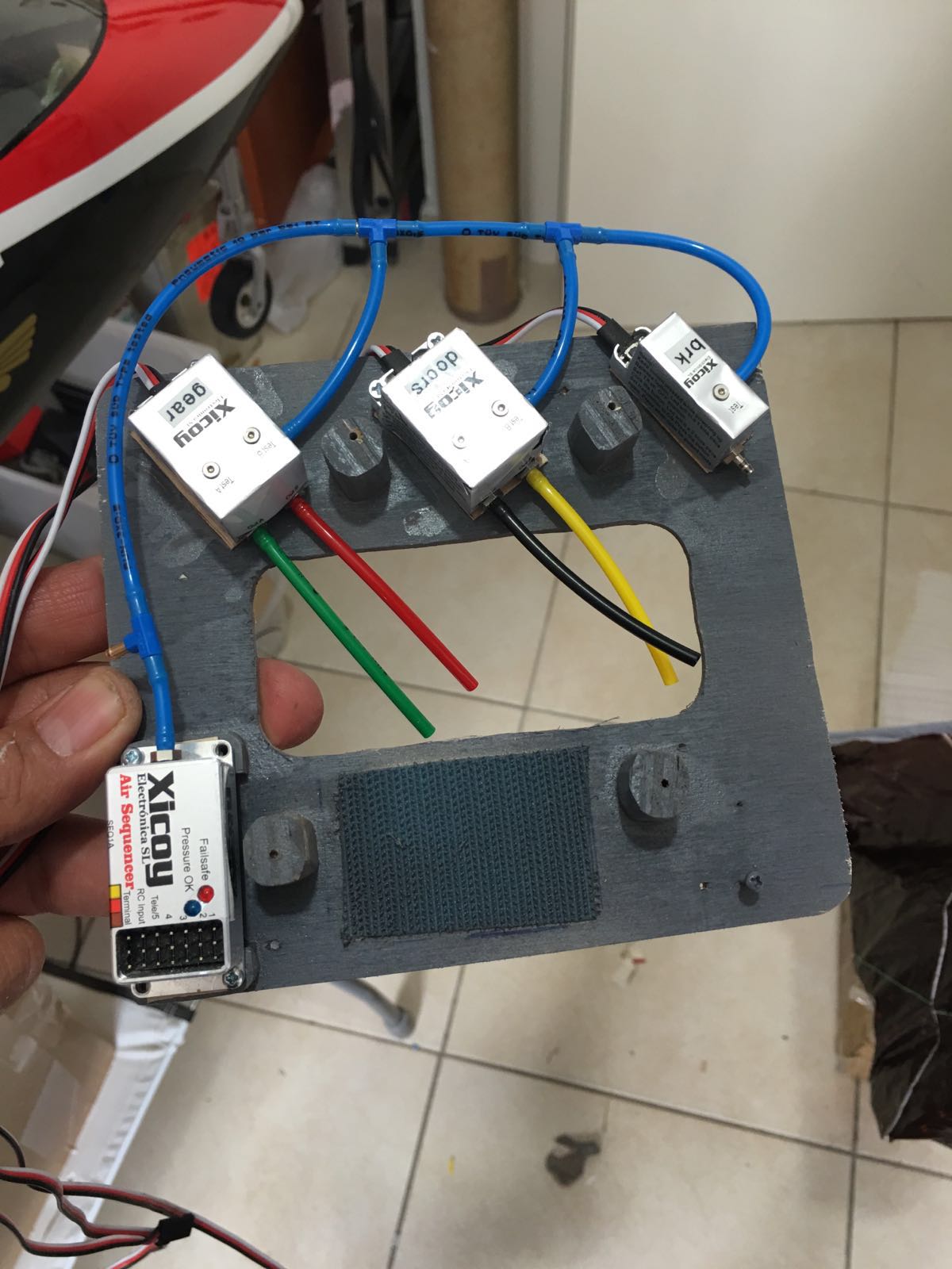

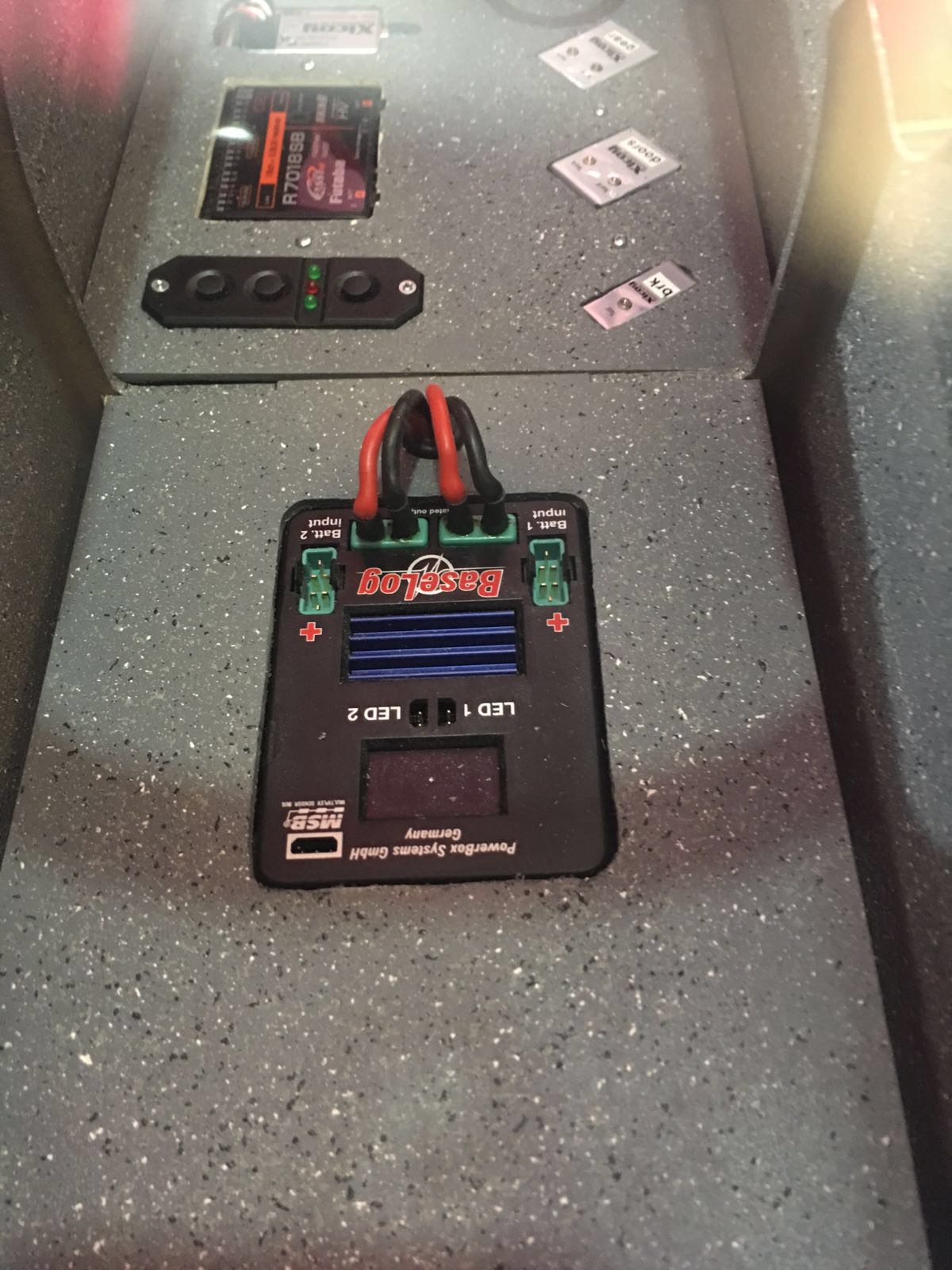

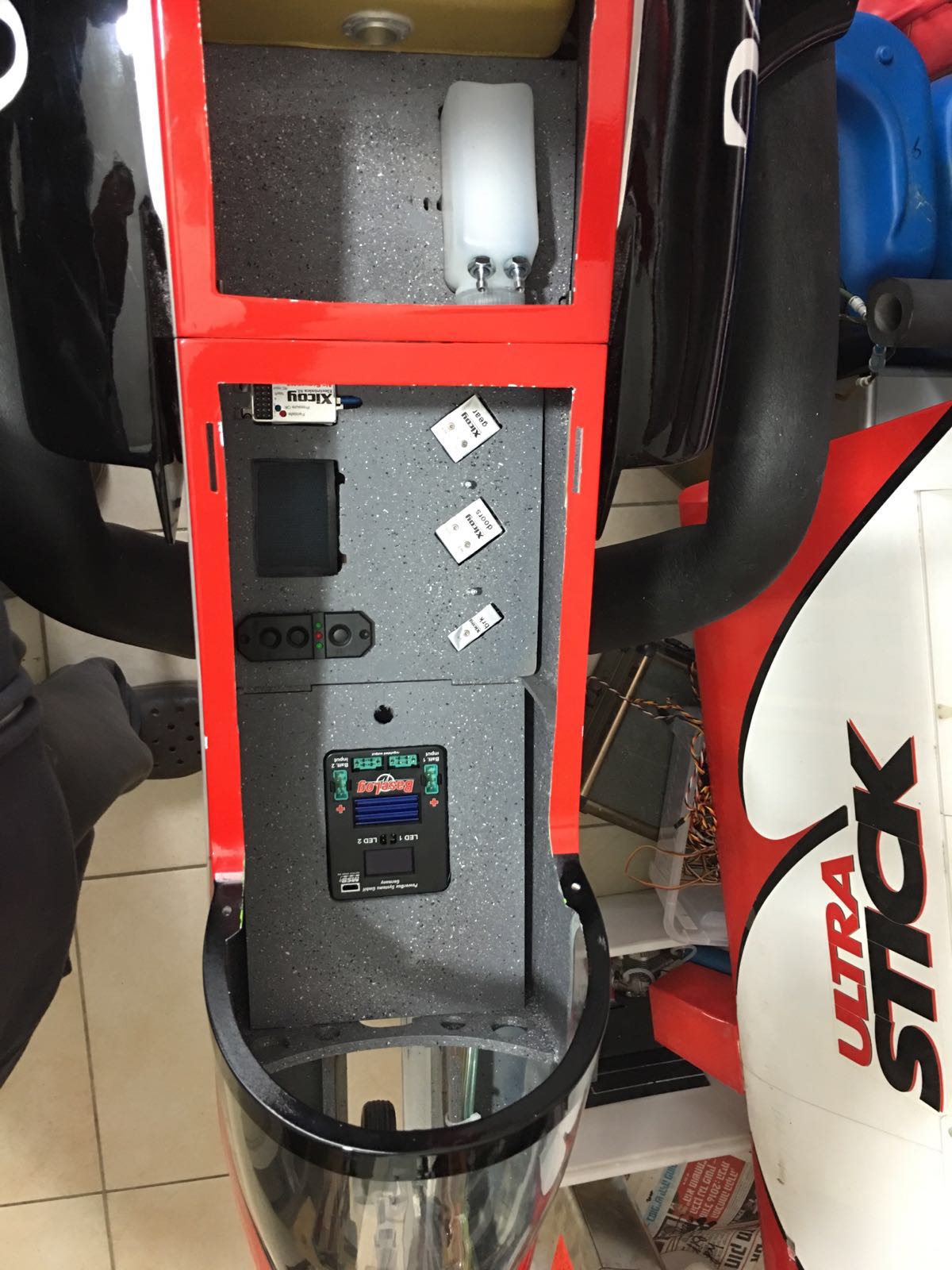

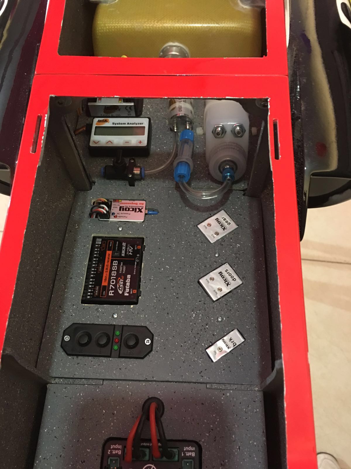

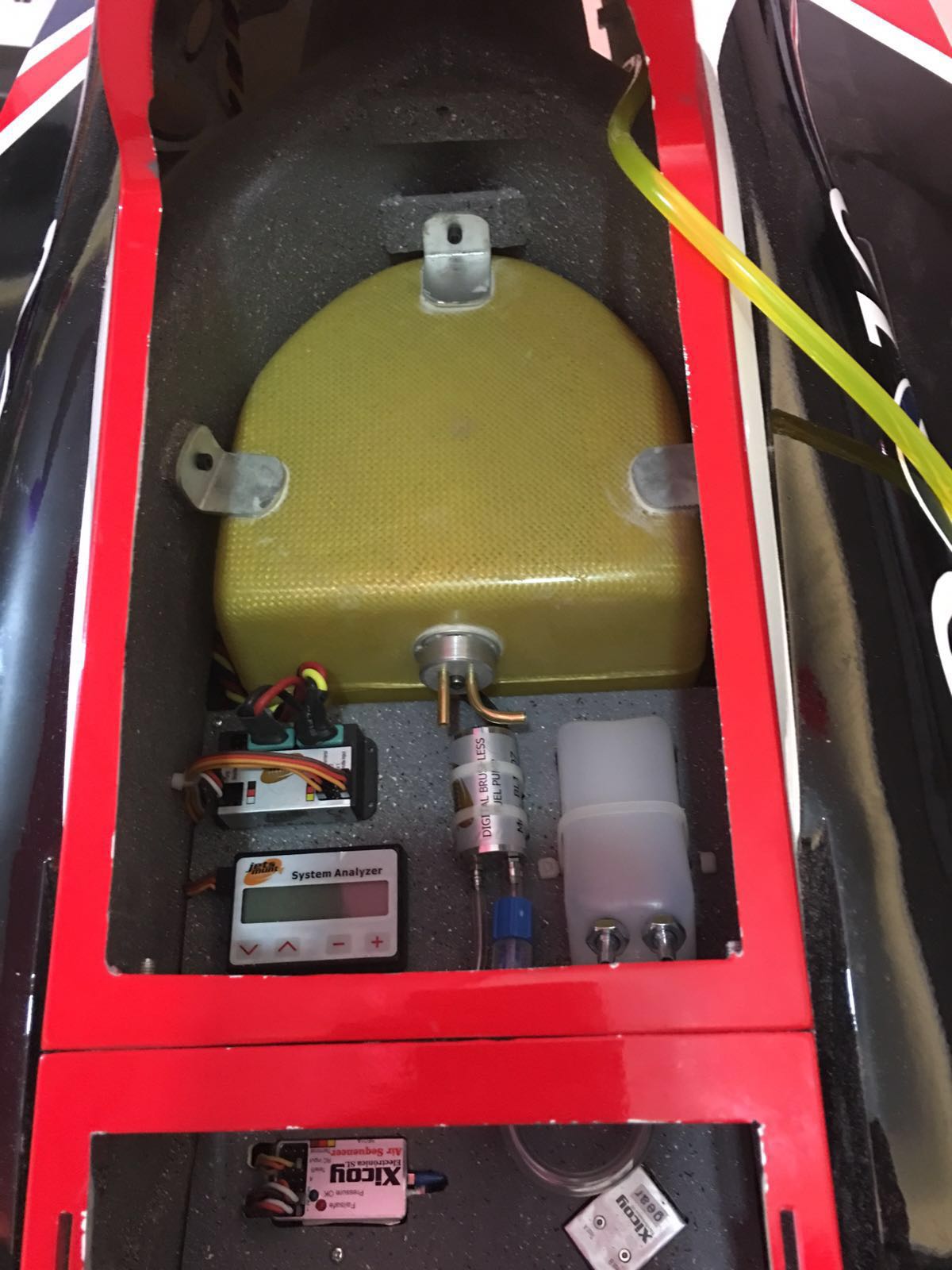

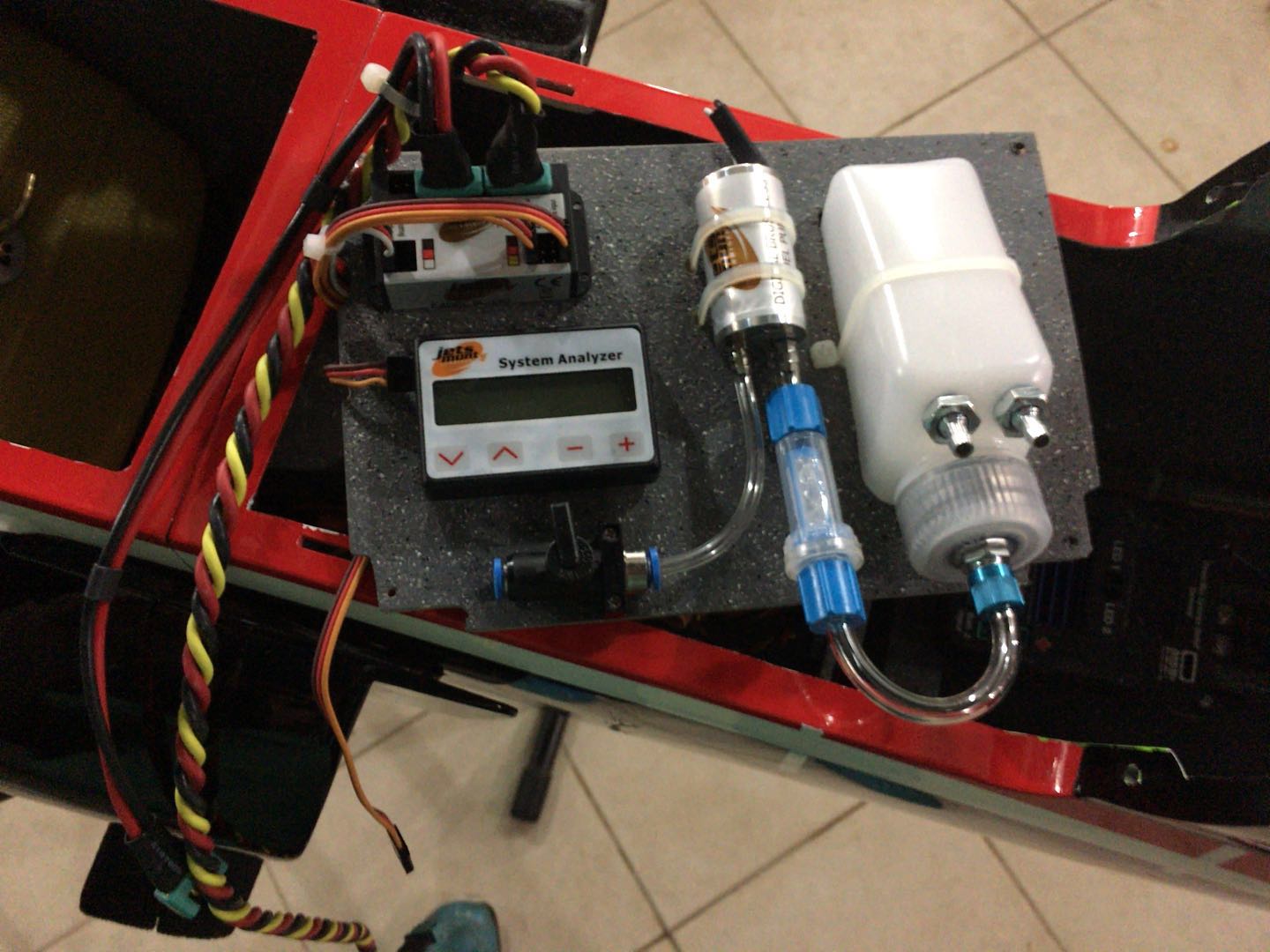

air tray - all in one
savox low profile 9-10kg servo fittet into horizontal stab
air tanks were located under the turbine mount
1 pic loaded bu ,istake - has n relevance - cant find a way to delete it

Old 02-07-2016 | 03:38 AM
  #532
warbird_1's Avatar
My Feedback: (61)
Posts: 2,578
Received 9 Likes on 9 Posts
From: Perry,NY
Izzy, can you tell me what the number of the savox' servos on the elevators are ?

From: REHOVOT, ISRAEL

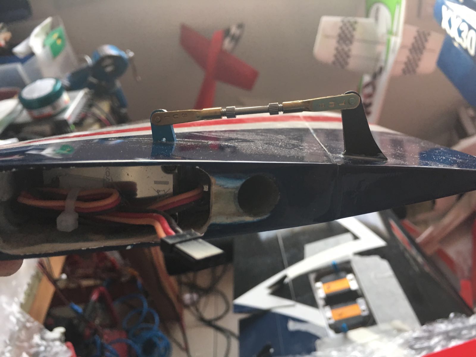

SB2261
below is the link to the servo - zero play - but you need to rebuild the housing
also make sure to change the geometry such that the horn will be 90 degrees to the hinge line
skymaster glued the servo mounts wrong, and if you keep it that way , you need to use ball joints to make up for the mistake
( ask me how i know - i built mine, and fixed the others that i built for friends ) http://www.savoxusa.com/product_p/savsb2261mg.htm

Originally Posted by warbird_1
another thing that bothers me about the elev. servos is them wanting you to mount them so that you have to open up the stab root the the fuse side for servo bottom clearance. i was thinking about mounting them conventionally but i'm concerned about the control horn being so close to the root of the elevator control surface.

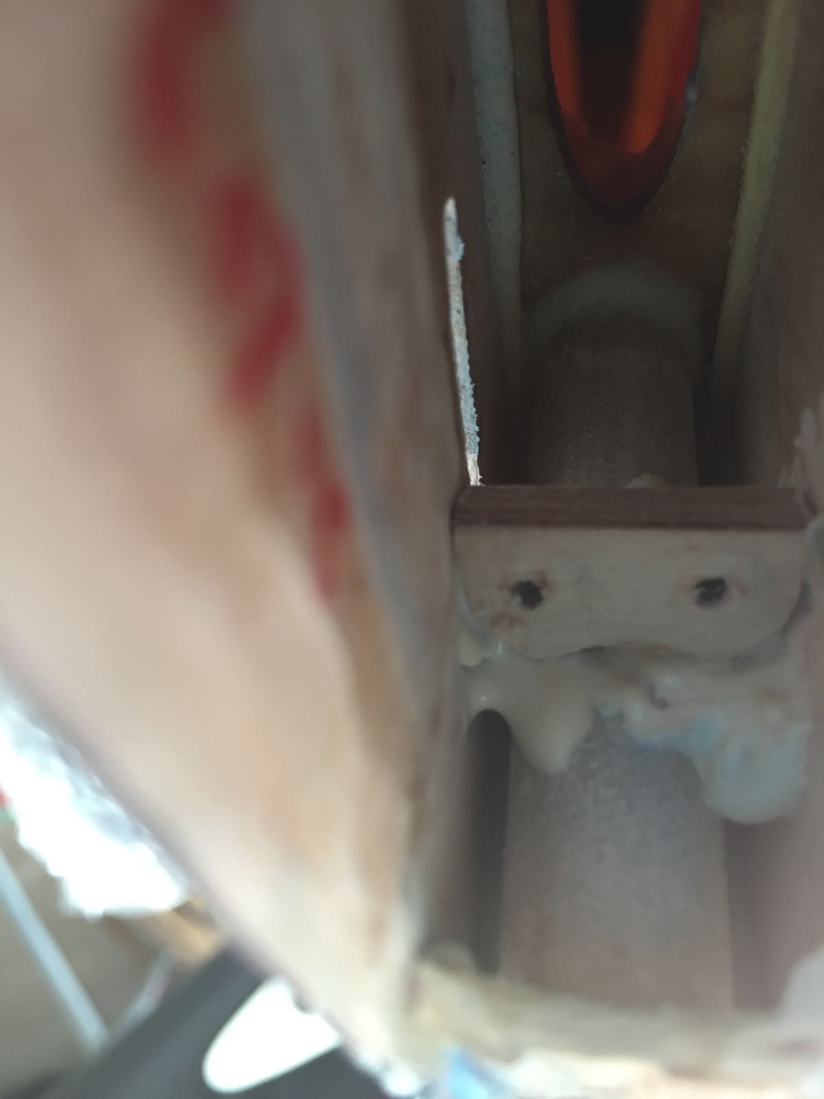

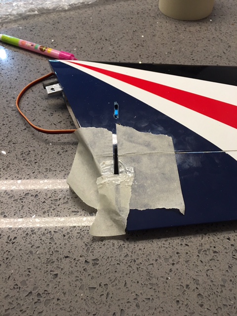

the kits i built were a year old and 4 years old , so no changes were implemented
if you mount the servos as i dod you do not need to open up the root of the stab at the fuselage end , in fact , i made it so that the stabs are removable , and makes transportation easy
i will upload pics later tonight of mods i did

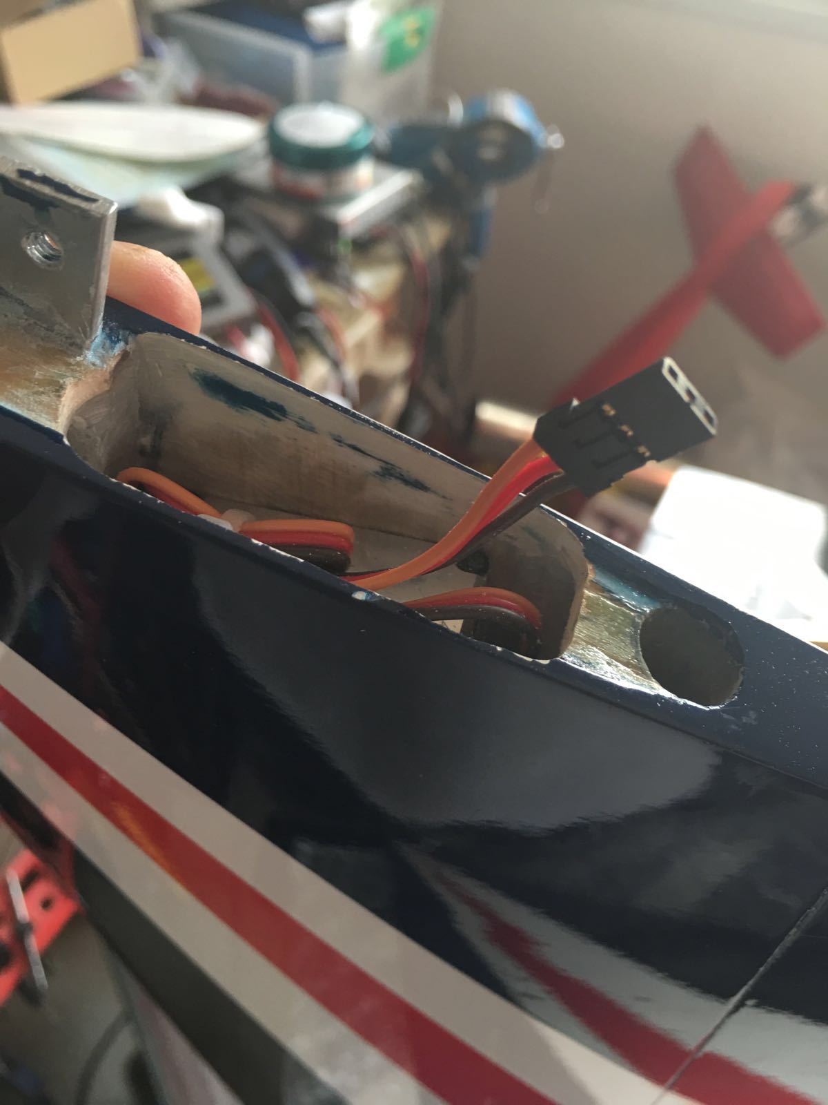

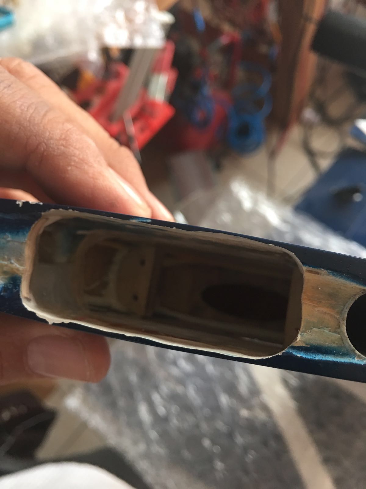

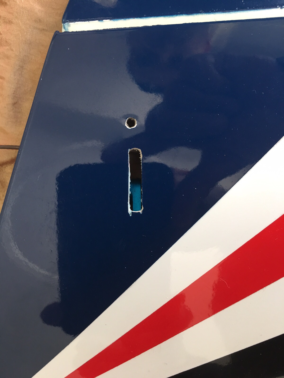

Posts: 389

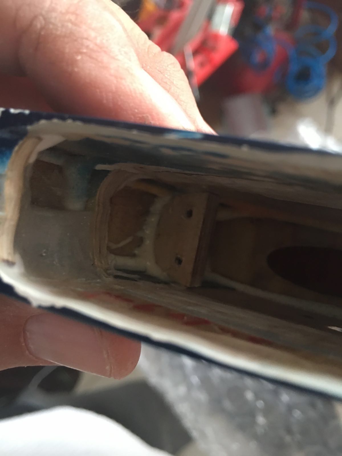

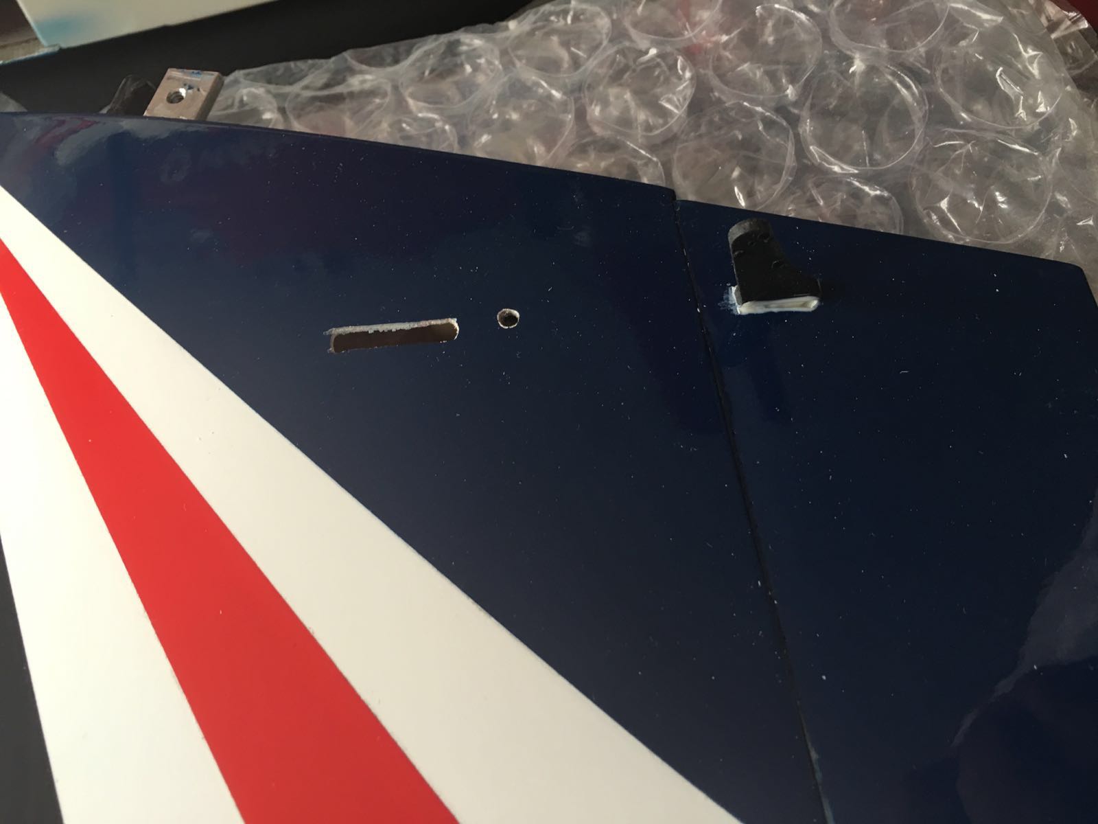

as you can see had to open up a bit the servo mounts quite a bit and then made new servo mounts plates - glued with hysol to the spar and stab joiner
now it also works nice as the angles are correct
the savox servo is amazing - srong and zero slop
