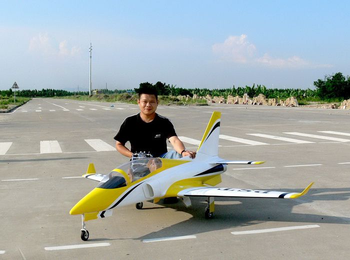

here is picture for the Dirk 's (Airpower) Viper Jet 2M, who just finished the maiden, dry weight 24lbs.,
good job...Dirk
Best regards
Anton

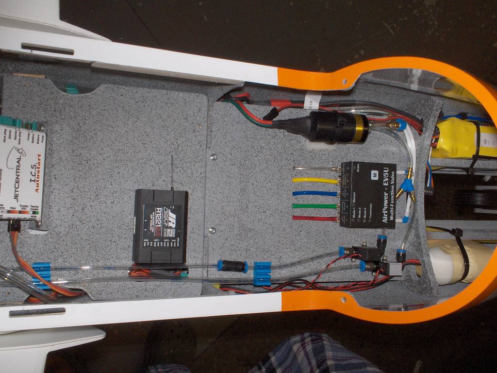

Received the Viper but seem to be missing a few parts. Did anyone receive the rearward equipment tray? I have the front portion.

If it's the same as the big viper, you only get the front tray. I binned mine and made some up myself

Default RE: Viper Jet 2M Pointers/ tips.
Jjet, There is no rear tray that comes with the kit. If you want one you will need to make it up your self. Here is the one I made up. As you can see there is not much on it. If you are going to use the cockpits you will need to keep every thing to the sides. Since we mounted the cockpit in the front a little different than what the instructions call for we had to cut some of the bottom of the front one for clearance for the receiver. There is not a lot of room under the cockpits.

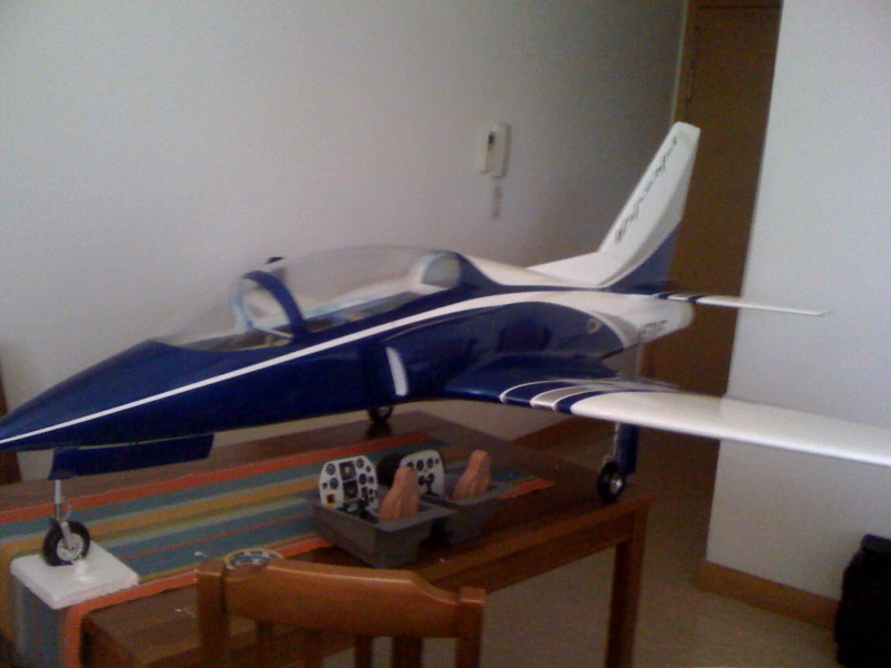

Last week recived mine, I impresive whith the quality of the kit[X(] .This picture was take it 1 hour after open the box
