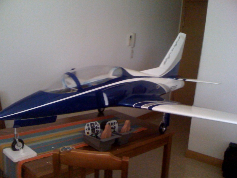

Look what the friendly postman dropped off today.....About 45min after delivery!
