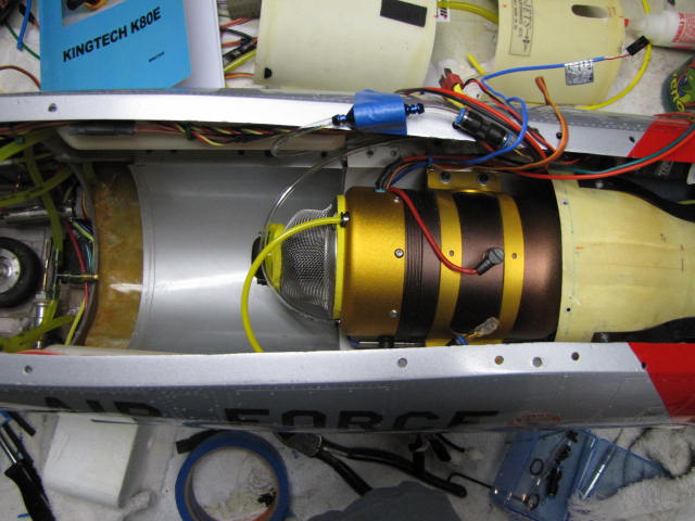

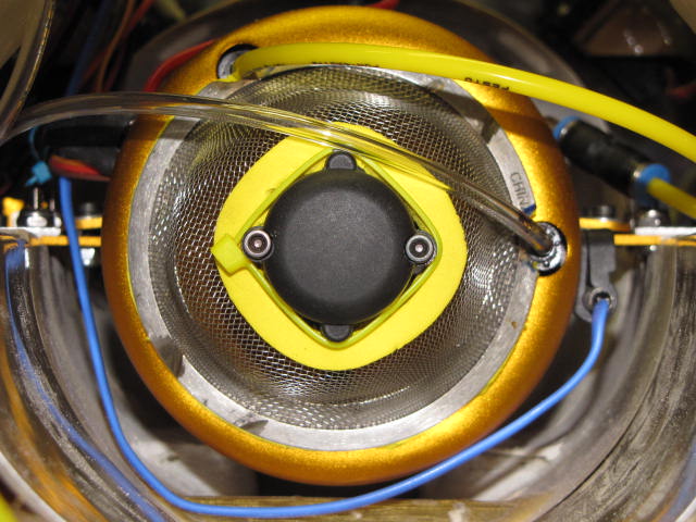

Well here is the install of the KingTech K-80 in the sabre. looks like next weekend will be the remaiden of the Sabre. Note the FOD screen. I made this out of a tea strainer and that foam rubber craft sheet the kids make letters and stuff from.
Joe Lewis
KingTech Rep

Here is the Sabre with the KingTech K-80 installed ready for the test flights. I hope to do it this weekend but there is a chance of thunderstorms. May have to wait until next weekend.
Dry weight is 22lbs.
Here she is.

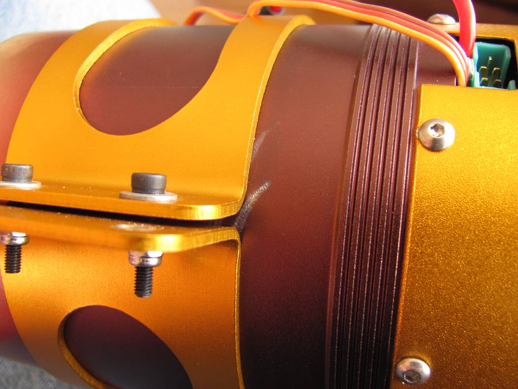

<span lang="EN-GB" style="font-family: "Times New Roman"; font-size: 12pt; mso-fareast-font-family: SimSun; mso-ansi-language: EN-GB; mso-fareast-language: ZH-CN; mso-bidi-language: AR-SA">Saturday my Kingtech ended its short life. After 6 test run fore a total of app 8-10 minutes running it was time to try the turbin in my Rafale. Fuel system had bean flushed several time and everything was ready for the big day. Turbine spool up fine to idle but seams to hesitate fore a half second on its way to full throttle. Back to idle after about 10secund at 145000 rpm. Next I gave full throttle but at 70-80000rpm it was over. Suddenly stop and a terrible sound. I use pressurised air to cool down turbine. Front compressor damage and everything is total stuck. Can&rsquo;t turn anything. During 3 test run in test jig I notice high speed vibration at app 70-80000rpm so this turbine has to be out of balance from factory. I haven&rsquo;t done any modification or loosen any bolts other than turn outlet cone so temp sensor fit my mounting. What now? Return turbine to factory?</span>

I amnot a professional by any stretch of the imagination, but Its fairly obvious you have had a bearing failure. Whether this was caused by a faulty bearing, or imbalance I cannot say as I have never seen this in person, However i am sure Barry can help you. Kingtech is beginning to gain respect in many peoples eyes because of a quality product and superb customer service. What was your oil ratio if I may ask?

Thanks JMalone,
Rossi, could you please send this engine back to Taiwan factory for inspection and repair, also what is the serial number of your engine? and the oil and ratio of your fuel mix? nice close-up photography by the way.
Barry

Barry. Thanks for quick respons. I wil send turbine back to factory. Serial number is 0911176. I use kero from Statoil in Norway mix with 5% Statoil Aquaway 2-stroke oil for outboard engines. (approvals: NMMA TC-W3tm)
Thanks for the info Rossi, your fuel mixture should be just fine, Chuang in Taiwan and I are eager to look into this #176 and a report will follow, thank you!
