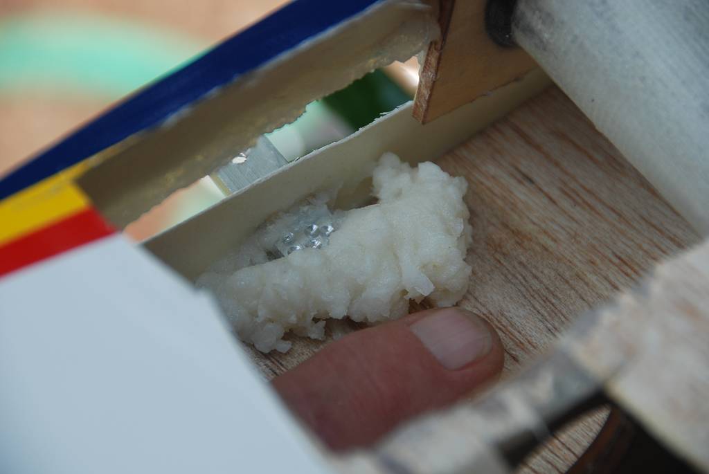

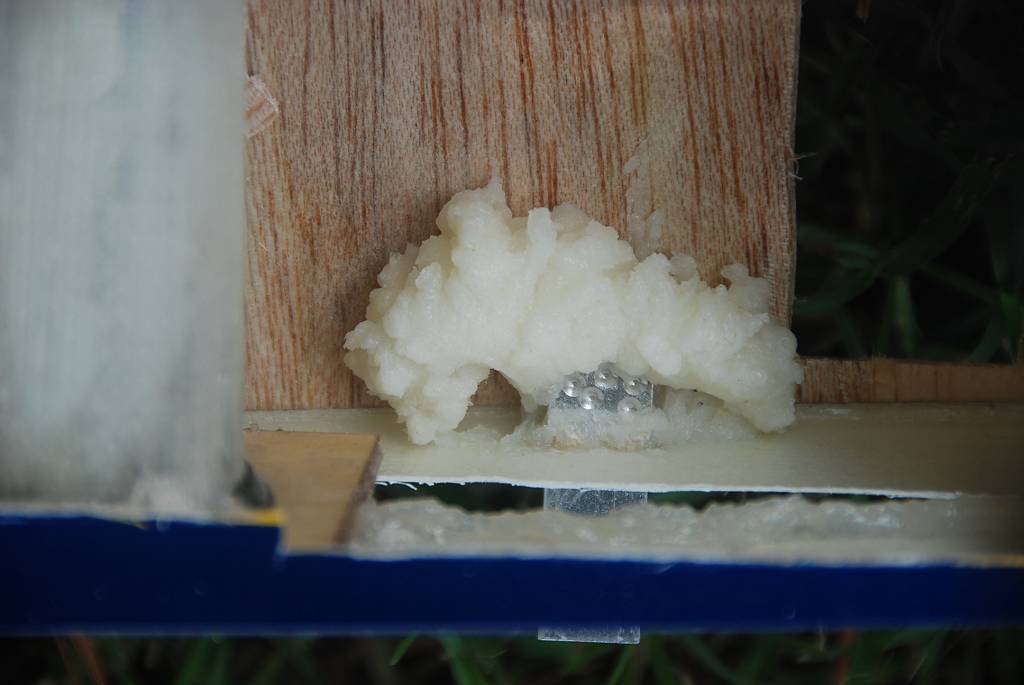

All good questions Albert!
You know, what's odd is that were your tab pulled out there is no wing material that came with it. The glue stayed secure to the metal but not to the wood in the wing.
That glue joint failed big time!
At this point I am afraid to fly my Dragon but I can't afford to replace it right now.

I'm trying to figure out how to check/beef up the aluminum tabs. I never thought about it but Albert is right. The tabs are only about 3/4 if of an inch long in the wing. That's just crazy!

next question. Is that Hot-melt glue holding the tab in?
I was standing next to my friend who was flying his Large SM viper. He had a total of 4 flights on it. On a normal pass the wing pulled out and the plane crashed and burned. New JC 160, new JR servos, everything new. Nothing left but the wing that pulled away from the fuse.
We picked up the wing and guess what? The little metal tab that plugs into the fuse was missing. The tab had seperated from the wing as in your pictures. $!2,000 dollars down the tube. I took a picture of the wing and sent it to jeff who forwarded it to Anton. They are sending him a new kit, but refused to pay for his new 4000 dollar engine loss and other items when it was clearly their fault.

Having looked at how your wing mounting tab was secured, I thought I'd examine the wing of my crashed Dragon. The attached pictures are the results. I wonder if this was one of the ones they "checked" after being informed there was a issue.
I really see no way of fixing this correctly on wings that are built and painted. The attachment method of the mounting tab to the wing skin is less than adequate in my opinion. There is a gap between the aluminum tab and "balsa" wing skin of about 1/4"............as you can see in the pic, they just "kind of" filled the area with some adhesive foreign to me. To be honest, looks like something my sister would do.

The picture above, is a picture of crap. It needs to be added to Wikepedia. All that white glue is supposed to hold a wing from detaching in flight? Scary stuff! What I don't understand is how somebody like BVM would deal this POS!!
What about the people who gave up waiting on parts, or who had to wait for months? What kind of %hit is this?
From seing SM and FEJ I see a lot in common. The only difference I can tell is that SM has better air systems. It seems like they use that white hot glue in lieu of propper structural reinforcement.
Again, like somebody said earlier, it is just a matter of making small changes to teh design that would go a long way, and take care of those who lost a model and/or equipment to make it right.

Here is one of the pictures of my friends Viper wing showing the missing metal tab which holds the wing on. Quite evident the tab pulled out of the wing. This after 4 flights.

The tabs were a concern since day one but all I can do is pull on them before flying to make sure they were not loose. I thought they were several inces long and perhaps went through a few ribs. Had I known they were that short and glued with gum I would have never flown it.

We talked about making sure it doesn't happen to yours and about coming up with a solution. Well I'll open up one of the wings so we can better understand what's in there and perhaps come up with a game plan. Hey I don't cut holes into a wing for just anybody buddy. lol
