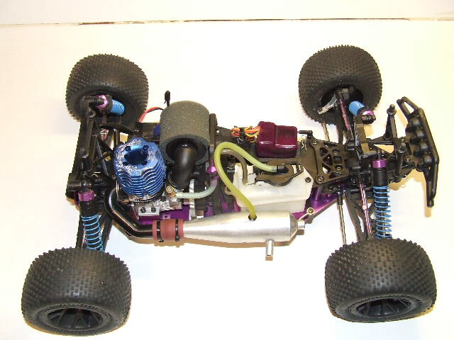

http://www2.towerhobbies.com/cgi-bin...?&I=LXFAZ9&P=0
Had to do a little modifying to make it work with a pull starter TZ. Before I geared it up I had problems keeping the front wheels on the ground. Now you hit the throttle count to 1 and the tires are ballooning.
Old 10-17-2006 | 02:20 AM
  #8090
Joined: Oct 2006
Posts: 16
From: , OR
Default RE: Official HPI MT2 Thread
getting a MT2 soon any suggestions to make it work with a .18 TZ when you say u geared up what did you go to?
I want to gwt it hooked up at the track any suggestions on durability improvments or essential parts upgrades?

ORIGINAL: 46u
Thanks 46u,what kind of mod didyou have to do?What tuned pipe would you use?
I had to grind the part of the lip of the pipe where it went on the back of the engine as well as there is a washer with two holes it for the retaining spring and I had to cut about ΒΌ of it off to miss the pull starter. Nothing hard. If I would have run a none pull starter I would not had to cut anything.
If I had it to do all over again I would get a none pull start engine and get a starter box. The pull starter on this engine is very small being it is a rear exhaust. I have had more problems with the pull starter in half a gallon then I have in all my pull starters in the past 6 years.
