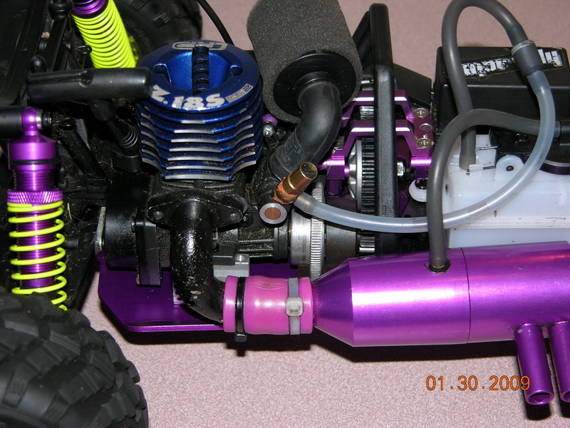

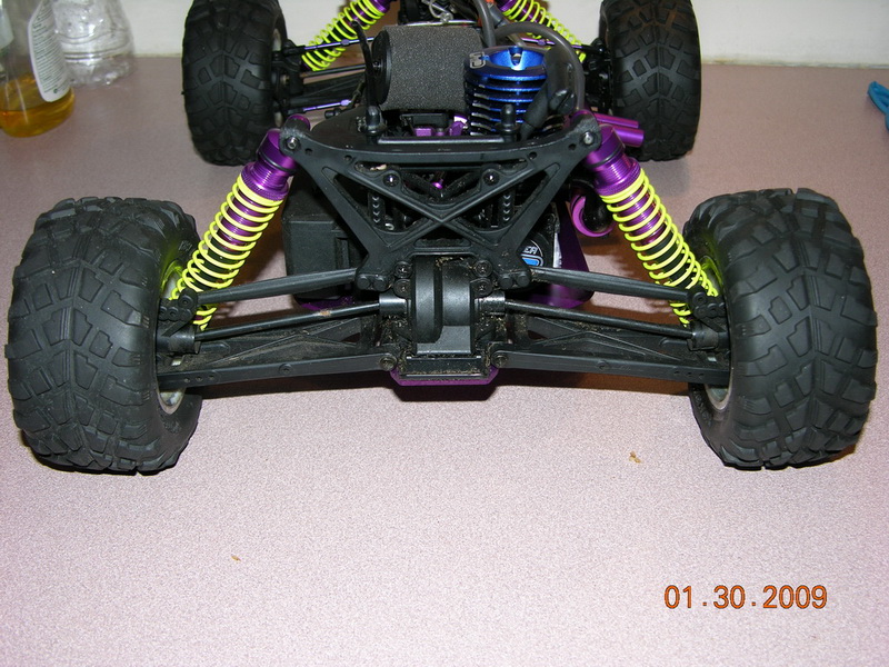

OK I finished my other MT2. I put the LRP Z.18s with 13/52 gearing with a 2 shoe clutch with .9 springs. It has a CVEC pipe on it and new GPM shocks. Now if it will just warm up a little I can get it out to test it.

New car is looking good Keith.

Cool glad you got the engine working.
Thats actually the older of the two trucks. I just started upgrading it with some spare parts and a few new ones I ordered.

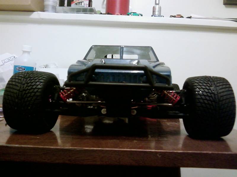

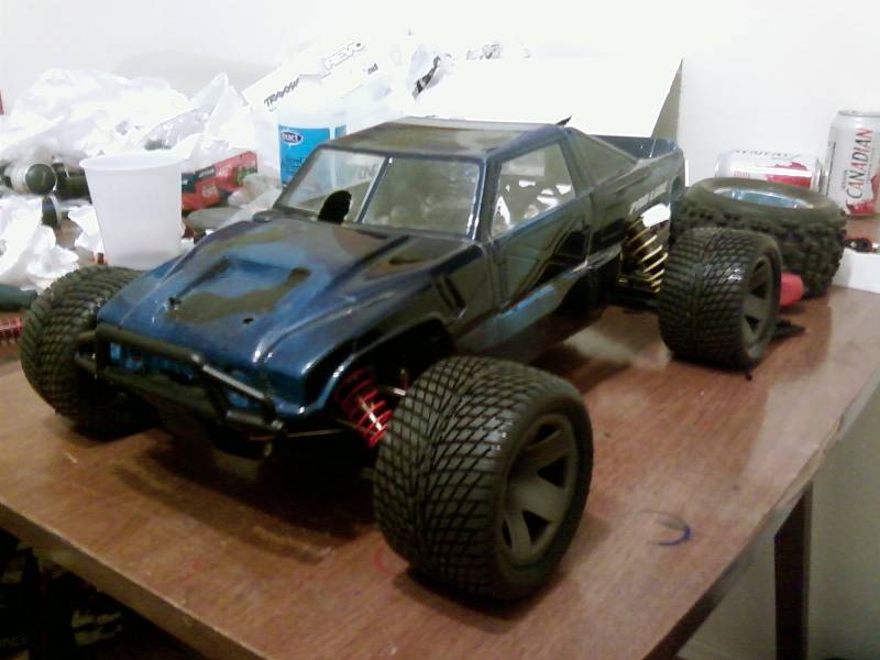

Here are the latest pics of my mt2 and some airbrushing that I did a while ago and what the heck one of my revo too
Dont mind the lightning I know its not the best but it was the first time I tried to do it. And the sled is my bosses sled that he got me and my friend to paint up.

eminent what tires do you have on your truck?
It warmed up here today finally so I was able to get one truck out for some driving. It was starting to warm up and run nicely when I lost a screw out of one of the knuckles. I had a screw to replace it but its stripped out so Im going to have to replace the knuckle instead. Was fun while it lasted though.
Those are proline road rage 2 on 2.2 rims they feel like there going to be great they stick way better then all the other tires that I have and are way lower then the dirt hawgs and geolanders. Right now I only have just over 1/2" of clearance I put the sway bar kit on it and it is killer riged. I used some fuel tubing under the shock pistons to lower it and cut my springs down to get rid of the extra pre load. The only thing left to do is the 2 speed then its ready to go.

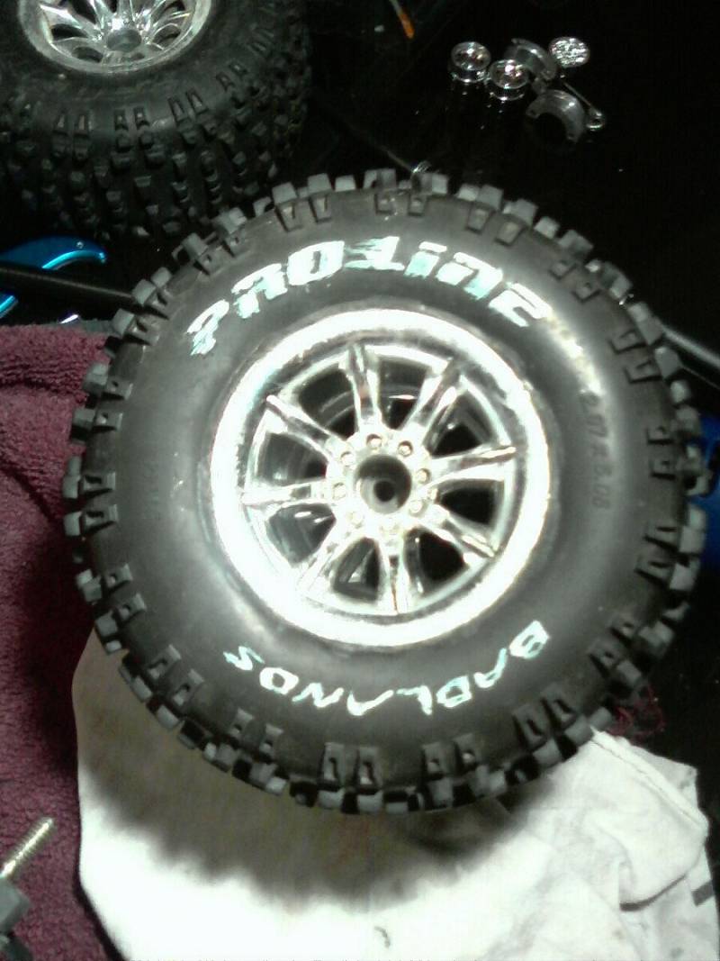

What do you guys think of the painted letters on that tire in my last post? Those are the tires for my friends tsunami I think it looks sharp. I might waste a few hours and do that to my tires.

It looks good. I dont know how longs its going to last when its running, but it looks good..
