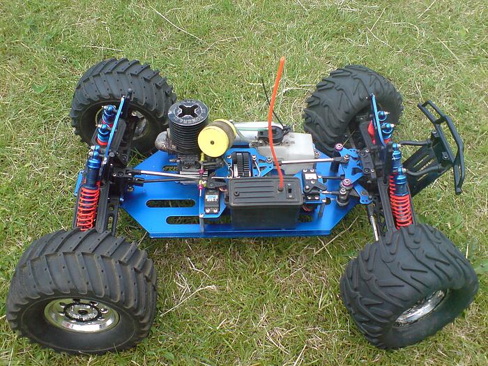

Hey guys i have the XTM Mammoth, check it out on my profile on my modles
ID:	1283959   Click image for larger version

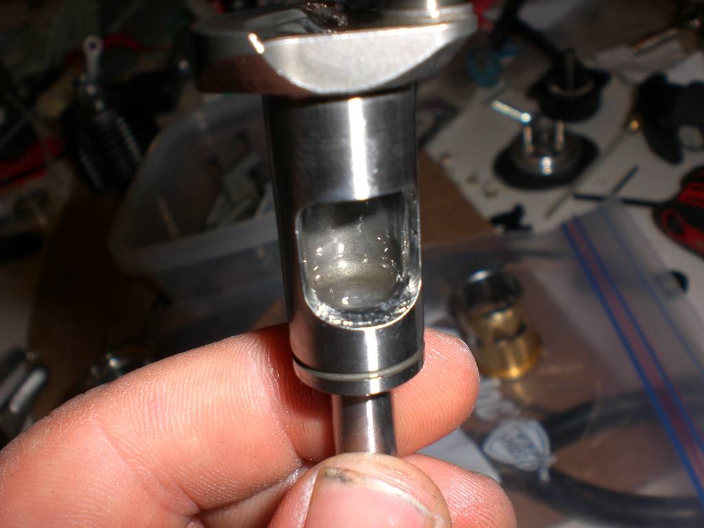

Well guys... I couldnt wait I took apart the 5.9 and ported and poliched it as well at a pile of crank work ill post some pics right away just hope there not at big as the las ones I posted lol

It took me about 2 hours total thats with taking the engine apart porting it doing some block work smoothing things out, matching the intake valve in the crank under the carb exactly the same shape as the opening in the block under the carb, rounding out the intake valve in the crank, rounded the shark tooth shaped "boost" things on the crank into the crank instead of it being a sharp edge and polished everything a bit and I added a small amount more taper to the bottom of the sleeve then I cleaned everything lubed it up and put it all back together.

Here we go I dont know whats up with my computer lately but I have to try to upload them about 4 times before they work..... and just so you know my revo is the extende chassis with the extended rear a arms on the longest setting and the xl is still that much longer lol
