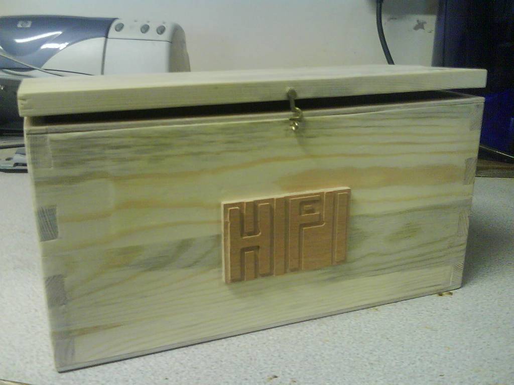

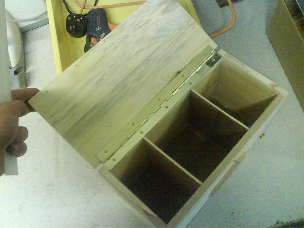

Nothing special but i thought id show you guys what i have made at school for 2 GCSE's in resistance materials, a HPI mt2 Box
lol
lol
Joined: Aug 2007
Posts: 2,149
From: .....,
NY
Nice hob. Im actually planning out a tool box of my own. I cant seem to find anything that has the room to carry what I want to, so I figure Ill just make it myself. Ill post some pictures when I get it done.

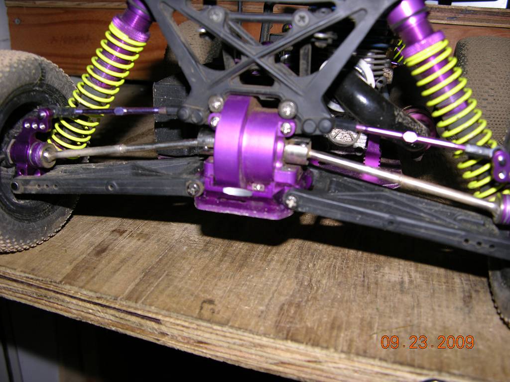

In the mean time. I installed the rear GPM hubs and the lower mount. To fix the problem some guys were having with the tie rods separating on the front I moved the ball mount closer to the wheel. The stock position had it all the way towards the center. By moving it outwards it allows a few more threads to hold the tie rod end in place without breaking it.
