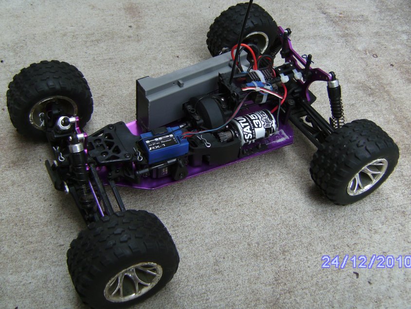

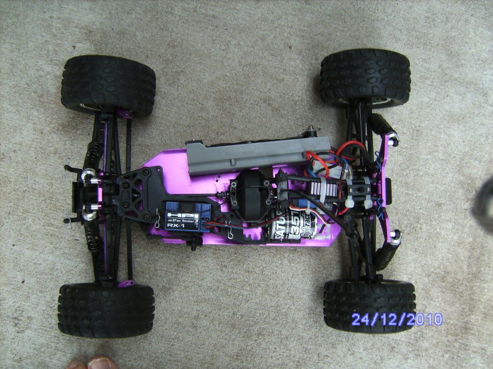

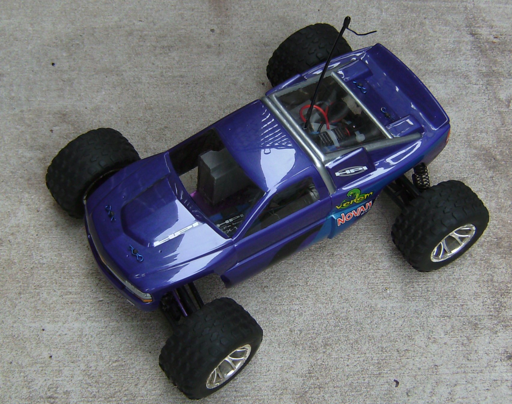

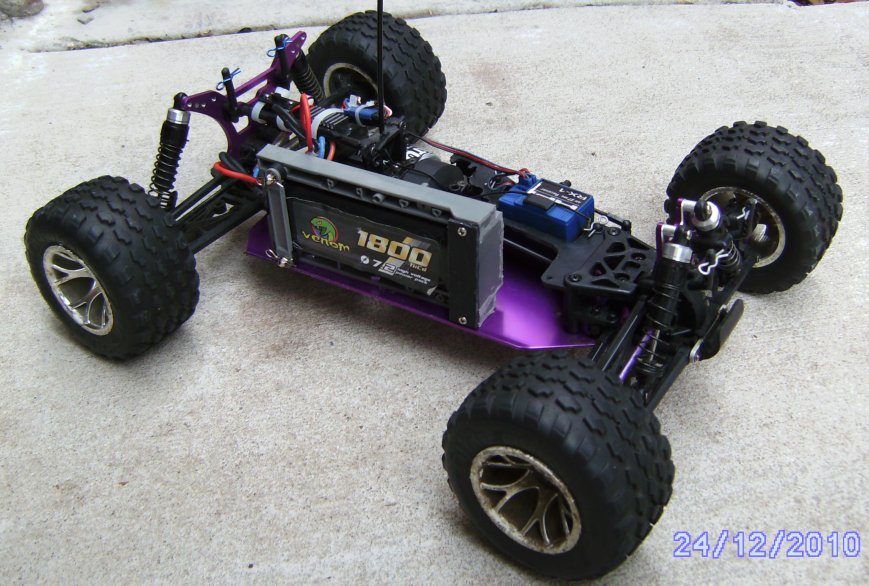

WELL I finally did my one project of converting my 2nd RS4 nitro MT1 to electric that I mentioned a few pages back (I still have my MT2 nitro convert as nitro and its staying that way )
In all truth the whole conversion took me at most 2 hours, and most of that time was spent trying to figure out what I could use to stop rear chassis flex, and mount the ESC.
Battery tray is a cut down Traxxas Stampede Chassis (found it for $10 shipped )
motor for now a 35t Saturn (out of my Brama) gonna pop in a 27 turn once it arrives. Ran it for 20 minutes today at full throttle, and it the motor didn't even get warm to the touch.
ESC is a HPI (again out of my Brama)
Motor mount is some cheap airplane mount I dremeled the hole bigger.
Pinion gear is a 11 tooth MOD 1 by Novak (had to also 3/16 X .028 stainless steel tube to make a adapter to fit the motor shaft)
I used a spare front shock mount to mount the antenna and to make a place 2 run 2 cut down parts trees to the rear shock tower, which I zip tied the ESC and power switch to.
there is a stronger brace underneath the ESC that I had leftover from the MT2 wing mount mod I did a few months back.
In all truth I was actually shocked at how easy it all went together. And if the 27t motor doesn't get warm I'll probably drop in the 20t motor I have in my Brama and see how it does with that.

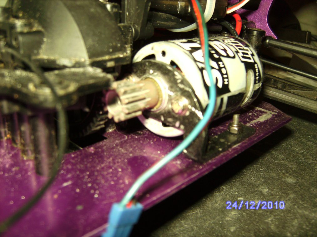

Nice work syco. Any chance of getting more pictures of how you mounted the motor? Im thinking about converting one of my MT2's to electric but the motor mount has been slowing me down.
Old 10-27-2009 | 04:12 PM
  #20022
SyCo_VeNoM's Avatar
Joined: Jul 2007
Posts: 12,989
Received 44 Likes on 41 Posts
From: North West Indiana
Default RE: Official HPI MT2 Thread
I had the same issue looking for a mount I got fed up looking and just ordered a "RC Plane Airplane Metal CNC L Motor Engine Mount" from gemstraveller on ebay. I figured at $4.80ish I wouldn't have been very mad if I couldn't get it to work unlike most of the other mounts I've seen for $10-20 and had no idea how I would go about mounting it
the holes to mount it to the chassis were a little small for the screws I used so I enlarged them with my one drill bit
And for the motor I had to royally enlarge the hole on it. Grinding the hole out to fit the shaft through actually was the part that took me the longest. I probably spent a hour on the mount alone everything else was around 30-40 mins tops.
Too bad the pic of the bottom is too blurry or you could have seen the horrendous job I did measuring the holes locations and how I was off by 2-3mm on each one.
Here are two of the pics I took of the mount (rest were too blurry) before the cameras battery died.
