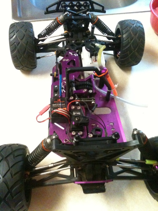

Its a Hpi MT 1 oringinal model, easy tells are the body posts, front shock tower, front shock location, battery/reciever tray, 15fe motor. I saw it listed on Ebay as a MT2 lol but its a MT1.

ORIGINAL: KeithjV
It looks like it could be an original MT. Would need more pictures though to be sure. Also looks like it has some upgrades on it already. Those look like aluminum shocks. Most of the parts line up the same so you shoule be ok.
Has anyone tried the blue grove electric conversion for the MT2?
There is a member that posts in the general forum that has the blue groove elec conversion from what I get hes a bit disappointed in how the battery mounts.
And chevymanmike1010
parts that are a direct swap for the MT1 off the MT2
Arms, bulkheads, gear cases, center gear holder, knuckles, C-hubs, rear wheel hubs, steering setup, shocks(MT2's are longer and mount on the C-hubs), dogbones, and bearings
Parts that require a few things to be swapped, but no real mods made
Front bumper, body mounts, front, and rear shock towers. All those most be replaced at the same time.
MT2 Chassis plate requires the MT2 radio tray. Unless you want to drill alot of holes, to use the MT2 radio tray on a MT1 3-4 holes have to be drilled (I did it once)
MT2 driveshafts will NOT fit (found that out the hard way). The MT2 uses different a larger sized cups for the center gears cups, and the cups that drive the diffs. So to use its drive shafts you need to change the diffs cups, and the cups on the center gear

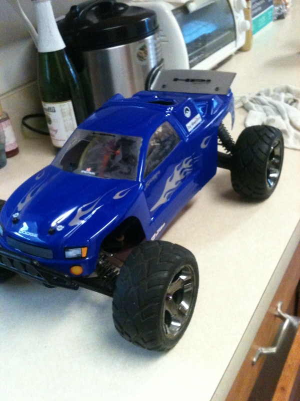

I have given up out the 17mm adapters, purchased traxxas anaconda wheels and tires which look pretty good.

Also installed Ofna ultra lx shocks on the MT2 alot better then the stock ones.

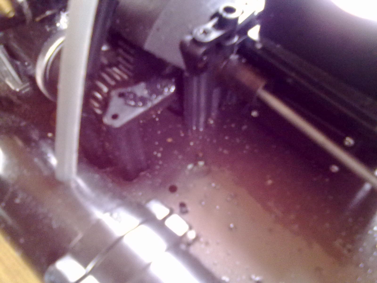

Hello everyone. I just got the mt2g3.0 for christmas. I've broken in the engine as described in the manual. I think I have a problem though. It has no problem startin, but when I'm done running it, and go to clean it, there is nitro fuel everywhere. Under the tank, on the side of the exhaust. I'm new to this and really need some help. I've run about 8or 9 tanks already and I don't want to damage anything. Thanks in advance! PACMAN

This is normal on a nitro car.  You'll usually always spill a little but whe you are filling it, and that fuel seeps all over the placte.  There is a lot of oil in nitro fuel and it won't evaporate like the fuel itself does.  You will also get a lot of oil coming from the exhaust which ends up all over the car. Nitros are dirty, but a whole lot cooler than toy store electrics!

Unless you are spilling a lot of fuel when you are filling up there shouldnt be raw fuel all over. You will get some oil residue from the exhaust pipe but that will be concentrated on the pipe side of the truck. If you have a lot of wet fuel on the chassis I would check all the fuel lines to make sure they are on all the way and there are no holes. Also check the tank to make sure there are no cracks and that the lid is closing tightly so the fuel isnt spilling out the top while its bouncing around

I hand that problem once. Turn out to be the front engine bearings, had to heat the case in the oven then the inner bearing justfell out but I had to tap out the outer bearing with a wood dowl. after It was all back together no more fuel all over the chassis, just a little in the normal spots from spilling and exhaust.

How is your temps and how is engine running, sometimes running overly rich fuel will spit out of the carb. But my guess is fuel tank lid wasnt closed properly or you may have spilled fuel while refilling. And welcome to MT2 owners club
