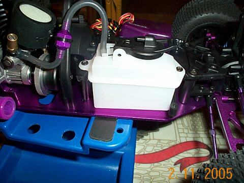

HPI will tell you the 100cc tank will not fit in the MT1. I have it in my MT 1 3/4 but you do have to do some modifications. You have to cut the upper deck and drill and counter sink one hole.
