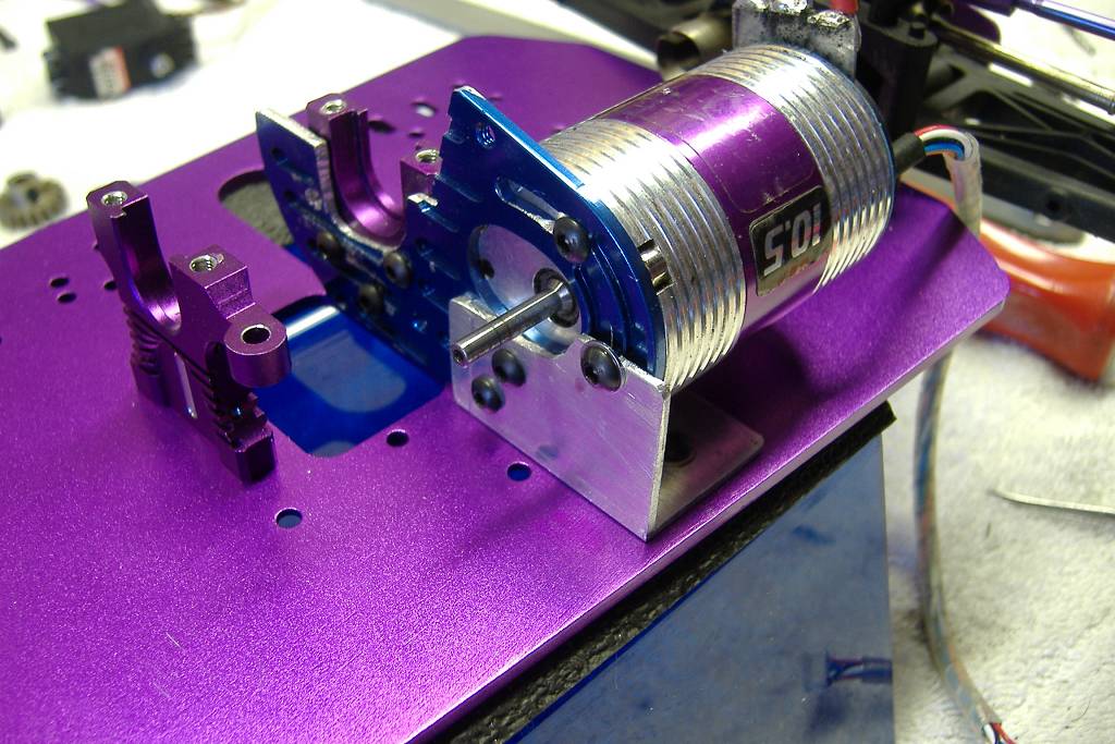

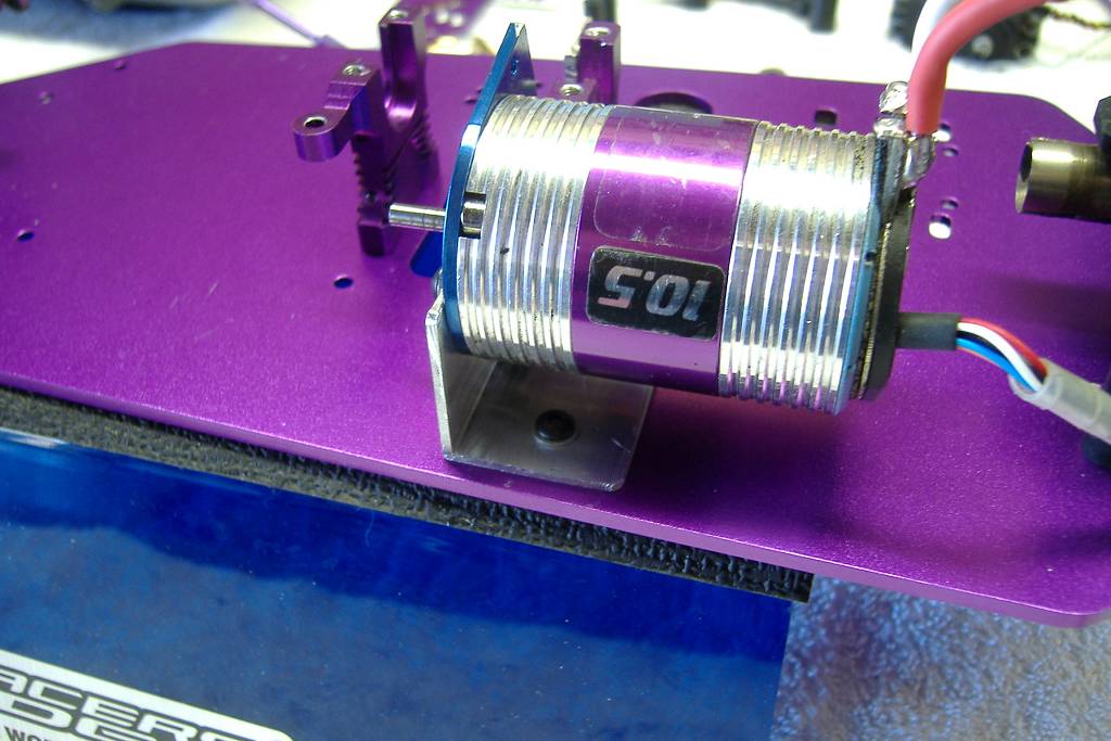

John that mount looks nice and neat but Im betting its going to flex under the torque. You need something heavier or thats going to mount to the chassis as well as the center diff.

Yeah the more I looked at it the less I liked it so I added a brace.

That looks much better. Time to get it running....

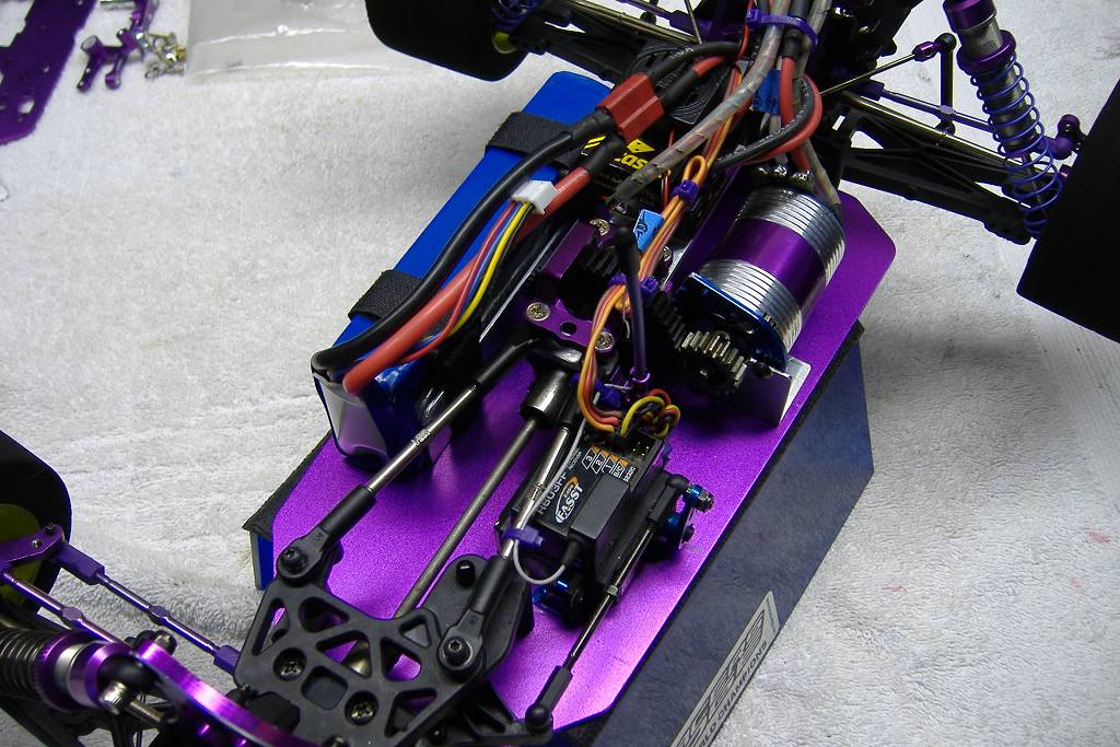

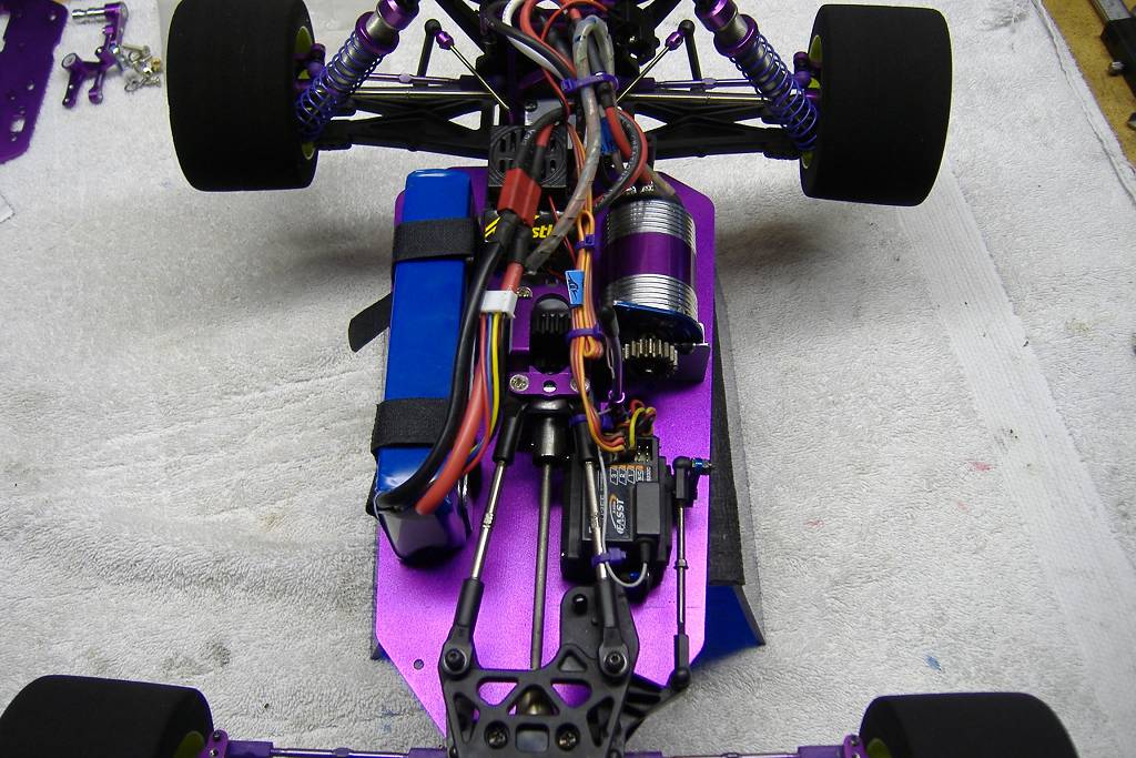

I got her all finished up and running today. I'm pretty happy with it, I can't wait to solder a Deans onto that 6S and see what she can do as it's pretty strong with a 3S. I've got it geared pretty high so I'll really need to watch my temps but I'm only planning on doing a pass at a time wuth the 6S. It's super stiff with the braces I made and everything from a 2S to the 6S fits in nice and snug.

I would consider adding braces from the front shock tower to the rear shock tower. I had to do that on my EJato, other wise would fold in half. Or you can find something to use as an upper deck.

It looks good John. See if you can post some video of the runs

looks nice
way neater than when I converted some a year or so ago.
Man, thats one good looking MT2. Kind of makes me want to get one again! What kind of speeds are you geting out of it?

I'm a little bummed. I strapped in my 6S battery yesterday and did a couple runs in front of my house. After the first run I felt the motor and ESC and they were barely warm, so I went for it. It felt like it was kind of cogging or stuttering when I had it wide open on the first pass, and it did the same thing on the next pass so I brought it in. As I was letting it roll towards me the ESC (a new MMP) started shooting smoke out. I went to pull the battery plug and the wires came right out of the ESC, it melted the solder on the wires.
I'm still new to the lipo thing and I probably did something dumb here, but the ESC is rated for a 6S so it should have lasted for a couple runs?
The lipo is a Turnigy 4000mah 6S 40-50C, and the motor is a Novak 10.5 turn brushless.

how many KV is the motor(or was)
6S is for 1800kv motors if the novak was around 4000kv(like a few 10.5 turn motors) I'm shocked the magnets didn't fly off the rotor. Higher the KV you need to use lower cell counts in BL. Like a 4000kv motor should not be used on anything higher than 2S, a 3500 could do 3S, etc

Definitely too high of a voltage.  I ran a 10.5T ballistic motor on 4s for about two packs once and that was it.  I can't imaging running that high of a kv motor  on 6s.
