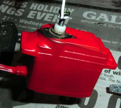

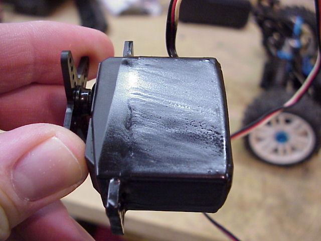

u tired of balloons for servos to water proof them
no more u need to do this cues of plastic dip just go to your local hardware shop and buy this stuff and it water proofed i thin it comes off with a knife and peels off here are some pic i haven't done them but next winter o ya
just dont do it to your receiver just servos

Ahh ok.
Plastic dip is the single most greatest idea I have used for a long time. I havent re-applied any yet because
1)My servos are crap
2)they seem to be doing well without it
3)Too lazy to pop them out of my trucks...

lol lazy well i got it from SMF ii think its a good idea its spring and it hasn't been raining i just took bottom plate off and cut a square and put it between the plate and servo this plate is at bottom it just a water shield im going to keep it on for summer to keep dirt out

I take some electrical tape and wrap it around the cracks first. Then I plastic dip them... [8D]
