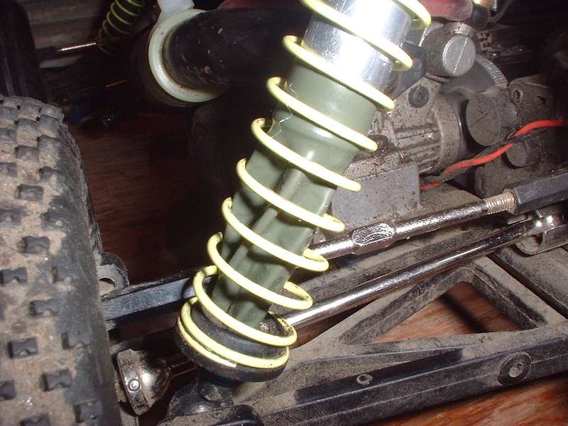

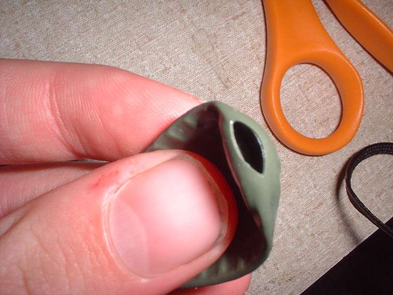

ok this is a good one shock boots take a water balloon cut a small hole on the bottom and cut the top rim off then take spring off slip it over the shock body and bottom part the cut a small needle size hole on side so air can move put back together and you have a good shock boot i will get pic

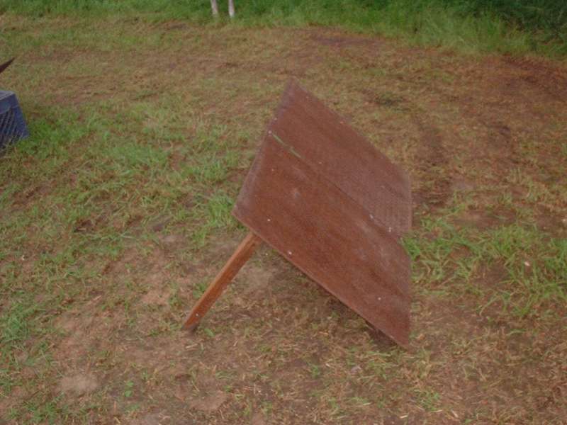

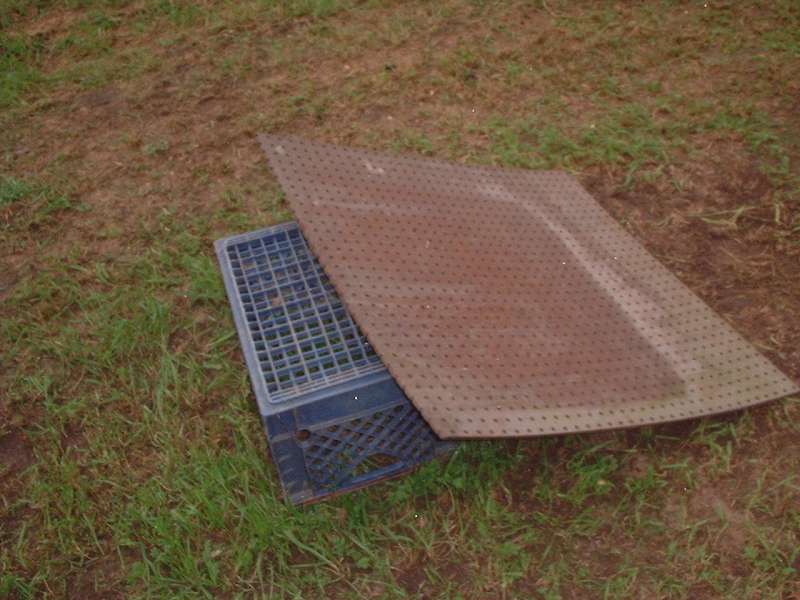

ok people here are the ramps ive made there is an easy way and a hard way
the pic with red i put a block of wood there so the screws didnt go up threw the ramp if you look you will under stand the one with the handle is the harder on and the one with the crate is the ezy way lol the one wit the red has a door hing so it is adjustable and you can go both ways its up to all of ya for what ramps you like
you dont need to put that block there if you want to spend 10 min wit dremal and take the tops off it just helped aand wit out block it folds up flat im might do that when i have some time well enjoy
PM me for more help with the ramps like instructions

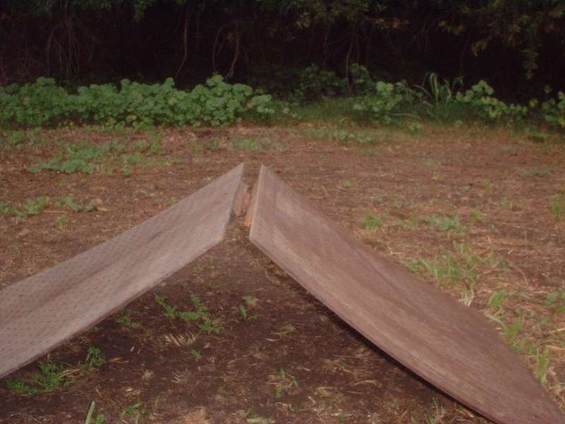

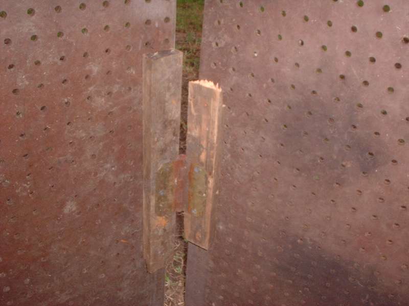

Old 03-12-2005 | 07:18 PM
  #43
brownstone101's Avatar
Joined: Feb 2005
Posts: 1,909
From: Somewere, OR
Default RE: OFFICAL TIPS AND TRICKS THREAD
here is the hard one to make[:@] enjoy
