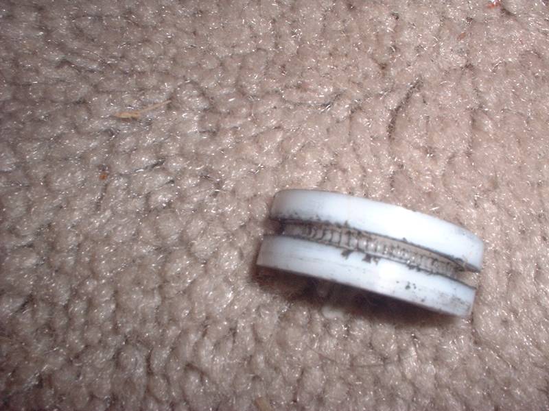

well i was wondering before i do this rebuild what should i watch out for when i replace my clutch spring like is it hard or just hold the 2 pads in the spring and pop them on i just want to know before i do it when i get my shipment?

put the shoes together, join the spring & roll it on. sometimes it is easier to leave the shoes on the fly wheel. if the old spring has a visible wear mark from rubbing on the CB, your shoes are worn as well. you will either need to replace them or cut the groove that the spring sits in deeper. you may also need to clip a bit off the spring to shorten it if this is the case. the white shoes tend to wear out pretty quick.

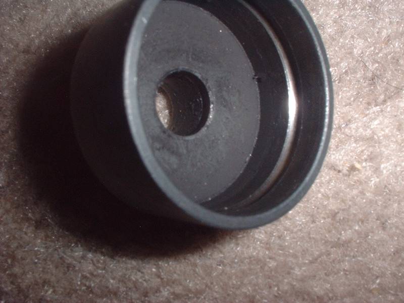

Old 07-31-2005 | 08:55 PM
  #57
brownstone101's Avatar
Joined: Feb 2005
Posts: 1,909
From: Somewere, OR
Default RE: Official Nitro Evader ST Thread v2.0
ya i think i need cut a grove maby my cb has a DEEP track in it i hope its fine
o will get a pic
