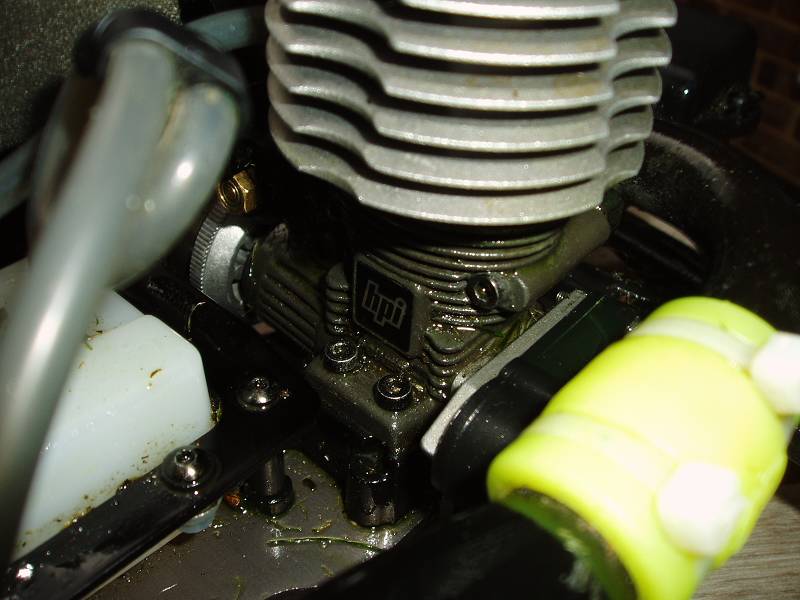

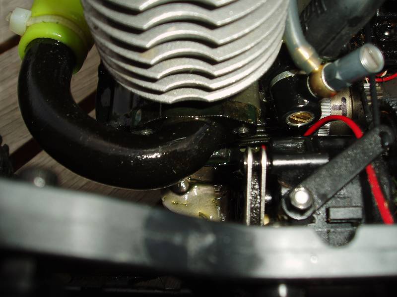

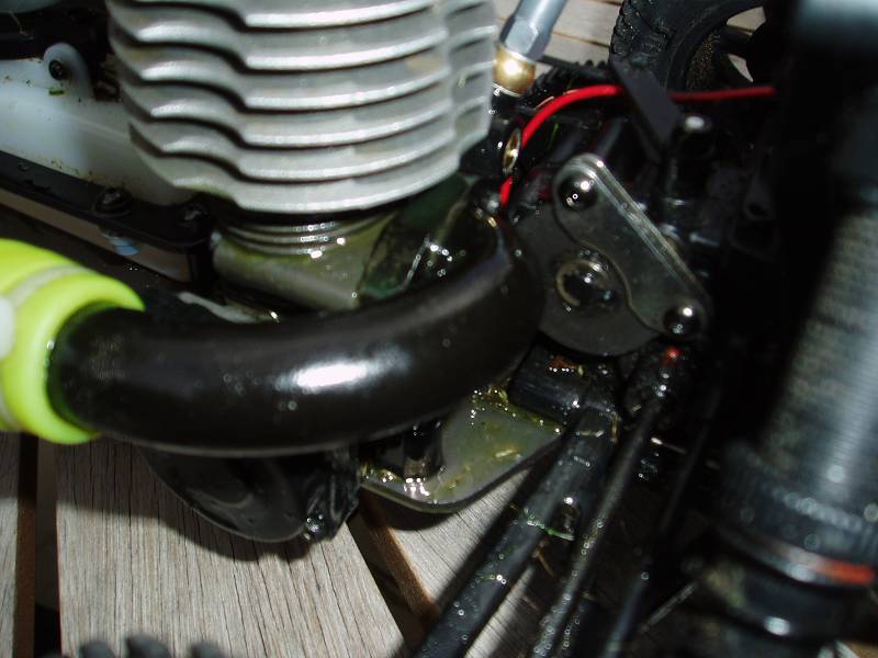

OK, Im back to the original 3 shims now and I took alot of time to ensure i tightened the heatsink evenly and in the right order.
Just ran a whole tank of fuel through it (it sounded really rough), was running rich cos there was smoke all of the time but its wasnt so rich it was spitting fuel out the exhaust.
There is no fuel around the glowplug, so i dont think the leak is there.
At the end of the run I checked the temp - It was 85F (20C), the heatsink was barely warm to the touch.
Im running 20% fuel. The temp gun is a Microtemp MT002 (which the guy in the shop recommended).
I must admit im scared to run it again, as I dont want to damage it like neilt6 suggested, I didnt go anywhere near WOT running today.
Couple of pics showing how bad the leak is....
Please help.....[sm=confused_smile.gif][sm=confused.gif][sm=cry_smile.gif][sm=crying.gif][sm=frown.gif][sm=48_48.gif][sm=angry.gif]

Join Date: Feb 2007
Location: cape coral,
FL
Posts: 765
RE: Engine fuel leak
could it be your exhaust leaking or loose? when i first got my rc10gt i didnt put loctite on the header screws and it threw oil like that everywhere after running a few tanks thru it. and dang if ure engine is only 86 degrees wow!!!! thats way cold. you def need to lean it out as said earlier.

tune your car back to factory setting, use a hotter plug like OS #8, lean out slowly and read the engine temp again, your temp gauge might be faulty so do the water drop test on the heatsink and see how many seconds it takes to evaporate.
as for leaking, can you do a compression test? you can also go to auto part store to get some high temperature silicon (gasket maker) and put a very thin layer on the shim, then tighten up all screws evenly. Wait for couple hours then fire her up and see what happen.

If I am not mistaken HPI engines take standard long plugs and not the short OS plug but double check. I know My HPI 4.6 does. I would think if your head were leaking that bad you would be able to hear the compression leaking or see bubbles while it was running. Yes check the exhaust for leakage. If you are running that cold you have to be running so rich that even a small leak will look bigger then it is. Clean it all off and run it for a short time and see if you can tell where it is leaking.
Good Luck!
One other thing you might want to take your pull starter off and makes sure screws in the backing plate are tight!
Good Luck!

Viper458, Checked all the screws on the engine, they are all as tight as I could make them.
Ben805, How long should the water drop take to evaporate? How do i do a compression test?
46U, I cant see any bubbles or leakage when running, it seems to run out after I have stopped.
I will try to tune it tonight and let you all know how I get on.
Thanks for the help!!

Ok, here's what to do. First, take your hi-speed needle out and thouroughly examine it for damage then clean it. I just spent 3 weeks trying to diagnose my engine running perpetually 330F before my LHS discovered my hi-speed needle had come off it's o-ring and was in fact not moving in or out when turned, leaving it with way too much air, but enough fuel to appear rich. Yours might be stuck really rich. After you've fixed that, reset your engine to slighty richer than the factory settings and start leaning it out 1/8 of a turn at a time while simultainiously checking your temperature until the temp gets up to around 220F - 230F after some runs, then go down to 1/16 or 1/32 of a turn at a time and perfect your tune while keeping your temperature under 280F. Also, if the water actually steams off you are running within the 230F - 240F range. If it just sits there forever you're below 220F, and if it fizzles off in under 1 & 1/2 seconds you're too hot. Judging by the pictures, your problem must be near the exhaust system since what you're seeing is caster oil that's already been through combustion. If it was a compression problem there would be fuel there too.
Hope that helps!

Sorted it!!
You were all right!! The needles were all set horribly fat, I have tuned it now and the temp is up where it should be, there is a fuel leak which I can now see is the exhaust gasket.
Neilt6 - One last question, how could you tell the oil was castor oil?
