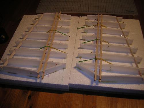

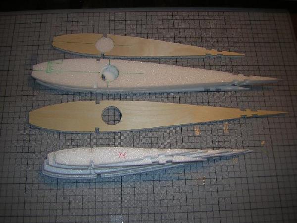

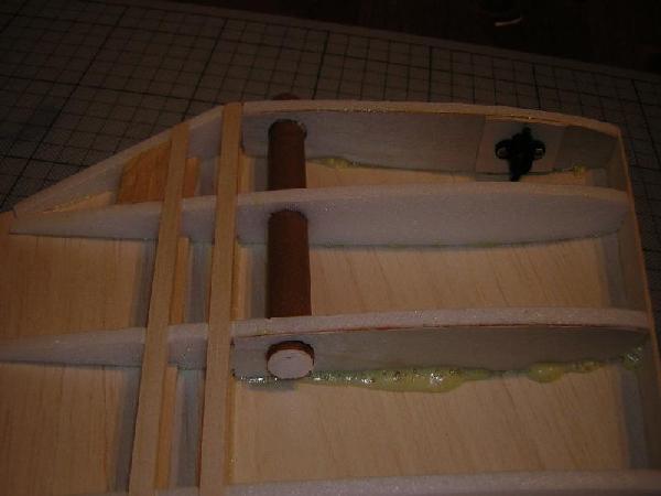

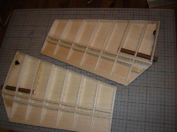

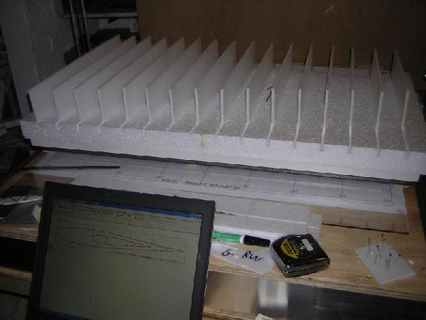

Hello Matt
Difficult for me to understand everything that is written!
Is what you mean? see photos of geoffroy plane named Graviton.
Claude

Originally Posted by papaone
Hello Matt
Claude
Hi Claude,
No that isn't the technique, BUT what you show in the photos will work. Many many years ago, Hal DeBolt described this same method in his "Solution" build plans. I built the Solution (a 60 sized pattern model) using Hal's wing crutch method (that your photos show) around 1977 or 1978.
