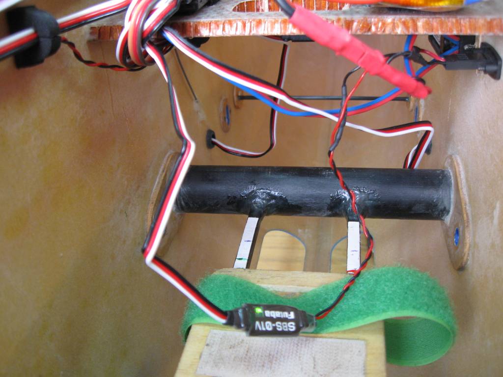

I managed to get a SBS-01V Voltage Sensor for my Futaba 18MZ.
It is not available in the market for some months.
I connected it to the receiver battery (New THUNDER POWER 910-2S) before the DigiSwitch.

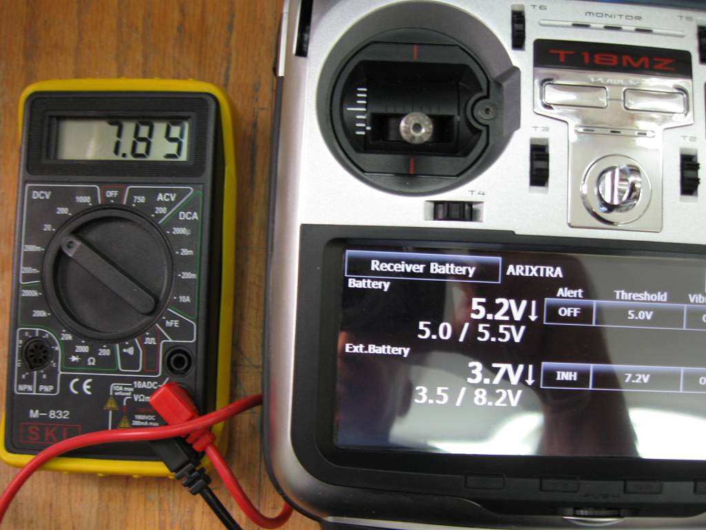

I have some strange reading in the radio telemetry:
Under load the receiver battery voltage droops to 4.0V and simultaneous it reads 8.1V on a voltmeter connected parallelly.
Is someone had the same experience with the SBS-01V Voltage Sensor?

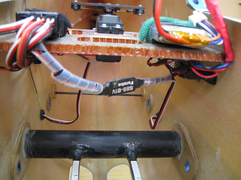

First off, the R7008SB RX sends receiver bus voltage without using the added sensor.
Second, if you want a second battery voltage (like motor, before regulator, etc) then all you need is the cable CA-RVIN-700.
The SBS-01V sensor allows you to monitor a third pack.
SO:
RX = servo bus voltage. If unregulated = RX battery voltage. If regulated = regulated voltage to the RX/servos.
EXT Battery = either voltage before a regulator, if none then you can get motor pack voltage
SBS-01V = Third pack. I would only use this if I was using a voltage regulator for the RX power and wanted to get the following:
1 - Regulated voltage to RX
2 - Unregulated RX pack voltage (before regulator)
3 - Motor pack voltage
If you are using unregulated RX power then you do not need to use the SBS-01V.
In your case I would need to know how you have things connected to diagnose your issue.

Here is how things are connected:
2 - Unregulated RX pack voltage (before regulator) - use the SBS-01V
3 - Motor pack voltage - use CA-RVIN-700

It might not make any difference but I wonder if the digiswitch regulates the ground wire and not the positive wire or floats the ground to some extent?
I'd double check the voltage drop across the digiswitch on the positive and negative wires and see if there is zero voltage drop across the negative wires.
It seems really odd that a meter is reading 8.1v but the sensor is reading 4.1v unless the sensor is comparing the voltage on the battery positive to something other than the battery negative (maybe the RX negative?)
If you can read 8.1V across the battery terminals, I'd like to see 8.1 volts between the rx negative and battery positive as well.
As I looked at the manual, I think you either have a cold weld or a bad sensor, did you installed the fuse? If there is no fuse, I think is a bad sensor as I am pretty sure you know how to solder well.

Yes I installed the fuse.
About a cold weld, I usually try to avoid a cold weld.
Without any load the sensor reads the battery voltage perfectly, in this case do you think it still can be a cold weld?

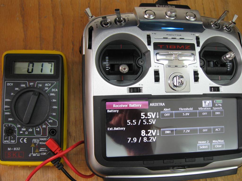

What voltage are you seeing on your transmitter under the RX voltage? This is the one that the servos see, not the one the SBS-01V is reading? Also, do you have the SBS-01V plugged into the the S.Bus2 port??
Also, how are your telemetry slots assigned? What sensor is on which slot?

What voltage are you seeing on your transmitter under the RX voltage? – 5.3V.
Do you have the SBS-01V plugged into the S.Bus2 port??- Yes.
How are your telemetry slots assigned? – Slot no. 6.
What sensor is on which slot? – Voltage

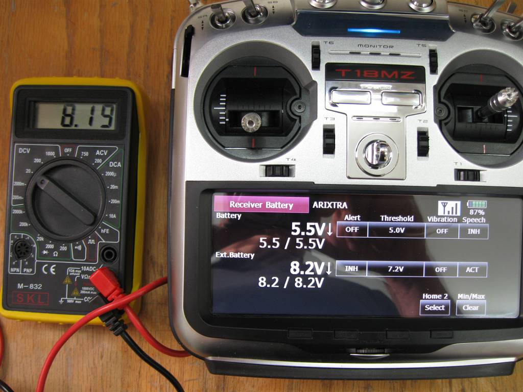

OK, so the RX voltage is working correctly.
The motor battery voltage displays correctly as well, correct?
The issue is what voltage displays on the RX for the external RX pack (before the regulator) correct?
Forget the voltmeter readings for now. What do you see on the TX display for the three voltages you are monitoring??

The motor battery voltage displays correctly as well, correct? - Yes
The issue is what voltage displays on the RX for the external RX pack (before the regulator) correct? - Yes

Thank you for your answer.
I flowed your advice and here are the results:
1. In picture no. 1 you can see the way the sensor was assembled (a lot of room for electrical garbage).
2. In picture no. 2 you can see the reading with no load on the radio and the reading on the voltmeter (DCV) – everything is normal.
3. In picture no. 3 you can see the reading with no load on the radio and the reading on the voltmeter (ACV) – it is not zero on the voltmeter, a suspicion of electrical noise appears.
4. In picture no. 4 you can see that the sensor was separated from the servos wires.
5. In picture no. 5 you can see the readings with load after the sensor was separated from the servos wires – on the receiver (after the digiswitch) 5.2V,
On the voltmeter 7.89V and on the receiver battery (telemetry) 3.7V !!!
Any suggestion?
Thanks in advance,
Isaac Najary

Hi Isaac, thank you very much for the detailed photo's.
With the voltmeter set to the 750Vac range I'm not sure if anything can be read into the "017" displayed but if there were 17volts of AC present on that line the sensor might be having trouble making sense of it. The main clue here is that there's more volts at the RX than what the sensor says is being put into the digiswitch and there's no way that can be. I know the YS cdi puts a lot of noise back on it's battery.
What I'd be tempted to do is remove all the servo's from the receiver and make up a dummy load like a simple resistor (4 or 5 ohms, or a 6V 5Watt light bulb) that will draw about 1 amp and plug that into the receiver and see what that does. Or before that, replace the digiswitch with another regulator (just for bench testing). There's something funny going on...
