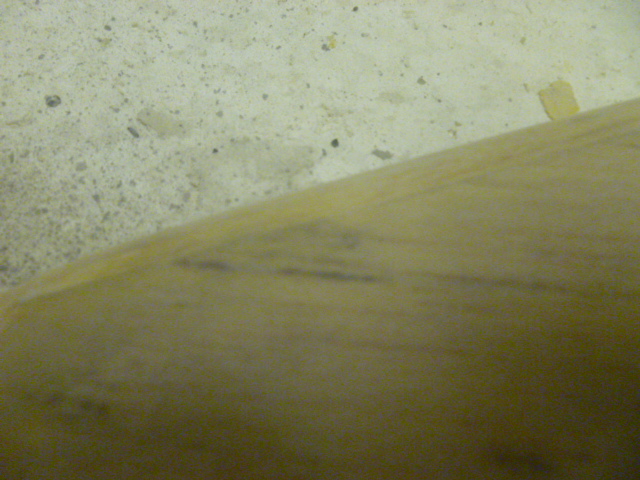

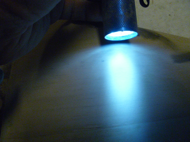

Now the work begins. I level the whole surface with 220 dry. The reason for the gloss Min Wax is to create a "guide coat", A guide coat tells us if we have low spots. If you still see gloss, you need to sand more because it's not level yet.
After leveling I use a flashlight held low to the surface to find pours and grain that still needs to be filled. You won't find all of them so just go for the big ones at this stage. I fill them with auto Glazing Putty, The stuff is heavy, but you will sand almost all of it off so weight gain is insignificant, This is the best material I have found for this purpose.

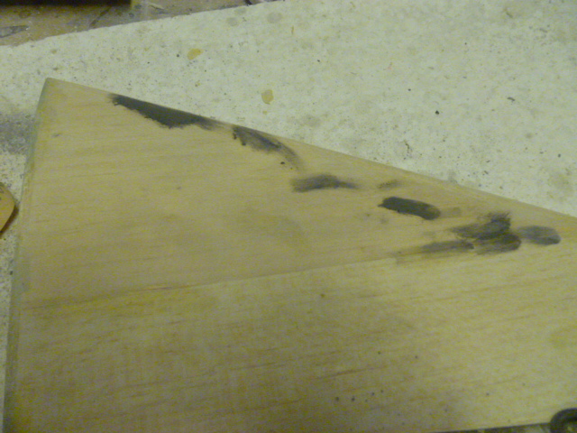

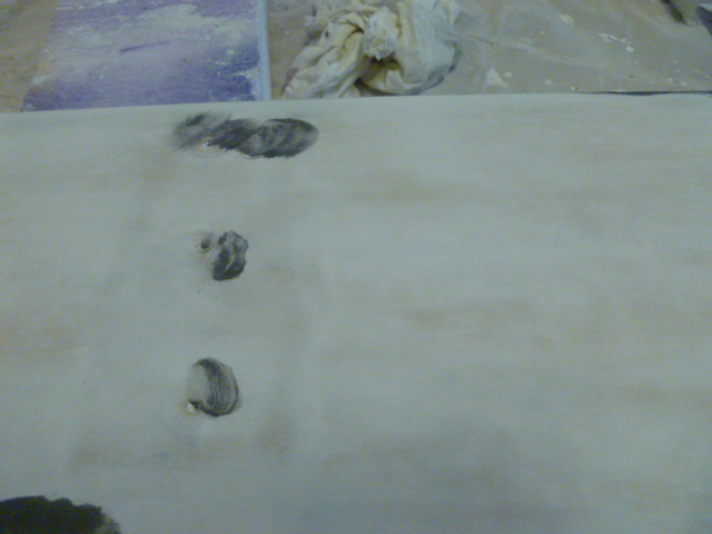

OK, now back on the hunt with the flashlight. I will tell you this is an extremely important stage and will take your work to the next level (glass smooth finishes). The initial grain filling with the spakling will get about 90 percent of them. The first round of glazing putty will get another 4 percent, but that 1 percent left is the difference between an average and a "show car" finish. Be ultra picky and look over the surface multiple times from different directions. This step is actually very fast and can be done in just a few minutes, so DON'T skip it.
#34
Here you can see one off to the edge of the light. It looks large in the picture, but was actually very small. If I see anything that remotely looks like an unfilled grain or microscopic pour I fill it with glazing putty. The glazing putty sands so fast, my opinion is "why not fill it". If it took some putty, fine, if not, no time wasted.

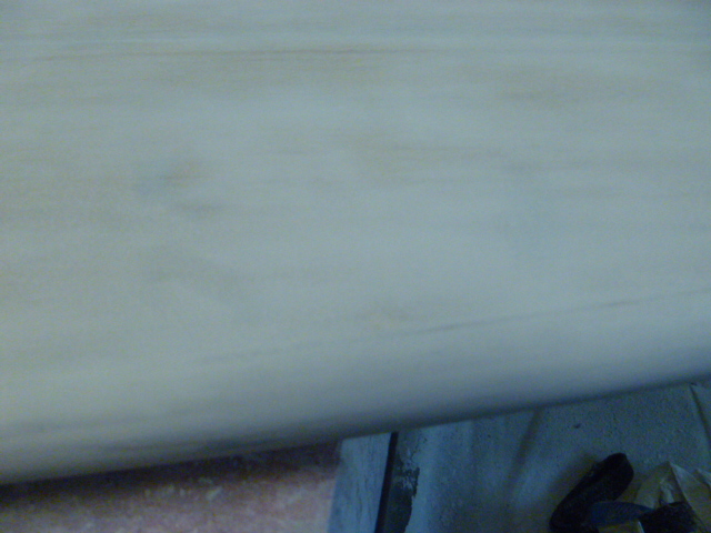

If there are any areas the have a fairly large amount of glazing putty still showing on the surface after sanding, I shoot a bit more primer on them to block the putty from migrating into the top color coats. At this point I sand with 400 dry and take the primer back a bit more. I have now removed as much primer as I safely can without cutting through it. I could probably go a bit more, but the 2 or 3 grams isn't worth it. One last quick pass with 600 and I'm ready for paint.
Ready for paint. The surface is more transparent than seen in the picture. Grain is visible over most all of the surface. You could read newsprint under it.

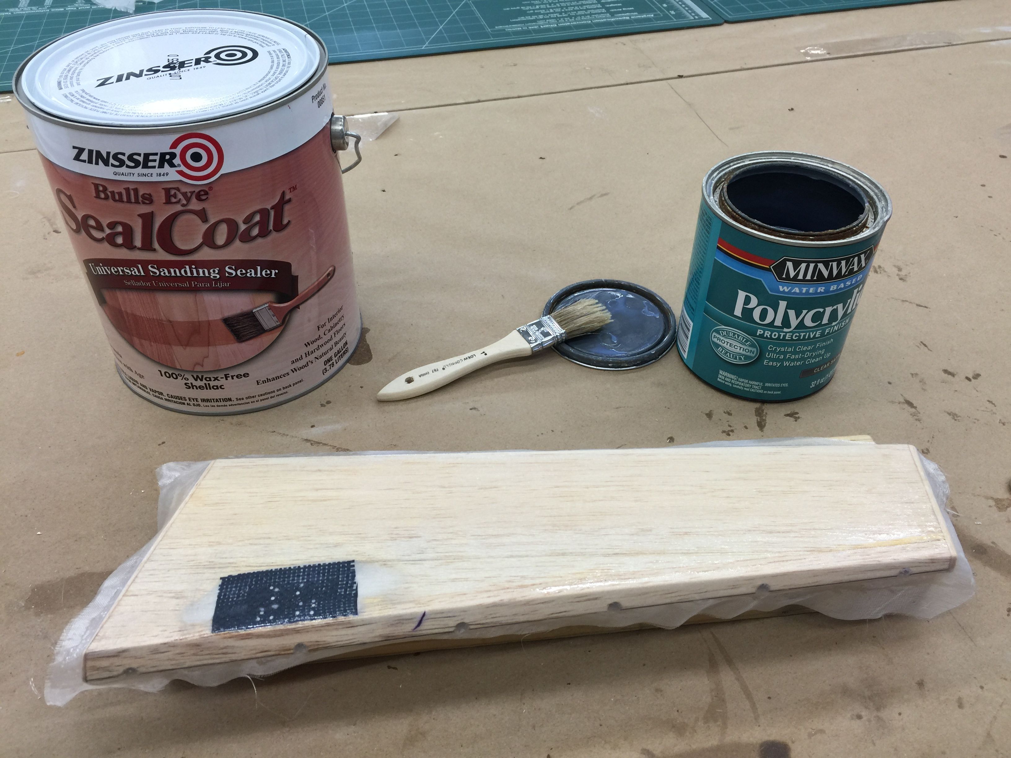

I have a balsa ply fuse and balsa covered foam core wings. Here is my finishing plan.
DAP light weight spackle and glazing putty to fill and sand holes and cracks.
One coat of Zinsser Seal Coat to seal the wood surface followed by light sanding to smooth the raised grain.
Cover with .73 oz glass cloth applied with Minwax Polycrylic.
2-3 coats of Polycrylic to fill the weave and light sanding with 220.
Prime with Rustoleum rattle can grey auto spray primer sanded with 220 and 400.
Paint with one coat of Klass Kote cub yellow on top surface and deep blue on bottom.
I glassed my rudder with the poly and it was so easy. I will never use epoxy again. I have not added any other coats of poly yet.

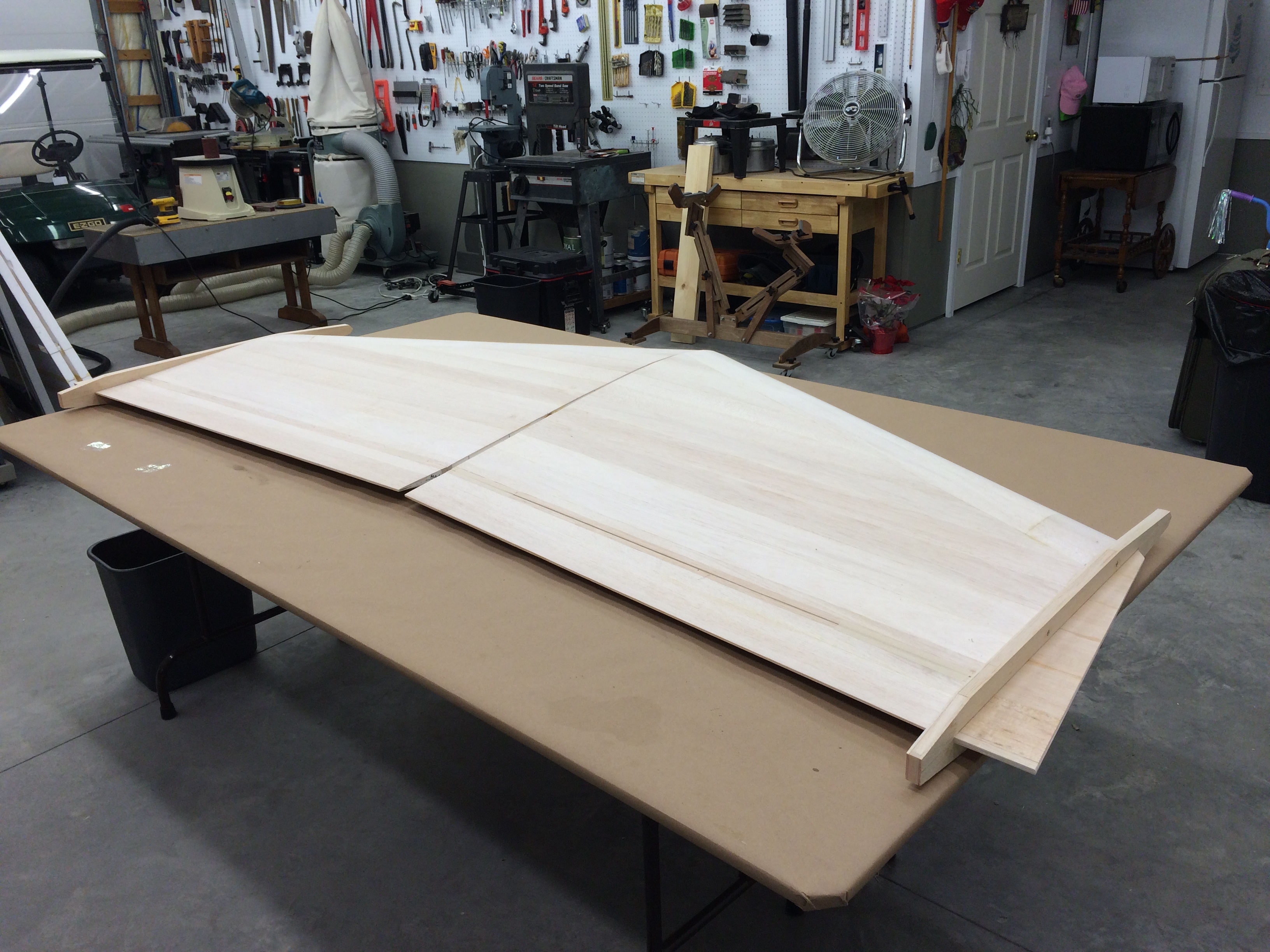

Current status of fuse and wings
