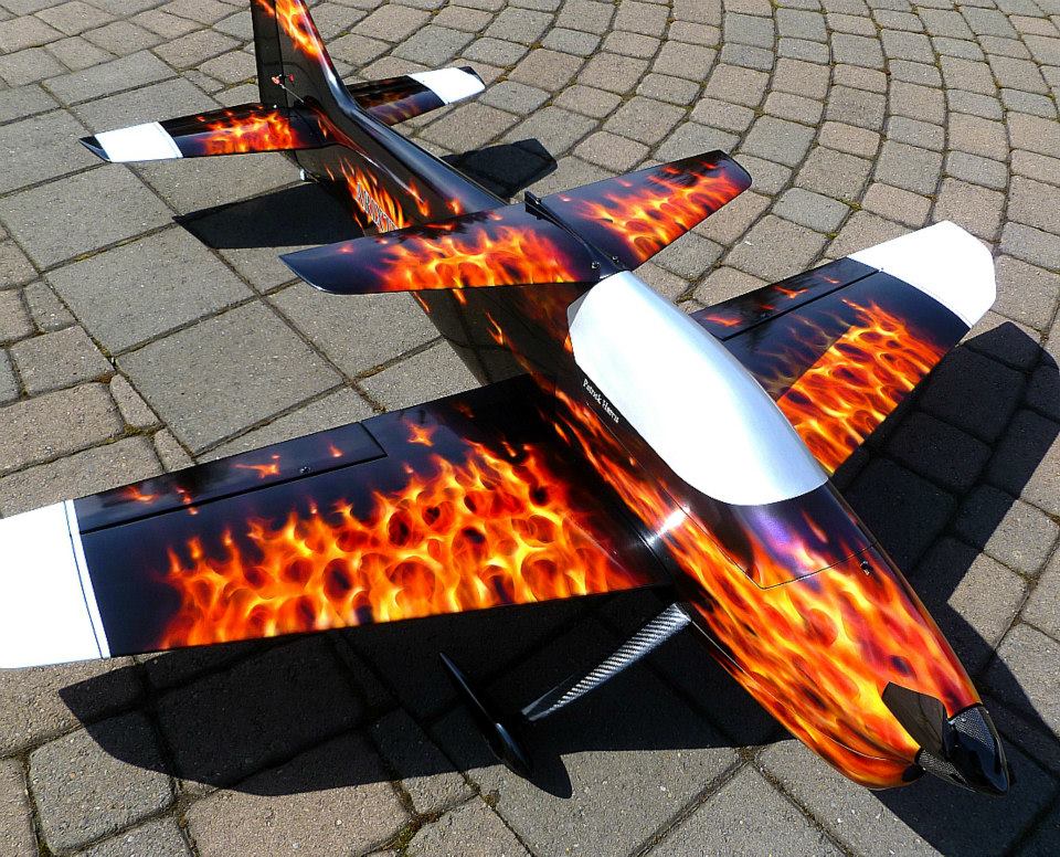

The same goes for the flame graphic on the wings of the Evolaris and the two Proteus. All I did was reduce the same image for the stabs and sent it to the cutter. Easy deal..done and done. You can see that the plotter will save massive amounts of time allowing you to do stuff you would never be able to achieve otherwise (well you can but it would take massive amounts of time). Another thing about using the plotter is to save all your sizes of images so you can go back and cut another one if you need it for repairs (been there, done that).

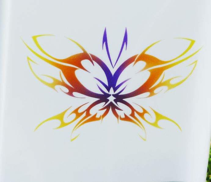

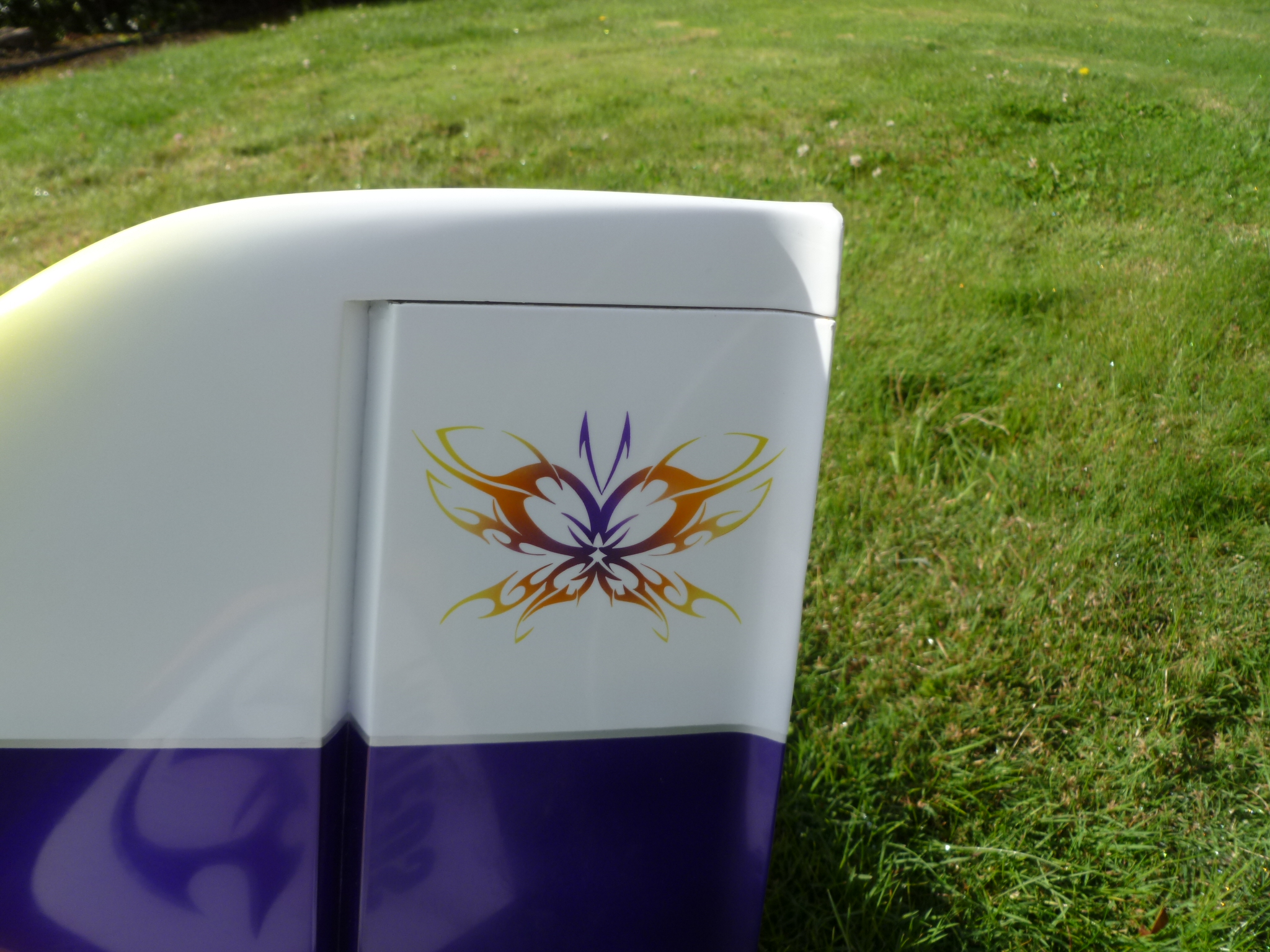

Go back to the beginning of this thread and you will see on the Evolaris a cool "Tribal" graphic on the wings and stabs. To create this image, I did a net search for "Tribal Graphics" and found an image I thought would work well. Keep in mind the images we pull off the net are in picture (JPG) format. What I do is just save it to my desktop and "import" it into Corel. Once it's in Corel, I use the "Outline Trace" feature that converted into a vector file. Once it's in a vector format I can rework it if needed and re size it. If you look close at the graphic on the wings, you will see I have painted a "beveled" edge (or the allusion of a beveled edge). All that was required to create the beveled edge was to add a line around the outside of the image. This was done with the "Contour" feature in Corel. This sounds intimidating, but is very easy to do.
You will also notice on the sides of the Evolaris and the top of the T Can on the Proteus, several company logos. Again this was a very easy process to grab the JPG image with a Google search, and follow the above process to convert them into vector files with the "Trace" feature.
