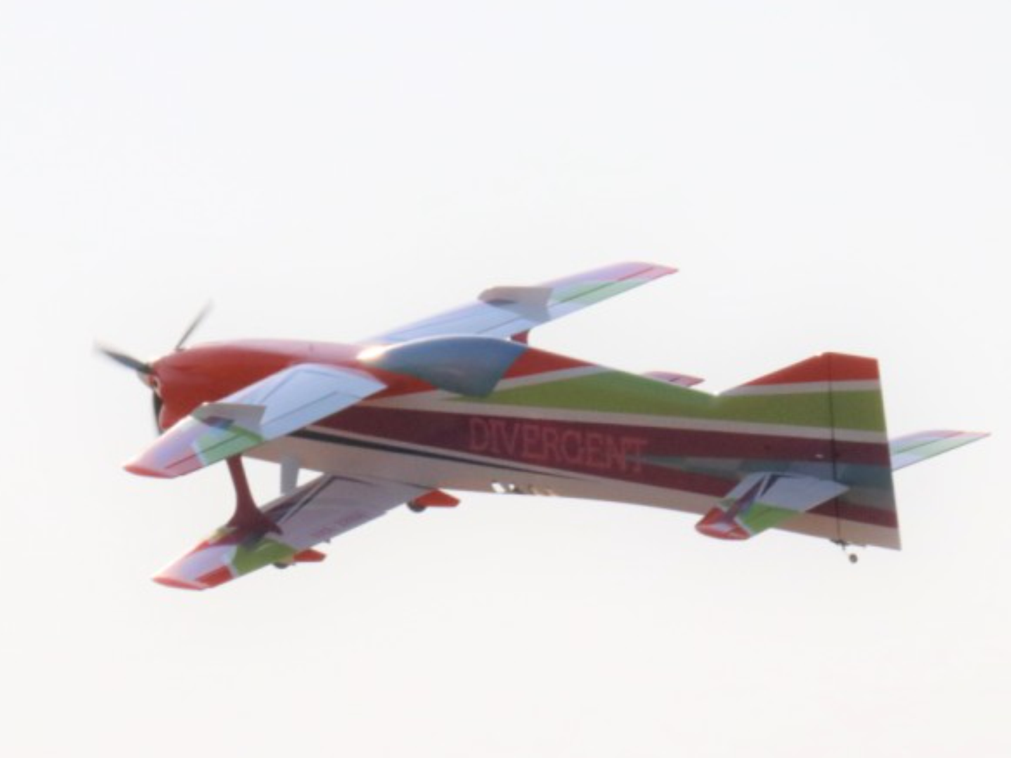

It's been a while but I finally have some pictures of the Divergent in flight. These were taken while just horsing around at a local club field.

I don't know if you noticed but somebody vandalized your spinner. They hacked the tip off......

I haven't updated the tread in a while, not much flying lately. I have all the nesessary materials in house for a couple kits. Very few changes will be made. I'm currently making molds for a slightly longer landing gear for a bit more ground clearance, molds for the wing fences which will be a bit smaller and the rudder will have a bit more taper top to bottom. A slightly different fuselage layup should yield a bit less weight as well.

ha ha ha. I'm still amazed at the lengths some MFG's go to to build a better mouse trap. Most if not all cowls have a built in air scoop. All that is needed is to properly direct the air to the motor much like you would do with an IC engine.

A little more to it then that with electrics Ken. One of the side air intakes has a duct that directs air directly onto the motor. The spinner in a standard Great Planes unit that has an aluminum backplate that I cut the tip off of to get a bit more air to the motor. The bottom air intake and the second side intake provide airflow over the ESC and batteries. An electric actually has the potential to generate more heat then a glow engine.

Hate to admit it Ken, but the little pin head is right. Electric motors generate quite a lot of heat. The best way to cool them is with the open spinners. This forces the cooling air directly over the hot motor, all of this assumes proper hot air exit area is designed into the airframe. In the case of this UGLY plane, proper hot air exit area Has been designed into the fuselage. It does work.....
