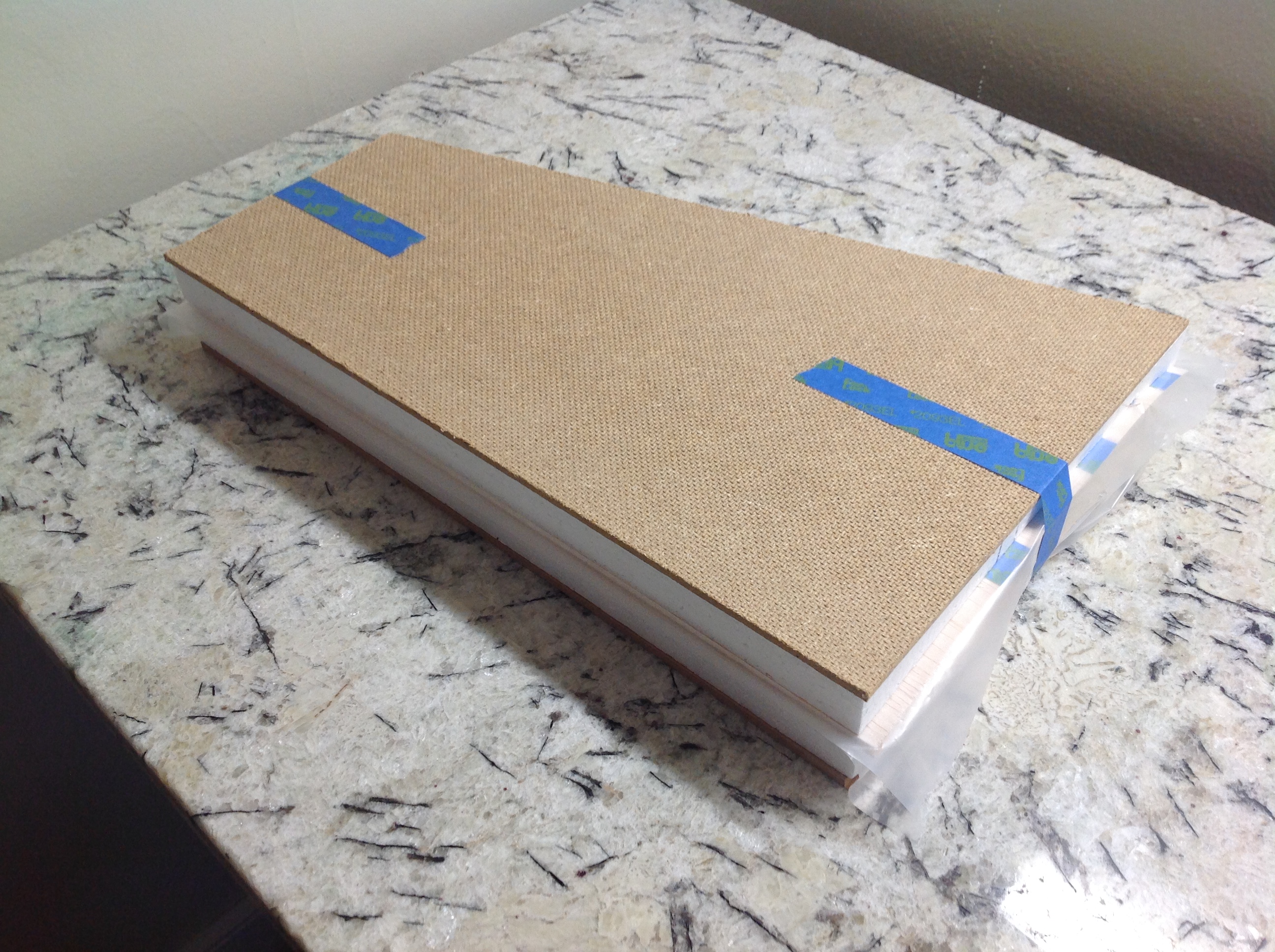

Time for another update, not too much going on with the build this past week. We have our last local pattern contest of the year and the one I enjoy the most next weekend so I have been busy getting ready/practicing. I was able to get the tube sleeves into the stabs and the stabs all prepped for sheeting. I decided to go into a bit more detail on my sheeting process simply because the process works so well and I think it will be of value to some of you.
The first step is to prep the shucks. This entails getting some 1/4" pressboard and cutting it to match the shucks outline. Then the pressboard is attached to the shucks with thin pressure sensitive tape.

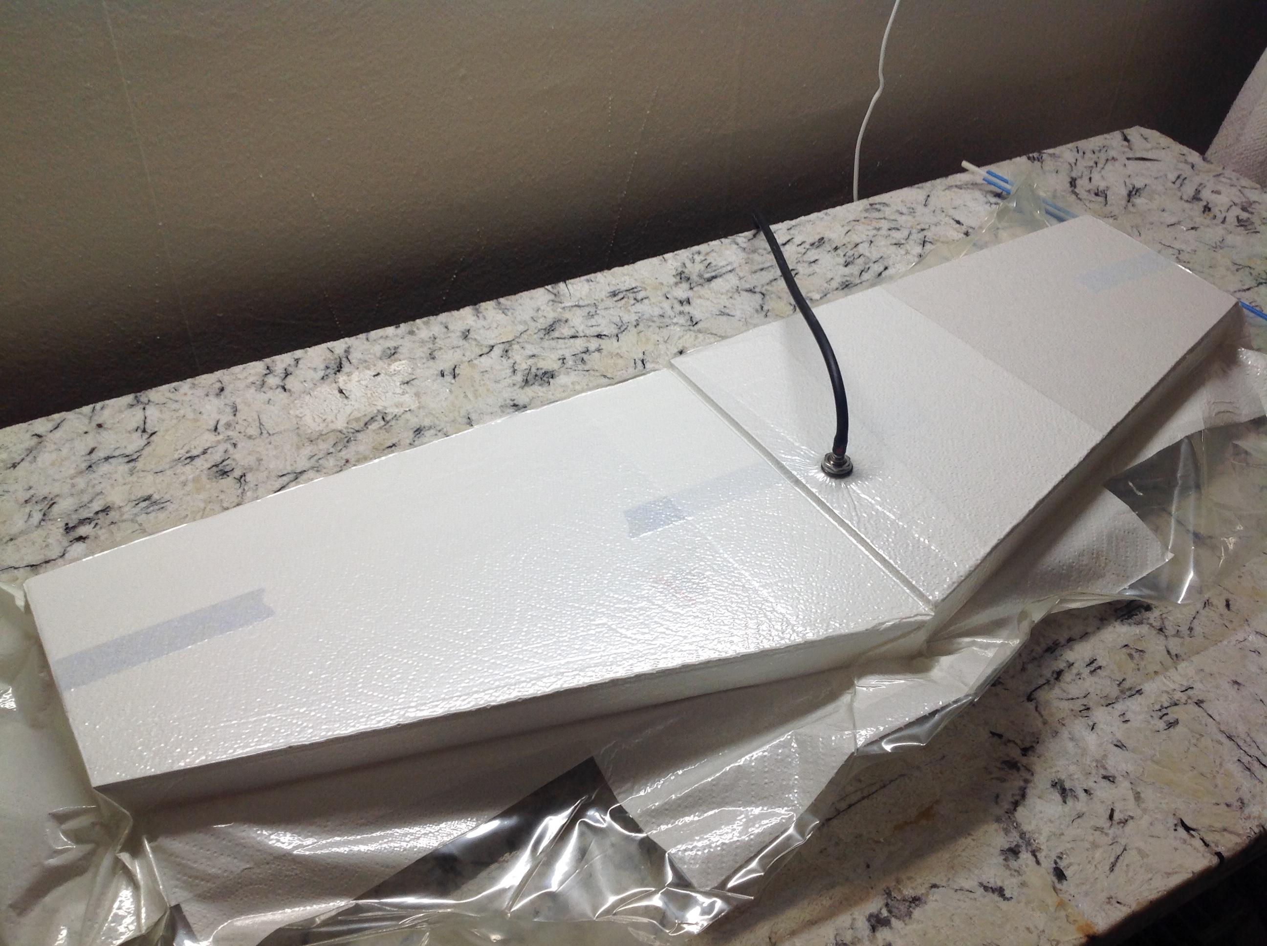

The next step is to mix up some epoxy laminating resin. For sheeting both stabs I mixed up a batch of 45 grams. That actually was a bit much as when finished I had about 10 grams left over. Then the epoxy was spread out on the sheeting. The goal with this is to use just enough to get a sheen on the sheeting. Any high gloss areas just means too much resin has been applied.

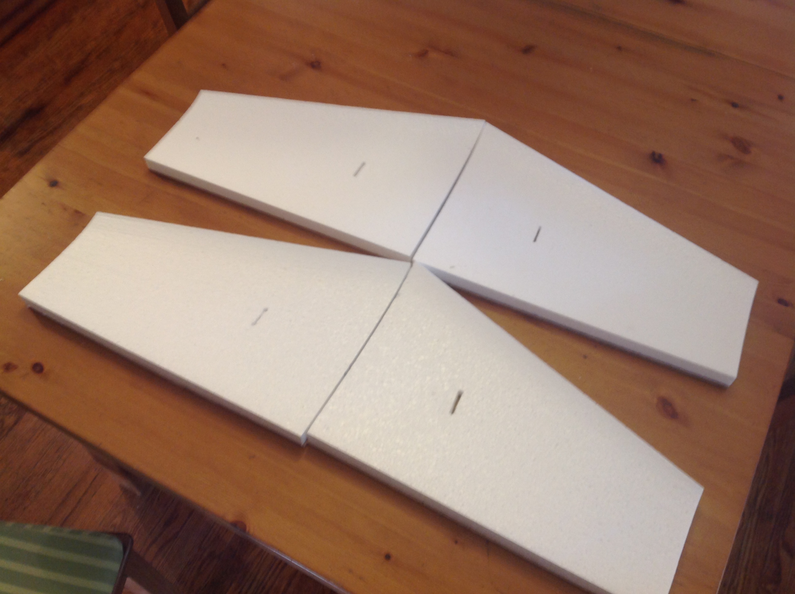

Then the sheeting goes onto the cores and the cores get placed into the shucks with some 1 mil plastic between the sheeting and the shucks. This is done so that if there is any epoxy bleed through it will not glue the shucks to the sheeting. The whole deal then goes into a vacuum bag with paper towel used as breather material. When vacuum bagging, breather is nesessary to get consistent pull over the entire surface. I pull about 5" HG in the bag and let them cure for the next 12 hours under vacuum. 24 hours would make me feel better but unfortunately I am building in the house these days due to a lack of having a garage. I just can't have the pump going off in the middle of the night while we are sleeping.

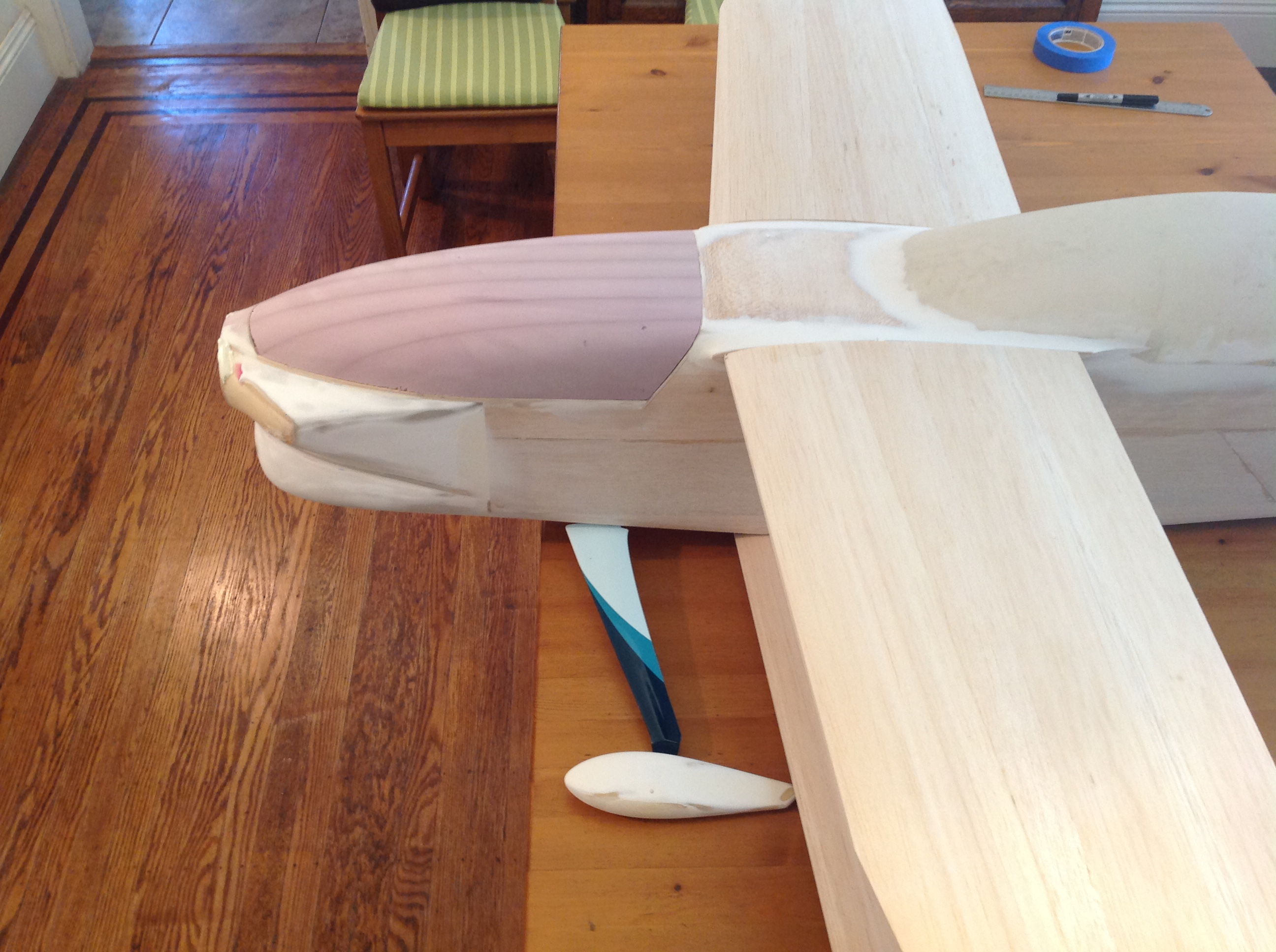

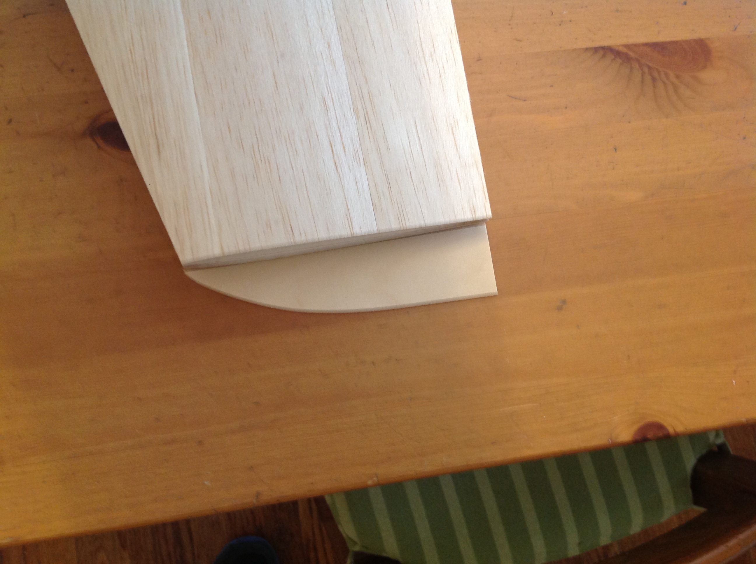

Another mock up after sanding the LE and TE of the upper wing. Also shown is the tip template. That makes the span and length right at 77". Once the LE stock and tips are glued on and shaped, I can concentrate on getting the match to the wings and fuse perfected. Then onto glassing the fuse plug. On a side note, a few weeks ago a club member dropped off a box with some landing gears. These ended up being the perfect size. I'm pretty sure I know who it was, if so. Thanks Don!

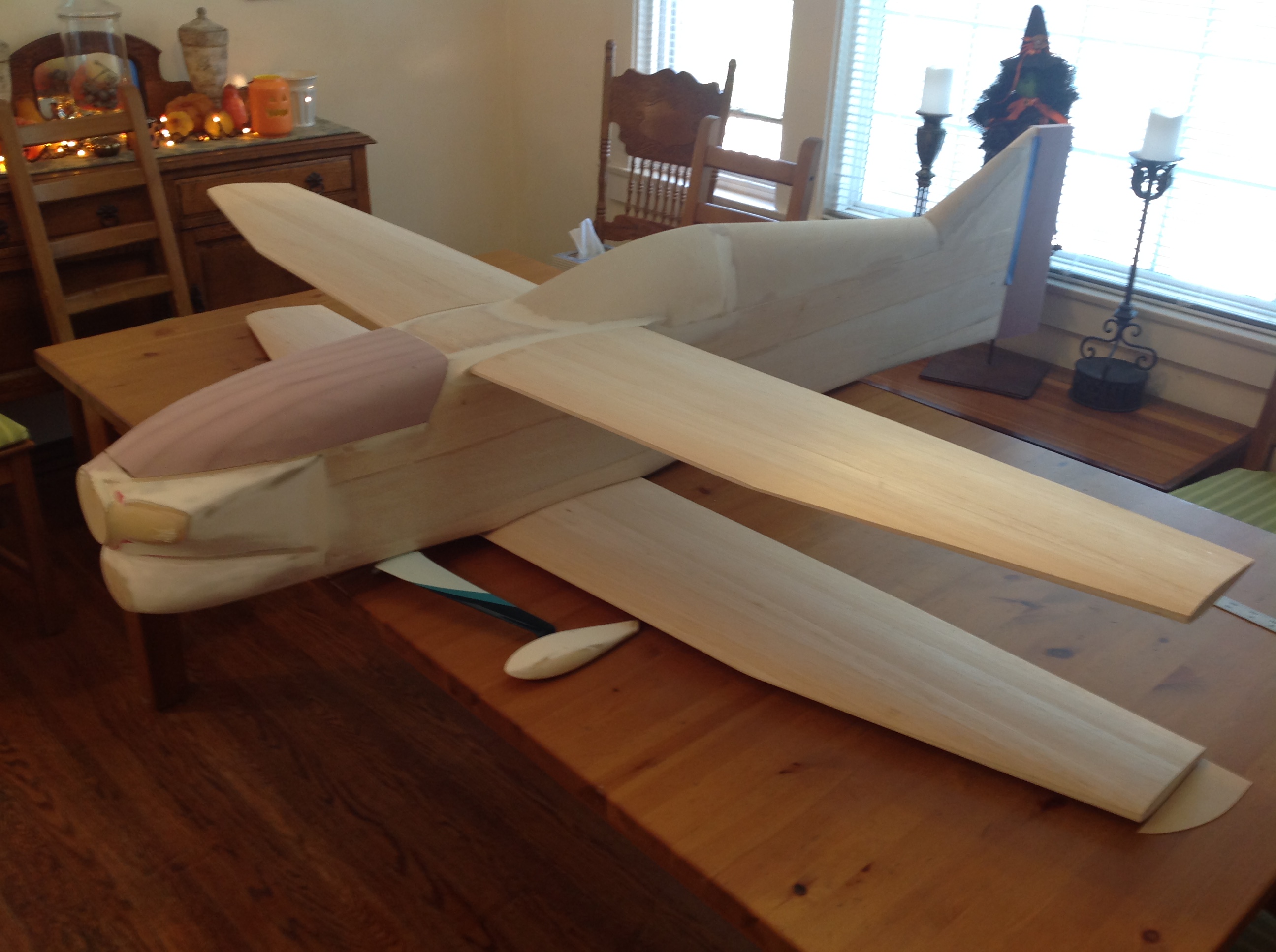

Back to the sanding stage. I didn't get much done due to getting ready for the final local pattern contest of the year. Now that is over I am back working each evening.I glued all the LE and tip blocks on the wings and stabs. Tonight's task was to get the stabs sanded out. At this point I will sand everything with 150 grit and leave them until it's time to glass everything. Then I will finish sand everything down to 400 grit. Here are the stabs after the first sanding session. I'm reasonably happy with the weight, 176 grams with the stab tube.
