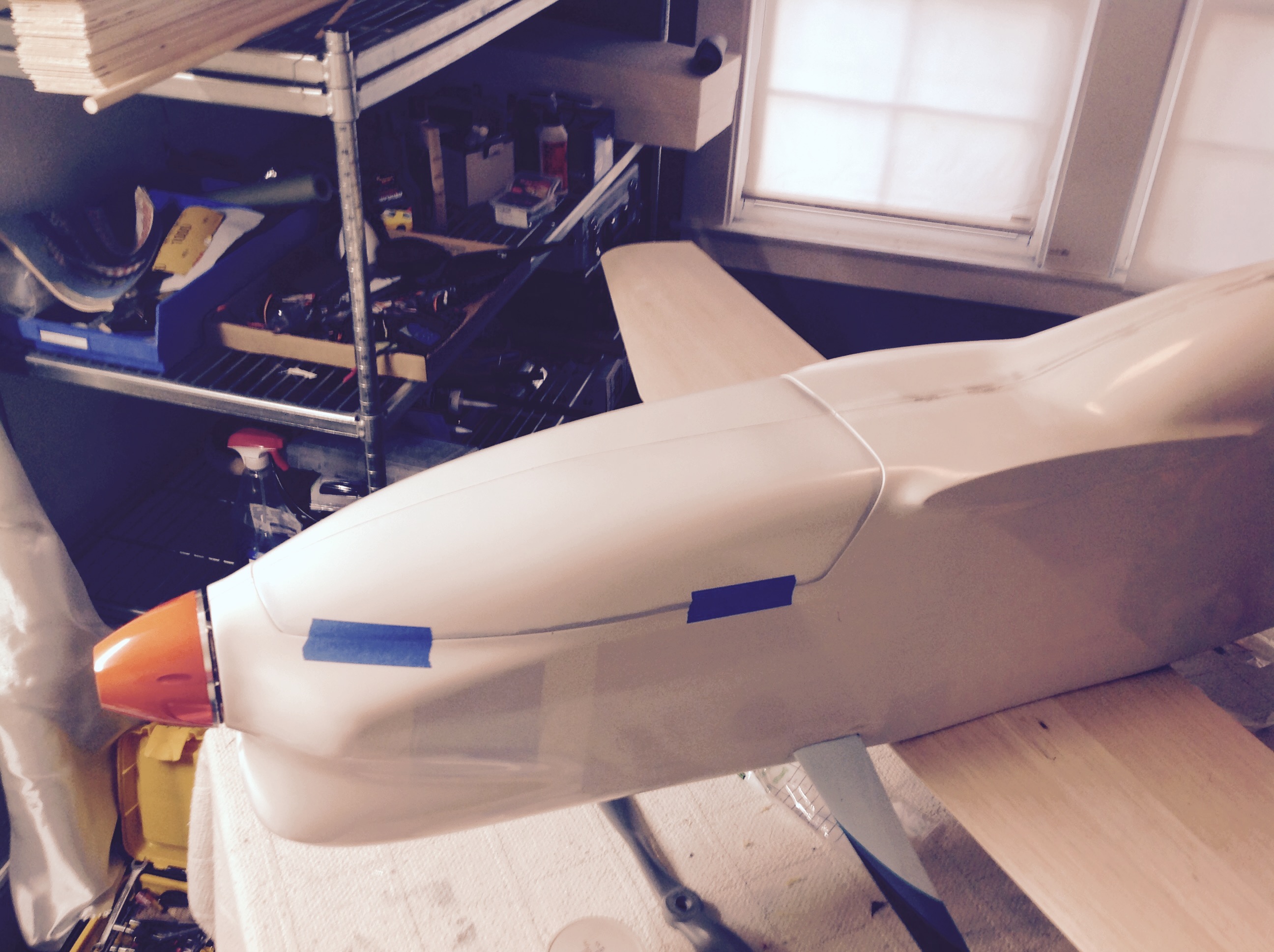

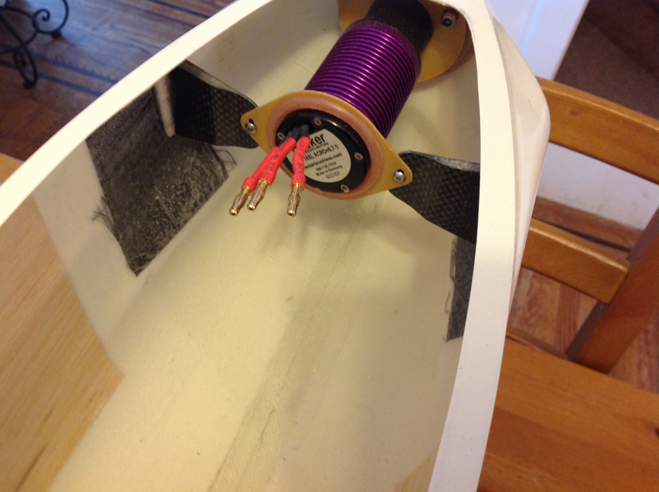

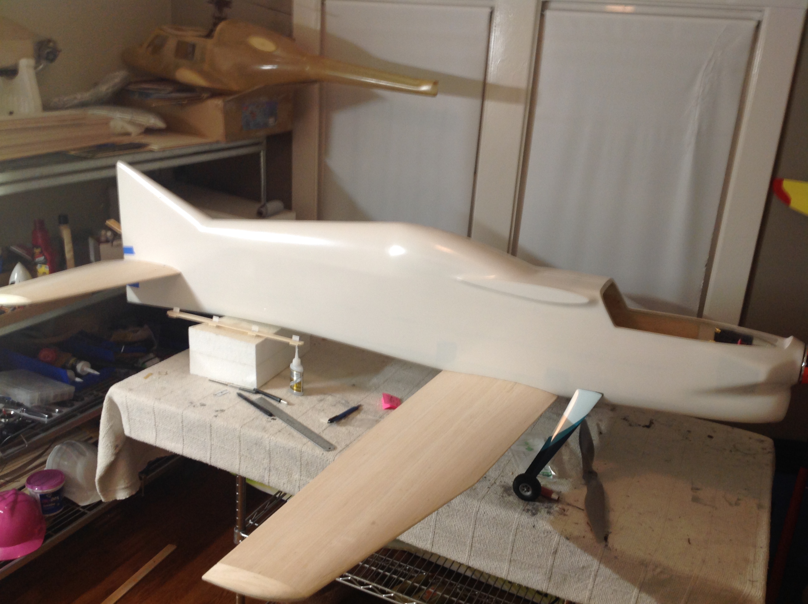

More good progress. I got the stab guide tube in and stabs leveled. The lower wing mounts are done as well. Tomorrow's tasks will be to glue in the fin post and lay up the hatch and a wheel pant.

A hatch is born. The fit is pretty darned good.

Getting closer.
