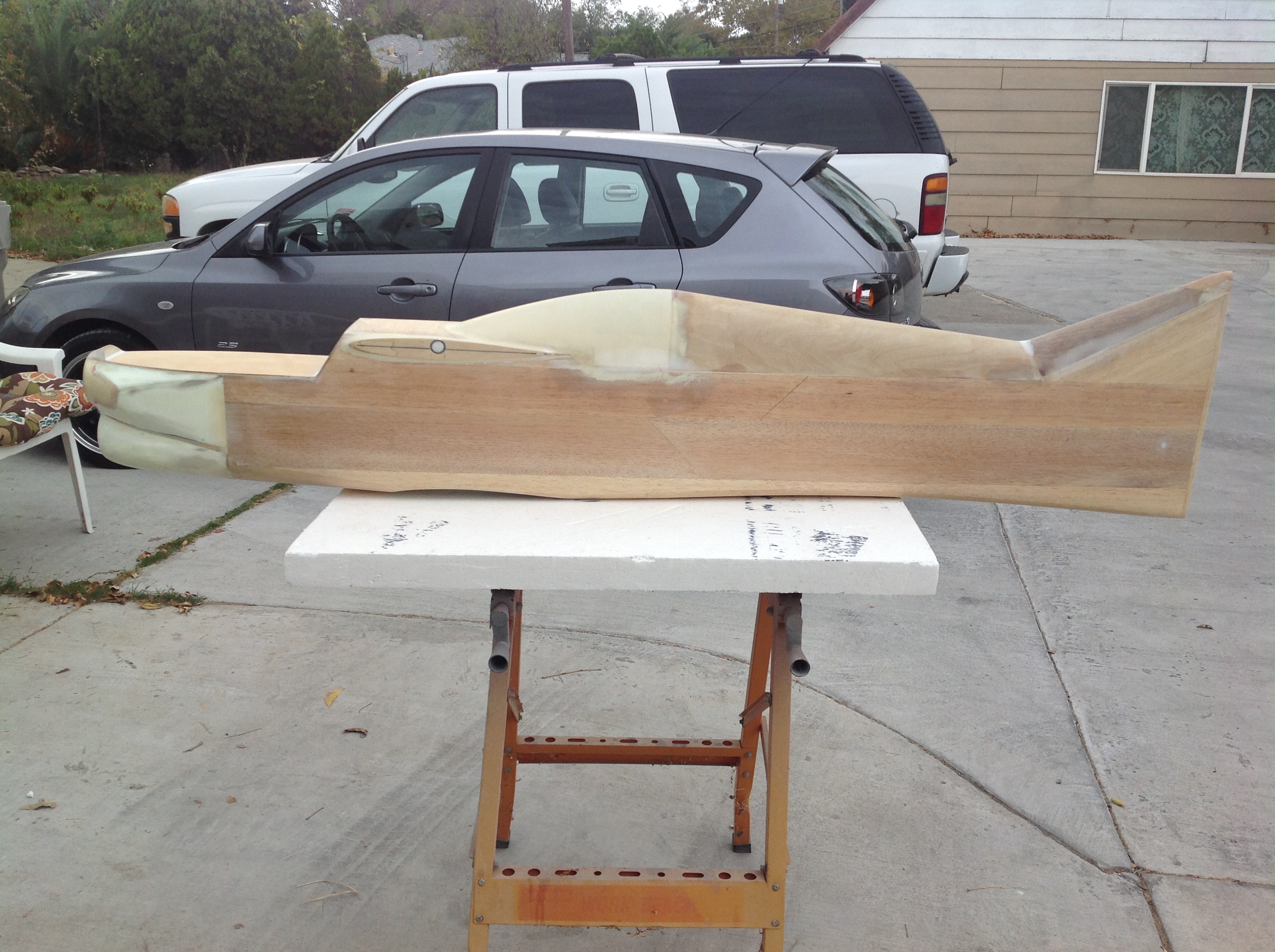

Not much to report this week, I have been sanding as much as I am able each evening. Unfortunately hand sanding takes a toll on my right hand. Just over a year ago I had developed an aneurysm in my hand and had to have the affected artery removed. Sanding is usually limited to an hour an evening. Most of the blocking is done and I have begun to fill in visible low spots and radius some corners. If we were going to have some better weather this weekend I would push through this work and spray the first coat of primer on Sunday. We are forecasted for rain off and on all weekend so for now I will just continue at a moderate pace.

I decided today it was time to get the hatch fitted to the fuse. The first step was to cover the area with some trim Monokote. A dark color was selected to aid in visibility. The Monokote was waxed and a thin coat of PVA was applied. I'm sure I would have done without the PVA but better safe then sorry. Next a layer of 1.4 oz cloth was applied followed by a layer of 3.7. This was left to get to an 80% cure while I took my wife to the movies ( gotta keep the balance ). When we got home I mixed up some laminating resin and added some micro balloons and cabosil for for a semi runny paste. That was applied in somewhat of a framework pattern. The hatch plug was taped into place using Kapton tape as it is a little bit elastic and will keep pressure as some of the paste epoxy squeezes out. I will leave this until late tomorrow and the pop it off. I should end up with a perfectly molded hatch floor.

I cleaned up the hatch some when I got home from work today. I am 95% happy with it. There are a couple of low spots that have to be filled prior to primer. The plan is to use a couple small pieces of transfer tape to hold the hatch to the fuse while the primer is applied and block sanded out. The hatch/canopy fit on my Hydeaway is horrible and really irritates me. This one needs to be done right. I think I am still on schedule for primer this weekend weather permitting.
