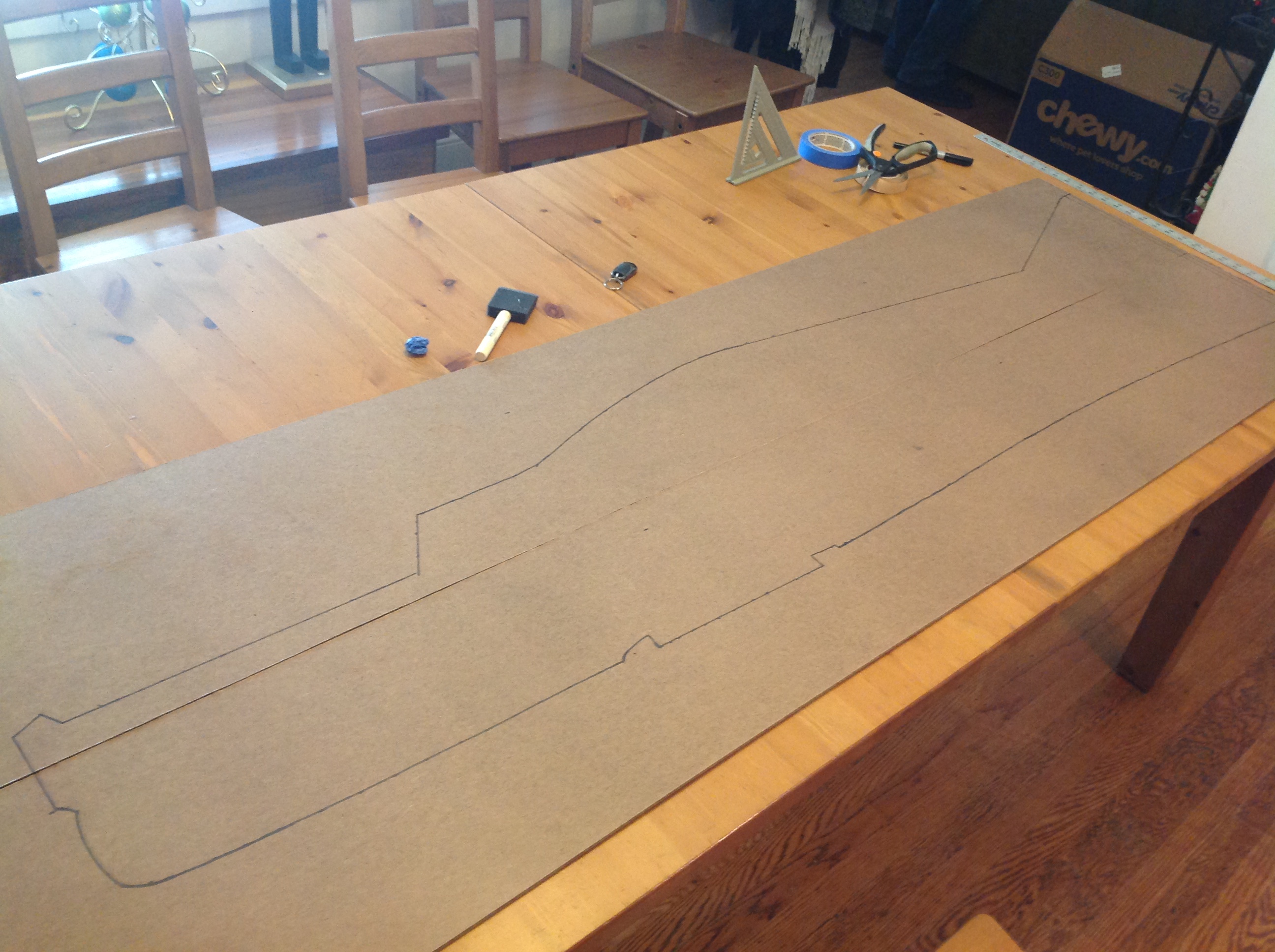

Now that the paint has dried for a few days and I have sanded all the texture out of the paint I have started on the parting flange. The first step was to trace an outline onto two 14" tall strips of 1/4" press board. Next I took another peice of 1/4" pressboard to use as a base plate. I then used some pink insulation foam to support the fuselage. Being that most of the fuselage sides are completely flat the foam shims were really easy to make. A center line was drawn onto the plug and several foam squares were cut 1/4" below the center line. These will support the parting flange at the correct height and help keep the parting flange straight. Home Depot wooden years sticks were added to be enough the base plate some rigidity. The next step is to cut out and fit the two parting flanges.
ID:	2247288   Click image for larger version

Parting flange is mostly done. Soon the fun part of laying up glass will begin.

Looks good. How hard would it be to make the end piece at the rudder post bigger. If you increase the size of it you should be able to stand it up on the end in your warming box without it falling over. The other option would be to leave the flange the size it is and add a couple of legs to it when it is built to thickness. Keep in mind that it will have to be able to hang over the end of the bench when you fabricate the fuselage in it, so you will still have to glass some wood or aluminum down the length so it will rest flat on the bench.
Still looks like a pregnant fish.................

Today I fabricated up a parting flange for the hatch. I used the same technique as with the fuselage. I went ahead and mixed up a past adhesive out of laminating resin, cabosil and graphite powder. I put a strip of teflon tape down the center of the hatch. A bead of this adhesive was then put onto the edge of the parting flange and then put into place. When the adhesive dries the flange halves will be removed and the adhesive sanded flush with the parting flange. Once I verify this technique works, I will move forward doing the same with the fuselage. The next step will be to paint the parting flanges.
i went a bit different for the wheel pants. I made a wooden box, supported the wheel pant plug level inside the box and poured some plaster up to the pant center line. In a few days I will pop the pant out, sand the flange flat and then seal the flange with laminating resin.
ID:	2247746   Click image for larger version
